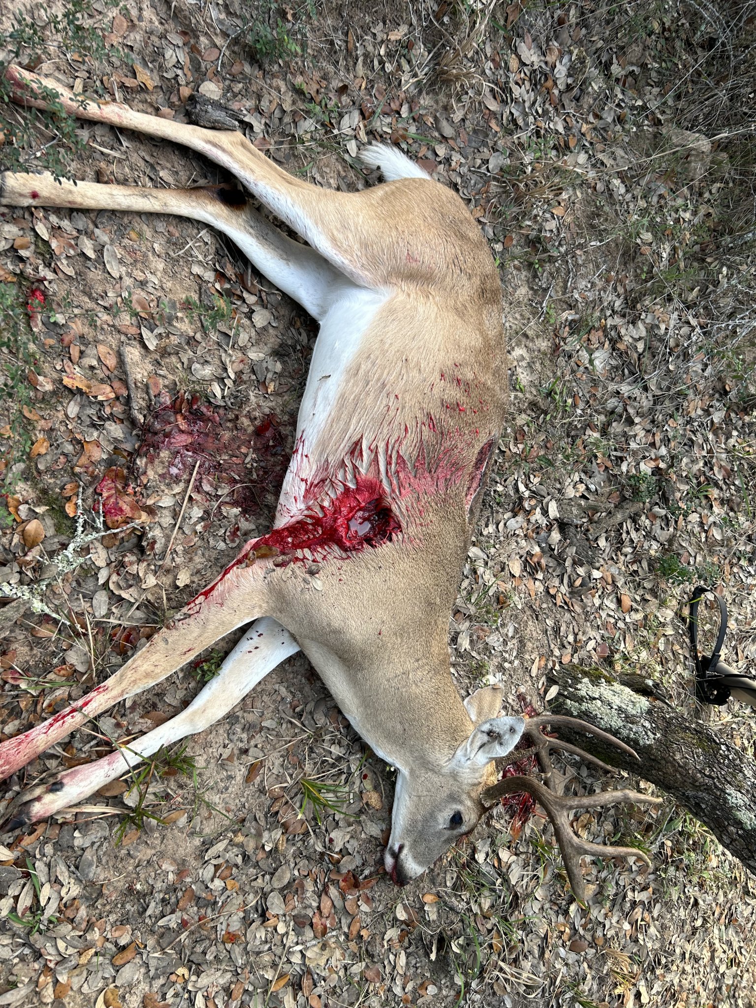

Back to back standing shots at about 200 yards with a Acog. Pretty sure it’s not the shooter.
First one is a broadside through and through pencil size hole. Even with a direct heart shot the deer didn’t die instantly.
On the second one I tried to Nick the edge of the front shoulder to get the bullet to tumble, and it did. Sounded like a drum being hit and it dropped.
Closest thing I can get to real world results without being a serial killer.
