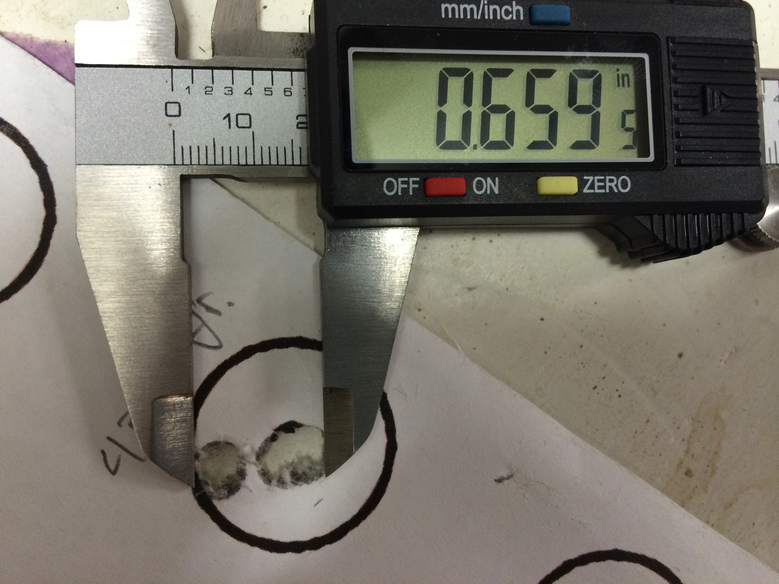

Finally got my new Timney trigger installed into my AAC-SD to replace the x-mark pro and my God what a world of difference! On my first outting with it, I think I shot one of my best groups!
.659-.308= .351 (if that is the correct way to measure groups), but I'm still getting used tot he new trigger, and definitely need more time behind the rifle, and hope to see my groups improve!
