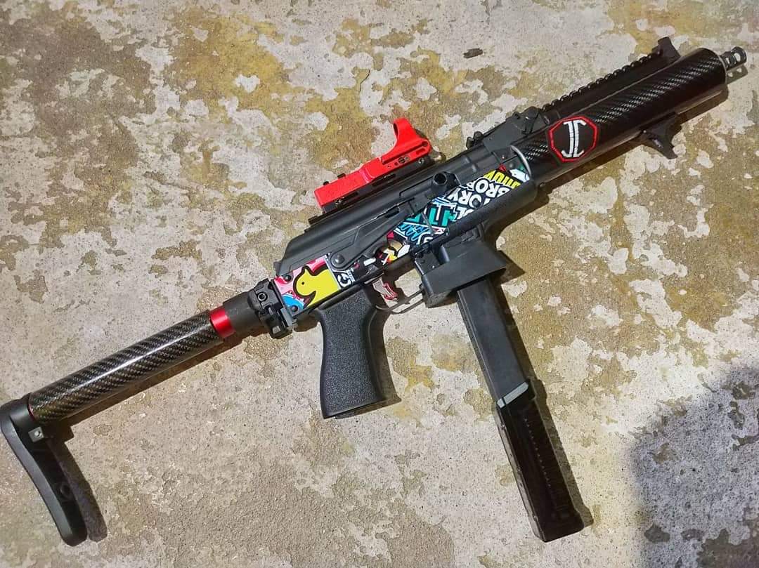

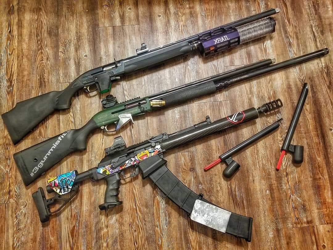

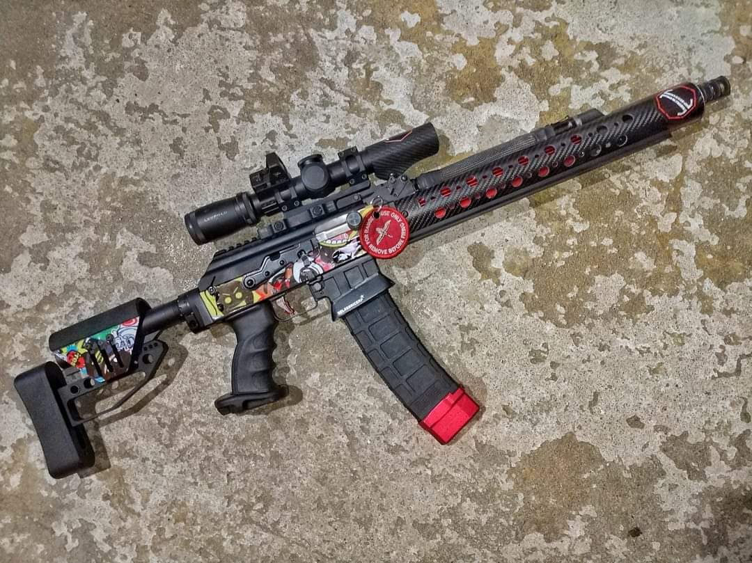

View attachment 8368420View attachment 8368421View attachment 8368422
Was he at AK Masters last year?
I don't think so, but I haven't seen him in a bit. He runs the Thunder on the Tundra AK match in WI as well as some club level matches, I think match directing burnt him out on the match shooting, as it tends to do.

AK and Remington shotguns at the same time? Your friend hates himself.
