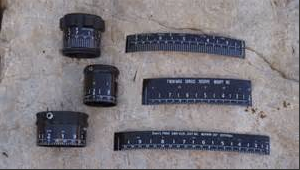

You might want to look into turret labels for your elevation turret on your scope. Range the distance then turn you turret to the distance and shoot. Not necessary to count clicks. You will have to hold for wind like you would without the labels though.
Custom Turret Systems | Affordable Custom Turret Labels
