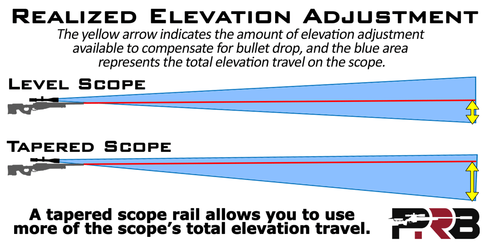

And look at the bottom image in the one that @spife7980 posted. At 100 yards, you're looking through the top of the glass. Image quality degrades as you move away from the center, but you really don't care a whole lot about that at 100 yards - if you can't see well at 100, even through the edge of the glass, you got other problems.
As you dial for elevation, you get closer to looking through the middle of the glass until you hit center. With 40 MOA of cant, that would be somewhere in the neighborhood of 1300-1400 yards with my 300 PRC. At that point it starts travel away from center again, and the optical quality starts to degrade.
Then, as I mentioned above, you have your max range. Again, using my 300 PRC as an example, I have 35 mil of vertical capability in the scope. If I had no cant, I would be able to get 17.5 mil up and 17.5 mil down worth of travel. Without the 40 MOA (11.6 mil) I have in the mount and base, that means that I'd be able to dial to about 1650 yards, give or take. Anything longer, and I'd have to hold over to get the range.
With the 40 MOA built in to the rail and mount, I'm able to dial 5.9mil down and 29.1 up. That equates to just over 2100 yards that I can dial to.

Your scope generally has half the elevation travel up and half down with a 0 cant base. It may not be exact but for broad strokes.
A canted based tilts that so that where the rifles relative 0 point is at in your scope is lower, thereby making more elevation travel available at the cost of down travel.
You dont utilize down travel once youve established your zero for long range shooting.
So for something thats intended to shoot long range, 20 moa should be the minimum I would want.
So if i read this right, and convert it into my real life example: When i am out to say 1500 yards, no MOA base, i pretty much MAX out my MOA AND hold a another 5+ in the scope. With a 20 MOA base, would that mean i would have 20 more MOA to use, therefore eliminating the extra hold, putting the target in the middle of my reticle? And in doing so, it would be more centered in the glass rather than be in the bottom? When i zoom all the way in, i can only see approx 30MOA in the glass vs the 50 or so I should see because it runs out of glass. Does this also change? Sorry…..trying to make sense of it.

Ok that scope has 120 moa/35 mils of elevation so I would get 30 moa in that CDG action if you go that route and then get a 20 moa mount to mount that scope in. Should give you plenty of elevation and still zero at 100. If you need more you can use the reticle and hold over.
Reactions: Taylorbok
Ok. So what that’s giving me is tech 170 moa? Right? 120+30+20
120/2=60 up and 60 down
The 30 can’t in a base and 20 in a mount equals a conversion of 50
You would end up with 110 up and 10 down in your scope in that scenario.
You offset the even split of the scopes total elevation travel by the amount of can’t built into the mounting solution, aka base+mount
Yup what he said. Cant in base or mount does not add elevation to the scope but redistributes the amount you have.
