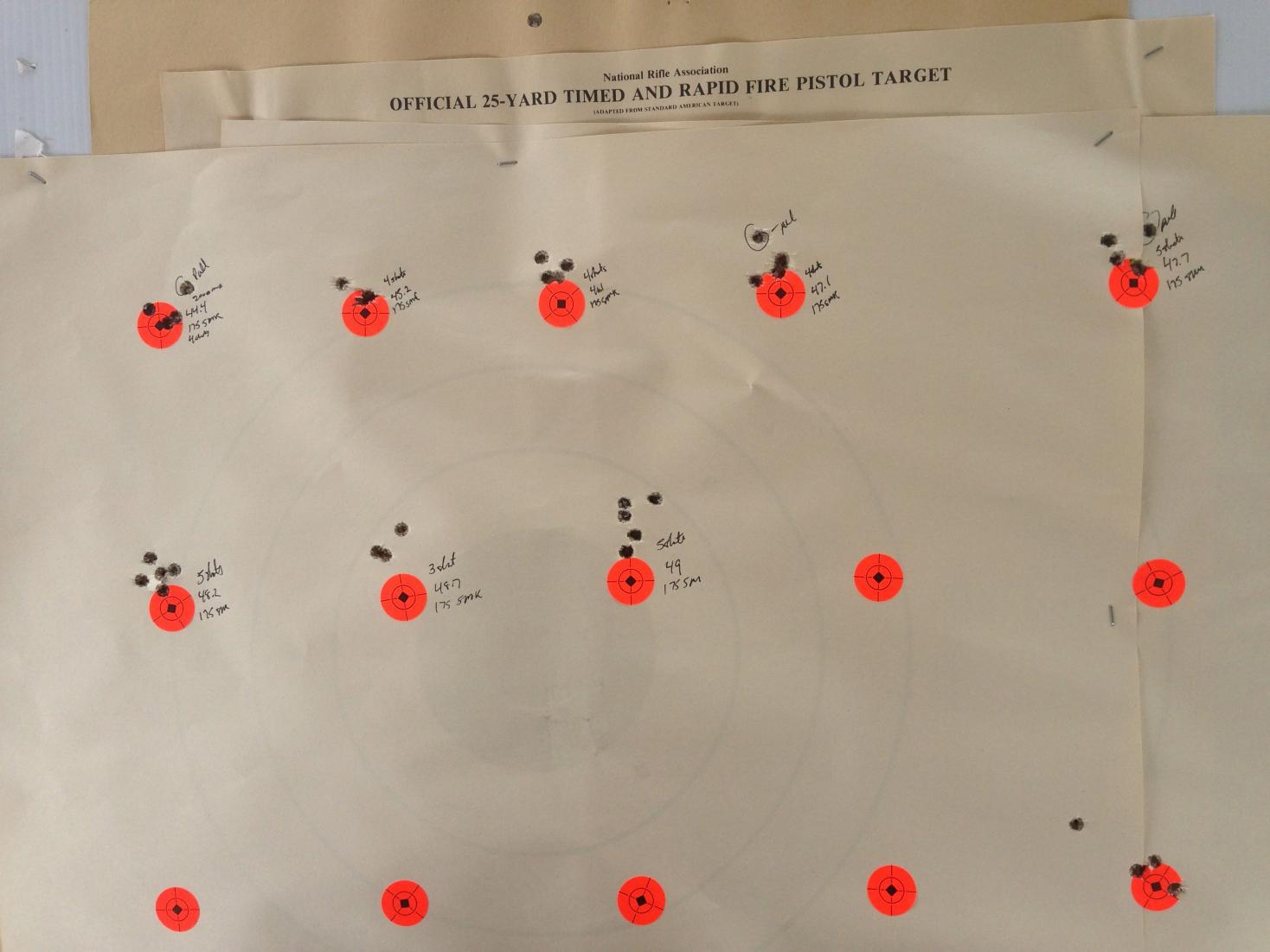

Well I finally made it out to the range today. I ran the OCW for 44.4 gr up to 49 gr of 2000-MR. No pressure signs. I pulled a couple, had a couple of primers that did not go off on a couple of the lower charges and had a couple that did not feed which was peculiar since they were all loaded at the same time, same die, same bullet lot but I could see where it was scraping.
Here's the photo of all the strings. Not sure what to make of it in all honesty. Thoughts?

Just an observation. But it seems to me that there is a trend there. The higher the charge the more the groups open up. What do you think??
True. I was looking mainly for the direction from the point of aim. I missed that. 46.1 gr might be better to work around then. If I do start there am I better off just taking 46.1 and working seating depth or change the charge by .2 and work two up and two down to see what happens?

Good pics. Its pretty obvious to me that your OCW is between 48.2 & 48.7. Your groups poi get a little higher with each group and the tightest groups come immediately after the scatter node. Exactly what the OCW method predicts. I'd say its close to 48.7gr.
Jumper, would you explain that a bit more please? When I read the OCW site it says I should look for groups that are on the same bearing and approximately the same distance from the point of aim. This is what OnTarget gave me

If I take that then based on above I should be somewhere between 46.1 and 47.7? I think I did not have enough granularity in the loads. Am I reading this correctly? It seems that maybe between 47.1 and 47.7 I would get the same relative POI and possibly below 47.1? All the x shifts were close for the 46.1 to 47.7 the y shift on 46.1 is climbing.

Dave - the OCW method is a good way to find the ideal load for a powder and bullet combination that is tolerant of minor variations in production. But its easier to see the scatter nodes and changes in poi when the groups are shot at 200yds or more. At 100yds its real hard to see subtle changes in a group. But your 100yd groups showed a big difference in size and a subtle shift in poi that also corresponded with the increasing charge. Its subtle but its there . if you look at the bottom edge of the box around the group you'll see it get a little higher on the targets as charge increases. But the most obvious change is group size.
Continued...
In the lower charge weight groups, there isnt a discernible change in group size until you get to 45.2 ~ 46.1 Then, as you progress, the groups get larger @ 47.7, then smaller at 48.2. 48.2 is a uniform group with the POI spread pretty even throughout the extent of the group. Then they tighten up nicely at 48.7. At 49.0 they again start to scatter. So your big at 47.7, getting smaller at 48.2 and smallest at 48.7. And, the poi is climbing with each of these 3 groups. According to the OCW theory, this means that as your barrel is vibrating the velocity of the bullet generated by a charge weight of 47.7 has the bullet exiting the barrel as the muzzle is moving between its high point and its low point, like the crest and trough of a wave. At 48.2gr, the bullet is leaving as the muzzle gets closer to the crest. And 48.7 generates the ideal velocity to have the bullet exiting the muzzle at the crest of a vibrational node. Notice how the group is tight and its POI is a little higher than the 2 groups preceding it. The crest and trough is where the muzzle is moving the least and is generally the best for accuracy.
To really do an OCW work up it should be shot at 200 to 300 yds and in round robin fashion so any shooter error or heat build up etc., is spread across all the groups. You did a good job of taking pictures and recording your charge weights so even though you only shot it at 100yds it was kind of easy to see. Hope this helps.
Yes, I would like to see your groups at 300yds if possible, I think Itll show you more, I mean, all those 100yrd groups are pretty good, 300 would bring out the devil in some of those loads, so to speak.
I'll get it out to 250 this weekend if I can get back in the reloading room. I am going to try and load at both nodes. Lower and upper. The upper concerns me as it is above max loading recommendation and it was cool outside. I am not sure how temperature stable this powder is. I did not see pressure signs though. Also, jumper I did shoot round Robbin. Thanks for all the advice.
Not sure on the emphasis on group size for an OCW.
From what I have read and tried , group size while finding optimum charge with a given projectile , means very little
In my experience, some of my best 100 yard groups really didn't do well past 200
In you case take 48 grains back up to 250 and start shooting 5 shot groups with seating depths changing .005 at a time
