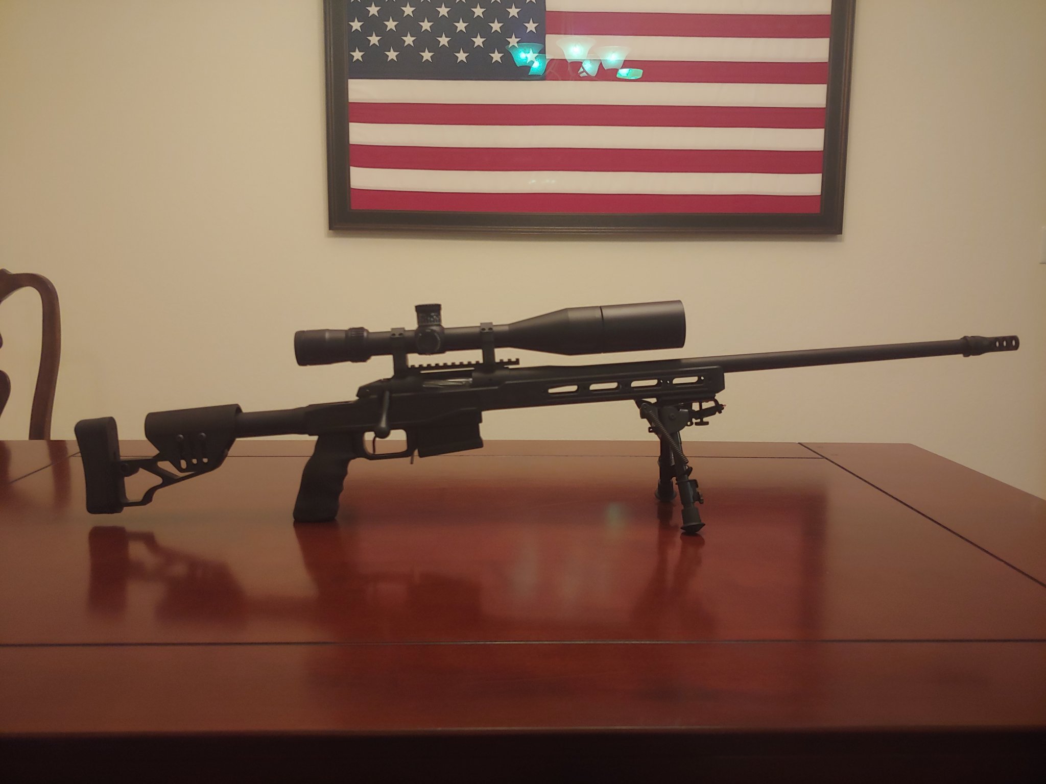

Here's my LRP, the quality and craftsmanship far exceed the price. But make no mistake, the RPR and BMP are fantastic options.
You can't go wrong either way, one thing to keep in mind with the BMP compared to the LRP. The LRP comes with the premier action which is a blueprinted action.
