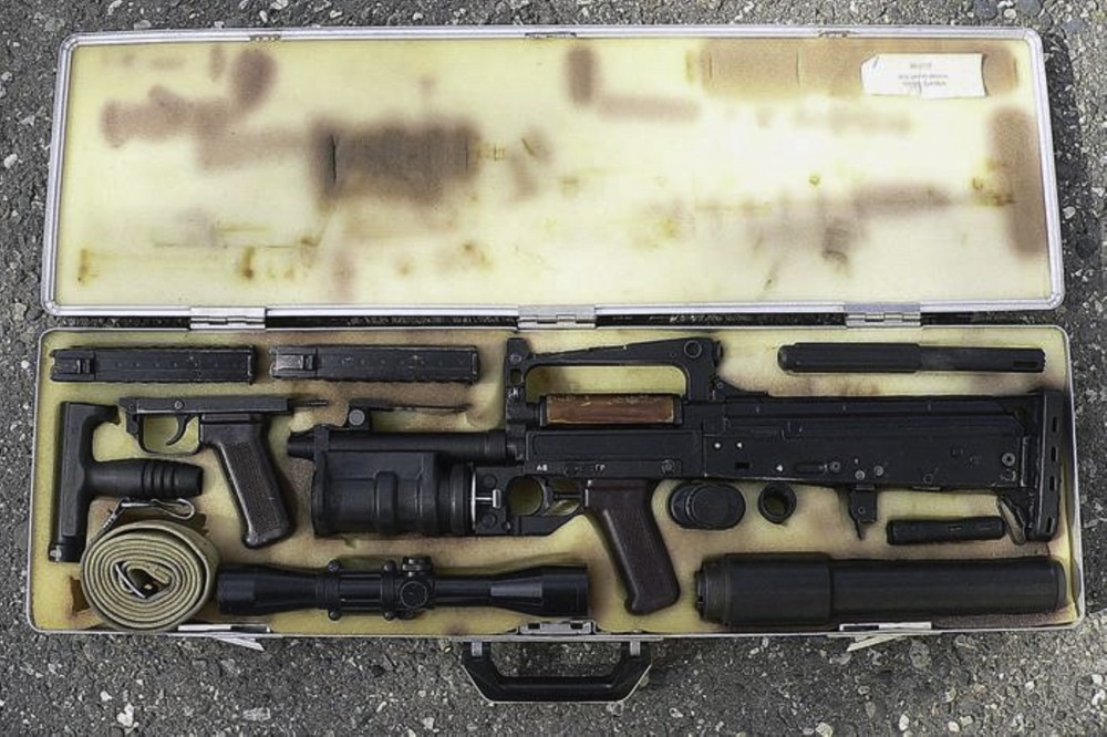

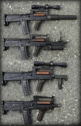

    My next project is the OTs-14 Groza. The OTs-14 Groza (ОЦ-14 "Гроза") is a Russian selective fire bullpup rifle chambered for the 7.62x39 round and the 9x39 subsonic round. It was developed in the 1990s at the TsKIB SOO(Central Design and Research Bureau of Sporting and Hunting Arms) in Tula, Russia.
    The weapon is colloquially known as OC-14 or OTs-14 "Groza". The OTs-14-4A "Groza-4" has one derivative, the TKB-0239 (ТКБ-0239), also known as OTs-14-1A "Groza-1", chambered for the 7.62x39 round. The Groza saw limited use in 1999 in the first anti terrorist campaign in Chechnya, however they quickly fell out of favor and are no longer produced.
    The weapon fires from a closed bolt and has a hammer-type firing mechanism. It has a unitary trigger; a three-position combination fire mode selector switch / manual safety on the left side of the receiver sets whether it fires either the rifle or the grenade launcher or places it in "safe". The assault rifle is equipped with iron sights contained in the carrying handle that consist of an adjustable rear aperture sight on a tangent leaf with range graduations from 50 to 200 m, and a forward post. The grenade launcher is aimed using a folding leaf sight. The weapon will also accept several optical sights, including the PSO telescopic sights which mount directly onto the carrying handle or, as on early models, onto a bracket on the left side of the receiver housing. The OTs-14-4A also has a night sight dovetail rail that will accept all standard night vision optics.

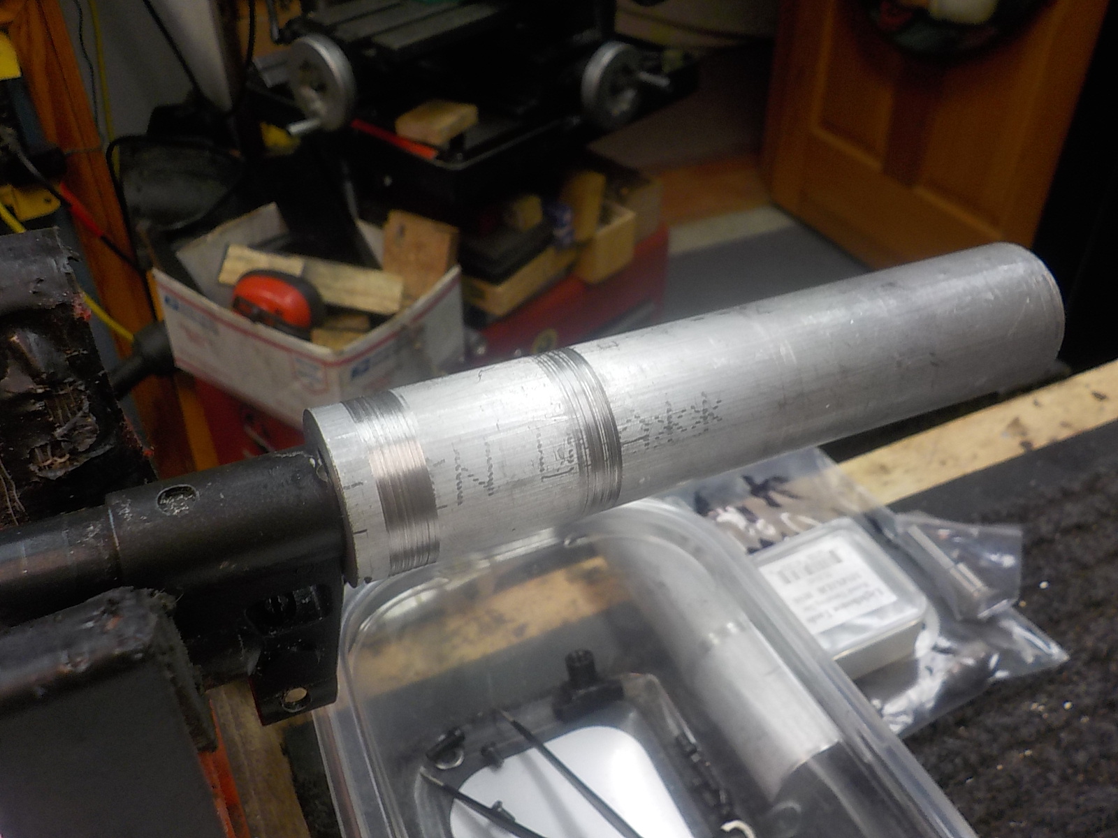

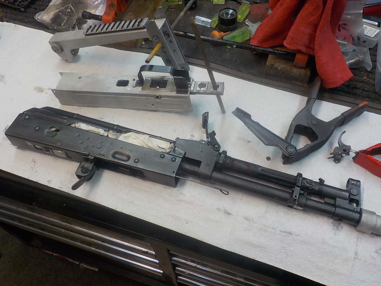

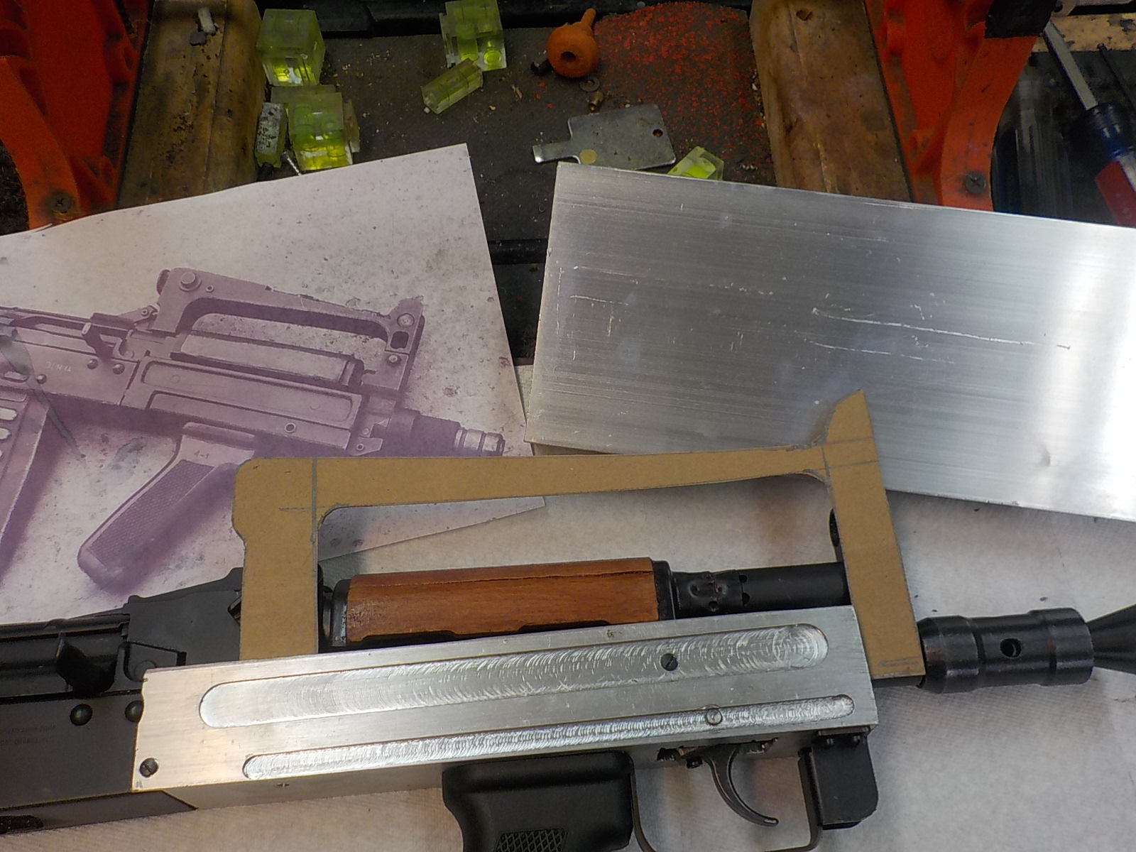

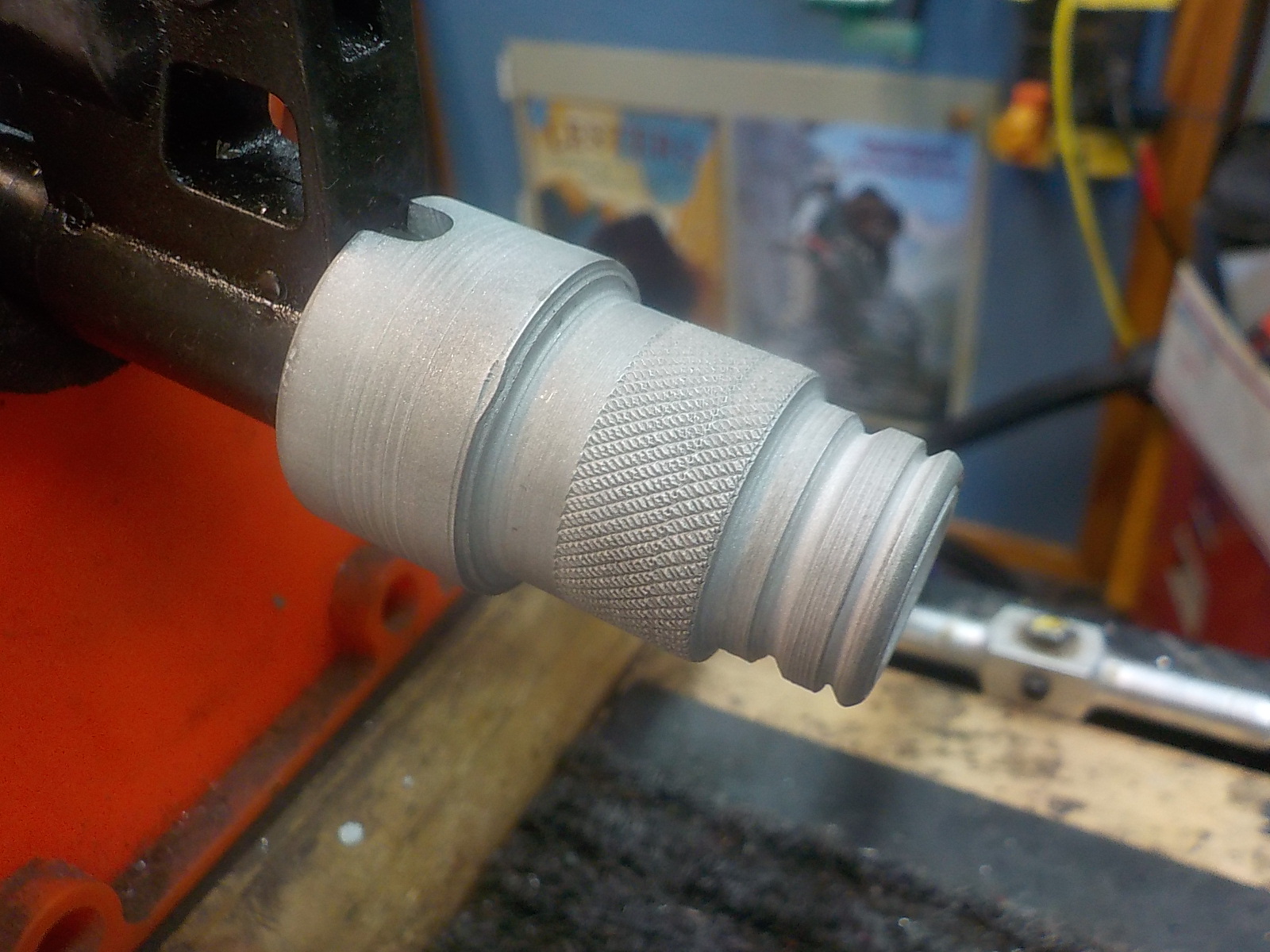

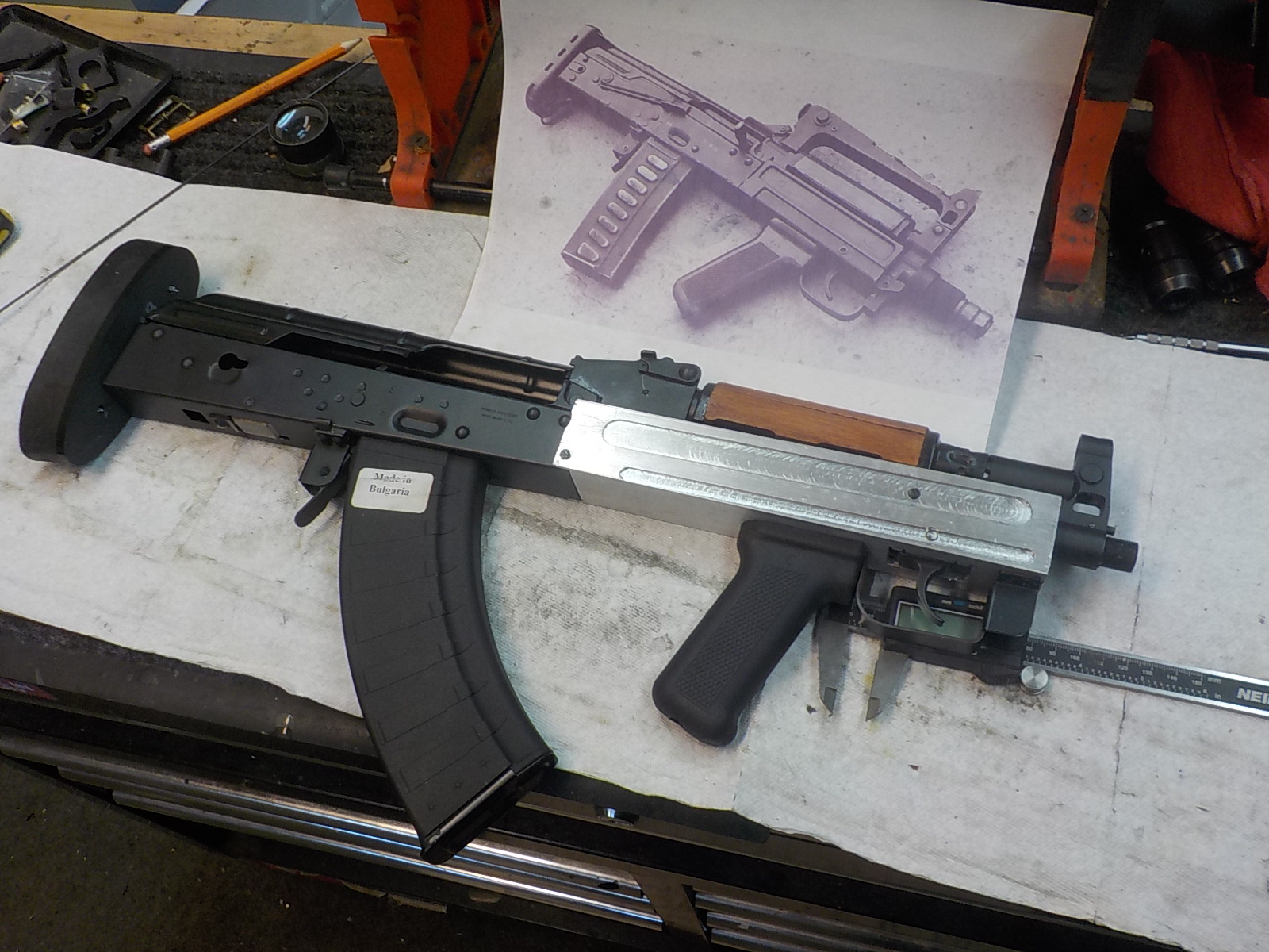

    Parts are on hand. I will convert a "hellpup" pistol into a Groza by changing it to a bullpup configuration. I'll do this by fabricating the forward fire controls from an 80% receiver. I'll fabricate the carrying handle from either a solid billet or sheet steel and turn the muzzle device on my lathe...or just use a krinkov brake. I'll probably SBR this just to avoid any problems.

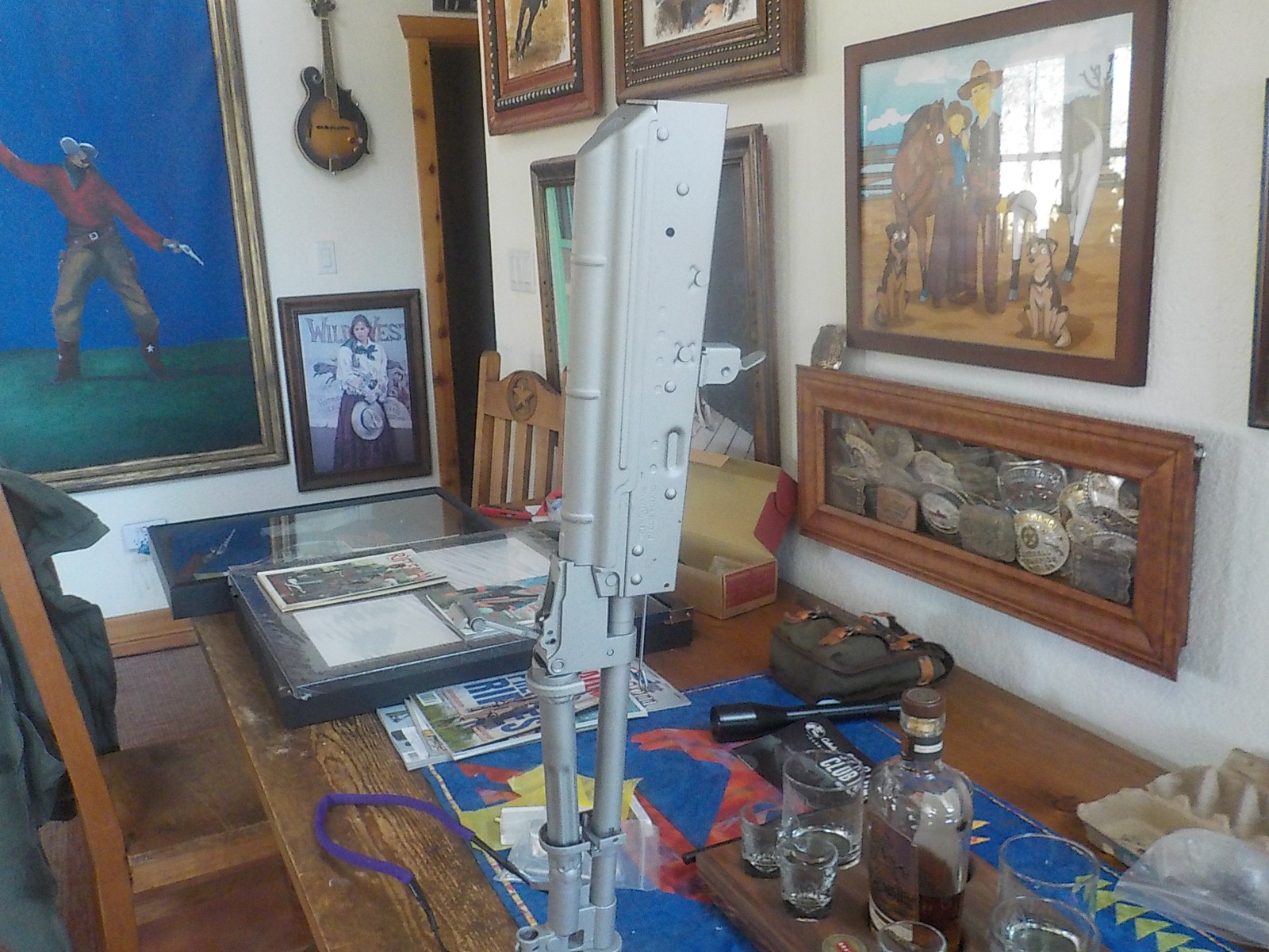

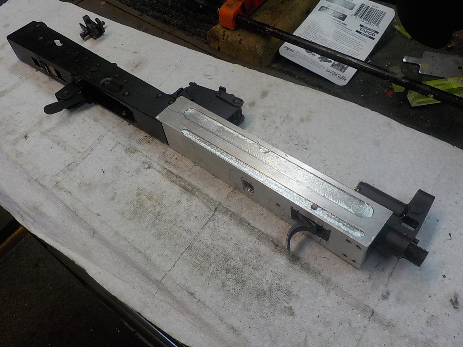

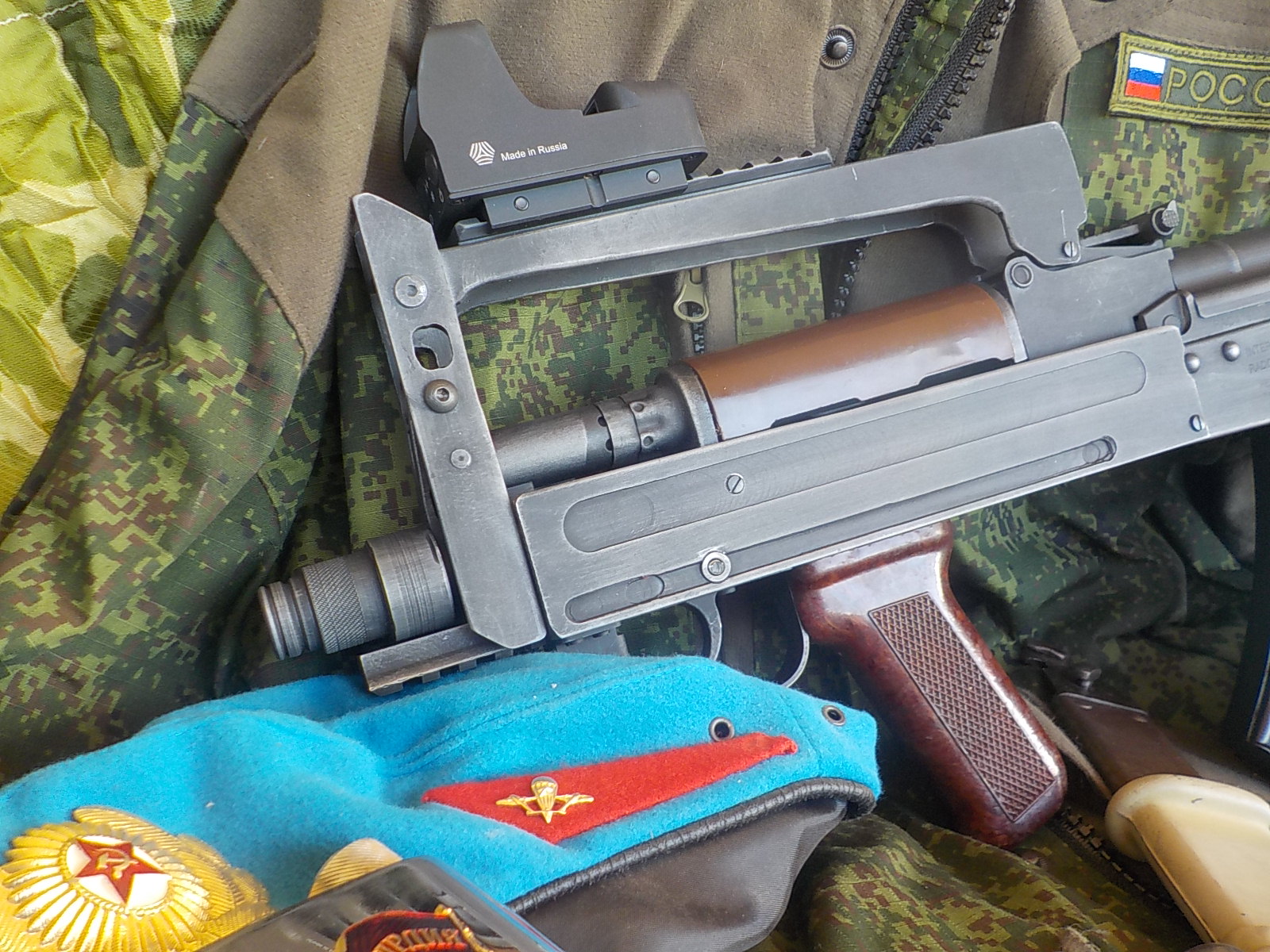

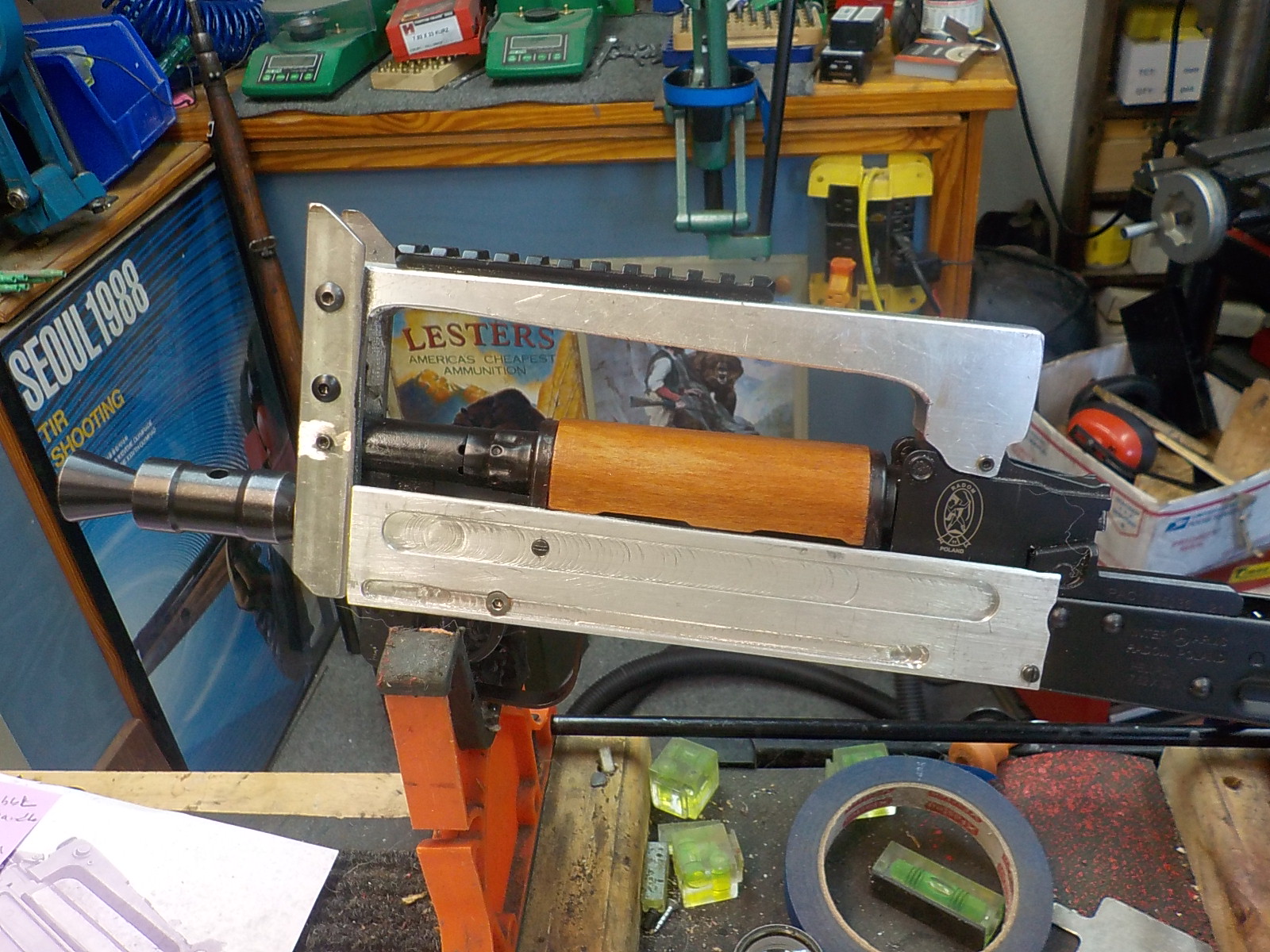

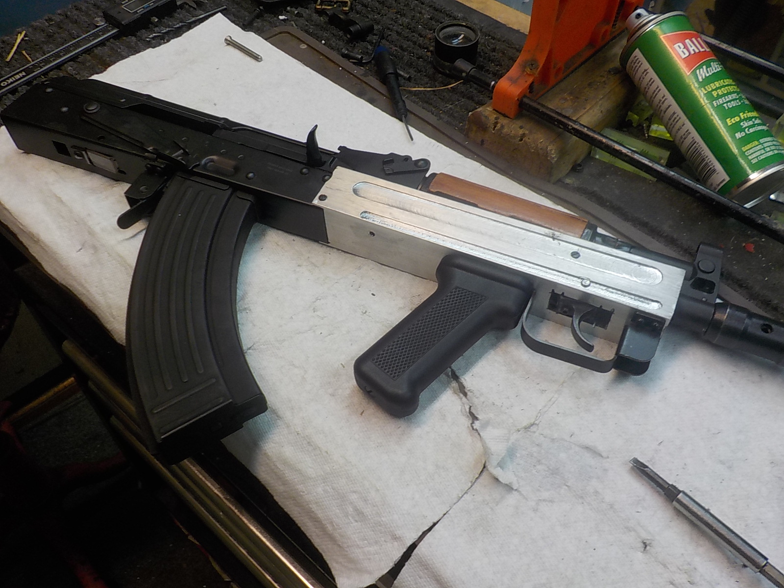

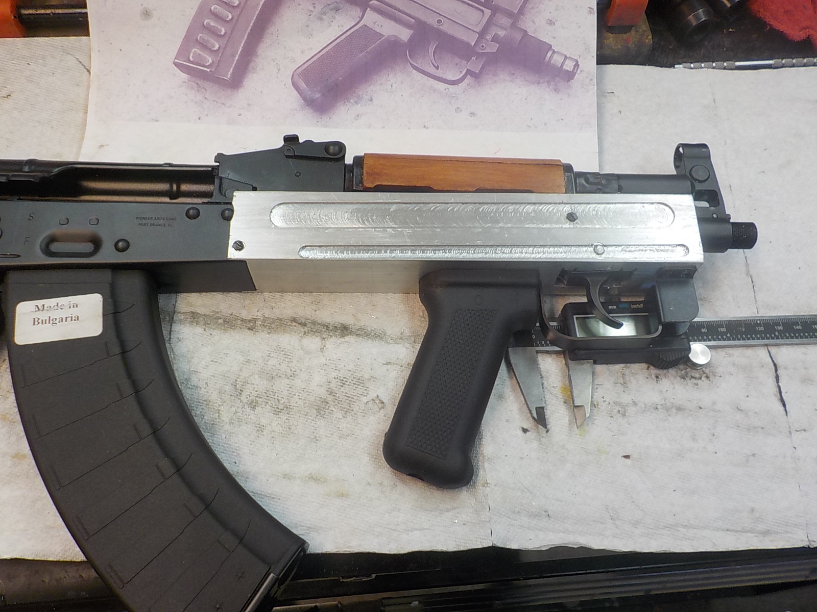

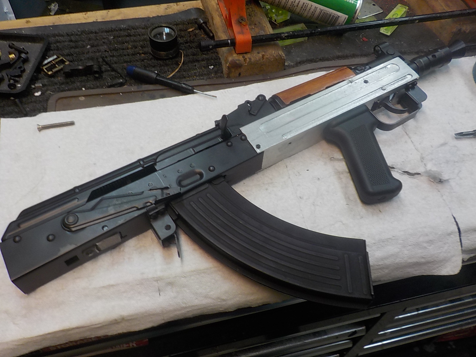

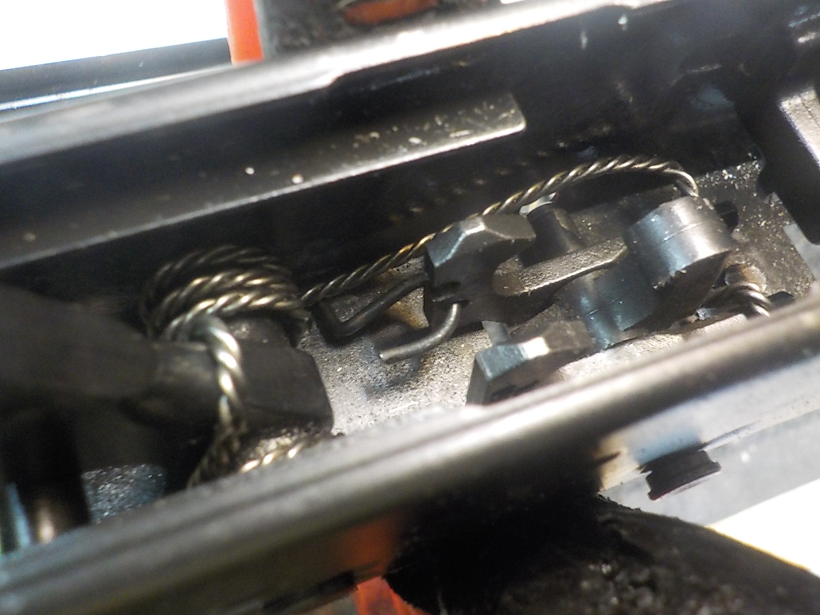

    Coming together. Fore-end, trigger, trigger guard, grip are done. Rear and front fire control is done, have to work on linkage. Need to work on carry handle/sight assembly, Muzzle brake, and buttplate (but can't attach until form one comes back. Decided to not use the 80% lower and fabricate a forend from Aluminum tubing.
    mocked up

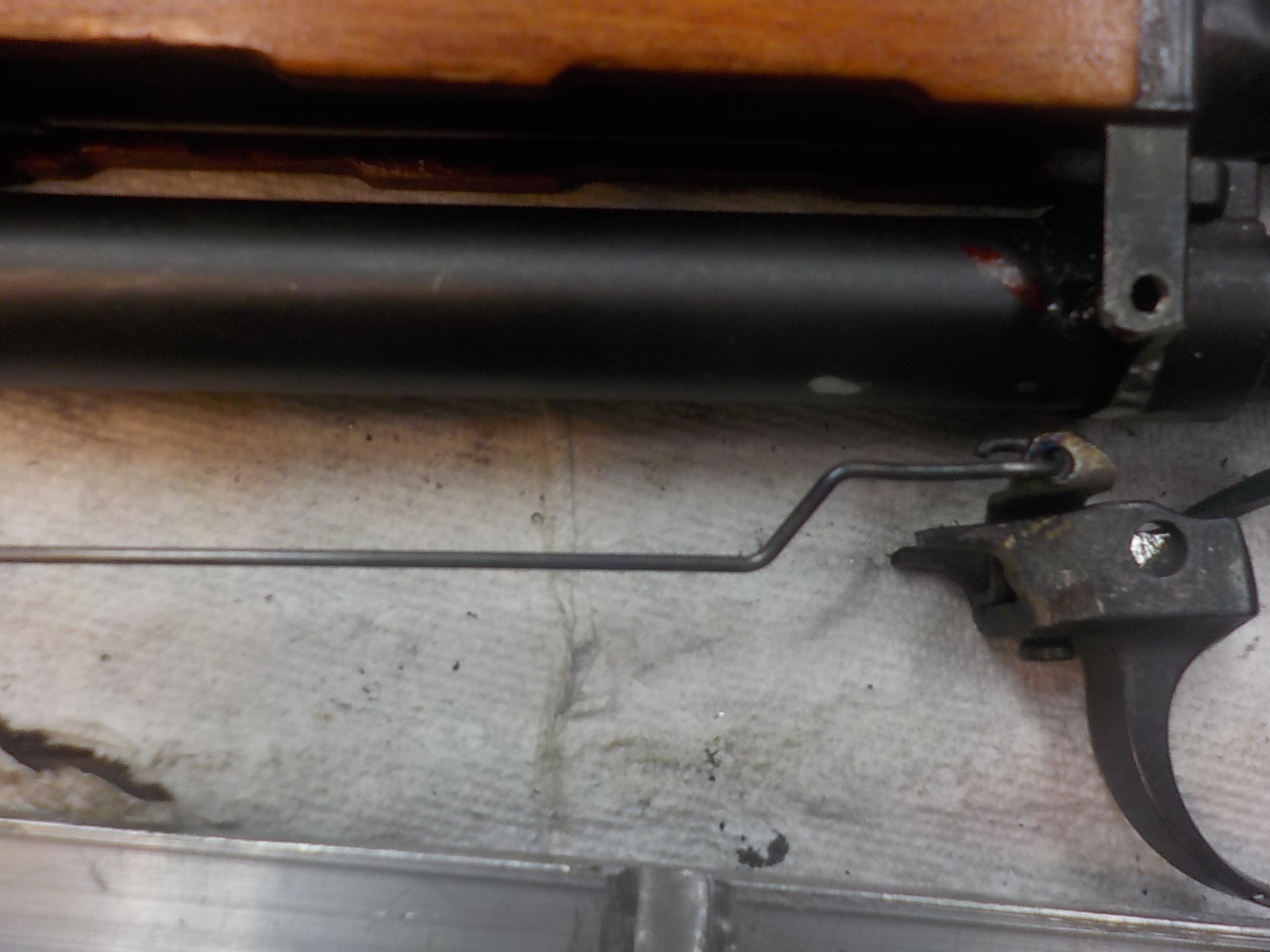

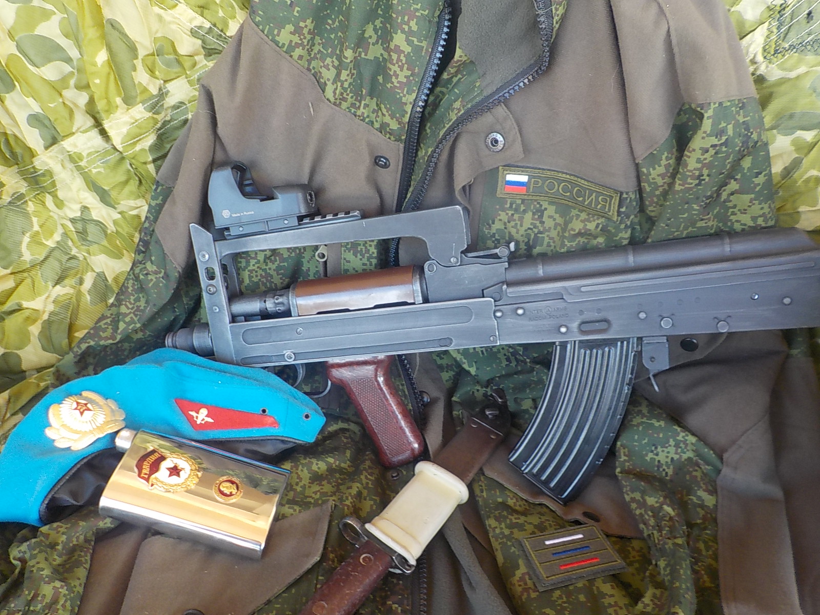

    Finished the linkage and test fired today. Pain in the ass as I anticipated but it works fine. Totally weird and unfcomfortable to fire. If you're not gettin hit by the charging handle you're busy concentrating on not blowing your supporting hand off. Unlike the original, I'll probably put some type of fore-grip on it. All that's left is more of less cosmetic. Carry handle with sight, muzzle brake, and buttplate once the form 1 comes (No fore-grip till the form 1 either).

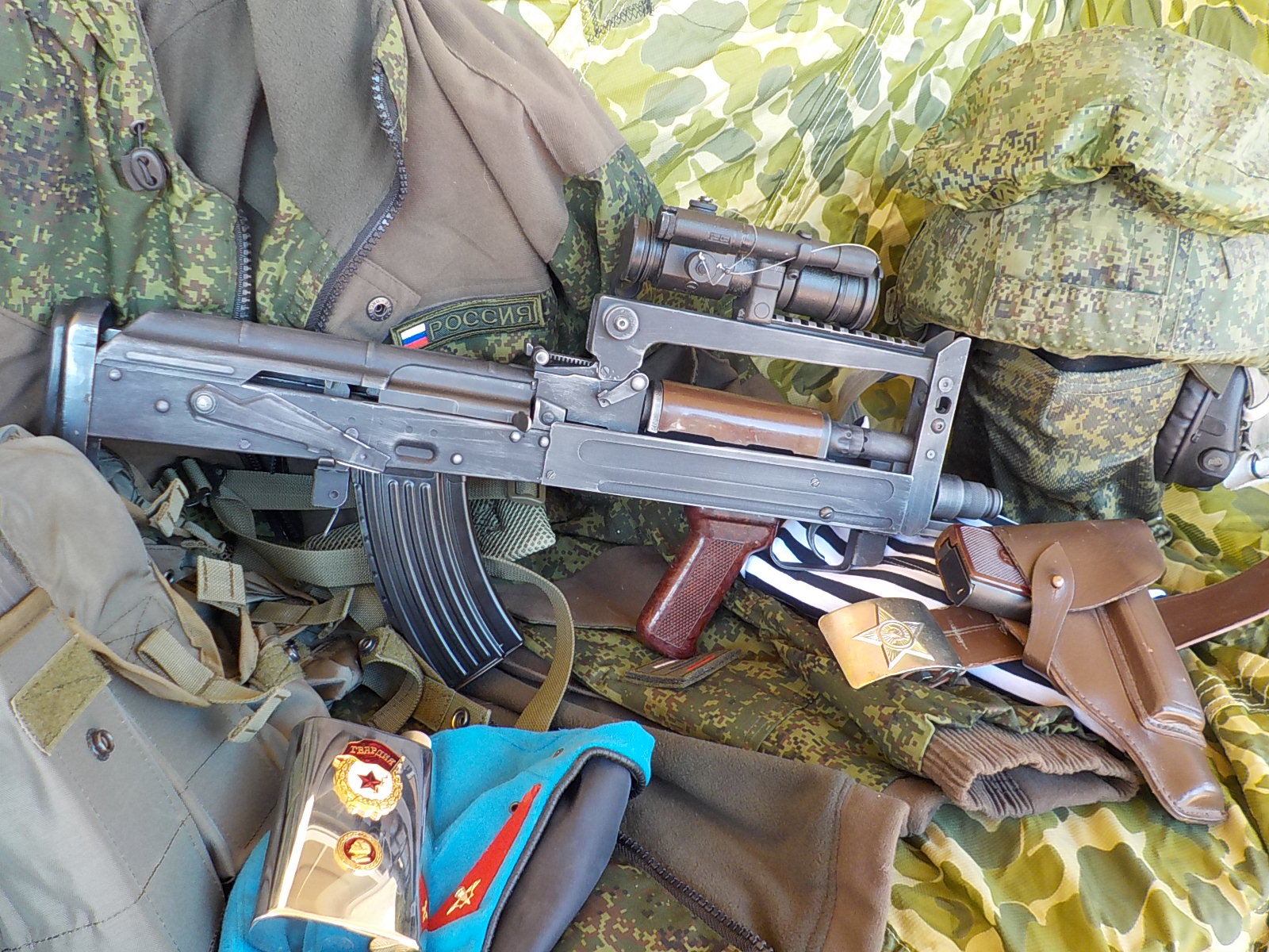

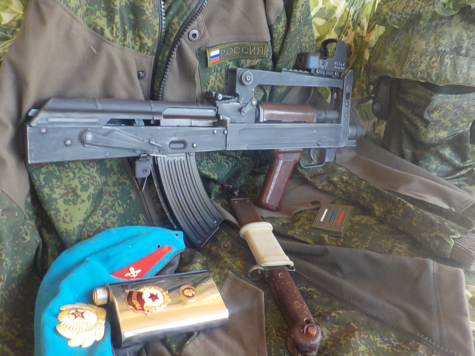

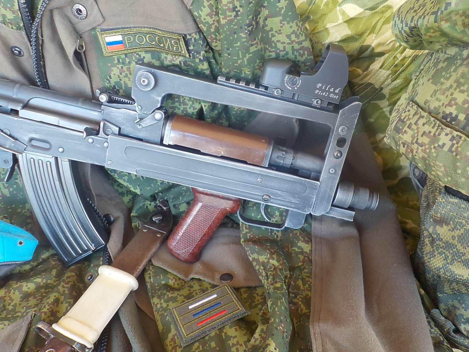

    Now for the Cerakote. I am going to do a "Battle Worn" finish.

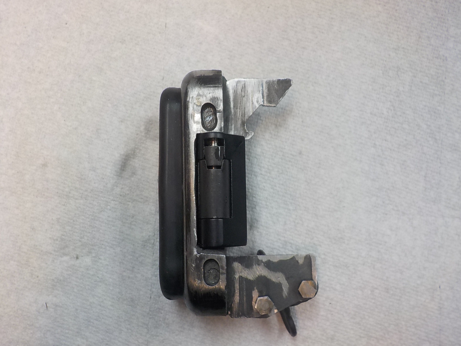

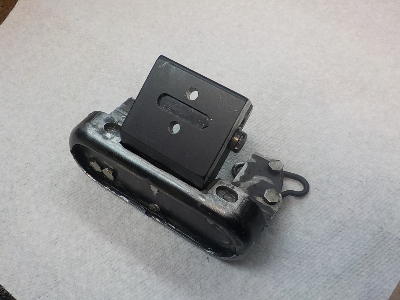

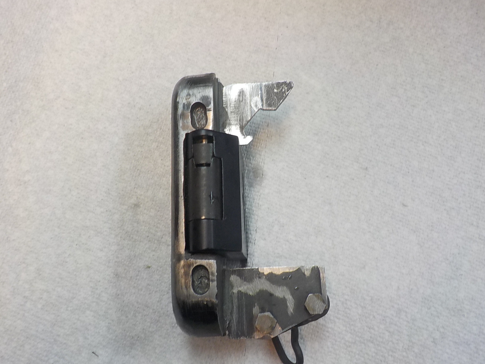

    Step one is metal prep (Note the lower part of the modified two piece trigger linkage):
    Next is the base coat of my proprietary "Bare Metal" finish.

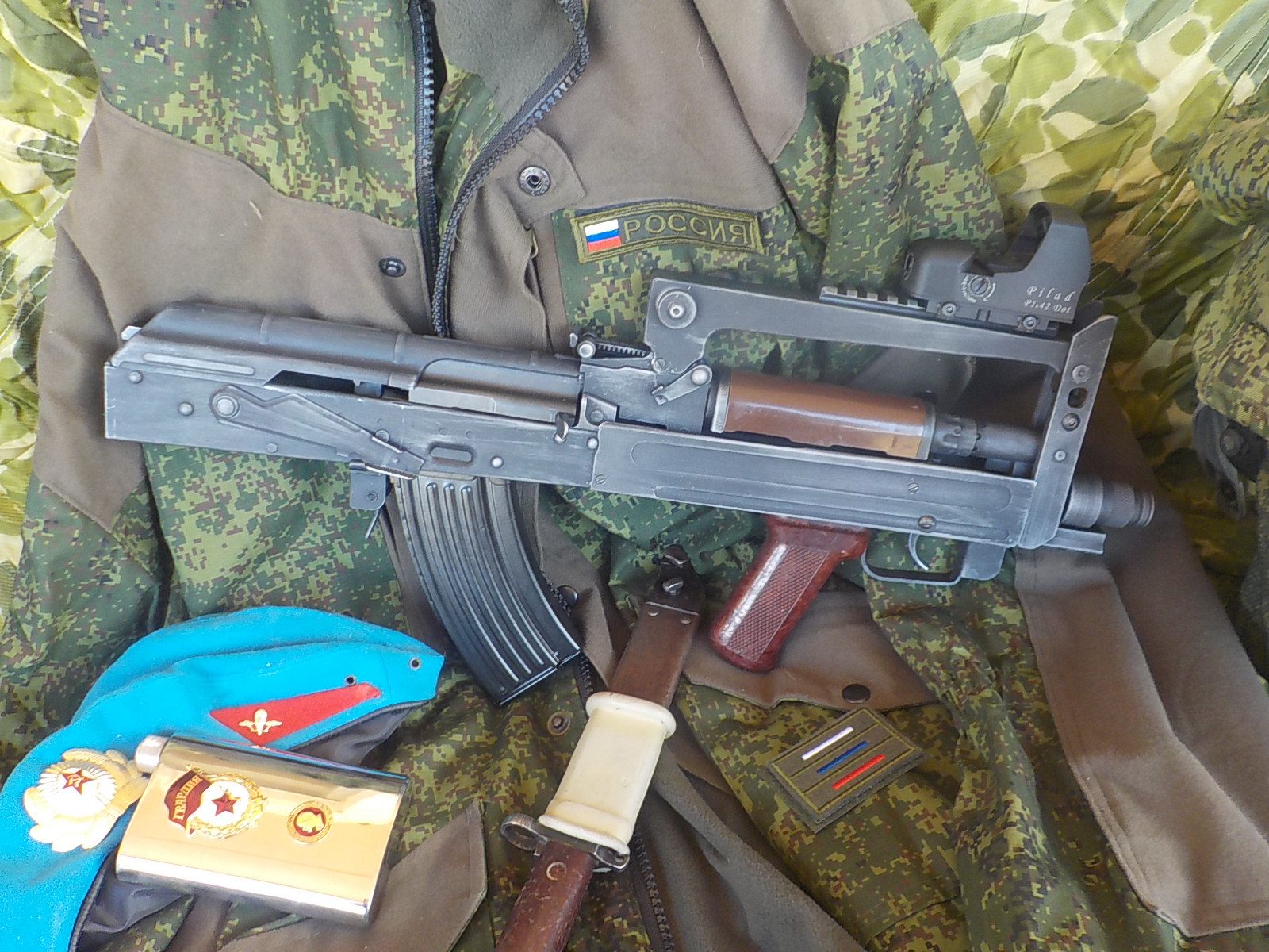

    Finally I will apply the top coat of Graphite Black. While the coat is still wet, I run a rag over the high portions to reveal the base coat of "Bare Metal". I keep doing this until I get the effect I want.

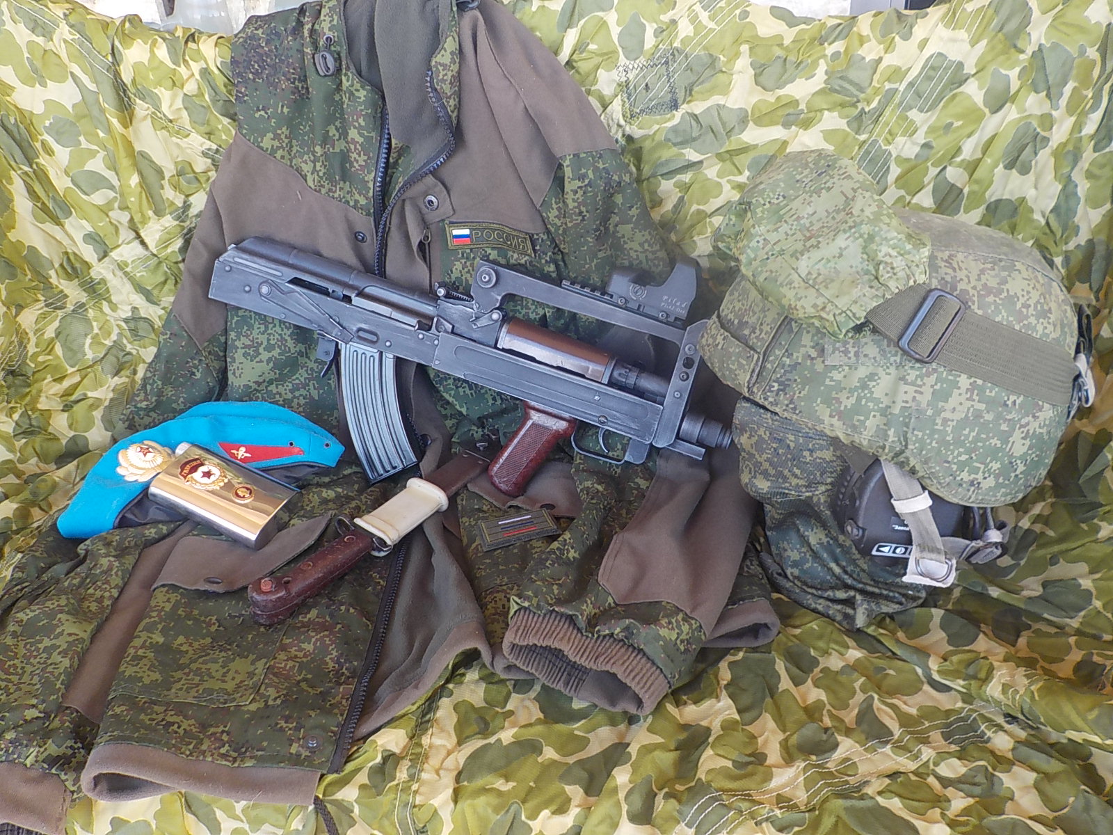

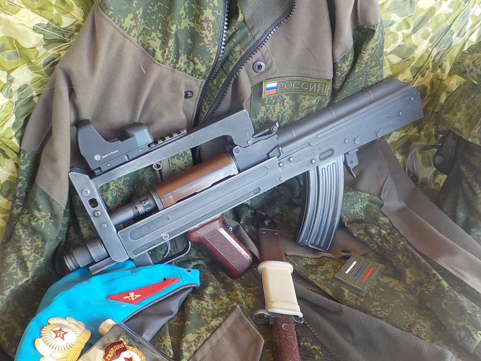

    So, now that it is complete and you have fired it, any thoughts on why it went out of favor?
    My guess is that with that shorty barrel and no fore grip, it was a perforated left hand waiting to happen...
    It is not pleasant to shoot. Easy to blow a hole in your left hand and it actually has a fairly stiff recoil. If you look at the video, I'm 6'2 and 200 pounds using an aggressive forward shooting stance and it's pushing me pretty good. With the bolt recoiling straight into your shoulder without any butt plate, or even stock, to absorb some of that impact, it is a heavy recoiling weapon. On the other hand, it is a very compact gun shooting a .30 caliber rifle cartridge.
