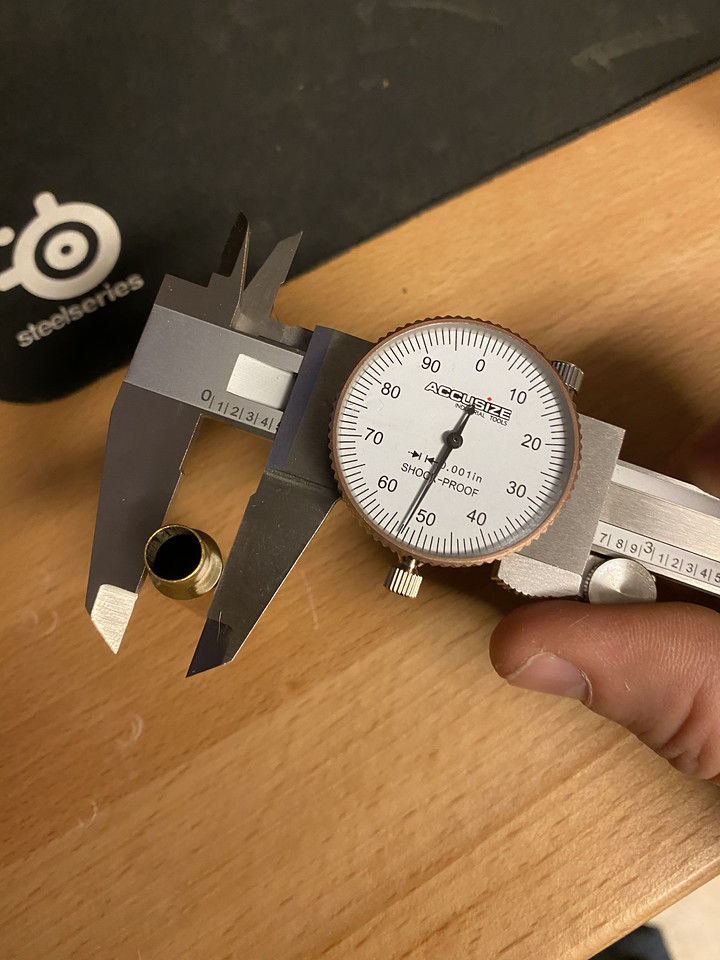

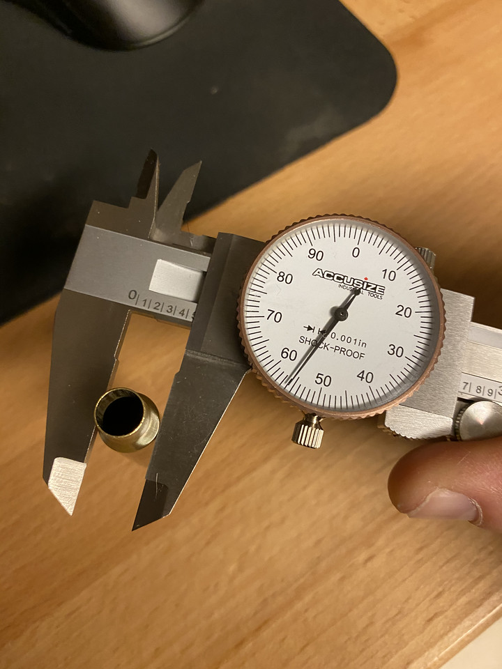

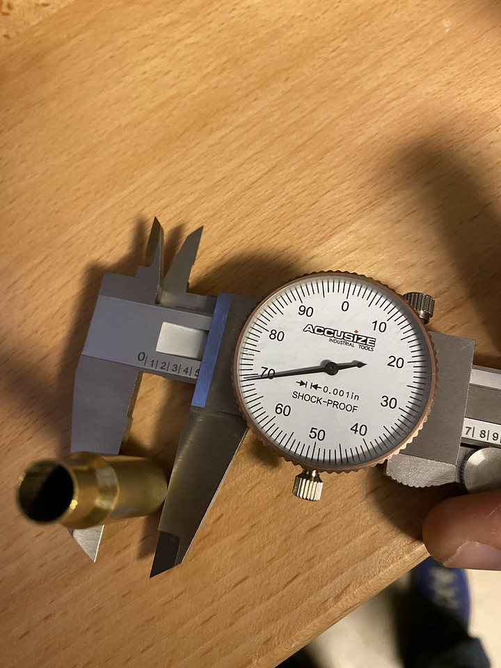

Just neck sized a 260 and seated a 130.
Sides at shoulder was .455.
It chambers effortlessly.
Ran it through a body die, sides now measures .451 and it chambers exactly the same.

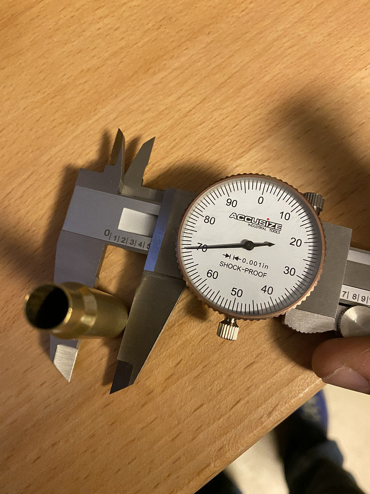

I just did the same with another fired case.
At the web line( about 1/8” above the grove edge) fired it measures .4695 and yea I know that last 5 isn’t really accurate.
Sized in my body die it consistently measures .4690 moving the shoulder back 1 thou.
Both chambered effortlessly.

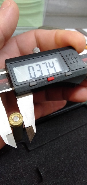

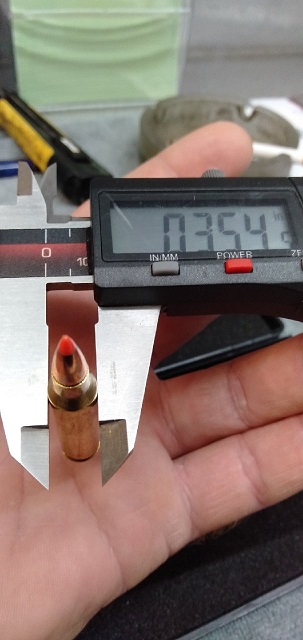

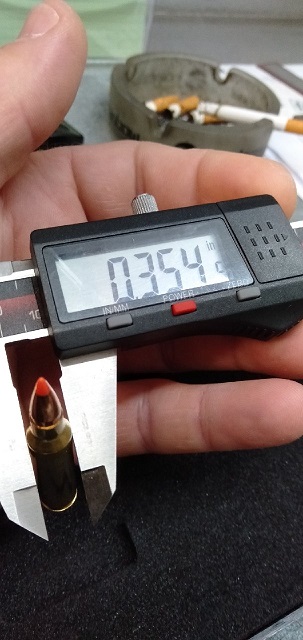

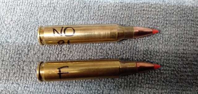

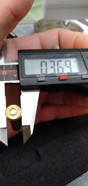

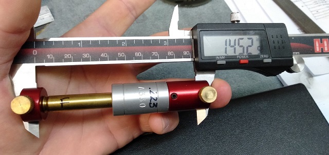

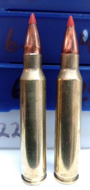

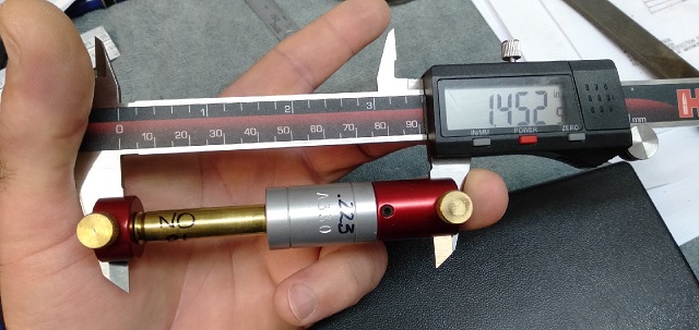

i just went and got measurements from my factory hornady tap 60gr and my neck sized only 60gr v-max rounds.
^ factory hornady tap 60gr
^ neck sized only reloads

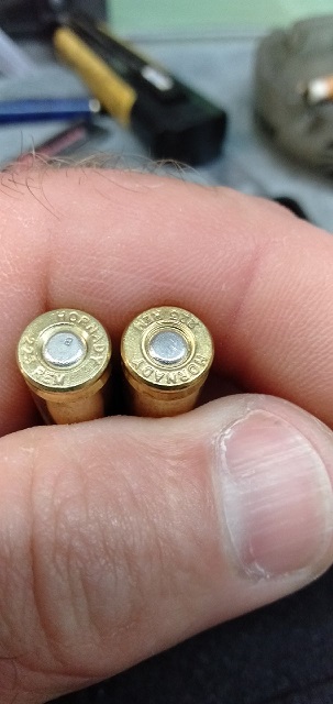

^ reload on the LEFT and factory on the RIGHT
the way i see it, if it works for me i'll do it. when it stops working i'll change what i'm doing.
maybe people need to write to the manufacturers of sizing dies and argue with them over which is right and wrong.
there is no right and wrong WHEN it works, there are only OPINIONS which are like assholes, everyone has one ;)
View attachment 7454459View attachment 7454460
View attachment 7454461View attachment 7454462
View attachment 7454463View attachment 7454464

ok, since i felt like a smoke i caved and did it just so you don't have a stressful day.
yes hornady could of done a better job with their comparator and maybe machined the hole a smidge smaller but hey, who am i to tell hornady what to do.
