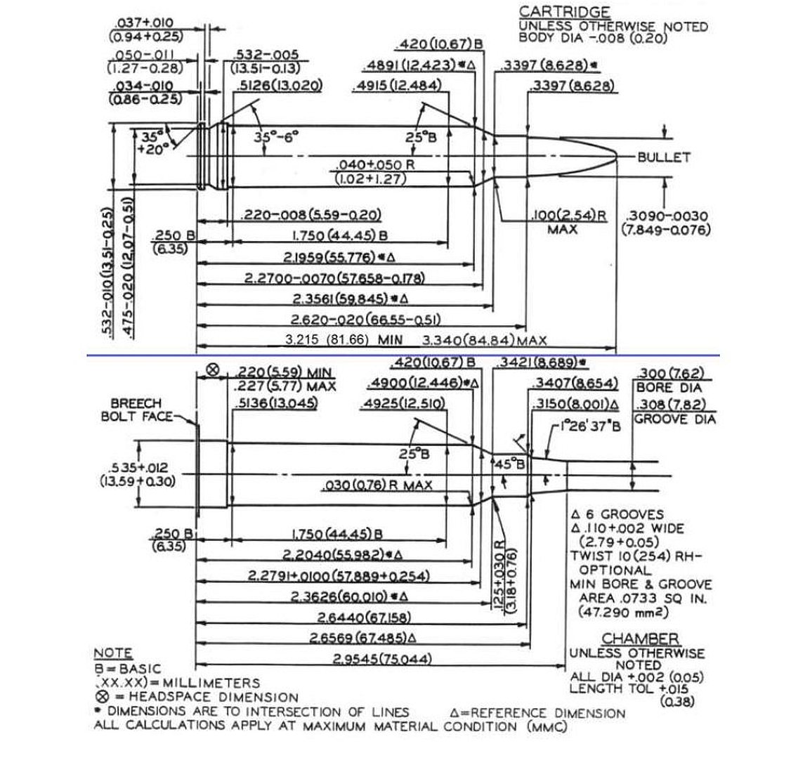

So, @kingaling and I was wondering what the -0070 means for Cartridge base to datum (.420): 2.2700 - .0070? Also, unless otherwise noted body dia. -.008 (.020)?

Those are unilateral tolerances in the negative direction. The nominal is max size and they can only be smaller by that unilateral tolerance or less.
That means you’re measuring the body diameter at 2.2630”-2.2700” from the datum.
The unilateral tolerances in the negative direction makes sense. But regarding the body diameter statement, did you mean the length? In the pic posted that measurement looks like the length from base to datum.
AND... for the body diameter noted at the top " body dia. -.008 (.020) " is that -.008 unilateral tolerances for all measurements that don't give one (lengths and diameters) or strictly for the cartridge diameters only?
You measure the body’s diameter, at that length.
Any tolerance not denoted on the dimension itself will fall under GD&T. General Dimensioning and Tolerancing

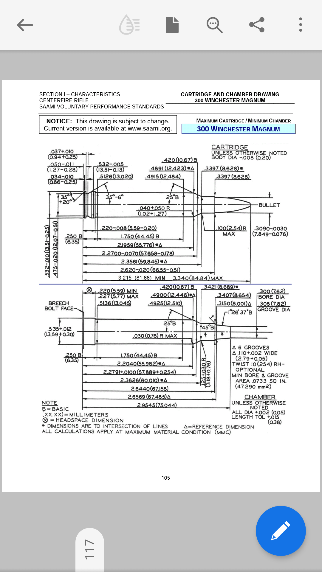

Yeah, don't think that is the whole SAAMI page for the 300 WM.
According to the pdf i downloaded from the saami.org site, that pic leaves nothing out for that cartridge except for maybe at the very top where it says "MAXIMUM CARTRIDGE / MINIMUM CHAMBER", which explains why some of the measurements are noted with a "-" and some are noted with a "+" between the numbers.
Edit: DOH! Just saw your updated pic.

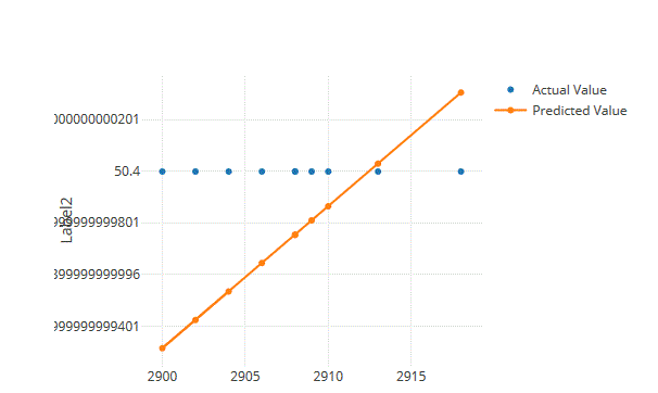

This is not for or against neck sizing but only to show how those stupid stats are misleading. Here I used a Lee Collet die loaded at 50.4 grains +/- .1 gr. I have an AVG= 2907, SD= 5 and ES of 18. Population was 50 and I just picked 10 out of the case for a sample. I know small population but it is a large sample regardless of the fact this is sort of random rather than statistical selection. Got similar results using a Lee FL die bumping shoulders. So, not bad using entry level shit. Groups look good except for one odd fucking thing. More often than not at least 20% of 5 shot groups have holes outside the one ragged hole and these are not outliers or pulled shots and groups average about .4-.5 moa. AVG, SD and ES are statistical calculations. Well, so is regression (least squares). Below are my 20%ers. Probably why the pros use the best competition equipment, including dies, to compete. Will I ever spend that kind of money to get these groups down to .25 moa. I doubt it. This is also why eyeballing OCW and related load devleopment is such fucking bullshit. You can do the same type of analysis during load development to see some "node" a member picked out for you based on pictures is total garbage.
The problem with low velocity spreads is that at a certain point, we are no longer testing our loads. We are actually testing the chronograph. These results more than likely reflect that.
Few chronographs are actually capable of accurately measuring within 20 FPS.
We did a test a few weeks ago where we shot through several chronographs at the same time. There was a Magnetospeed, a Labradar and a light curtain model... cant remember the brand. The consistency we are lead to expect was just not there. At one point there were discrepancies of 100 FPS between units, then we would try a different load and then they would get closer.
At first it looked like one was consistently faster than the other, but then that reversed and the other one was faster for a while.
It's frustrating when we spend good money on such equipment only to find that it just does not work as advertized.
