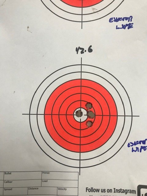

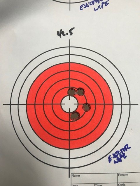

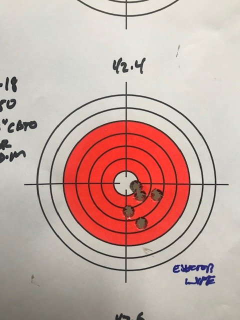

Just to add.. I looked at my groups from today . First round hits from 42.2, 42.3, 42.4, 42.5, 42.6 are touching the POI. Of those groups, 42.4, 42.5 and 42.6 are clustered closest to the POA. All those grains however showed signs of pressure.

Here are the three targets that were closest to POA. As mentioned I'm sure I could have tightened up the groups more had I had feeling in my finger. It was COLD this morning. 5 shot groups. I was also shooting off a bench that is too high for me table top wise. I have to set my Atlas bipod with the legs 45 degs forward to lower it.

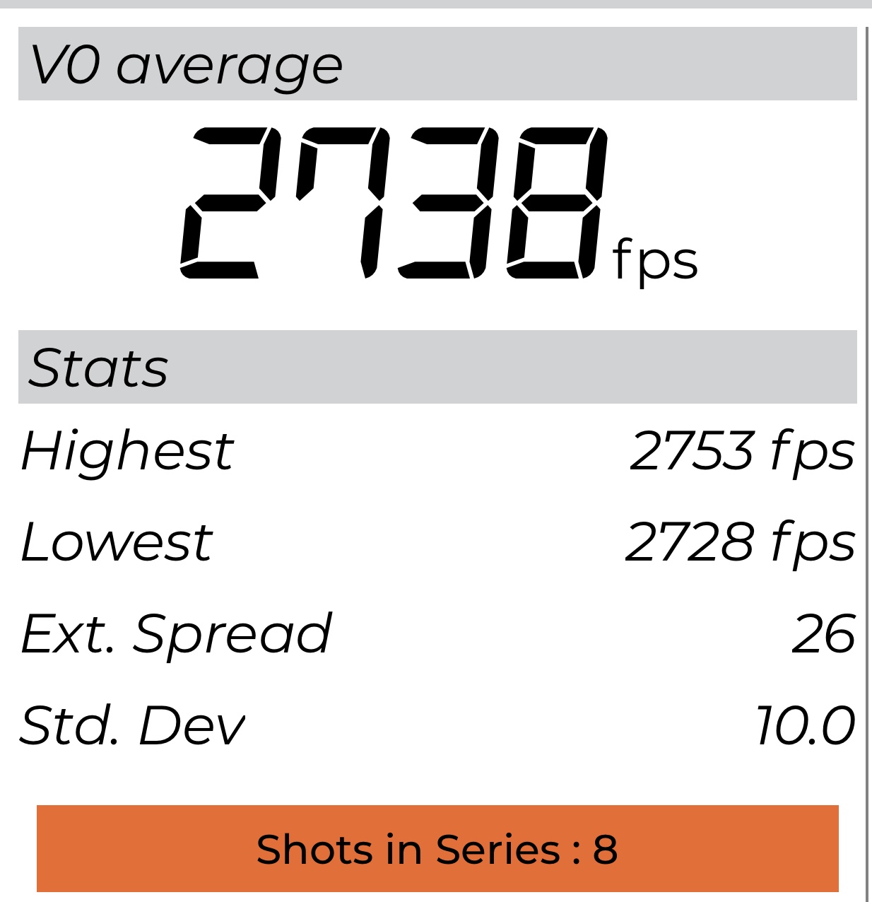

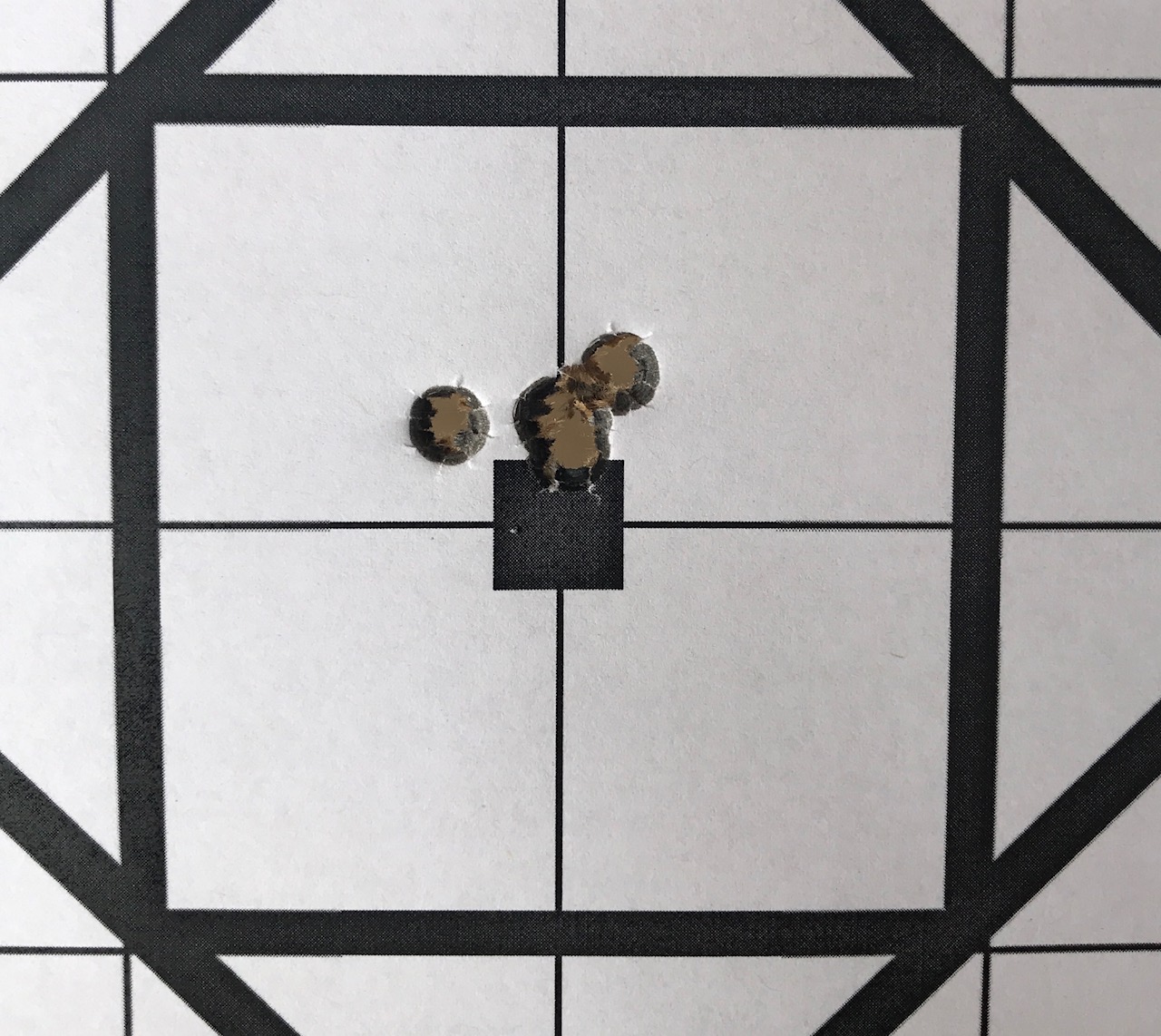

Loaded up a few and here's what I think I'm settling on but I'm not sure about the speed.
41.7gn H4350
2.19" BTO
4x fired Hornady brass w/ ghetto unscientific annealing
210M primers
140gr ELD-M
24" Bartlein barrel with a TBAC Ultra 7 6.5 can
The test target was 5 rounds. Including the pulled one it's about half inch. Not counting it the group is about 0.28". I got 10 rounds through the LabRadar but two did not register. Is this too slow to you guys?
