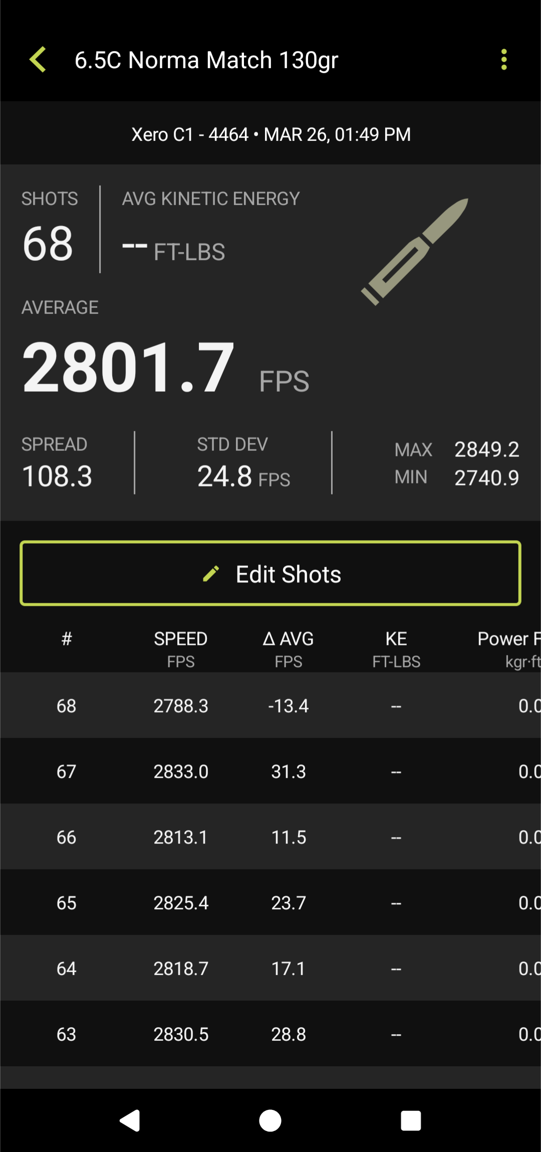

Factory SD/ES not good with my examples. Shoots decent(1moa+/-) good in one of my barrels around .7moa.
I couldn't get much better than 1moa or slightly under in my current barrel reloading the 130s. They do best when jumped a good bit, which is how the factory rounds are loaded.
I bought a couple thousand at .23 a bullet so we'll see on the next barrel.
