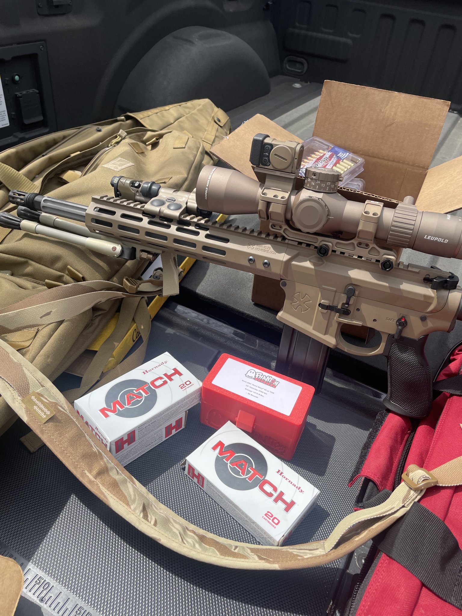

Just showed up today, I’m looking forward to trying it. This will be my first experience with the 6mm ARC.
Have you had a chance to try this out yet?

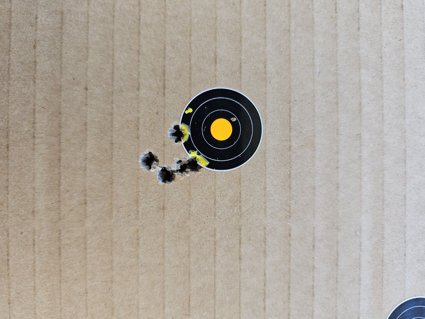

I took it out for the first time on Saturday, I had some Nosler 95gr bt’s on the self that I used for break-in, starling brass, and 29.0grs of CFE223.
Once I got used to the feel of the rifle it printed a few groups that were sub moa, and one that were all touching. I’m not much of an AR shooter so I’m pretty impressed. With real load development it think it will be a solid shooter.

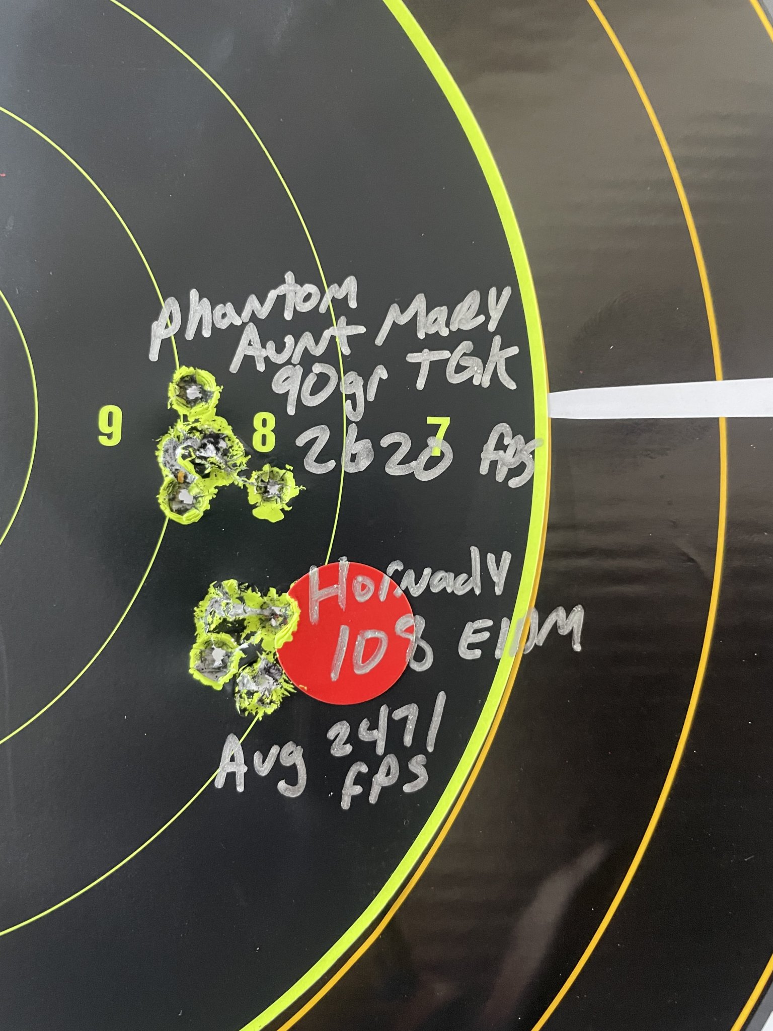

My 18” 6arc tightened up a bit the second outing. Was getting around .8 - 1.1” 5 shot groups with factory Hornady 108’s prone from a bipod and rear bag. I’ve got about 120rds on it now and probably get out to shoot it again next week. Haven’t decided yet if I should give it a cleaning at this point yet wait till after this next trip to the range.

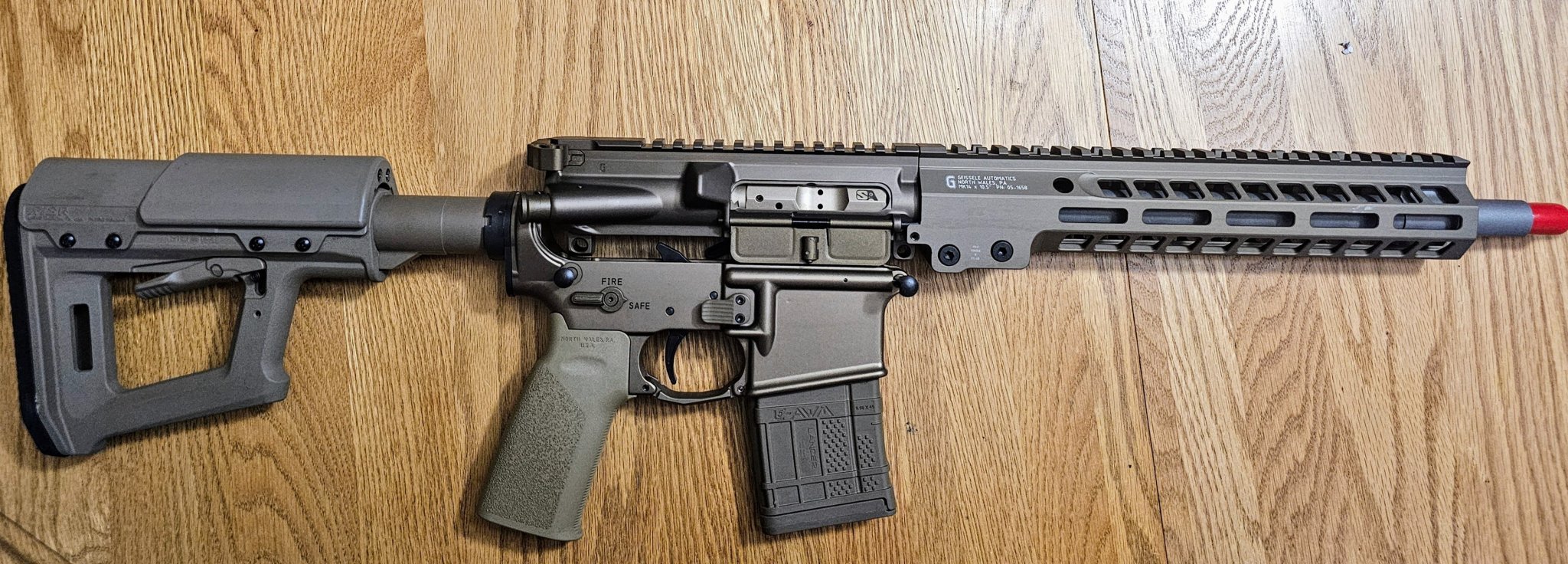

I did the final assembly of my upper with DDF barrel over my lunch break today. Man, that gas block pin is a pita. I have two 11.5" SS Noveske barrels that I've changed uppers and handguards on and neither was as bad as this one.
I probably won't get to shoot it until Monday. If all goes well next week with zeroing and seeing how my developed loads work in it, it will see it's first gas gun match next Sunday.

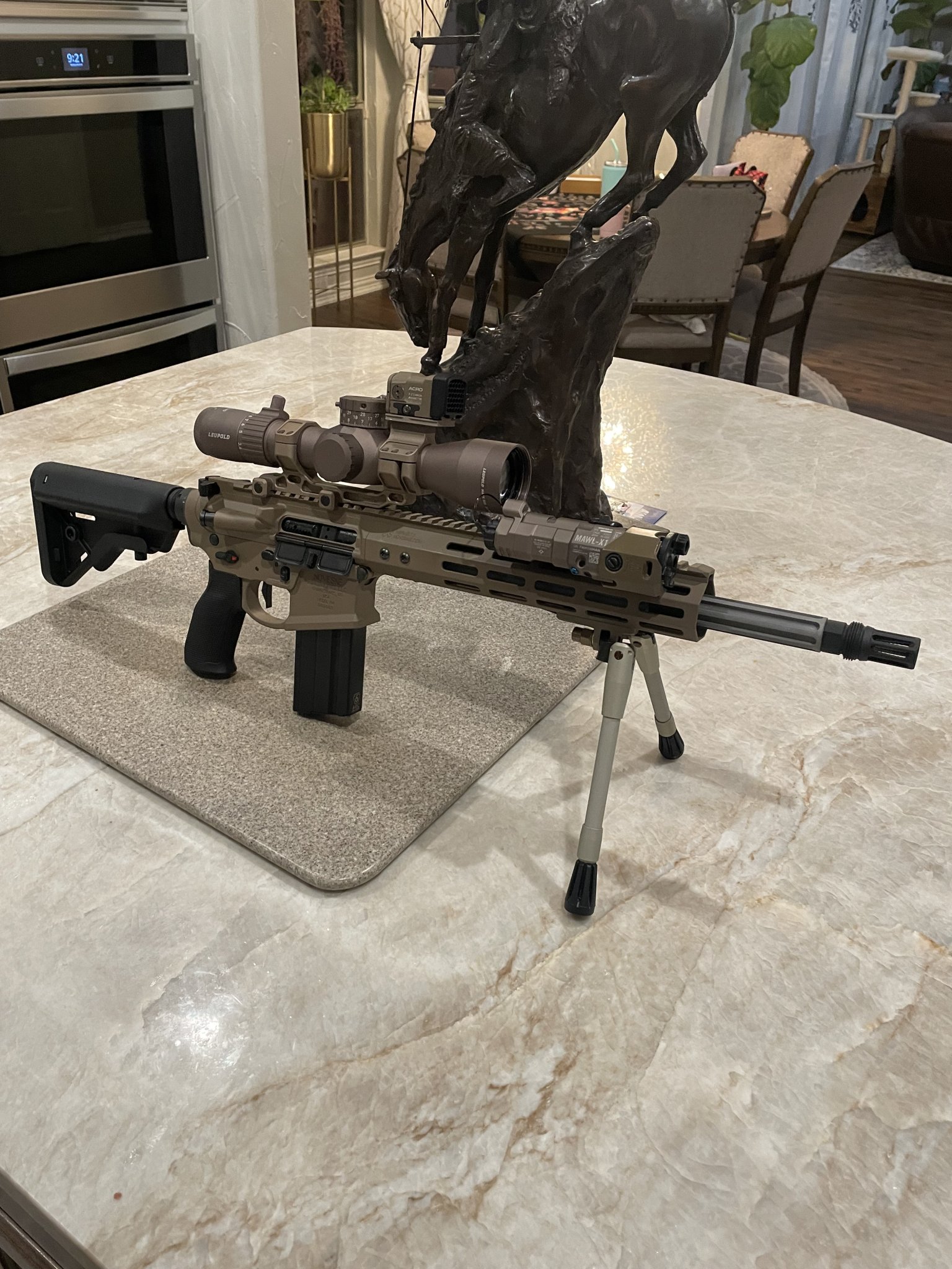

This was just a pic prior to final assembly and just getting everything fit up. Also gotta rob a SF MB from another rifle to put on this one. And baint it.
.73 MOA mean value, I’d be happy too and you’re not broken in or fine tuned. Could be a half MOA gun or close enough to claim it.

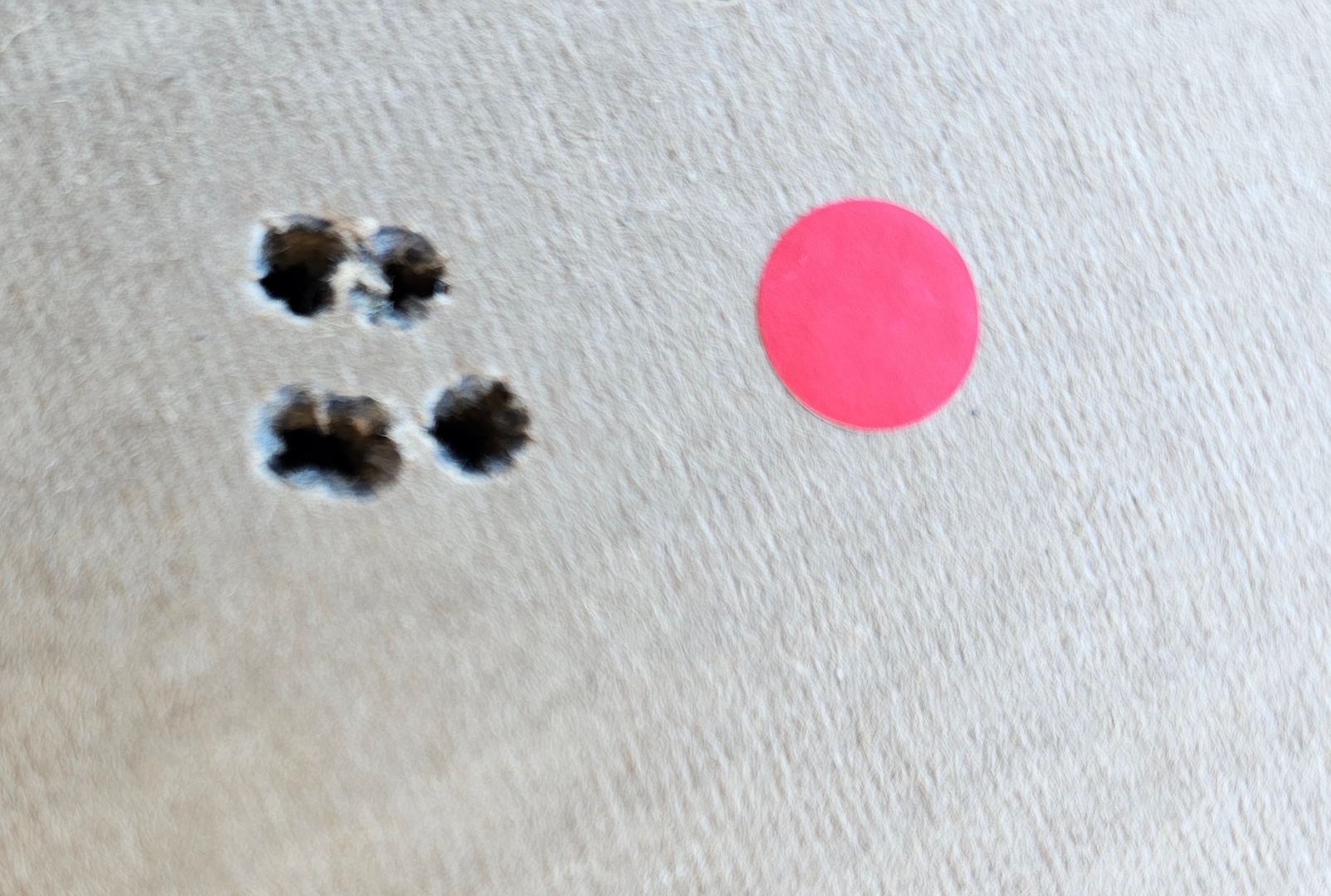

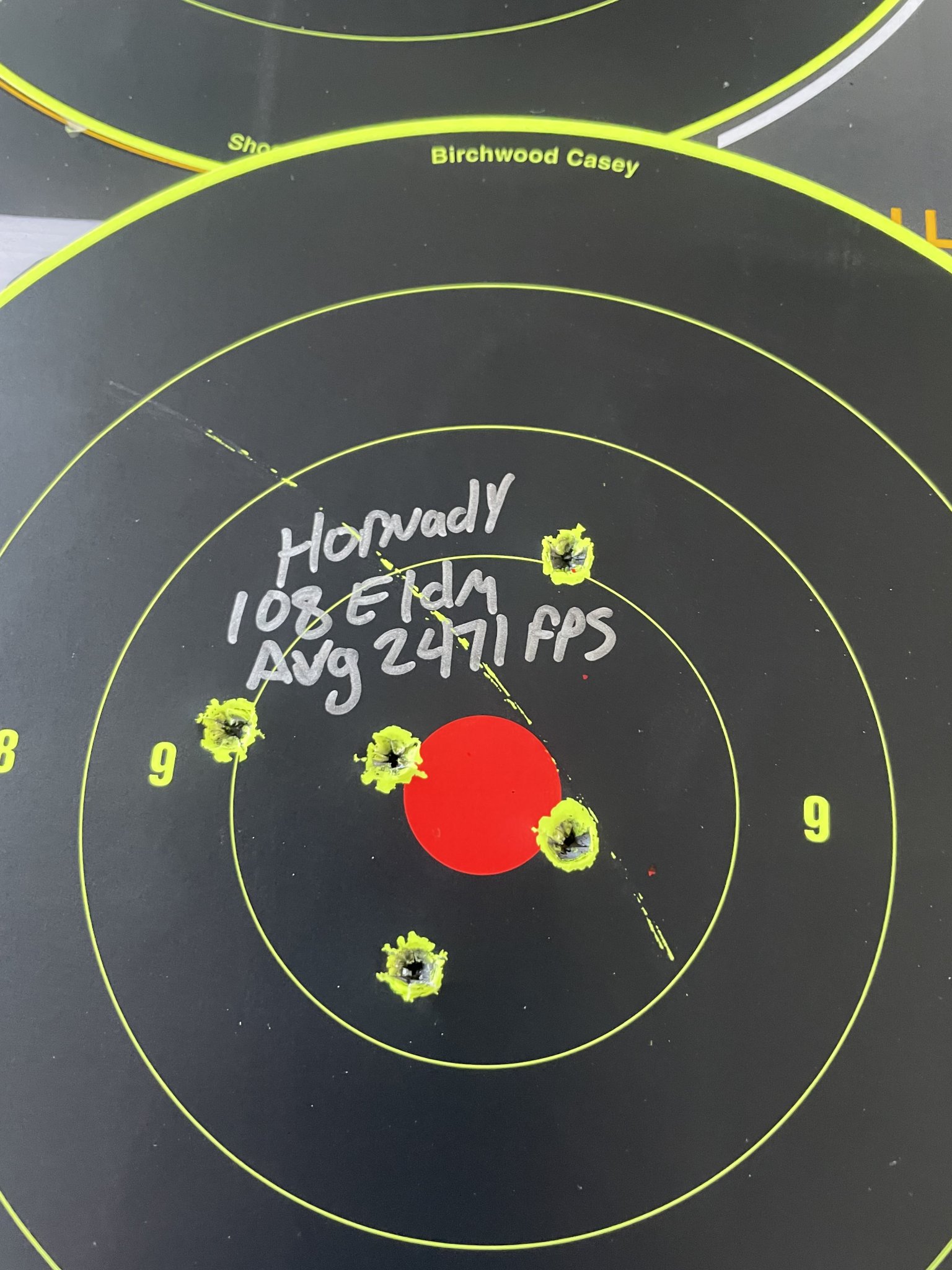

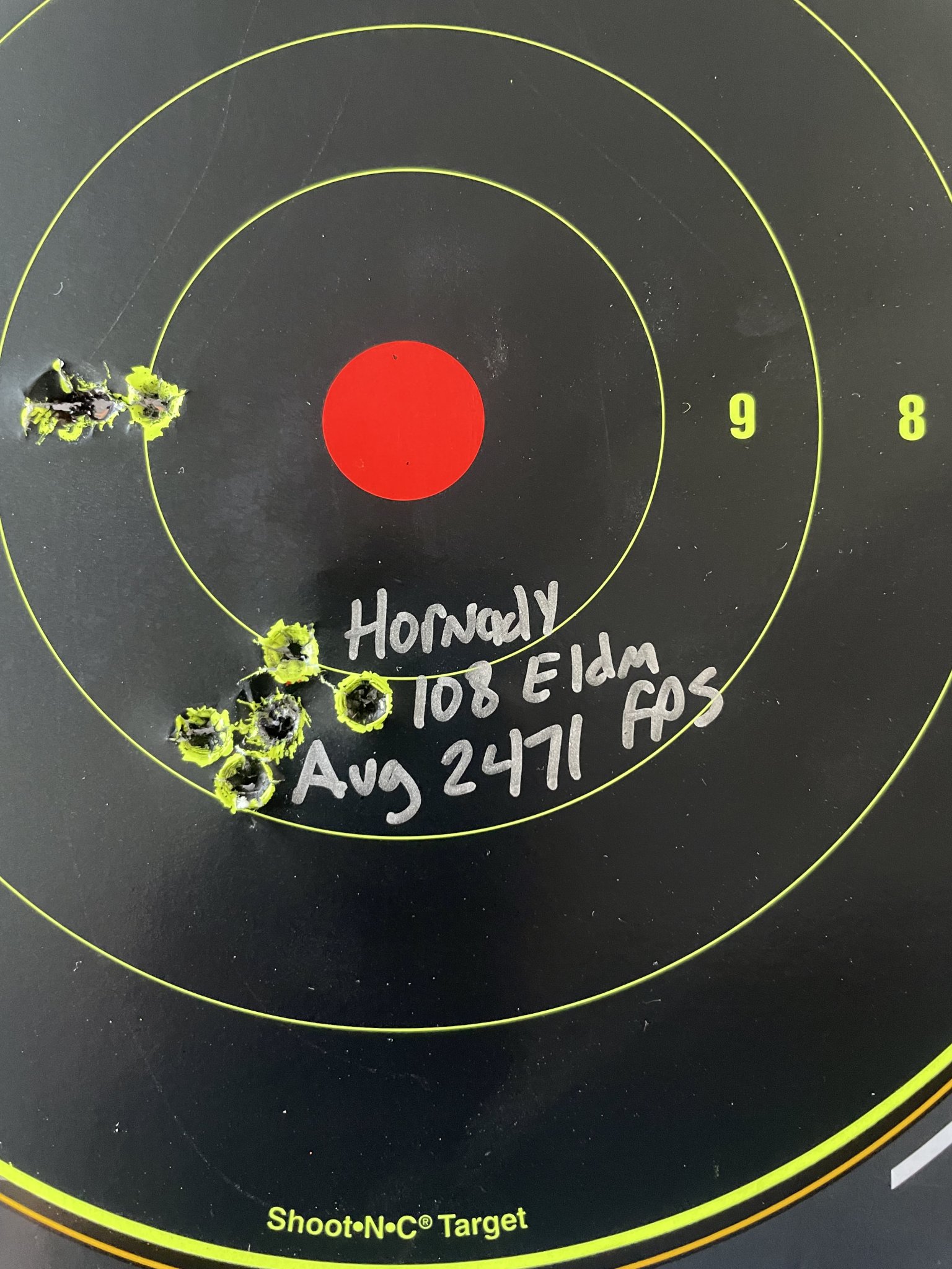

I've managed to get out to the range twice this week after work with the 2nd Noveske DDF 556. It shoots about as good as the first one, .8moa for 5-shots and 1.3moa for 10-shots. Not as wonderful as I was hoping honestly but probably a bit more consistent without the seemingly random flyers.
I have exactly 142 rounds on it now. Going to give it a 'new barrel' clean today and I'll be ready for some real tests this weekend with 77gr SMK, 73gr ELDM, AA2520, N135, and maybe some H322 or CFE223 if I get that far. I really need to get some 8208XBR and TAC jsut to see what the fuss is about.
I tried all of my suppressors with 10-round groups (AAC M4-2000, Griffin Recce5, and AAC Mini4, all with Griffin Taper mounts) and the Mini4 seemed to group the best.

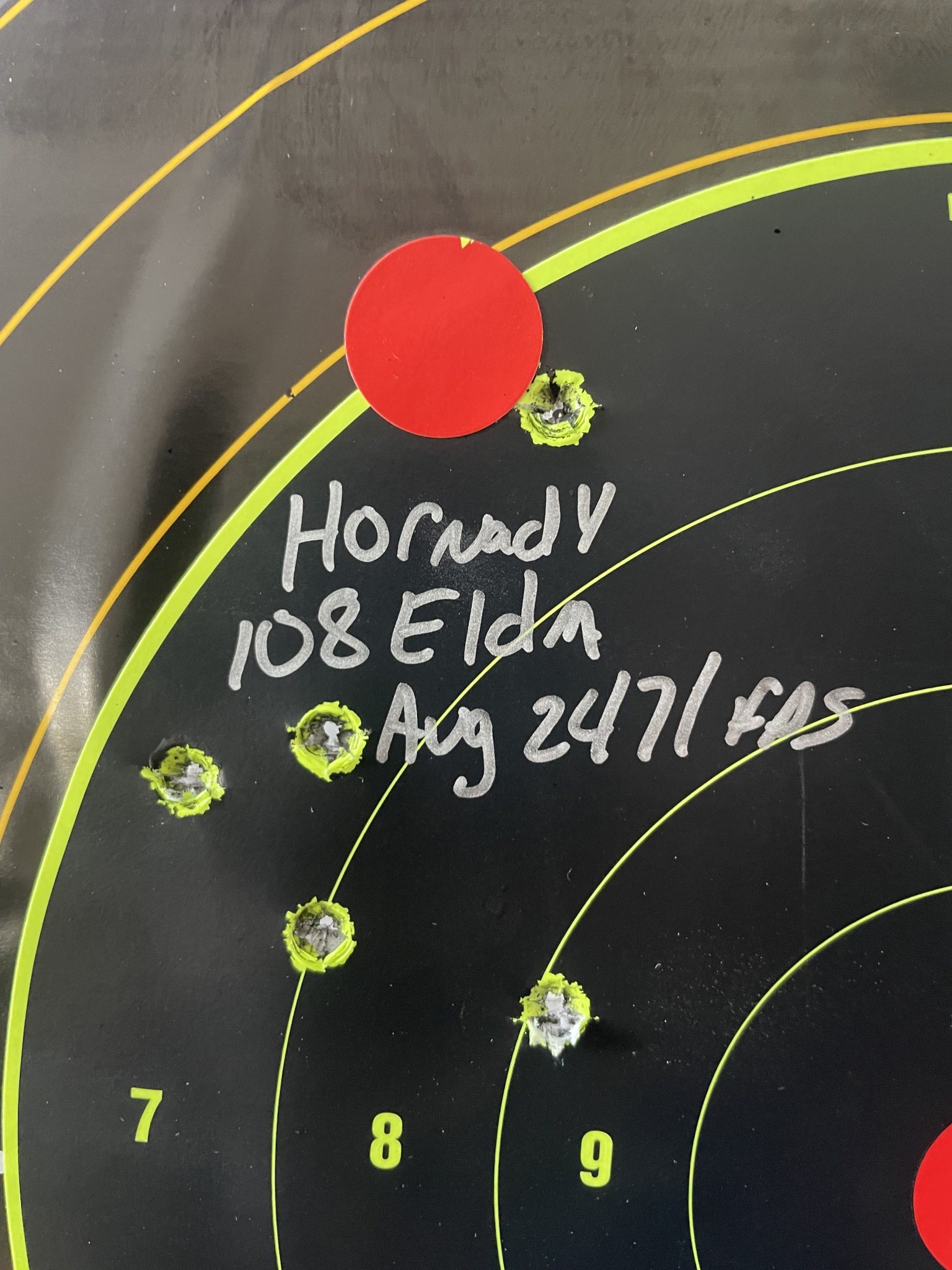

A few things, the 10-shot groups were with a different load and brass cases loaded 4 years ago, I basically used them for break-in and were the first 50 rounds fired. SD's were 25+, not great ammo. I'm a more proficient loader now.
The 5-round groups last night are my latest loads with NAS3 cases and different (better IMO) powder. It's a great load that has shot well in the last DDF, my 18" Centurion, 18" KAC LPR (Krieger) and 14.5" KAC.
Next time out I will do more 10-shot groups with my NAS3 loads and I will try a 20-25 shot group, with pics every 5-rounds as it progresses.
