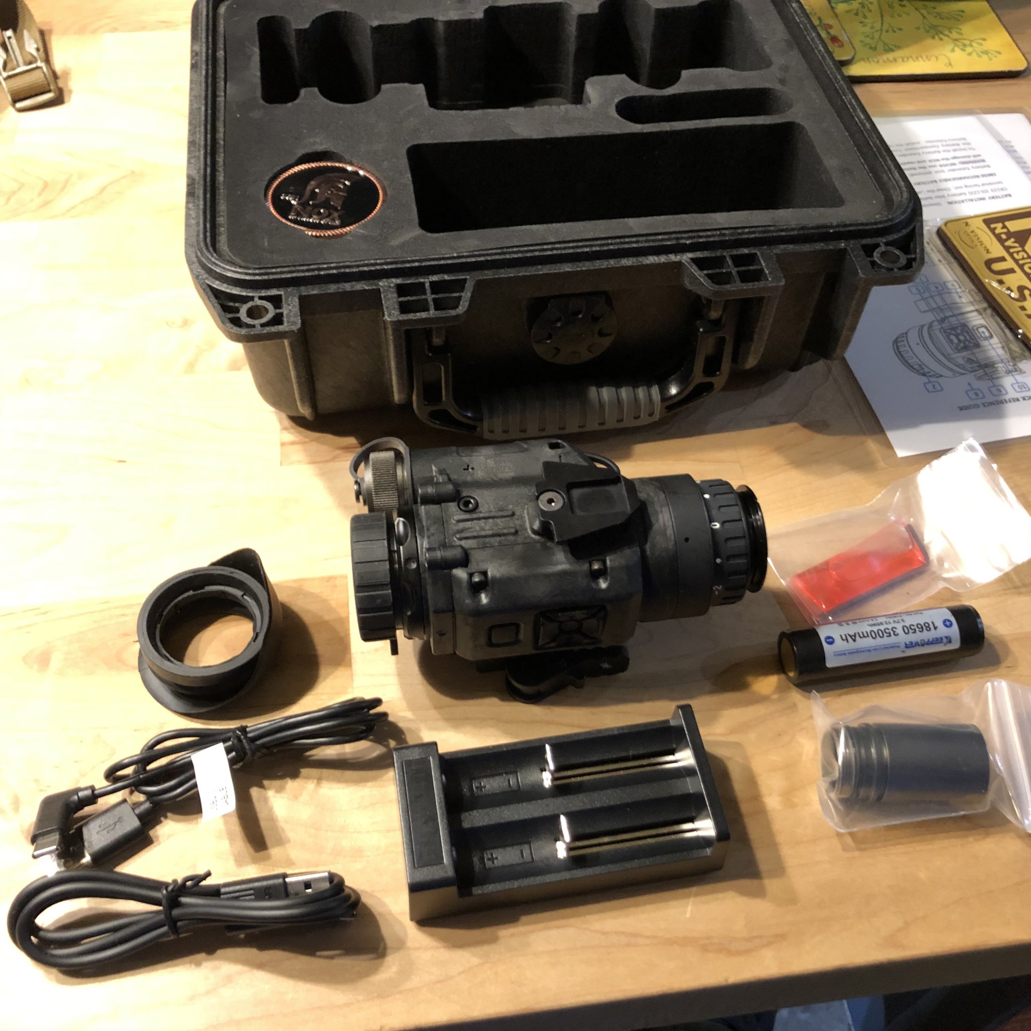

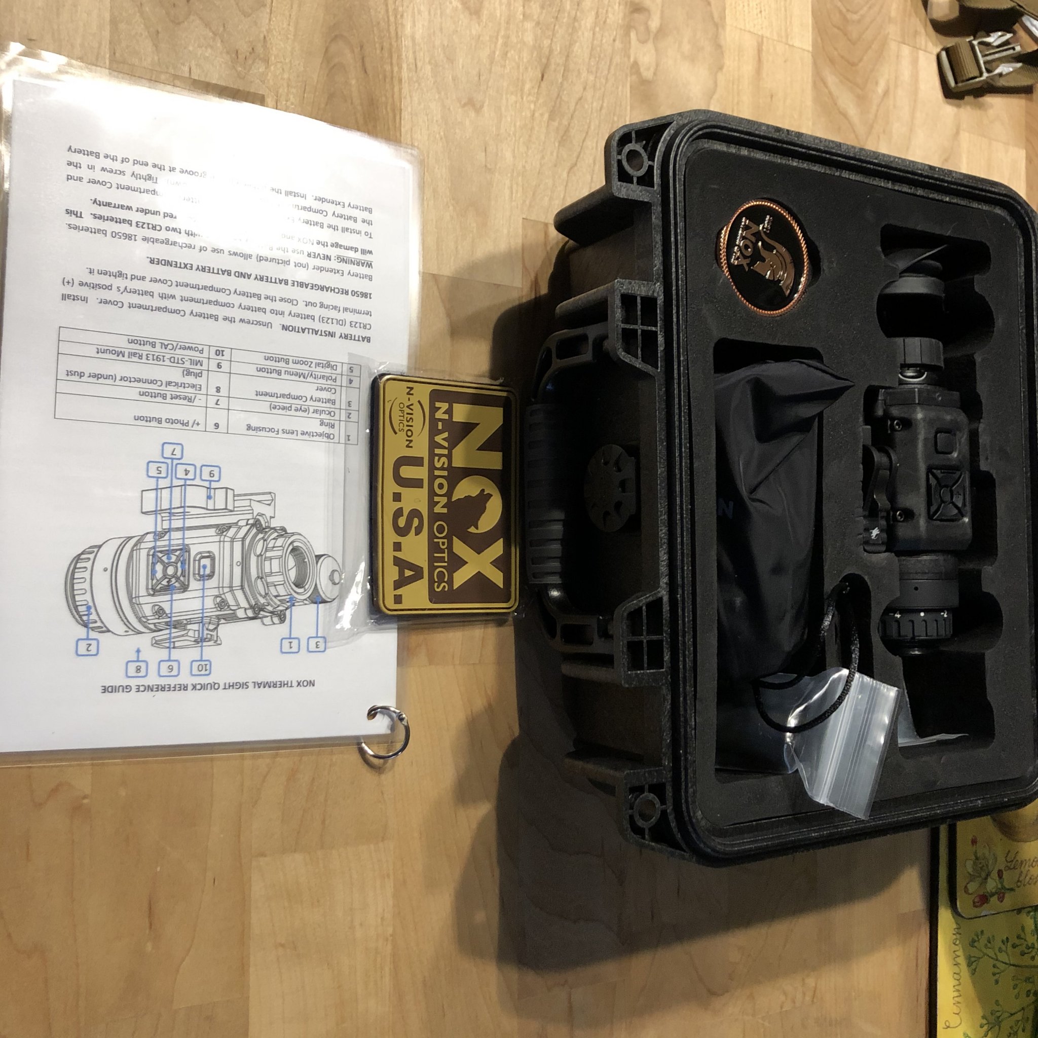

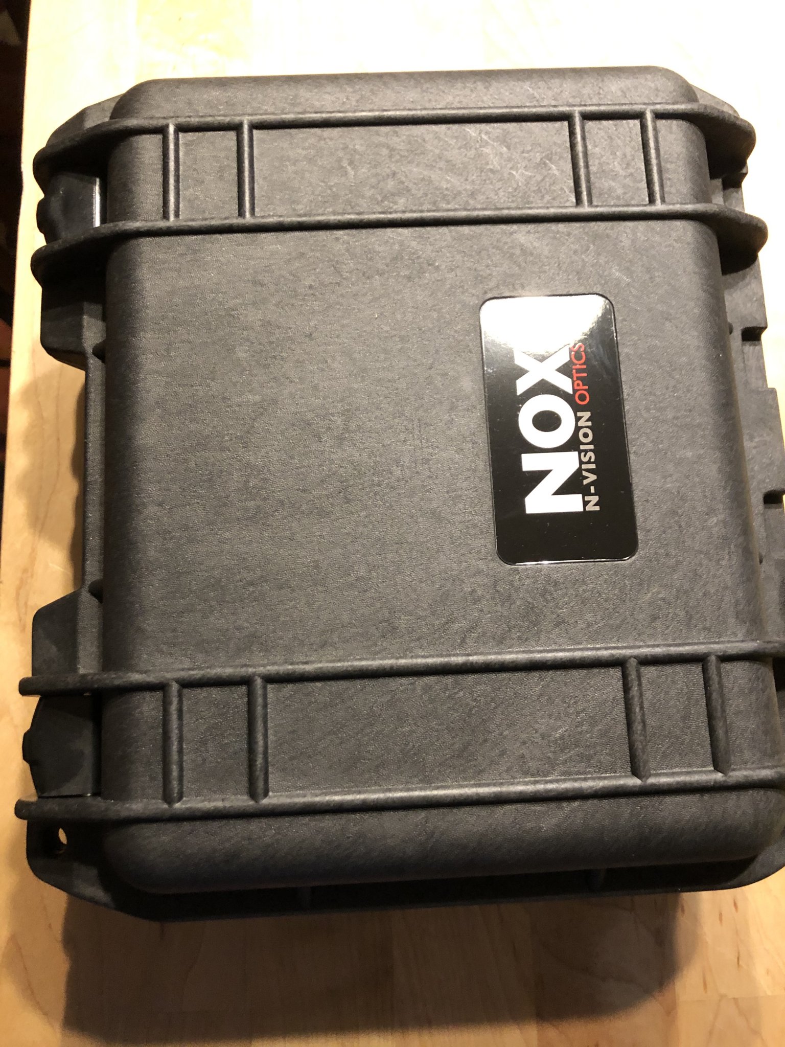

Night Vision Nox 18 unboxing and first thoughts
texasleftychef
Apr 4, 2011
454
182
Fort Worth, Texas

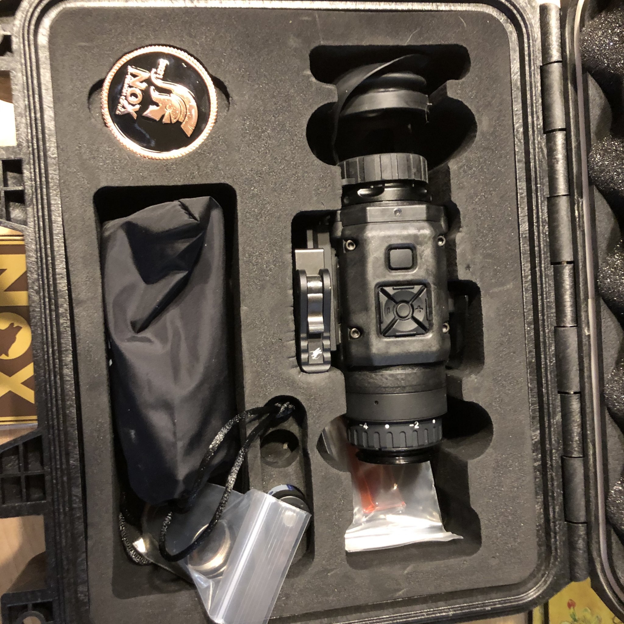

Hadn’t seen anything about this yet except Wigs review so I thought I’d throw you guys a bone. Got my Nox 18 from Robert on Friday and had a chance to play with it some last night and tonight.

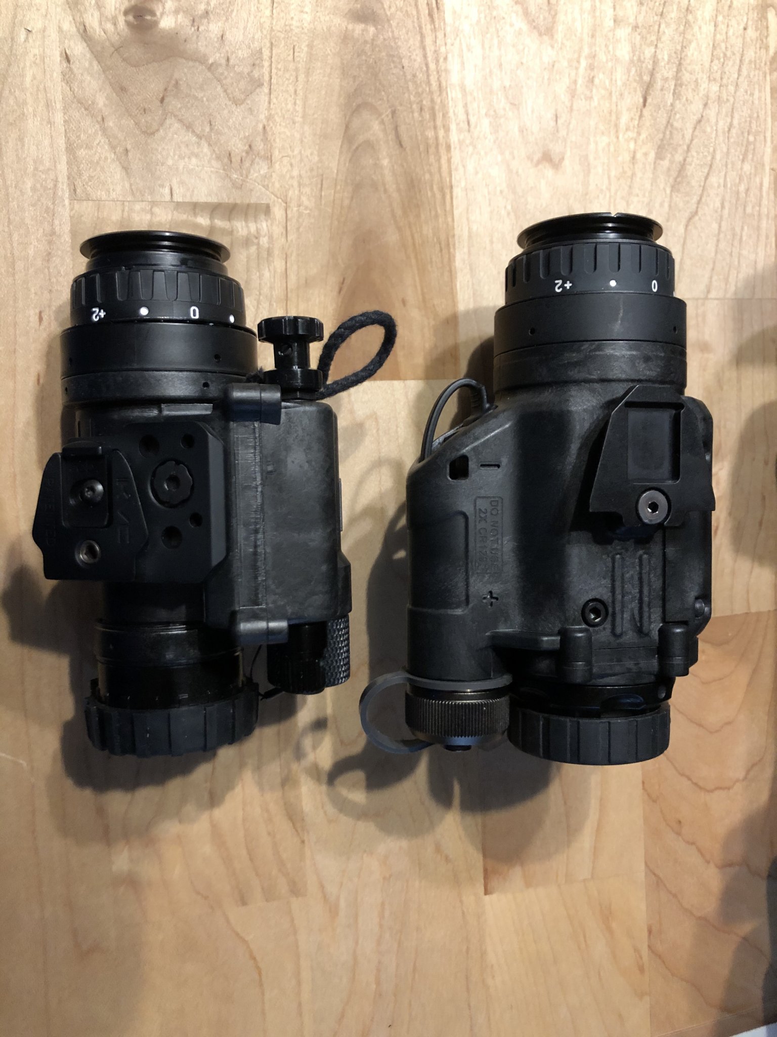

First thoughts are is this thing is pretty sweet. It’s Just about exactly the size of a pvs14 and roughly the same weight in my opinion. Clarity is great too and really bright on factory setting. Will have to compare to my Reaps but seems to be just about the same picture quality, maybe less grainy but I have some of the settings fairly high on my Reaps. Possibly more clear on zoom too than the Trijicons are but haven’t done a side by side.
Appears to be designed to either run on right eye or as a stand alone on either eye. I think if you want to run left eye with a 14 on the right you have to flip the Wilcox mount around to the ADM quick release and lose the ability to weapon mount. Maybe could get around this with Knights OSS right eye mount. Took me a little bit to get the controls figured out and even still kind of learning but they are pretty straight forward after some practice. Not sure if I like them more or less than the Reaps. Certainly not as jumpy. Just not what I’m accustomed to. Only minor complaint thus far is theDot on the diopter doesnt seem to be zeroed correctly but still focuses just fine.
I think you guys looking for a triple use monocular/scanner/weapon usable helmet mounted thermal are going to really dig this unit. I have not weapon tested it so more to follow.
All I have for now. I’ll answer questions as best as I can if you have any.

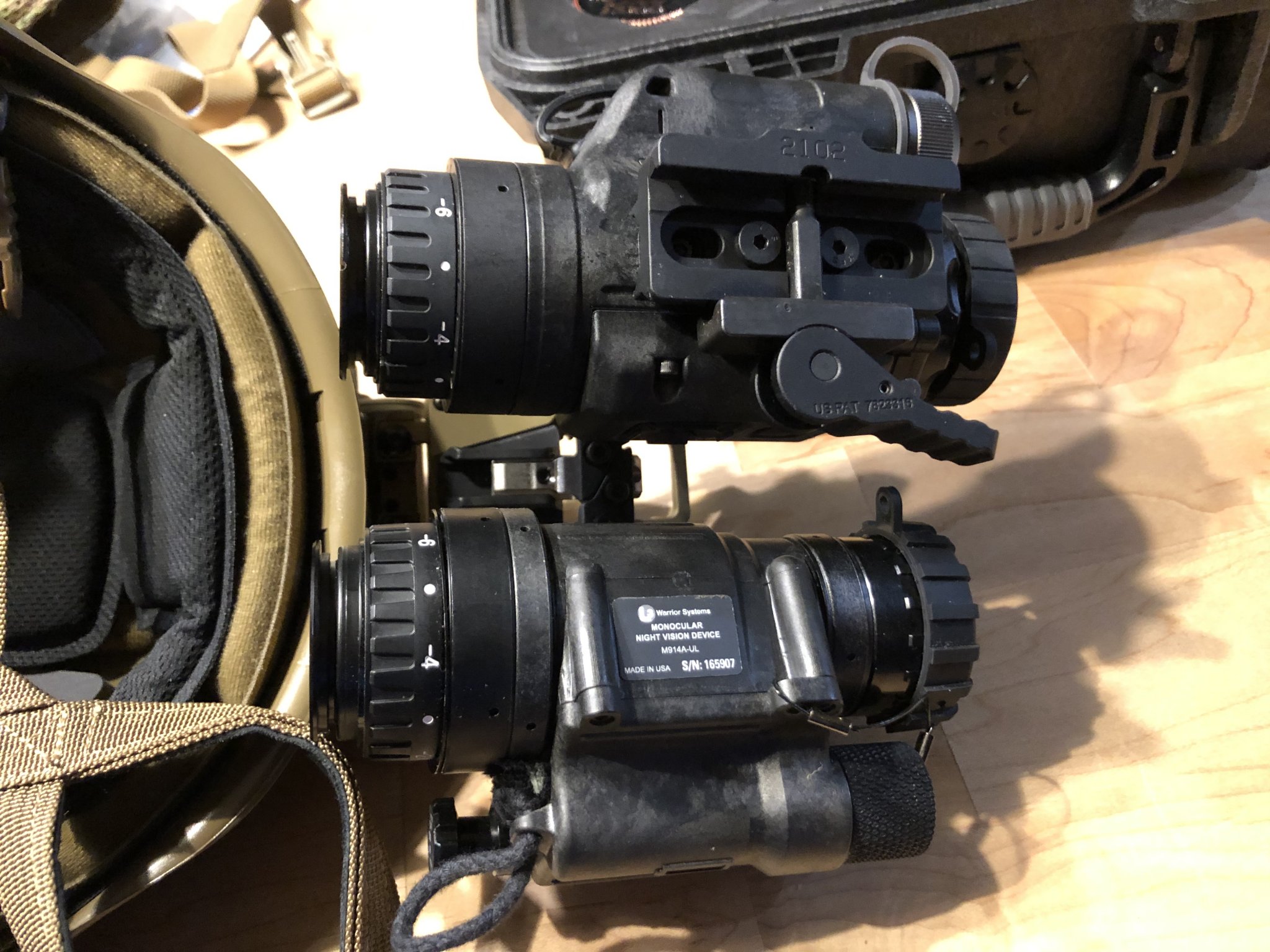

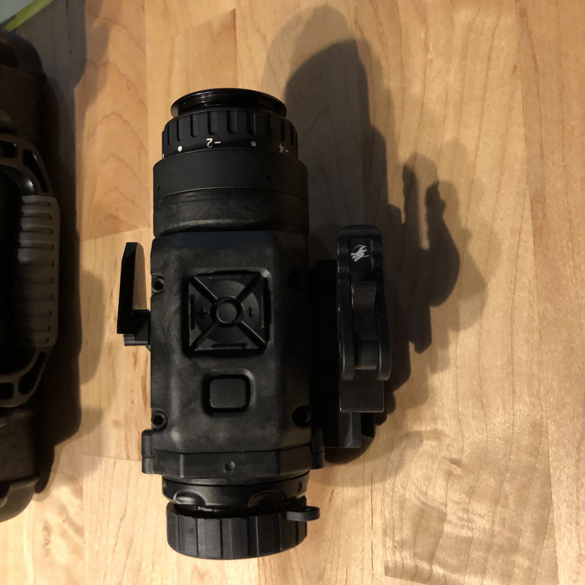

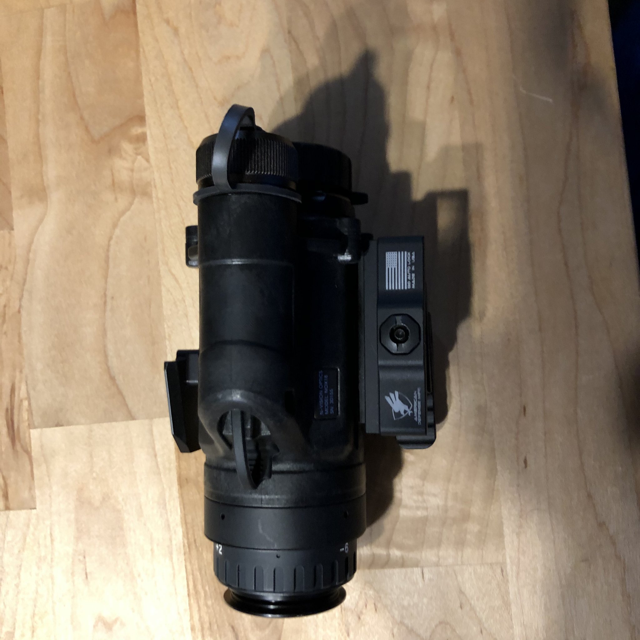

It looks like the dovetail is positioned further back on the NOX than it is on the PVS-14? How well did the two line up with your eyes once mounted to your KVC bridge?
So the picatinny mount secures to one side only? I see there’s an aftermarket mount on the market already out for this unit...would be nice if someone made a dovetail shoe mount for a rail section that would allow for quick detach to helmet either left or right and slide and click back onto the rifle if needed.
Looking forward to getting mine in too
Nice catch. That’s why I was trying to show you guys that pic as I have been worried about it since I first heard of the unit. Maybe others can chime in but to me it’s not that big of a deal with the Wilcox mount. There seems to be more forgiveness with the Nox than the 14 so for now I have been getting the 14 where I like it and then using the Nox where it ends up. In reality they aren’t that far off but it is not exactly the same.
Post the link to that other mount if you don’t mind please. Here is the line in the instructions about flipping the mount. I may be mistaken about mounting the other side but that’s how I read it.

Thanks for that. I had thought to mention that the Nox will sit lower on your rifle but when I mocked it up it seemed to be ok. That being said it might require or be more comfortable with a riser like an aim point T1. I think the ADM mount is the same as the aim point but the riser doesn’t seem to have the same screw pattern so I’m not sure if there is a compatable product right now.
I’ll probably end up putting a picatinny riser under mine anyway to match it up with my other optics for a more heads up aiming.

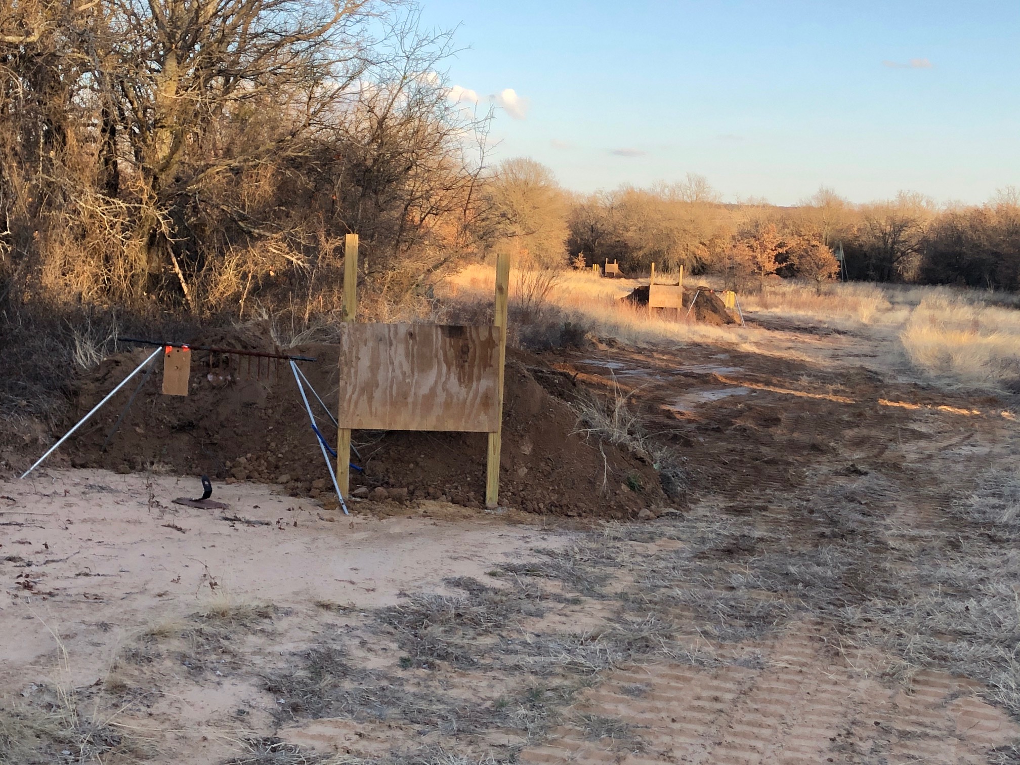

Set it up in the backyard just now. 33* and little temp change the whole day and sleeting. Pretty much the worst conditions I can think of for thermal. I will post the picture with the caveat that I don’t think the image could get any worse based on the weather the last couple of nights and picture isn’t as good as picture through the thermal. Unit has a picture taking feature that I wasn’t able to figure out how to download so this is a camera pic of a pic that I took. Full disclosure is I don’t think this is representative of the Nox based on the last two days but want to maybe show what it looks like in the worst conditions. Close house is about 75 yards and the one in the distance is about 225.

Thanks for posting, looks good. Still looking for my first NV/Thermal purchase and the NOX and Pulsar Krypton are high on the list. Ideally, I want something like a PVS-14 and NOX on the head and a PVS-30 on the rifle. Mix and match as needed.
Based on having Trijicon NVision and Pulsar I would get either a Trijicon or NVision unless you have to have the video feature. No experience with the Bering line so I can’t comment on them. I think the rest of your kit are solid choices. I miss my 30 to be quite honest. Maybe one day I can get a TigIr. For my applications thermal is 1000% better than NV.

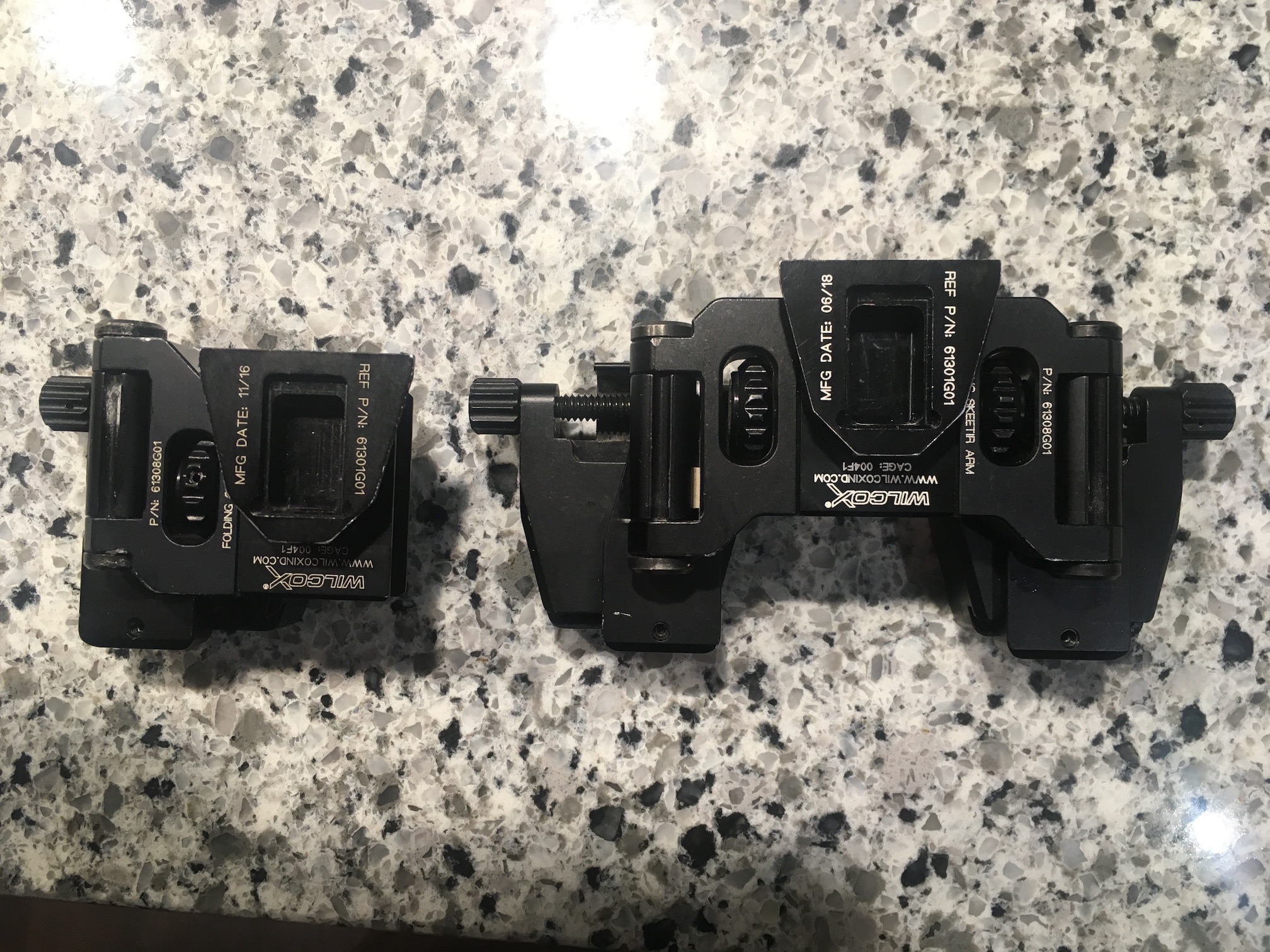

NighthawkCG, can you elaborate on what you’re describing - is this using a KVC bridge?
Not KVC Bridge, but wilcox. The bridge arm can be taken apart and flipped over, pushing the mount a little bit father away from your face. Depending on the J-arm used on the pvs-14 it can match up pretty well (at least with the IR Patrol).
I probably should have lined up the pieces differently, but in the pic below, you can see the front/back offset goes towards the front where in the complete bridge, they sweep back.

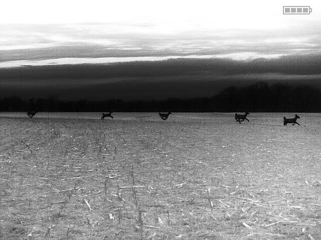

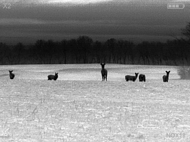

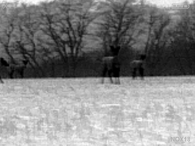

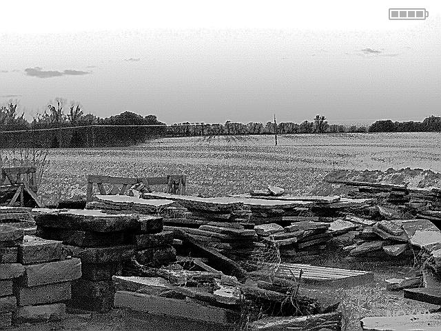

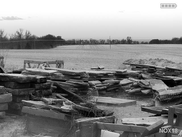

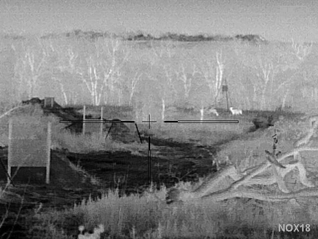

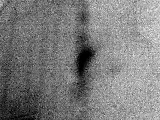

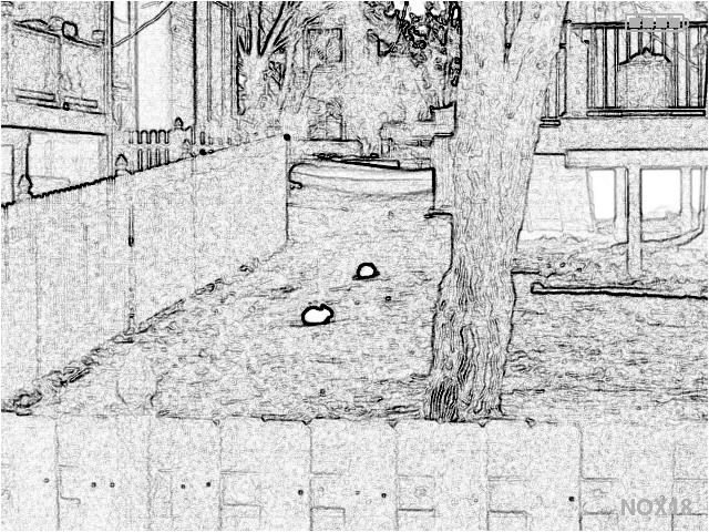

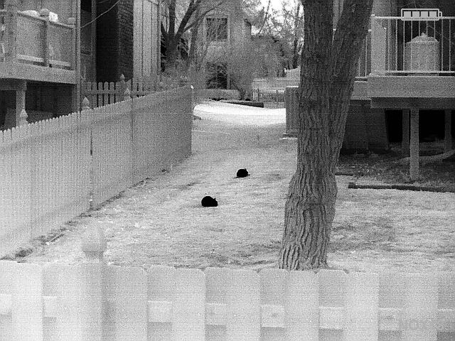

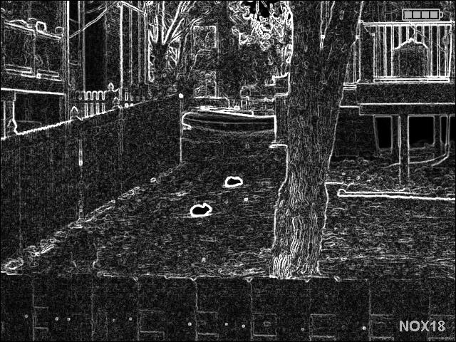

Update on software and pictures. Downloaded and took another picture today so you can see how bad the conditions were last night. I'm still not at some of you guys abilities to get the settings exactly right but I think I'm getting close. Just wanted to get you guys some quick pics for this evening. I'll try and take some way off tomorrow night and see how well it does and can detect.
Tonight's settings - not sure what I had yesterday
Brightness - 1
CE Level - 2
Sharpness - 2
Gamma - 2
First pic is Sunday night and the second is Monday night FYI.

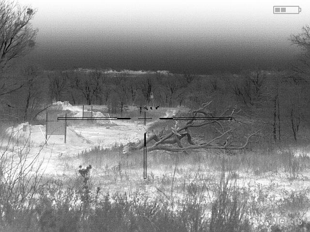

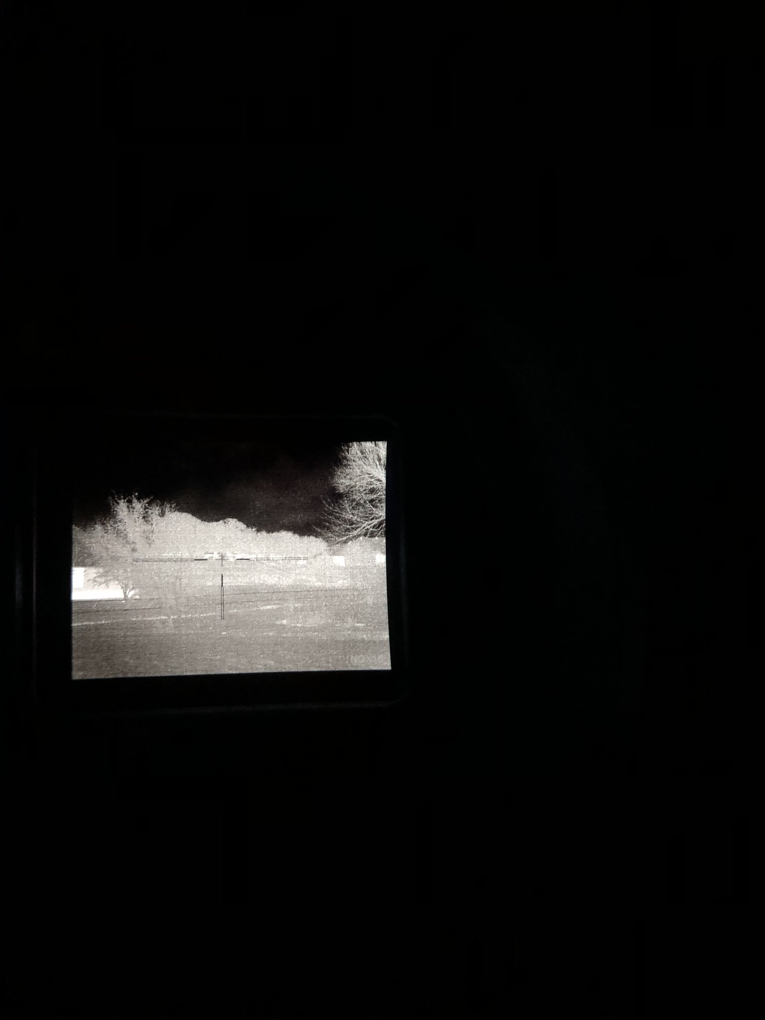

I haven't had a lot of time to play with mine, but had an NV class at our range this weekend and everyone was impressed with the Nox.
Nuc on Nox is super fast. Just a quick push of the power button which is far enough from the other buttons you can’t mess it up. Do wish there was a shutter though.
Glad to hear about this software. I’ll try and get set up on it and download some pictures. Taking pictures is cake too once you enable the function. See update below !
I am not well versed in the Dloc for the 14? I can post more pictures of the mount removed if that would help you.
Not aware of any blue tooth connectivity but it may be in there somewhere. Have to look some more.
Brightness - 1
CE Level - 2
Sharpness - 2
Gamma - 2

It’s not too bad. It seemed like there were two files. One was a screen grab (didn’t explore) and the other kind of opens a library and you can choose which pictures to save in I think bng or jpeg format. I didn’t experiment too much but I was up and running in less than five. Hide wouldn’t let me post the bng style file.
Reactions: Jim Out
The first night was about 30* and sleeting and virtually no temp change. The second was windy 35ish and had about 15-20 degrees temp change in the day.
Like I said I may have the settings a little high resulting in poor pictures. Was honestly in my pajamas and freezing both nights so I only played with a couple of settings as well as learning the interface at the same time.
I almost didn’t publish the pictures because I don’t believe they are necessarily indicative of the Nox’s performance but thought I should in full disclosure show what the downloaded pictures look like as I thought that was a cool feature that my Trijicons don’t have or I at least don’t have the cable to do it.
I honestly thought the second one wasn’t too bad. A little washed out but still able make out pipe fence posts at about 300 yards isn’t all that bad I don’t think. I’ll try and get out to the farm with it this weekend and get some shots that aren’t around the neighborhood.

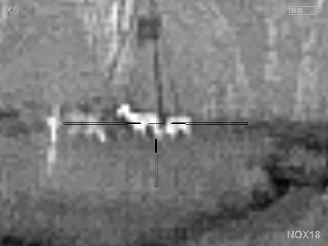

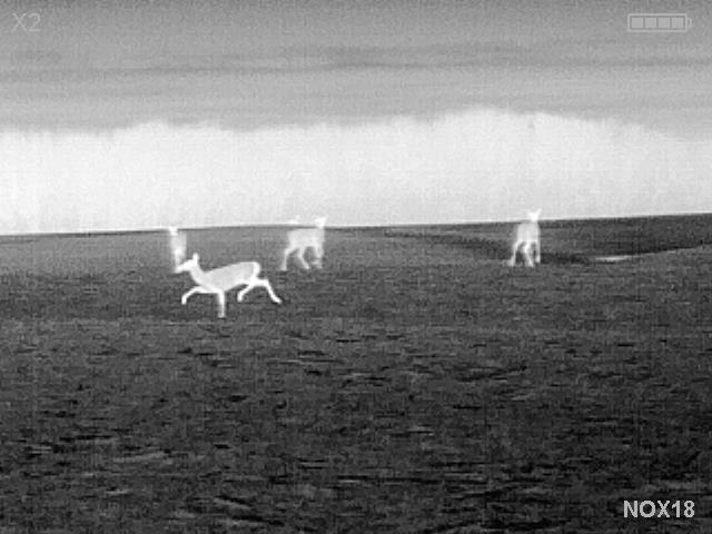

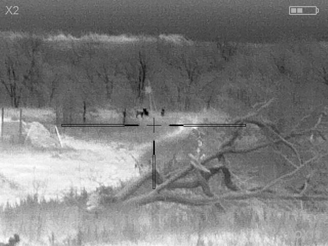

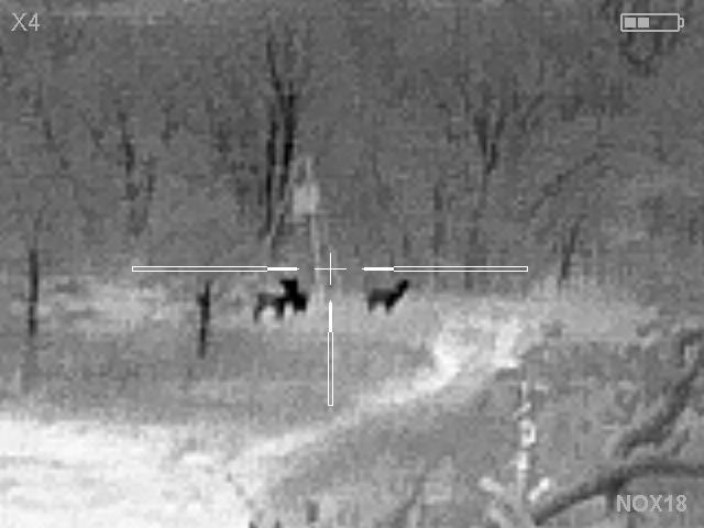

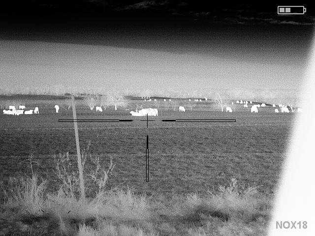

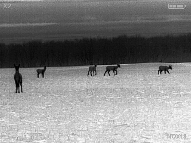

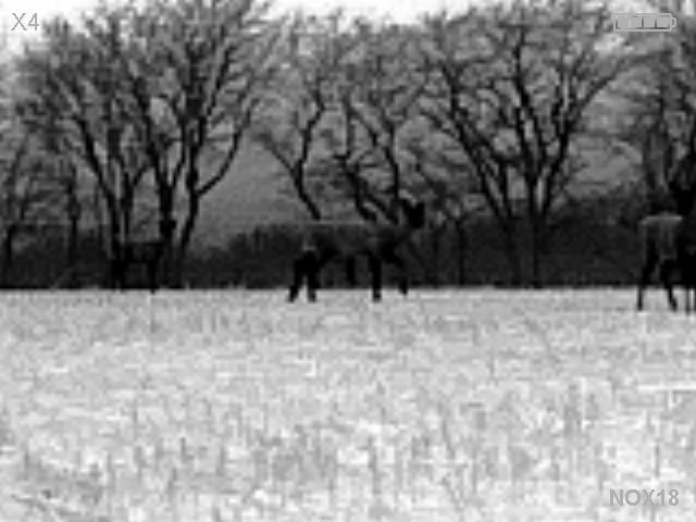

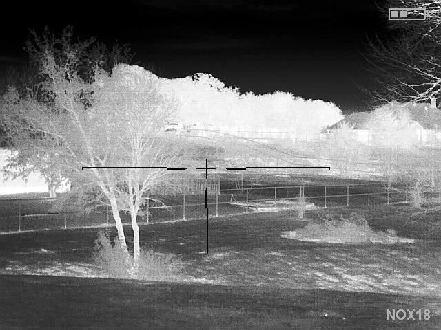

So here are some more pics for you guys. Was working at the farm today on my shooting range and stuck around to take some pictures for you guys. Nox was really pretty spectacular the further after dark it got and temps dropped. I was only meh about right at dark but once the temp started to drop it really started to pop. For reference the first target board is 50, and the others at 100 and 200 and the feeder is about 175. About the longest reach I have at my place as it's really woody. Temp about 50ish and humidity pretty low at 7pm. If had done this a couple of hours later, I think it would have been even better. Need to clear the downed trees in the foreground but didn't have the grapple on today. Feel free to tell me how awesome my shooting range is too for tactifool fat guy...
Nox seems to really shine with the zoom. I'm not sure why, maybe only the increments from 1x to 2x to 4x to 8x as opposed to my Reaps 35 and 60 which go 2.5 to 5 to 10 and 4.5 to 9 and so on. Don't know how these show to you guys via computer and jpeg and whatever is lost in translation but I was very pleased with the image and think you could even possible use the zoom at 3x or 4x unlike the Reaps. Cows in the last picture are probably from 100-500 for you guys wondering detecting range.
In the immortal words of the NV man extraordinaire the faux toes. You guys can complain about grainy and what not but I thought the image was pretty damn good and pics almost as good. But from a guy too poor to buy a Skeet.

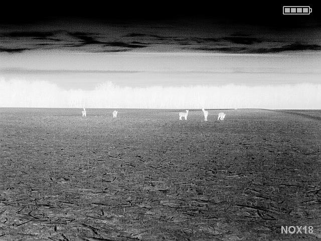

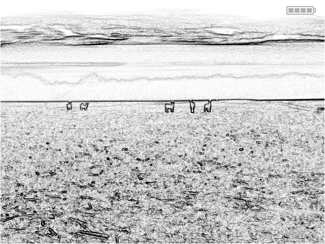

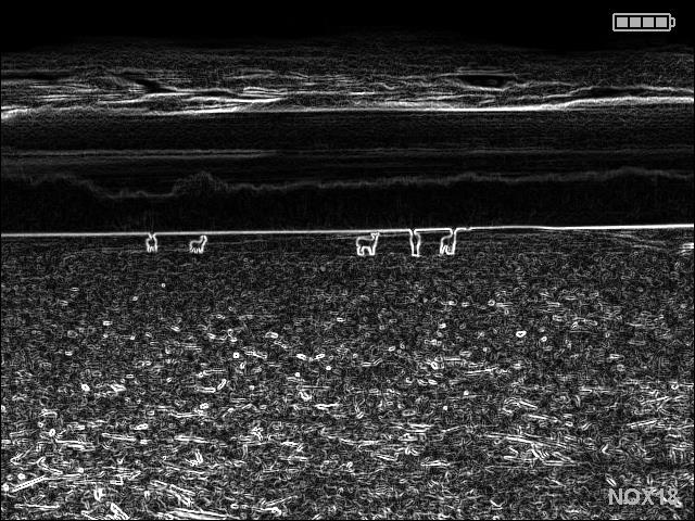

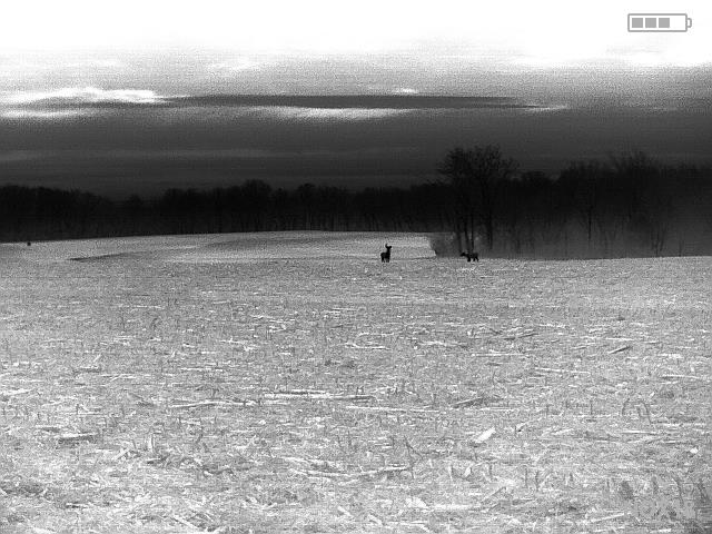

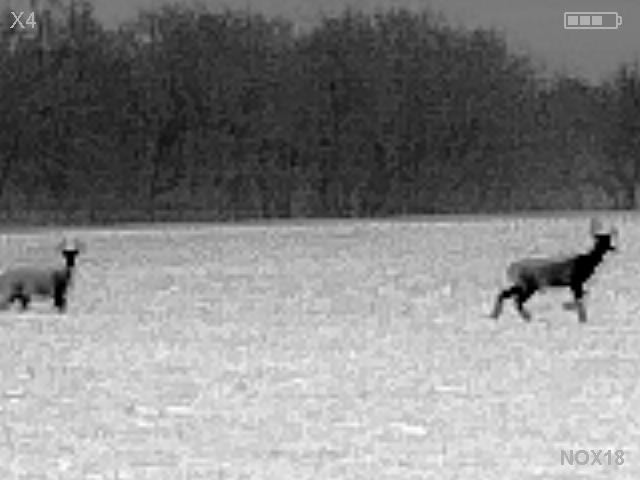

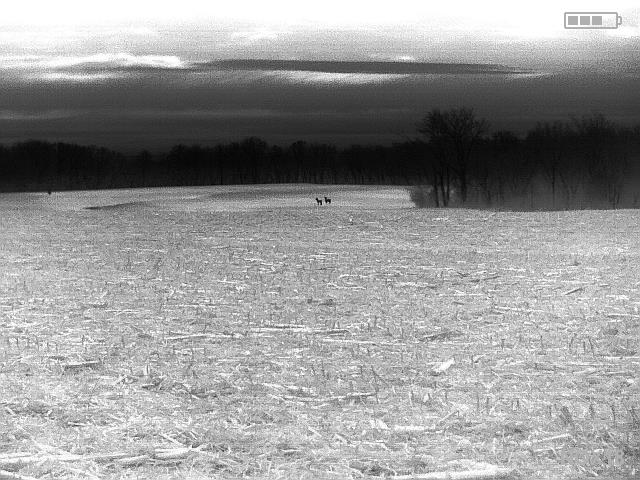

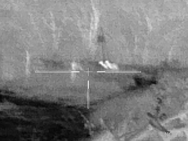

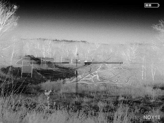

Here's two pics of deer at ~800 yards with no zoom. Far tree line is ~1,400 yards. Deer are under the tree line in middle of image. I honestly thought those deer were more like 1000 yards from day range finding and so I think the 18mm can detect further than 753 yards. I thought detection range was a math equation so perhaps I'm wrong on my estimated range. I only post these with the caveat that this was right at dusk so thermal contrast was not optimal. Also I was using the NOx as a handheld mono so I believe a slight amount of blur applied to image just from me clicking the take photo button. Think about it like jerking the trigger of your rifle. Instead jerking the mono causes image blur during image capture.
First pic is max CE setting, can't remember sharpness. Maybe 2 judging by the image. Second pic is default settings, maybe brightness 4.

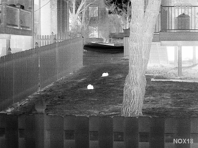

Also some rabbits on default settings with all 4 color modes. Thermal contrast was not great on this evening either.
I've been taking the NOx out quite a bit. I am extremely impressed by the HMT capability bridged with a PVS14 WP. I don't have any issue having the two devices sync to one image. I have only zeroed the NOx, I have yet to shoot anything. The image quality on all levels of digital zoom seems quite functional. I'd be confident shooting on 4x out to 400 yards.

I really liked and appreciate the 4 setting comparison with the rabbits.
What mount and bridge are you using with the NOx and what do you have for a PVS14?

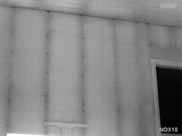

Could you post some of the pictures of your walls and maybe electrical outlets or breaker box too, please?
I really excited to think of using this on motors and appliances, not to mention the applications for vehicles and heavy equipment troubleshooting.

I'm using the Knight's armament KVC universal bridge RQE. Vyper PVS14 WP with ~2400 FOM and SureShotNV SNB filter.
I used it with my GP( I think, unknown SPECS but good FOM) PVS14 unit and, provided its dark out, I don't really have trouble fusing those images either.

I have a pic of some studs/screws the other night and that damn cold spot in my wall. Would get more interior stuff for you but the NOx is pretty chilly and needs to warm up to interior temps before it'll take a good image.
I attached more images of deer from a bit of a stalk I had last night. I couldn't count the points on the two bucks but you can clearly tell they've got racks. Thought about throwing a rock at them at one point.
