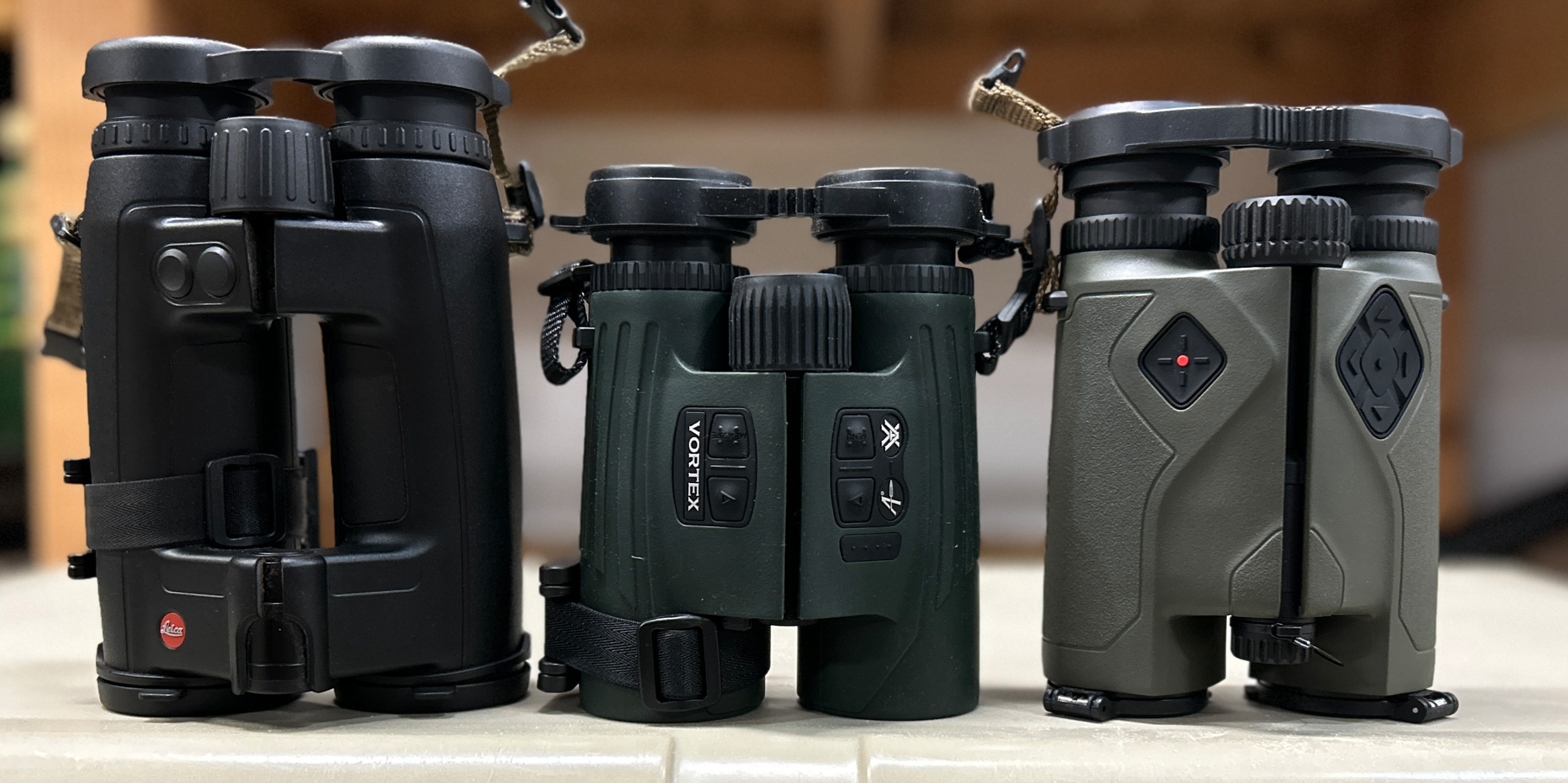

Hello, I attended my first NRL Hunter and I’m officially hooked. I have a question for the more experienced folks on this site:
My teammate and I approached our stages with a handheld LRF + standard binos. We lost a significant amount of time on each stage because of juggling multiple devices.
I’ll be buying a set of RF Binos this summer to use for training + next NRL season. Money is a concern since I cannot rationalize spending $3000 on a tool that I’ll be using somewhat frequently. It appears in that $1K-$1.5K price range, there’s a trade off between having a ballistic solver (Sig Canyon, 6K HDX) vs higher glass quality but no ballistic output (Vortex Fury, GPO Rangeguide, Geovid R)
For any reader or NRL competitor, do you think it’s better to have worse glass + ballistics or sacrifice the ballistics and get better glass? For reference I use a data card / arm sleeve.

The glass on the sigs isn’t that awful. I have the older 3ks, and I very rarely don’t find targets. If you get the 6ks, you’ll need a kestrel or something for solutions past 800. The fury ABs are a good in between with having full AB, but they are a bit slow for some people
for NRL hunter, under $1k, its hard to beat the Sig 6K's
- Sigs have the fastest laser/solver of all the top ones.
Even the 3K and 6K's will range something way faster than pretty much anything else
for a team, I would say, best bang for the buck.
1 pair of Sig 6K's
and 1 pair of good non range finding binos
like a used pair of Swaro EL's or maybe Zeiss or Leica

Thanks all for your generous input!
It sounds like there’s a few reoccurring themes:
- Sig Kilo 6K sounds like a safe choice that an engaged / competitive NRL junkie would be satisfied with at an entry level price.
- stretch the budget and find a pair of used revics for the long term.
-invest the money in higher quality glass with simple RF tech because you can’t range what you can’t clearly find

Another question for the peanut gallery, does anyone have experience with GPO Rangeguide series? There’s a shop closing down local to me that is liquidating inventory & selling the latest 10x32 model that includes RF, temp / humidity / pressure / angle readings for $590 out the door. (Instead of $1K-$1.2K)
I’ve ran pretty much everything minus the Zeiss and the revic for NRL matches. I think the Gen2 Sig 10ks are top dog right now. Sure the Leicas and Swaros have better glass but I can get 5 confirmation read outs to my teammate before he gets his second from the Leicas.
Middle ground in your budget is the Vortex AB 5000’s. I’ve had the sig 6ks and you’ll need something external for shots past 800y like mentioned above.

Aren't the Fury ABs discontinued? I have been waiting to see if they come out with a new version that is faster.
Sig 10k gen 2.
For me the decision for AB to kill the functionality of the AB light with an 800 yard limit makes the 6k worthless. Double dumb for SIG choosing to use the light version in a rangefinder that can hit a steel plate at several thousand yards.

Seen a range of reports on this, but in your opinion, how much worse is the 10k g2's glass in comparison to the Leica and Swaro's?
Just a casual observation from RO-ing NRLH matches, I see a lot of Sig Kilo10K’s being used this year (G1 and G2), with the Leicas as the next most popular model. Last year it seems like I saw a lot of Vortex Fury’s, but significantly less so this year.

I've been a little surprised by how good the vortex have been. Maybe I have a superb sample or maybe there's been rolling updates. The thread linked below has a bit of feedback if you haven't seen it.
I’m looking forward to using the straight up RF binos from GPO and pairing it with a dialed in hard dope card. I figured down the line if I’m going to leverage a ballistic solution it’s probably going to be with a WMLF not the binos

This.....I really like the Gen 2 Sig 10K. That being said, Swarovski would have my money if they had Sig's technology.
