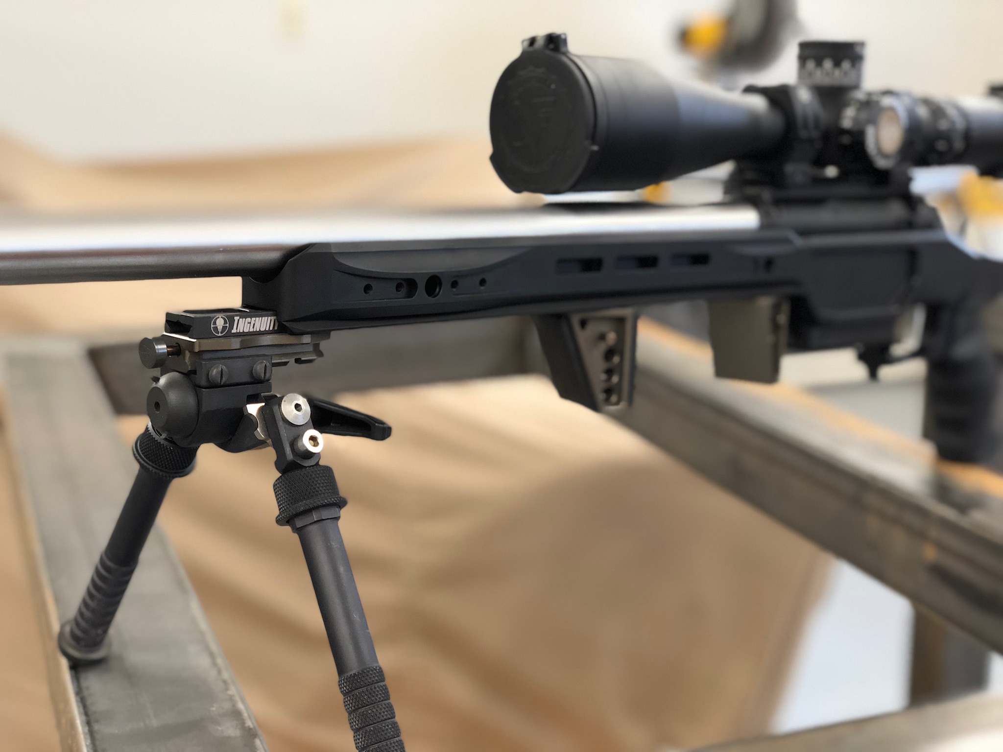

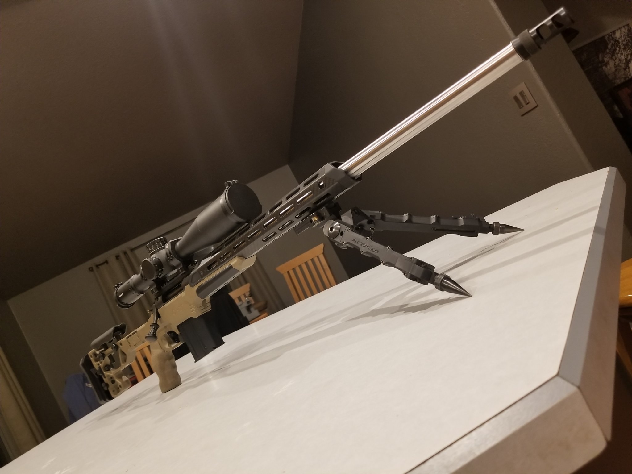

Here’s mine. Just needs a scope and a bipod.

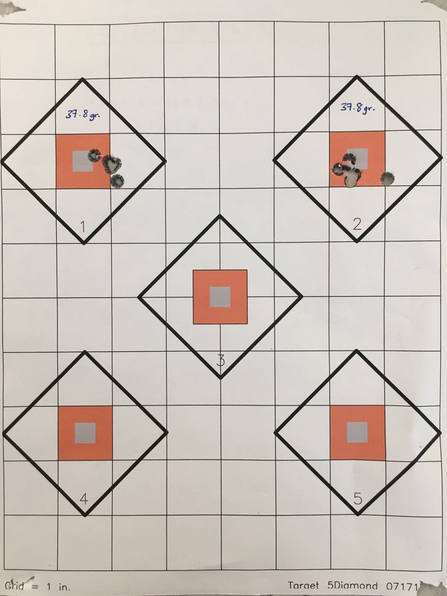

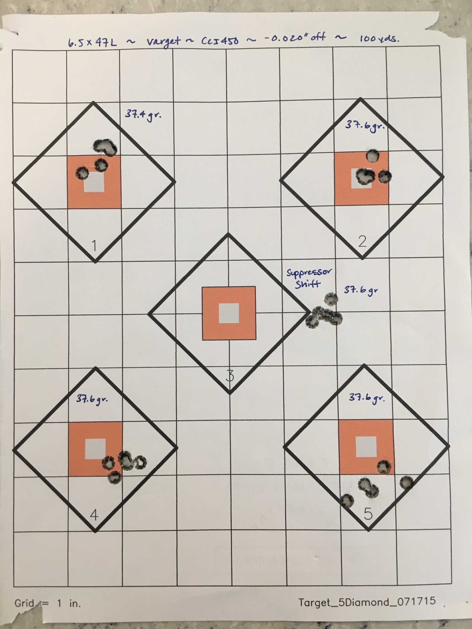

Not my first can. Also had a .6 mil elevation shift and .3 mil windage shift. Shift was consistent, but I was hoping to use it the same way you do.
My Surefire by comparison only has a .2 mil shift despite weighing double that of the TB.
Interesting. Mounting with the Thunder Beast Compact Brake I haven't noticed any POI shift and it sounds like it should, at least. Maybe call up Thunder Beast and see if they can take a look at it for you?

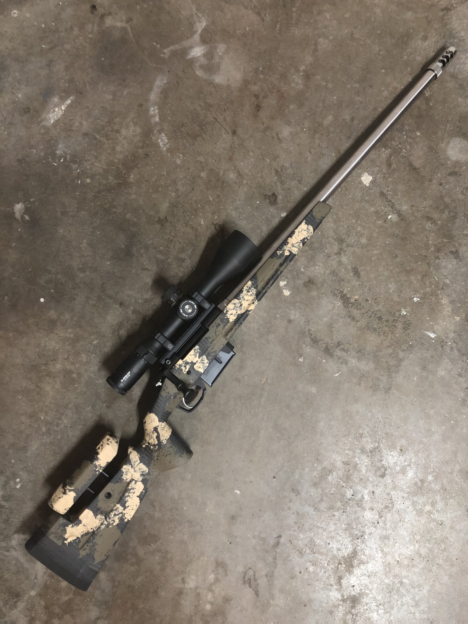

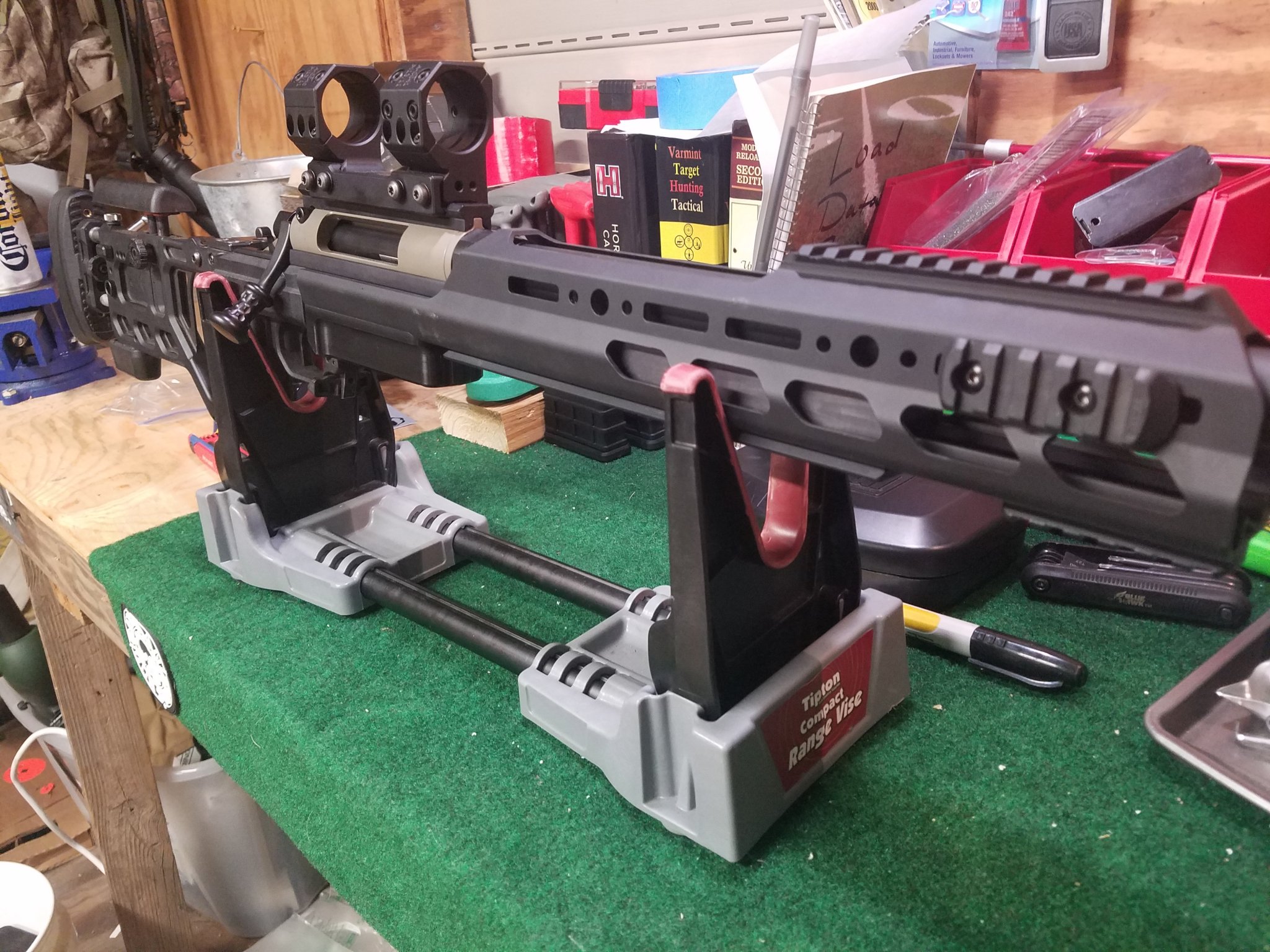

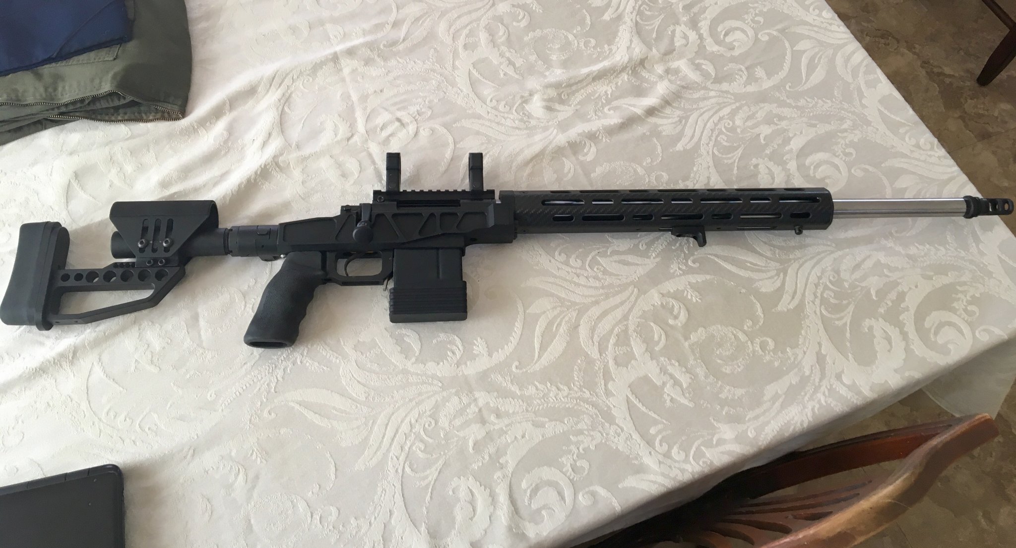

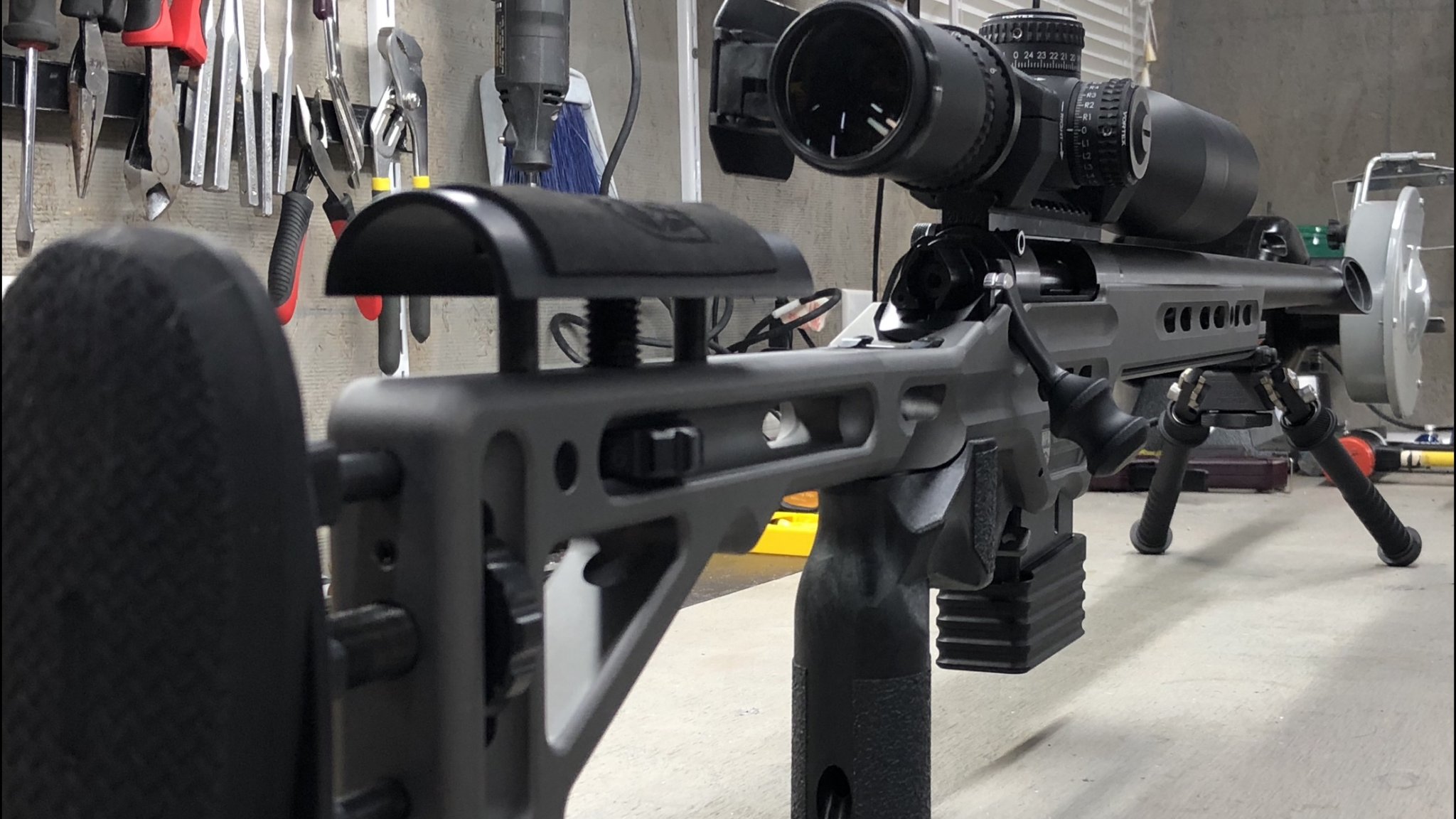

Finished it up
How do you like the PRS2 and Nucleus? The Bravo places my hand perfectly for extremely fast cycling. I imagine the PRS is the same?
I had the Nucleus in a KRG Bravo while I was waiting for the PRS-2 to be finished up. I actually like the Manners just a little bit more as it puts my hand a little further forward so I can get better leverage on the bolt than I could on the KRG Bravo. For whatever reason, I had an issue with not being able to open the bolt with just my index finger when mounted in the KRG, just couldn't quite get the right leverage. No such issues with the Manners.
Nice looking rifle, looks like it shoots well also!!
Thanks, I can't really complain. At this point I'm just fire forming brass and breaking in the barrel. I've got about 100rds down the tube so far. Can't imagine how much more things can improve with proper load development from where it is now.

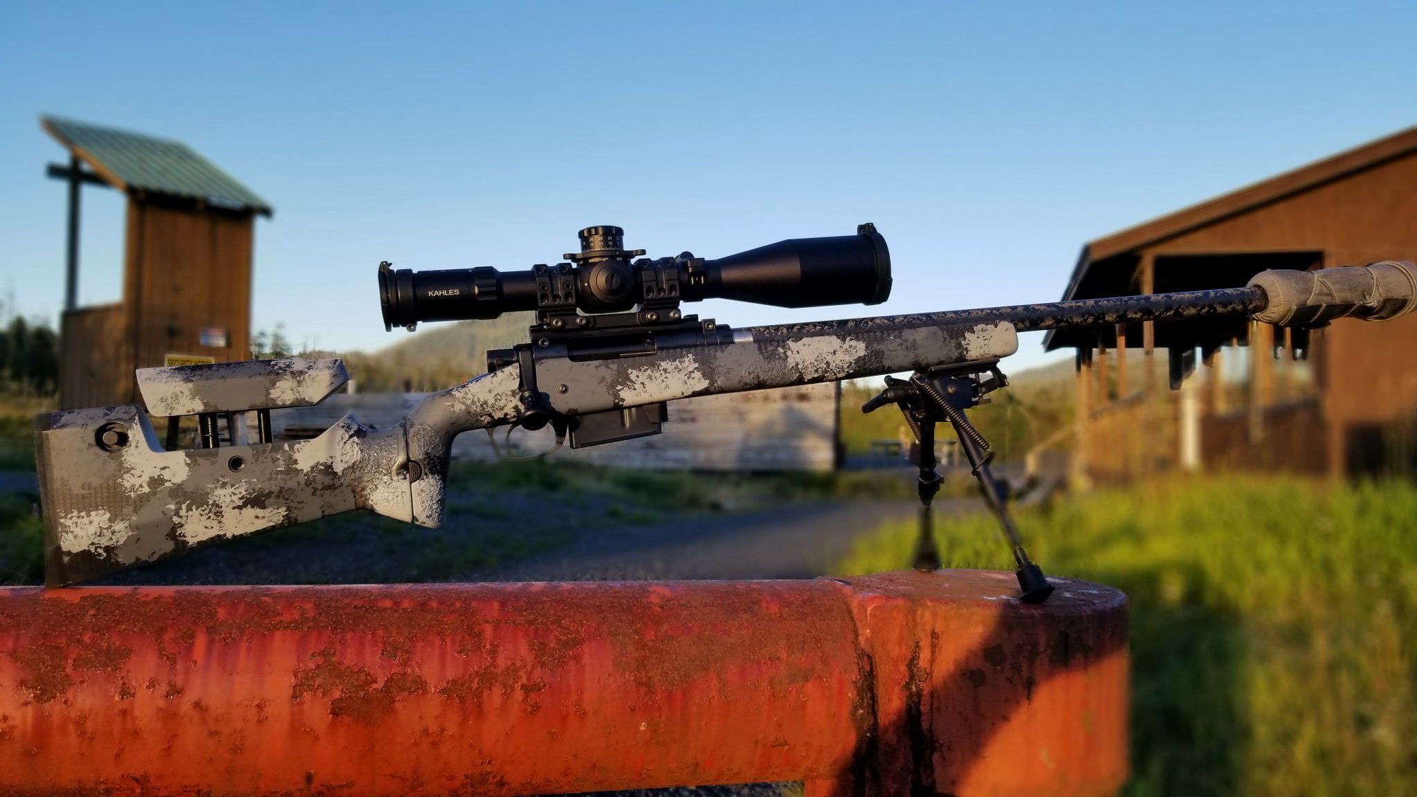

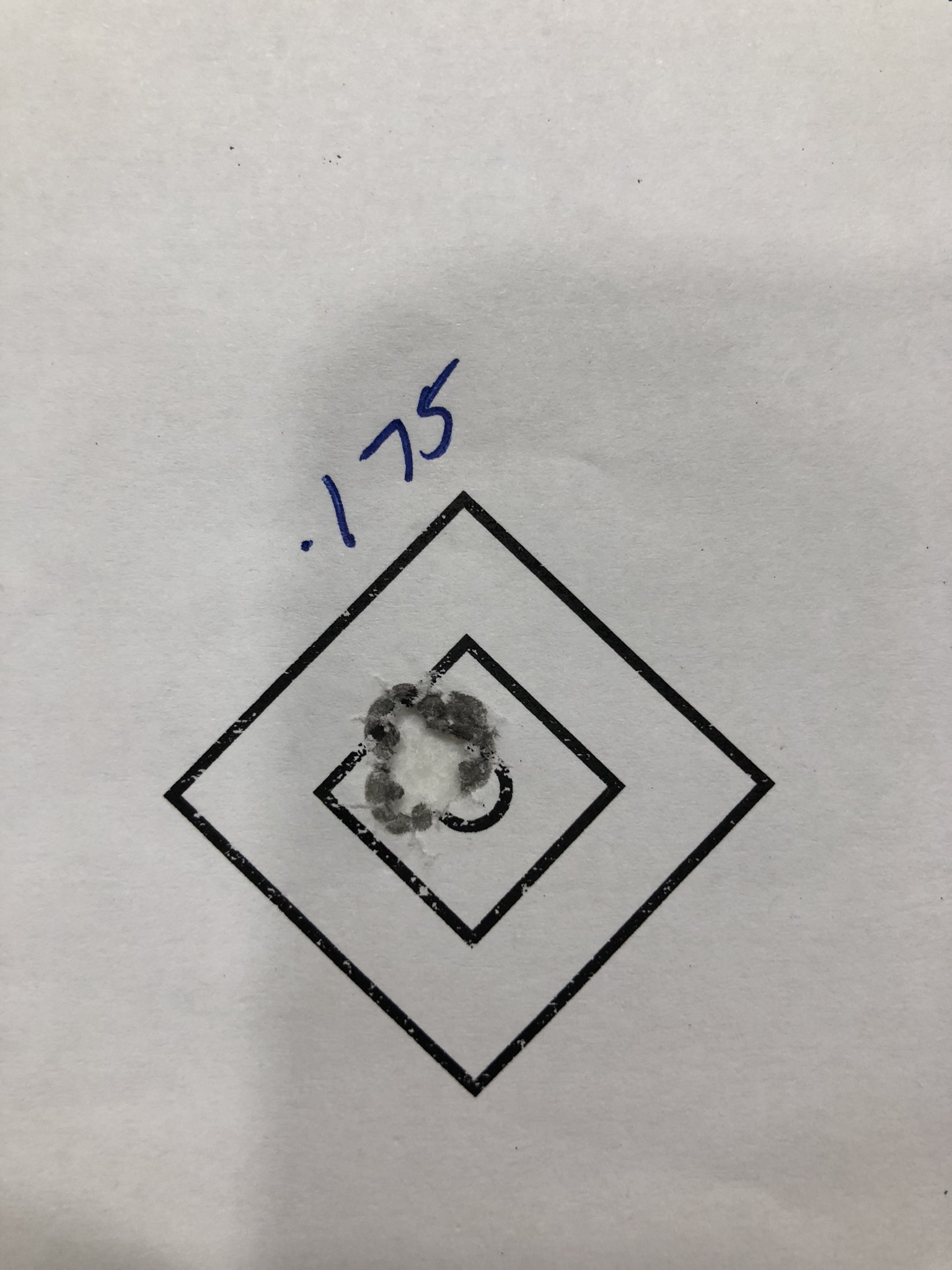

Nucleus RH 6.5x47 Lapua
26" PVA Shouldered Barrel, Med. Palma, Button Rifled
Triggertech Special set around 1.5#, very awesome trigger!

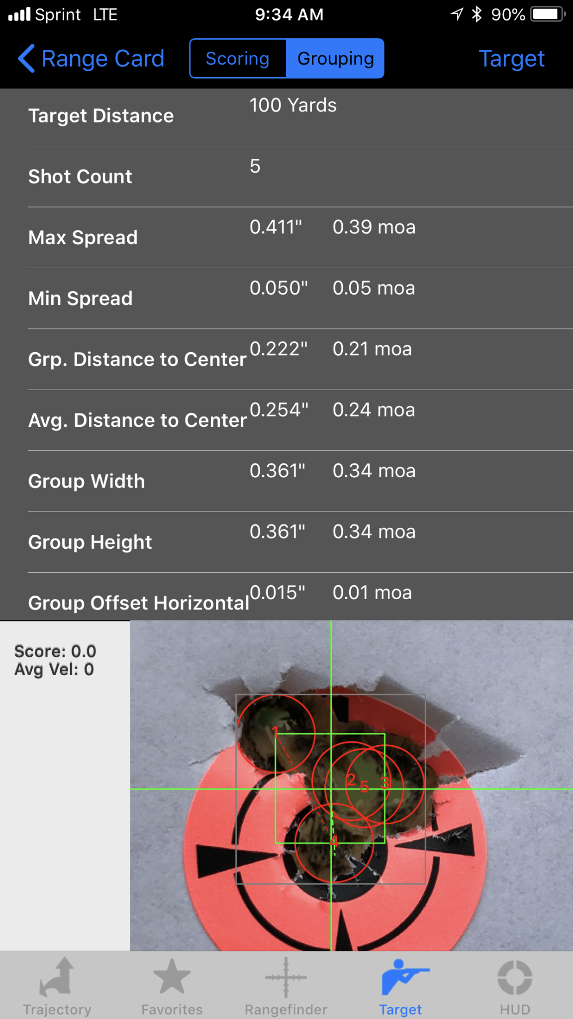

No light primer strikes, every round of the guns first 50 went boom today. The rounds on the target are #11-50 in 5 shot increments. The wide group I had my brother-in-law shoot it for a group.
I don't have much to compare the action to except a Tikka, and a Stiller TAC30. But, it is very smooth and locks up perfect. I can run it fast or slow and it's just awesome, no regrets here. There's something about the action that just feels rock solid. It has interesting features, but they feel very thought out and simple almost.

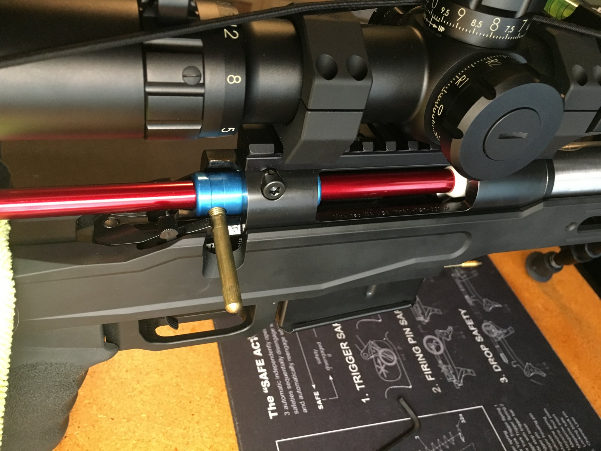

What bore guide are you using?
Nucleus action with Barloc, Hawk Hill 6.5x47 Prefit, Mcrees chassis, APA lil bastard, and Bushnell ERS. Had a Timney trigger on it, but just installed a Huber Tigger yesterday.

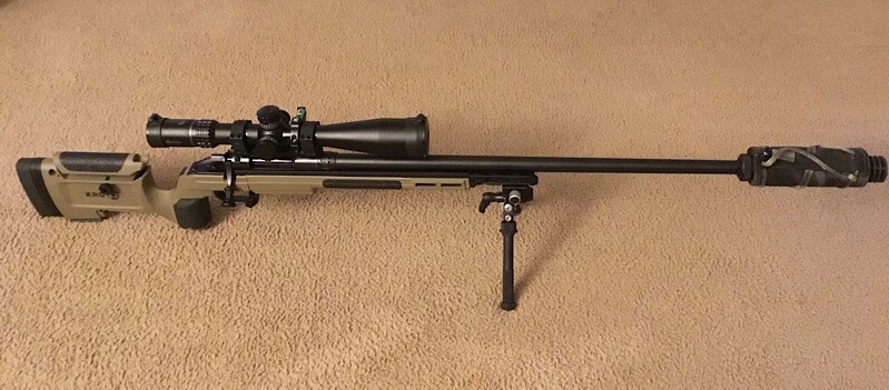

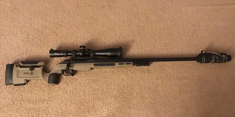

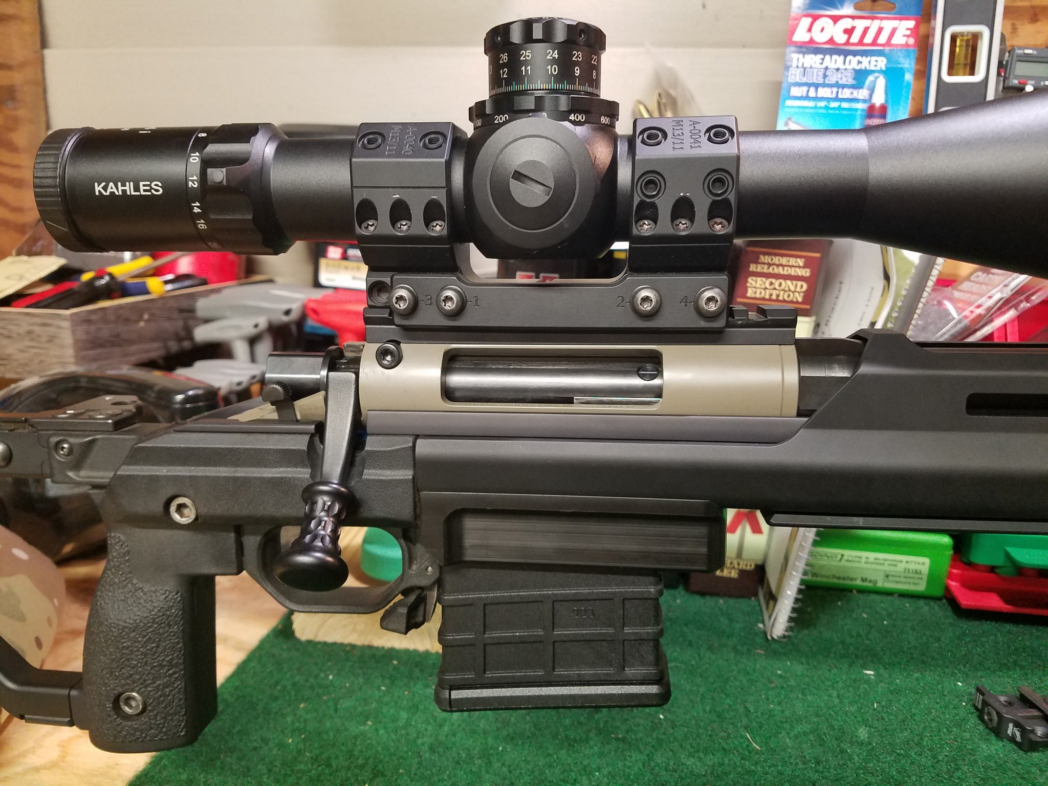

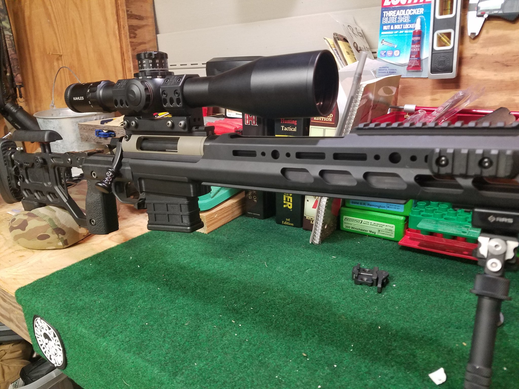

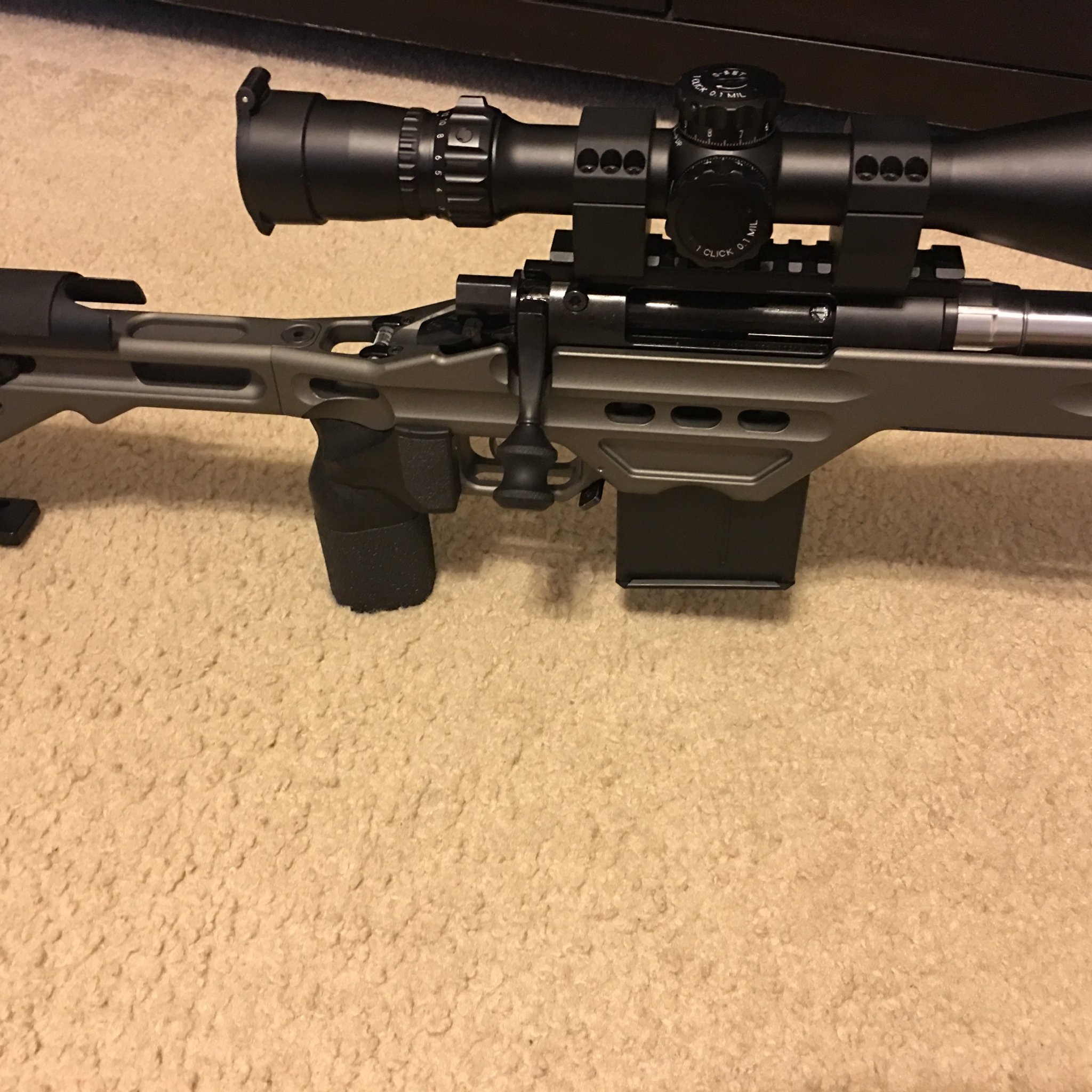

I put mine together yesterday.
Nucleus LH SA .473 bolt head - 30 MOA rail - Barloc
X-Caliber 20" 1-7 twist 5R Varmint contour threaded for suppressor - Chambered in 22 Creedmoor
TriggerTech Diamond trigger
KRG Bravo chassis with a LH Whiskey 3 backbone and modified shell to LH
Revic PMR 428 scope in medium ARC M10 rings
Now if it will ever stop raining around here,maybe I can do some load development.

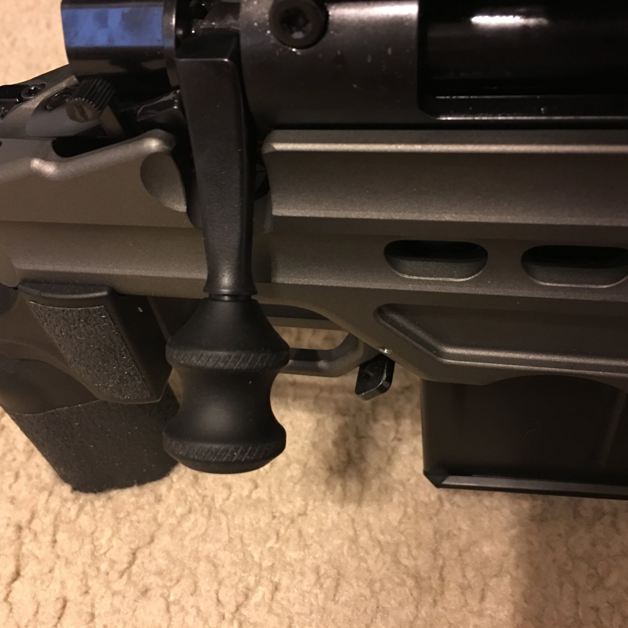

Has anyone changed out the bolt knob yet? If so......what's the right tool for that job.......strap wrench?
Used a strap wrench. Ended up going back to stock knob.
first one of mine was loose. second one wasn't much tighter. Doesn't seem like to big of a deal though. can use some blue loctite on it once I am sure I am staying with the factory bolt handle.

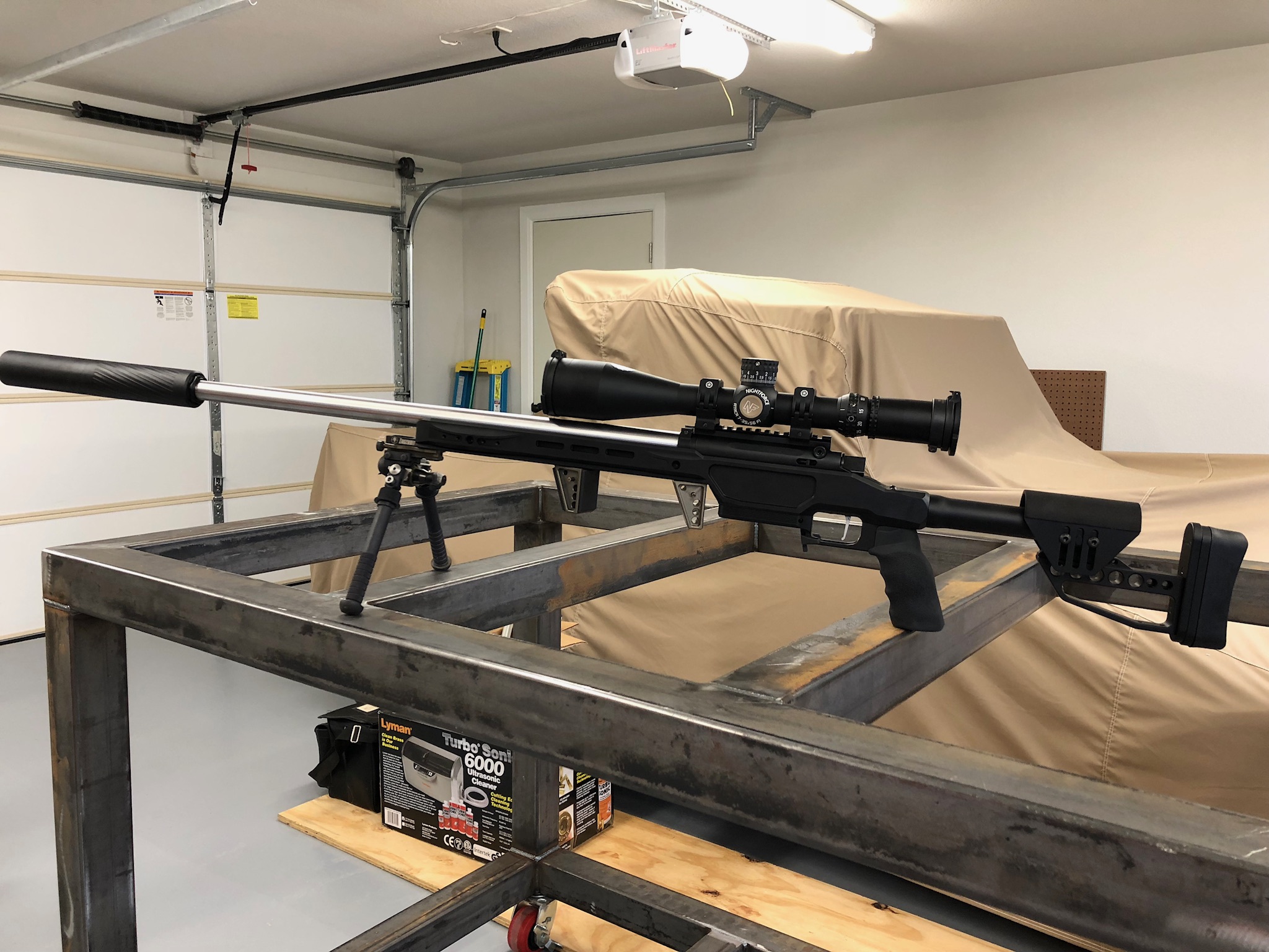

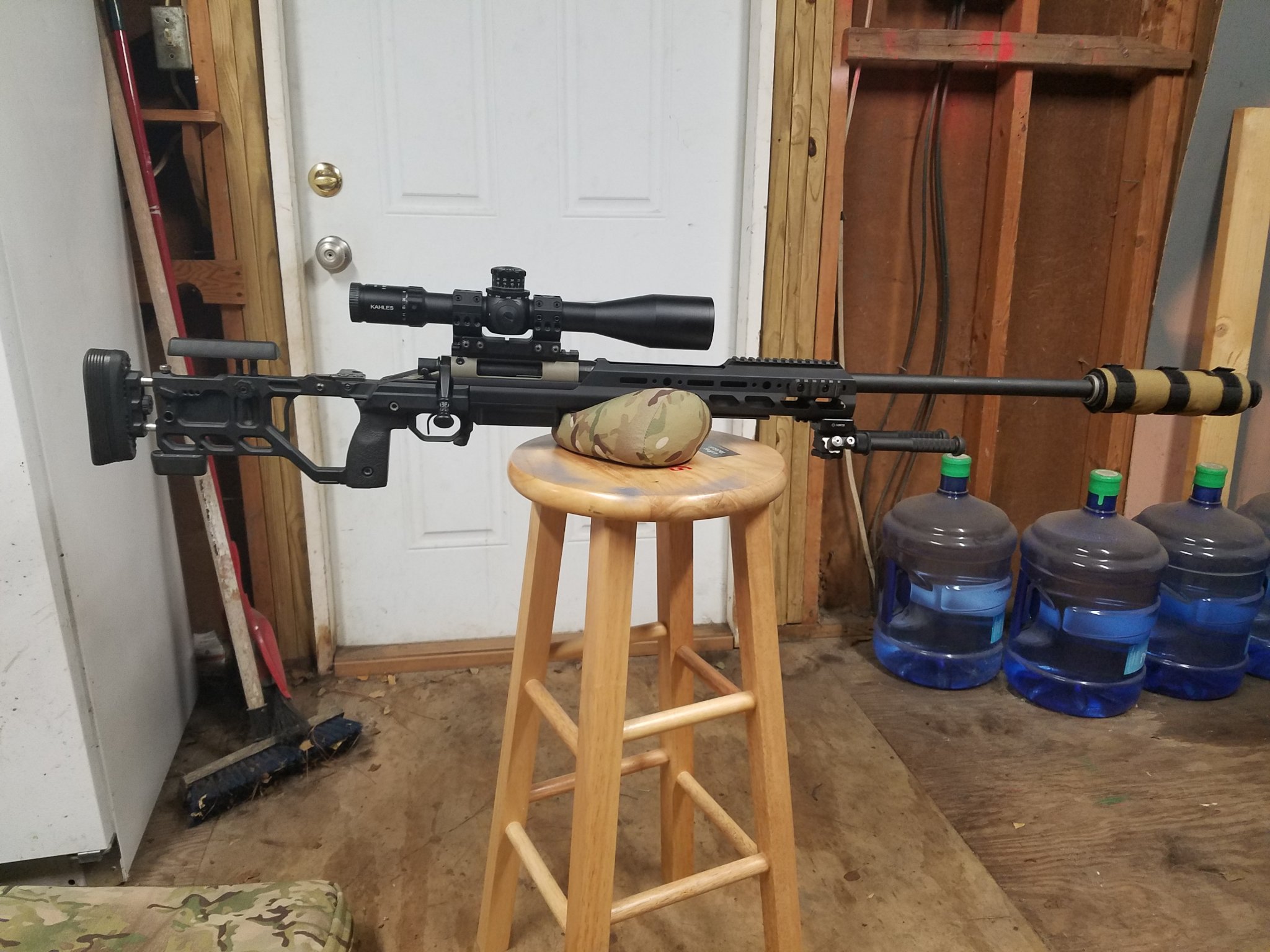

Another lefty.
ARC Nucleus 223 (trainer)
ARC Barloc
Criterion 26" 223 barrel
Area 419 suppressor adapter
Thunderbeast 6.5 Ultra 7
Triggertech Diamond flat
Killer Innovation Orias Chassis
MDT buttstock
Sawtooth Rifles arca rail
RRS Arca atlas adapter
RRS Arca chassis adapter
Atlas V8
Hawk Hill spiked feet
ARC M10 Rings
Vortex Gen 2 Razor 4.5-27x56

Here's some pic's of it,and after a couple range outings I found my load. I tried Reloader 26 in it,but with the shorter barrel I didn't have very good results with the 75gr A-Max bullets.
43.2gr of H4350 was just what it wanted with them.

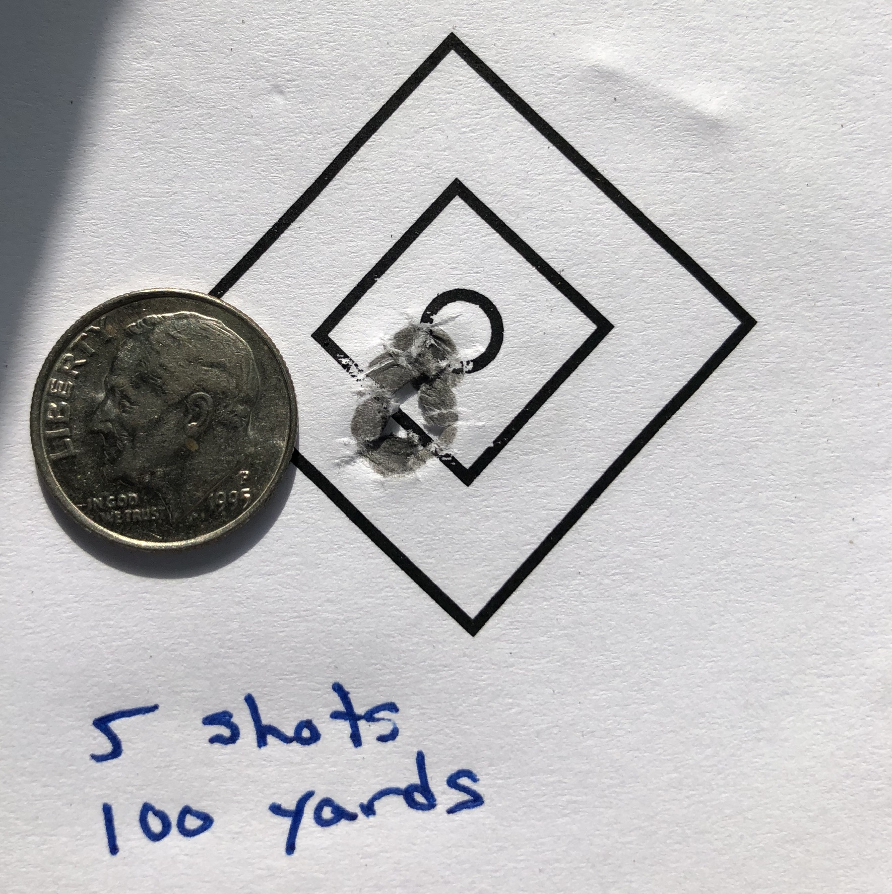

Bartlein HV 26" 7.5 twist
Berger 105 Hybrids
Stupid accurate
5 shot groups

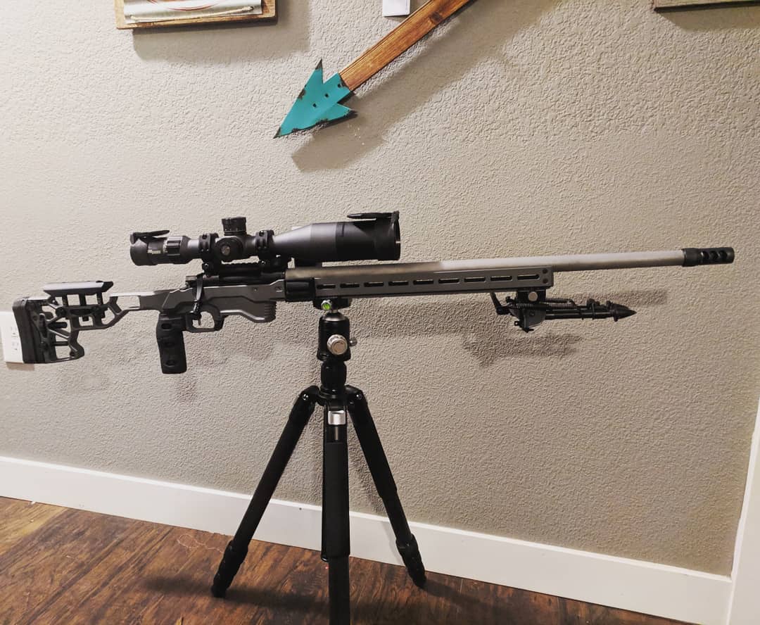

Figured I'd share my setup.
Bartlein 26" 1:7 left twist m24 contour 6creed
Trigger Tech trigger
Sig Tango6 5-30
MDT ACC Chassis
Reactions: BLKWLFK9

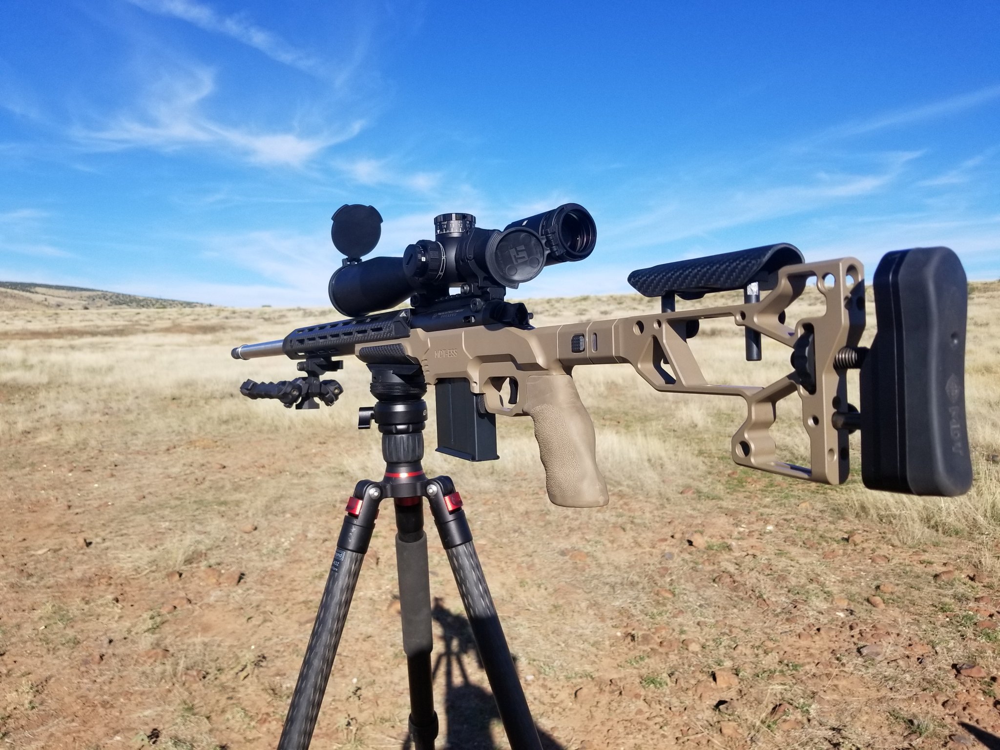

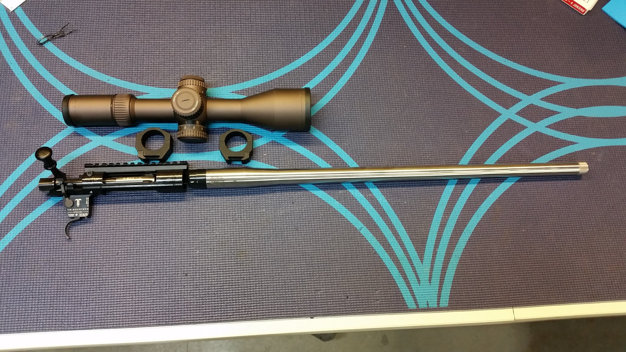

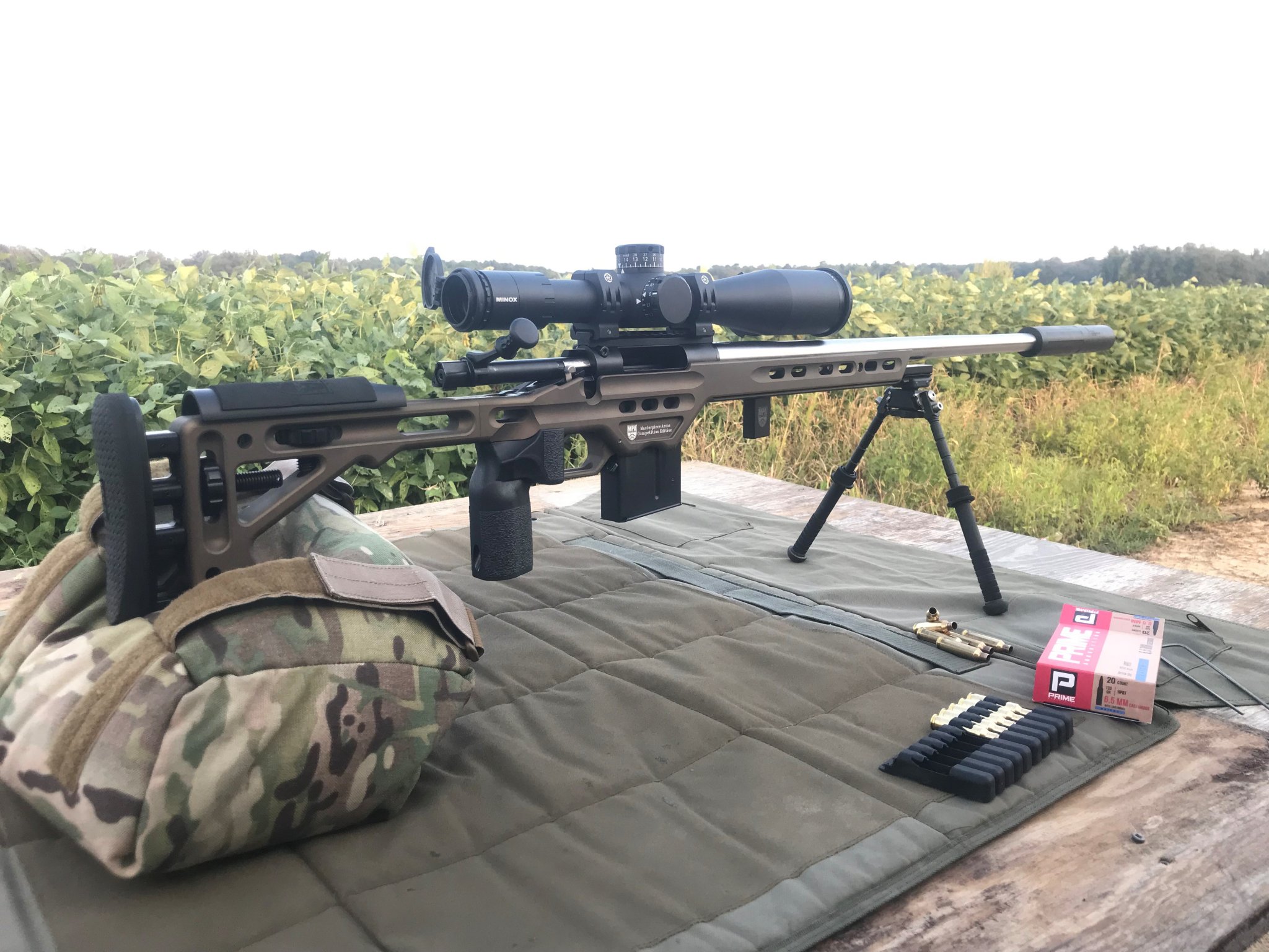

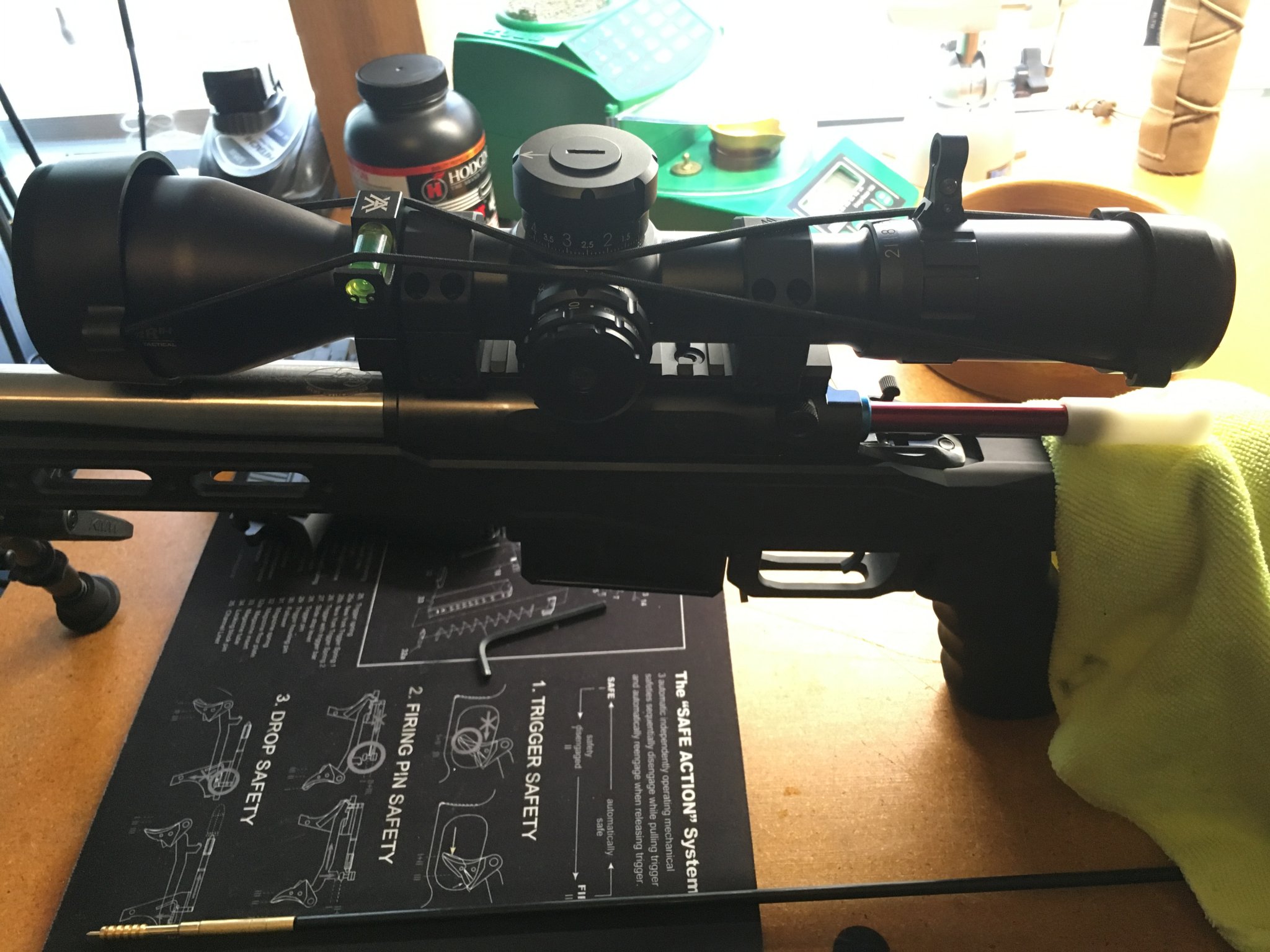

My first custom action!
Action: Nucleus SH w/ .475 bolt face
Stock: Manners PRS2 with gen 2 mini chassis in scorched earth
Barrel: PVA button rifled Rock Creek in heavy palma 6.5 creedmoor
Muzzle Brake: Area 419 Hellfire
Scope / Mount: Vortex Razor Gen 2 4.5-27 with ARC high rings
Accessories: SAP 2 round holder, Area 419 RRS accessory rail with Atlas PSR bipod.
Magazine: the 5round Accurate Mag functioned well, I have two 10 rounds on order from ARC
I'm terrible at taking pictures of rifles, here's what I was able to capture at the range last Saturday.
This last picture has my Nucleus next to my Tikka both in 6.5 creedmoor.

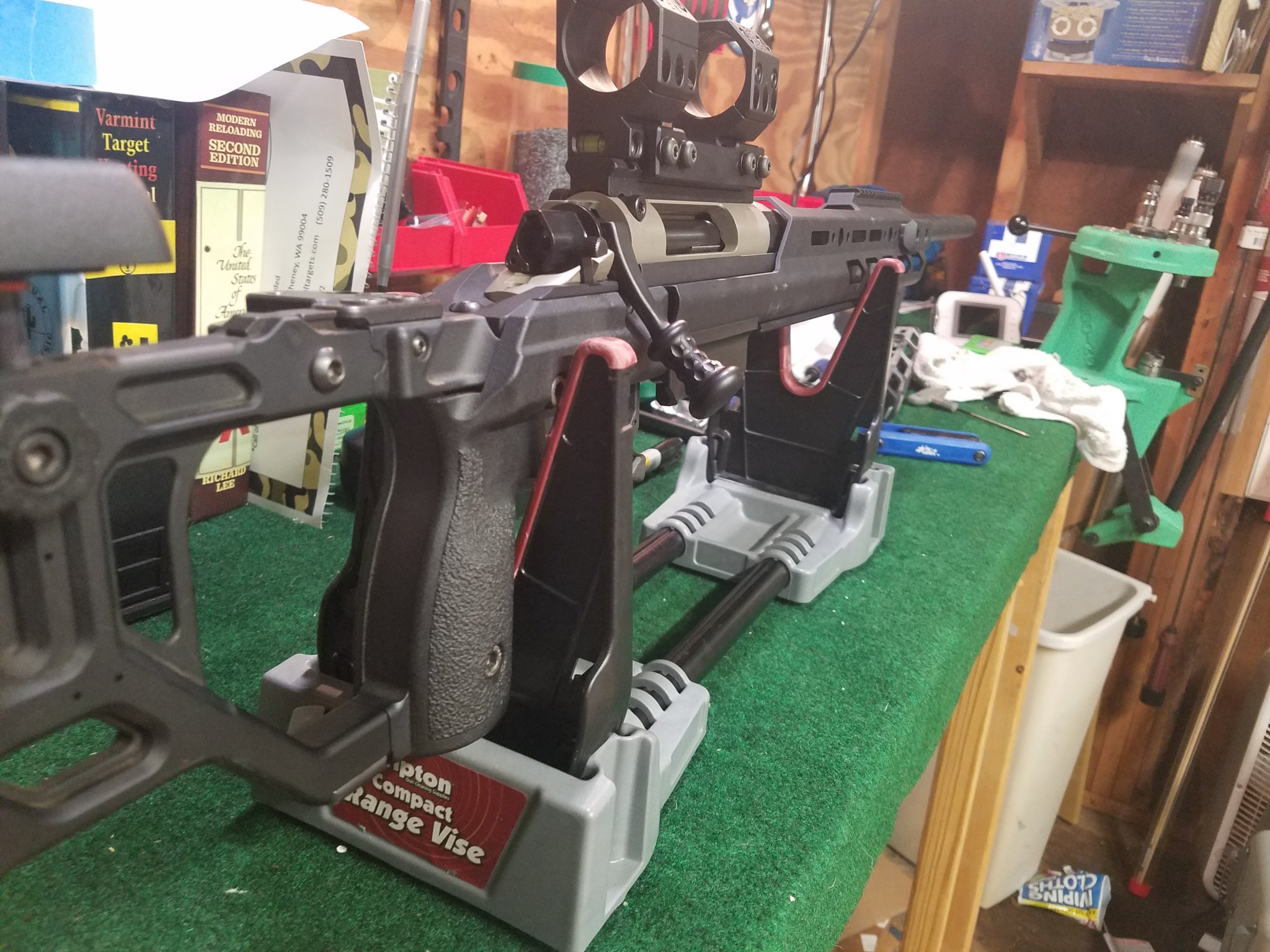

Took the Kahles off so it can go on the John Hancock, and put the BTR on the nuke in some ARC rings.

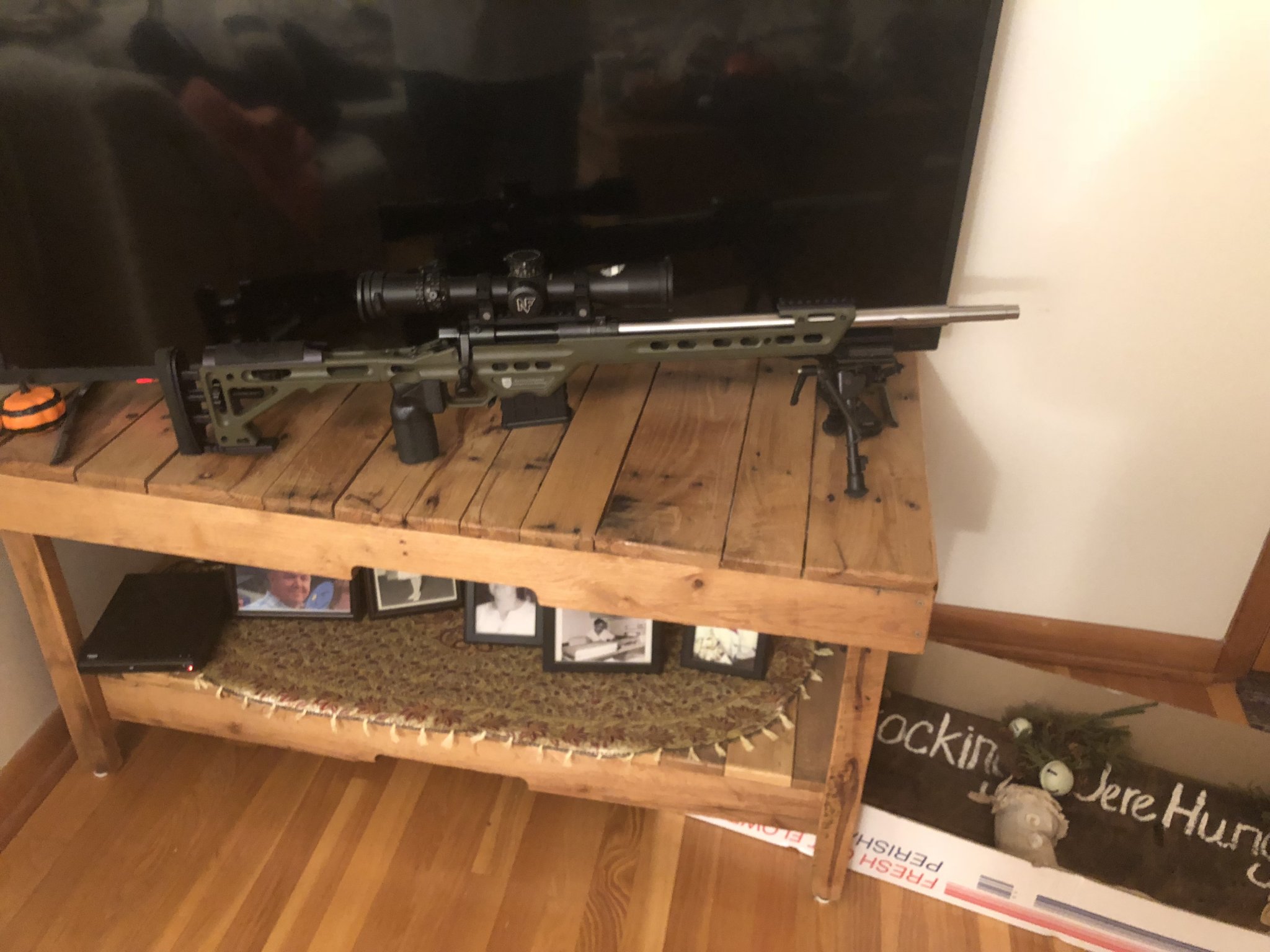

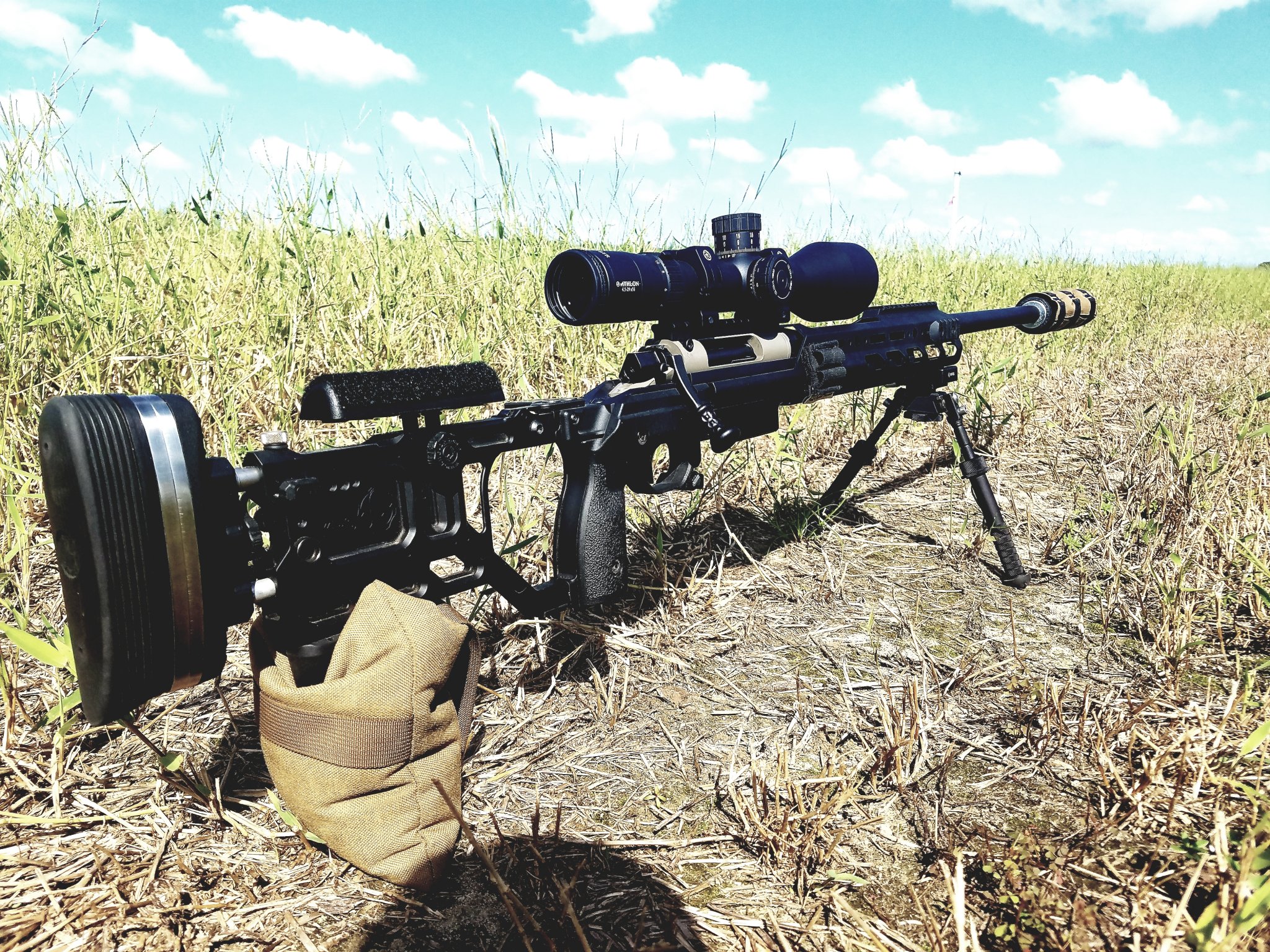

Just received my Nucleas a couple weeks ago. Might go with the MDT ESS or ACC.

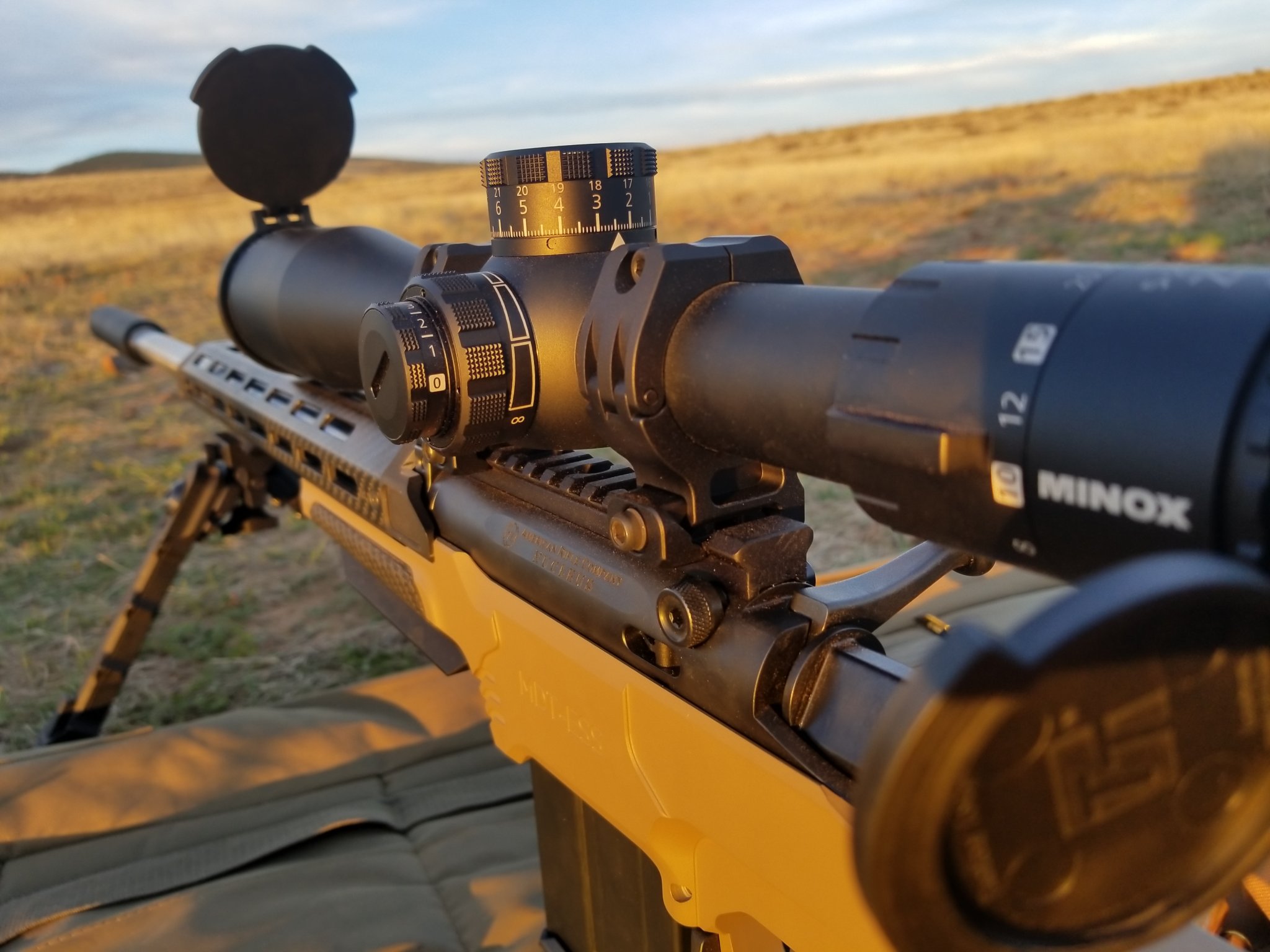

Finally getting around to pictures the build is
Nucleus SA with barloc
26" criterion mtu in 6.5 needmor
Mod 22 trigger w/safety
MDT ESS folder with carbon forend and ergo grip
Minox ZP5 MR4 reticle
ARC M10 rings
MDT 12rd mag
Accutac bipod
SAS Arbiter
