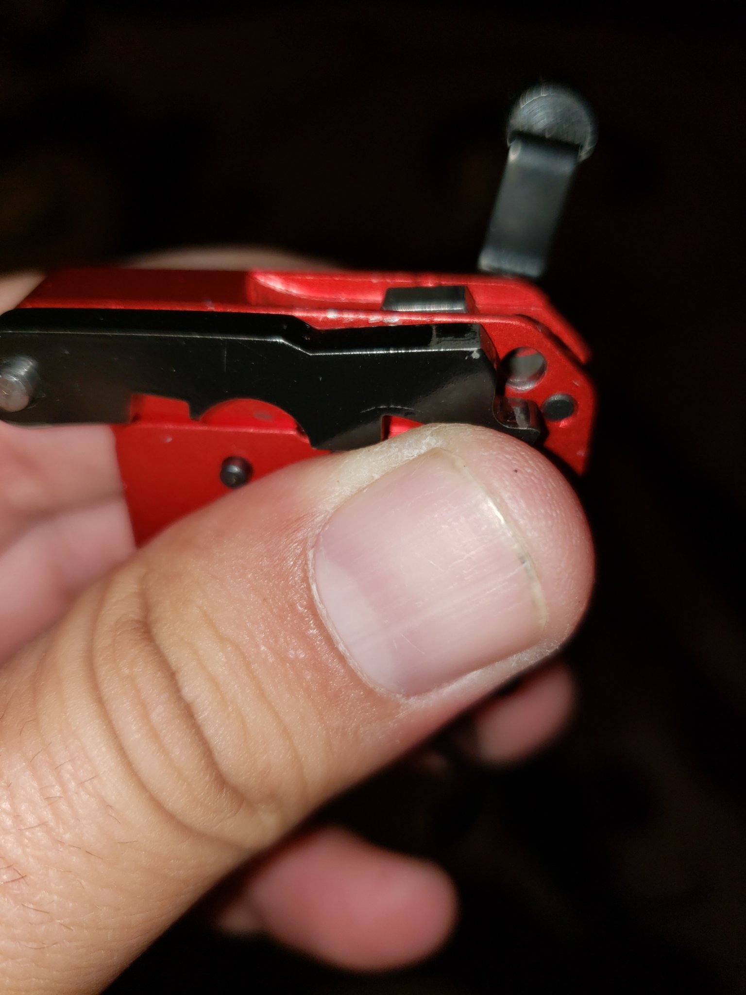

Hmmmm, I get a tiny bit of cock on close with my Huber. The longer trigger sear could do that. The Nucleus is listed as 100 cock on open. I wonder if I timed it whether I would start ftf issues.
Never a failure to fire over 400 rounds fired.

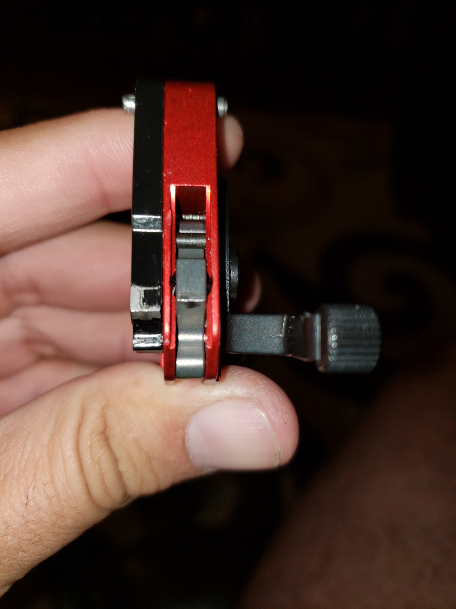

I also get cock on close with the huber. I also noticed that the huber doesn't drag on the cocking piece like the Calvin Elite does. I'm curious though, how do you time a trigger like the huber?
I don't know for certain. But, the cock on close happens in this case because the sear is further back, so the bolt cams forward as it engages the lugs while the pin spring compresses more.
To "time" it would be to shorten the sear (?) until it was the right length to hold the pin back at the exact point where the Nucleus cock's it. So the sear holds the pin at the same point it is cocked to by the bolt cocking piece.
Take too much off, and the pin is let forward with less spring compression, arecipe for light strikes.

Yeah, makes sense not to grind on the trigger... I don't know much gun smithing, hahaha, so I am not gonna mess with mine at all.
