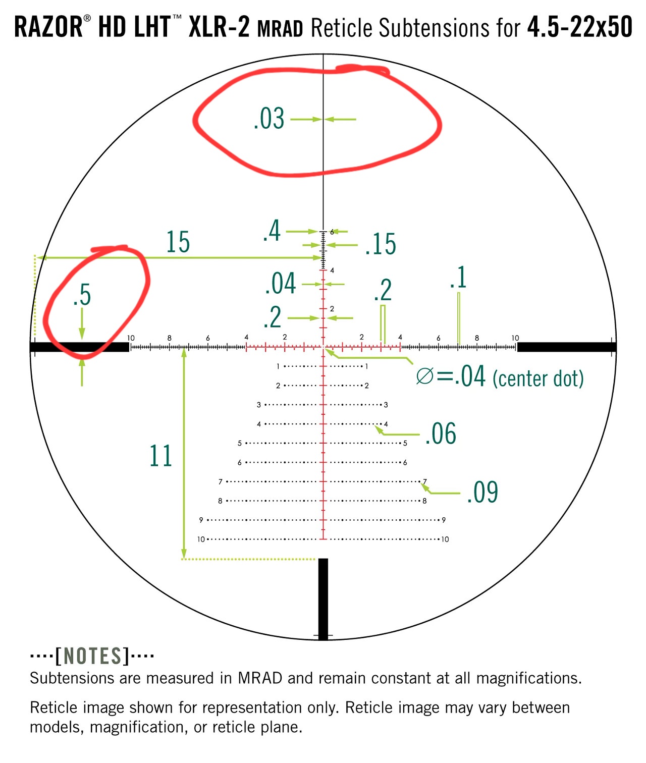

I think your asking about line thickness.
You have the spacings between hashmarks in the reticle diagram.
But the diagrams also denote the hashmark's physical dimensions (circled in red below).
You need to google the reticle diagram or go to the manufacturer's website.
Yeah line thickness exactly. I did refer to the diagram on the nightforce website but they don't break it down scope by scope they just quote a few different crosshair thickness for different mag ranges like 4-16, 5-25 so it wasn't conclusive. That or I am just not knowledgeable enough to comprehend the information there.
