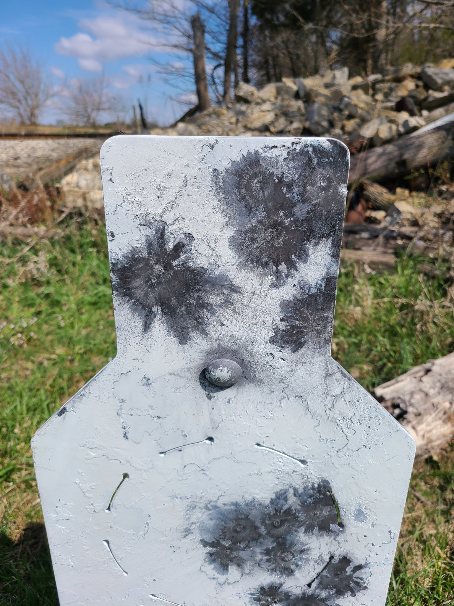

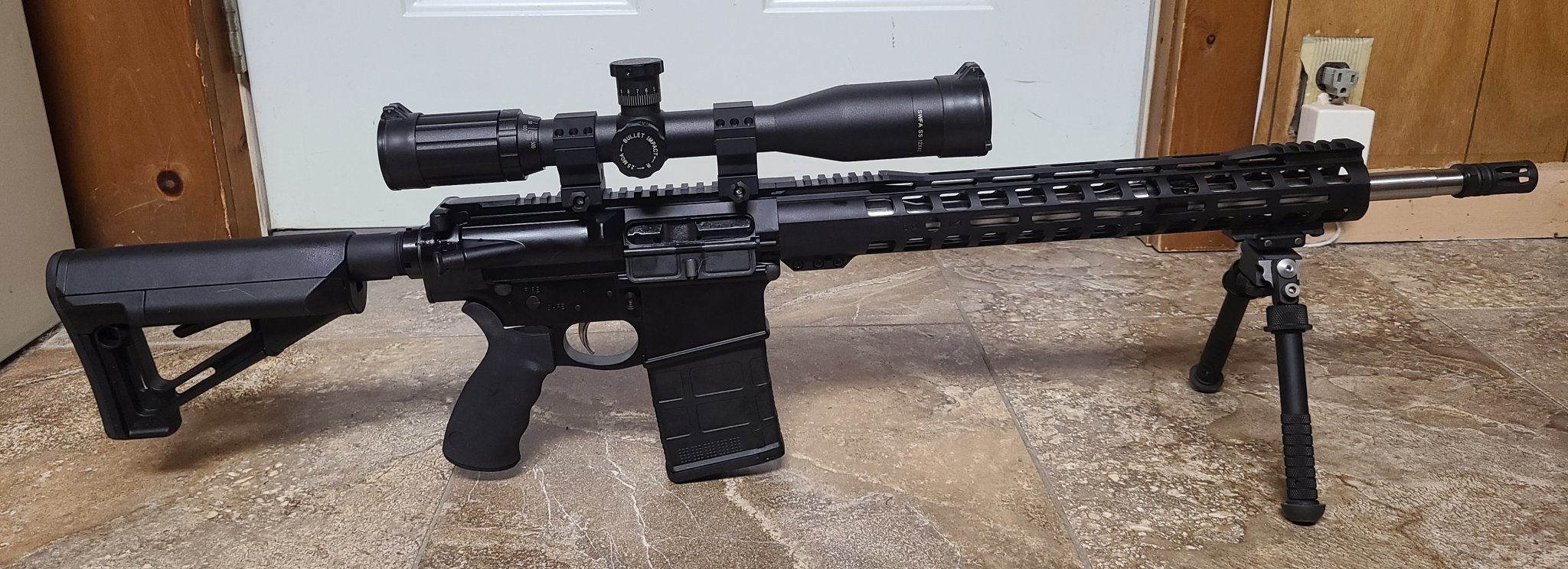

Here she sits in current configuration, and the 4 shot group in the upper right of head measured 2.09 CTC from 200yrds with Winchester M80 ball. I know 200 isn't much for range, but it was all I had that day for the short time I had to sight in the scope and get a feel for the new rifle.
