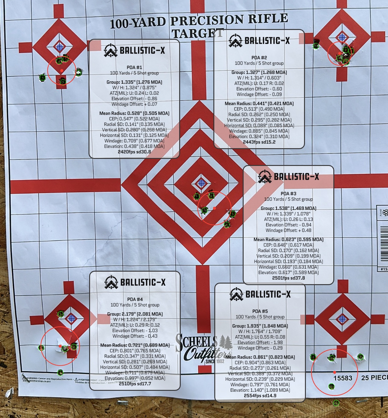

Rifle is an ar15, sionics upper, 16.1” total barrel length, 14.5” sans flash hider, 2-10x32 pstII scope. 75gr hpbt, h335, lc, cci #400 22.0-23.5grs in 0.3 increments. Aiming point was middle of each diamond. I shot clockwise on the left target and right to left on the right target. The high bullet bottom right I know I pulled. I’m thinking my load is around 22.3. I can overlay with ballistic x if someone desires.
It’s not a precision rifle, sionics says their barrels are 1.5moa. My normal load is the single target for reference. I was a little hurried in shooting it as I needed to leave for work. Poa was top of big diamond.
Thanks for any advice.

All rounds were ejecting 3-4 oclock today. I don’t run factory ammo, only my handloads. Everything fed good and I only did one round in the mag at a time to give the barrel time to cool, bolt stayed open with each. I didn’t run it over a chrono, but these must be a little faster than the smk I posted that I normally run. They were hitting about a moa higher than the smk which are 2503fps.
First off with the 223 the nodes when they show are only about +/-0.1 gn so the ).3 charge increment can skip it. Normally you should use 0.2 gn.
The target displays what can be a common issue with OCW being shot round robin. It also test the shooters ability to duplicate the same shooting on each group multiple times. It tends to cause the shooter's group size to open up. I see 22.3 as a possible node but it would need verification. We seldom describe what we mean though. In this case I would load 22.1, 22.3, and 22.5gn. Probably 3 or 5 rounds and shoot with a fouled barrel and not round robin. Then look at the group mean POI and precision between the three loads. You then have a "feel" what groups may look like and also how the POI changes. It should not change drastically. If it does then it is probably barrel harmonics and you are away from a node. But keep in mind 223 nodes usually are only a couple of tenths wide. Shot at 100 yds any vertical movement in the POI is like the result of barrel harmonics and not velocity differences.
Thank you for that. I will go back and run it in 0.2 from 22.1 but go to 22.7 just to see. I think some of the vertical spread was cheek pressure on my part.
So I went back out today, didn’t do round robin. 5 on each. I know I pulled a few. Poa2 #5 poa #4. I think I need to run it again. I did it over a chronograph and put the velocity and sd at the bottom. Top left -right- center- bottom left-right 22.1-22.9 in .2 increments. I think somewhere between 22.3-22.7 though. They are slow and wish I could see a node in the 2540 range.
If you're going to run an 'OCW' test, do yourself a favor - put all the targets on one line.
Either flip that sight-in target over, or bring a couple sheets of copier/printer paper stapled up side-by-side ala 'landscape'. Strike a line across the blank sheet (a cheap 2 ft construction level works fine), and put your aiming points on that. Having them all in the same plane makes visually interpreting things *way* easier.
Waste of time. Not enough data to get past the noise. OCW is a boomer tool and doesn’t even work. Load to a velocity you like and go shoot…… You’d be better off experimenting with a different bullet or powder if you want better results.
