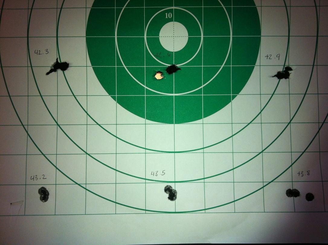

Shot these today. Rifle is a Savage 12 FTR .308. Lapua brass, varget powder, Federal primer, .018 off the lands. All rounds were shot in a round robin @ 3 shots each Any input? First time trying the OCW method. I'm kinda puzzled.....
Thanks,
Rob

43.2 or 43.3. Groups on either side are same point of impact more or less. Also, the flier in the 42.6 group indicates a "scatter node". According to Newberry OCW should be 1.5%-ish above that. 42.6 + 1.5% = 43.23.
That 43.2 group looks great as is.

Dude, use 43.2. It's obvious and right where you said others with your rifle found their load (within 0.2 grains).
It was asked rhetorically above by shoot4fun whether those were scatter nodes or just disappointing shots. The fact that the 2 odd groups with fliers are 1.5% above and below the tightest group that also has the same POI as the groups on either side points to those being scatter nodes if you subscribe to Newberry's theory on OCW. It also points almost definitively to 43.2 being your OCW.
Load some and try again, run them over a chronograph to see what your velocity spreads are, I'll bet they look good. Shoot4fun gave you good advice if you wanna play around with it and see if you can come up with anything better, but I'd go with 43.2 with the shortage of components at present.

Cool deal, just didn't expect to be done with the testing so quickly. Thanks for all the help.
Rob
