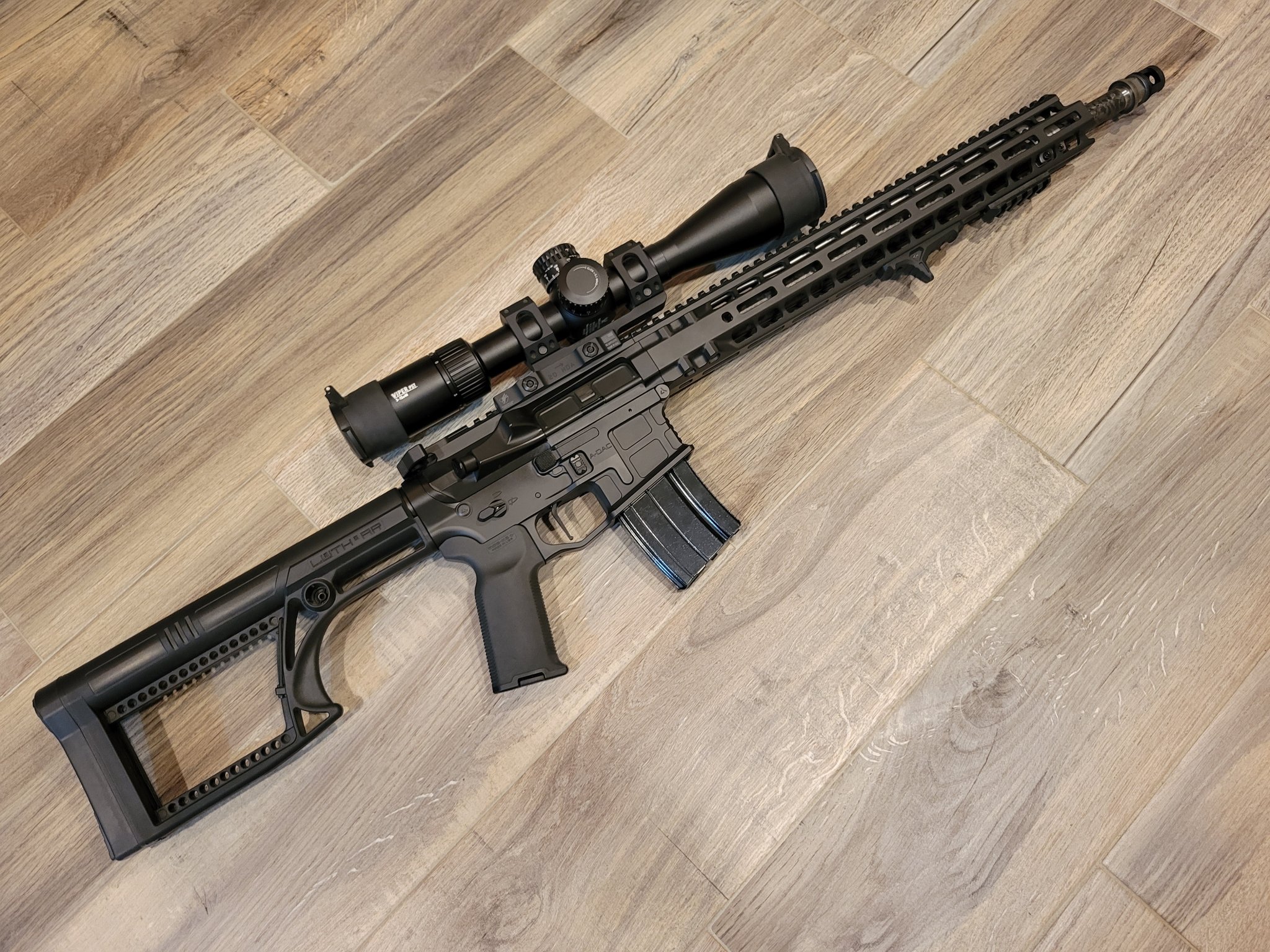

Here's one more data point on the proof. I did have a weird poi shift during break in as the barrel heated up the first time but haven't duplicated it since. I honestly need to shoot it more. I really like the rifle - radian kits are a bit heavy but the rifle only weighs 6.4 lbs with all the Ti and carbon stuff.
I really dislike temp instability in rifle rounds (I live and shoot in Utah from the teens to the hundreds) and this group came while testing Varget and xbr8208. Need to get back out to confirm.

Quick update - as the barrel has sped up, this load now shoots 2513 fps at 29 degrees Fahrenheit with an SD of 10.8. if that means 2530 or so in summer months I'm stoked.
Comfortably sub MOA with both 108 ELDs and 105 BTHPs. Seems to prefer the 108s. 10-shot groups at .75-.87" - many 3-shots under .5".
Crazy as it sounds, I really think the amount of pressure on my bipod had as much or more variance as the setup.
Out of the country now, but will be stretching it out to 1200 yards or so when I return for final thoughts.

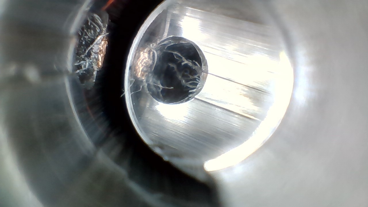

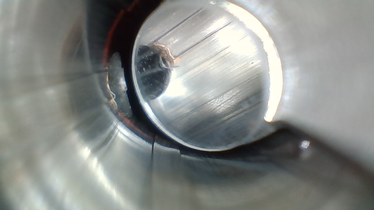

The port is dead center on a land. Looks like it was pealing copper and it was building up.
I think with a plus 2" gas & the larger port it requires (.101), it becomes more important that the port fall in a grove or at least is somehow deburred.
I've got some .055 abrasive cord & polishing cord. My thought is to slide a piece of break line in the barrel from muzzle end stopping just shy of the port, tape it in place, & thread the cord through port and break line. This is if Odin ever gets back to me and Green lights it. If not they can have it back.

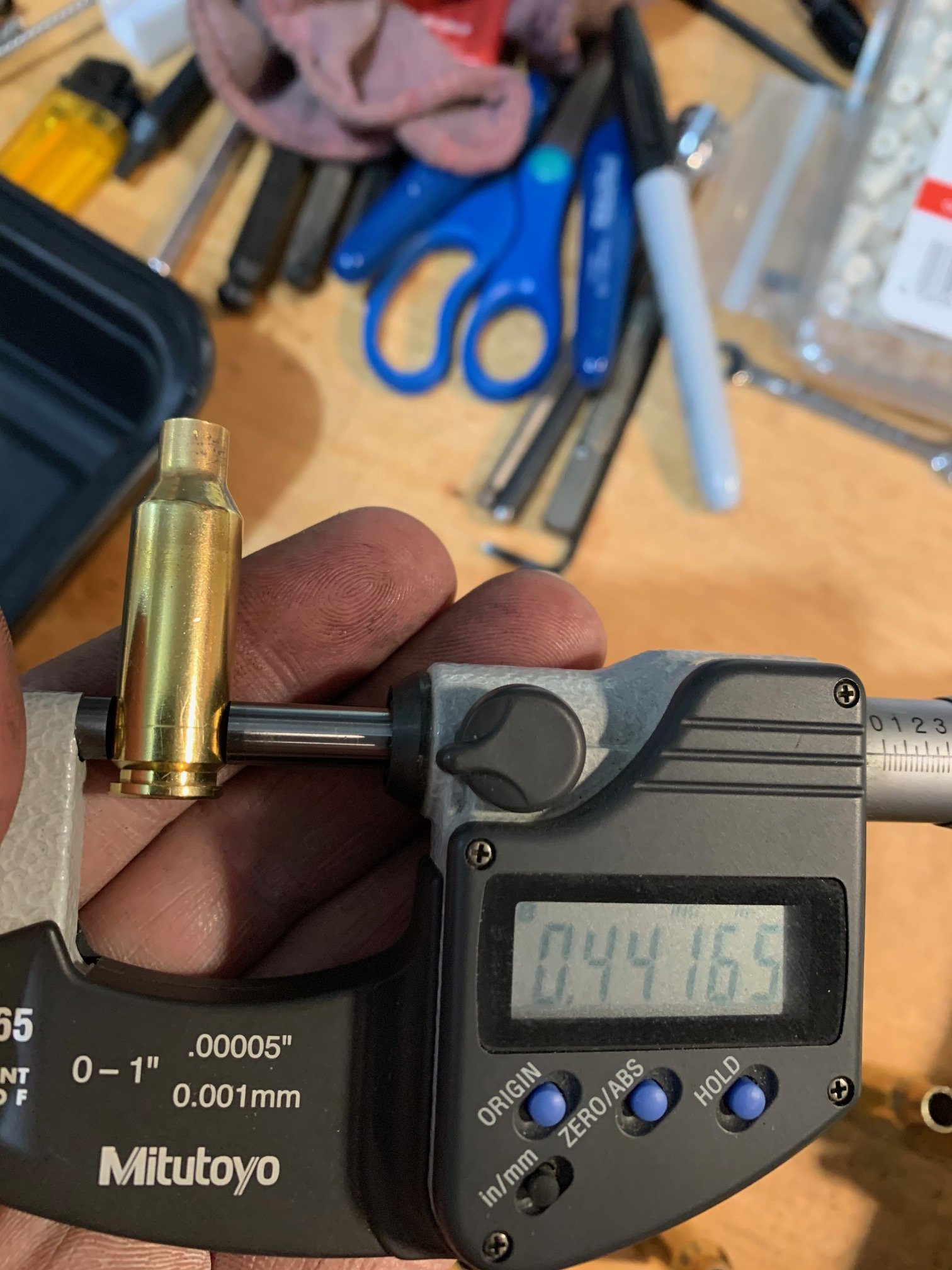

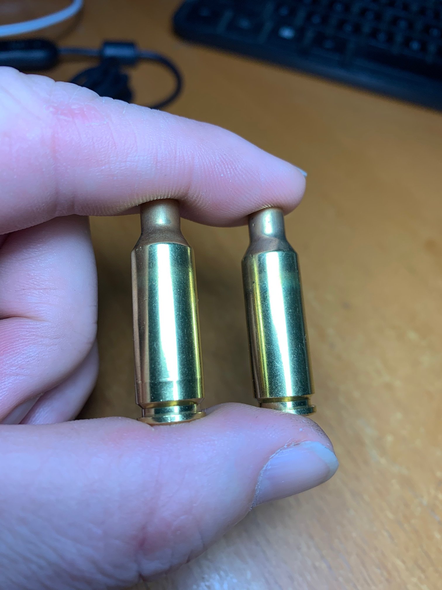

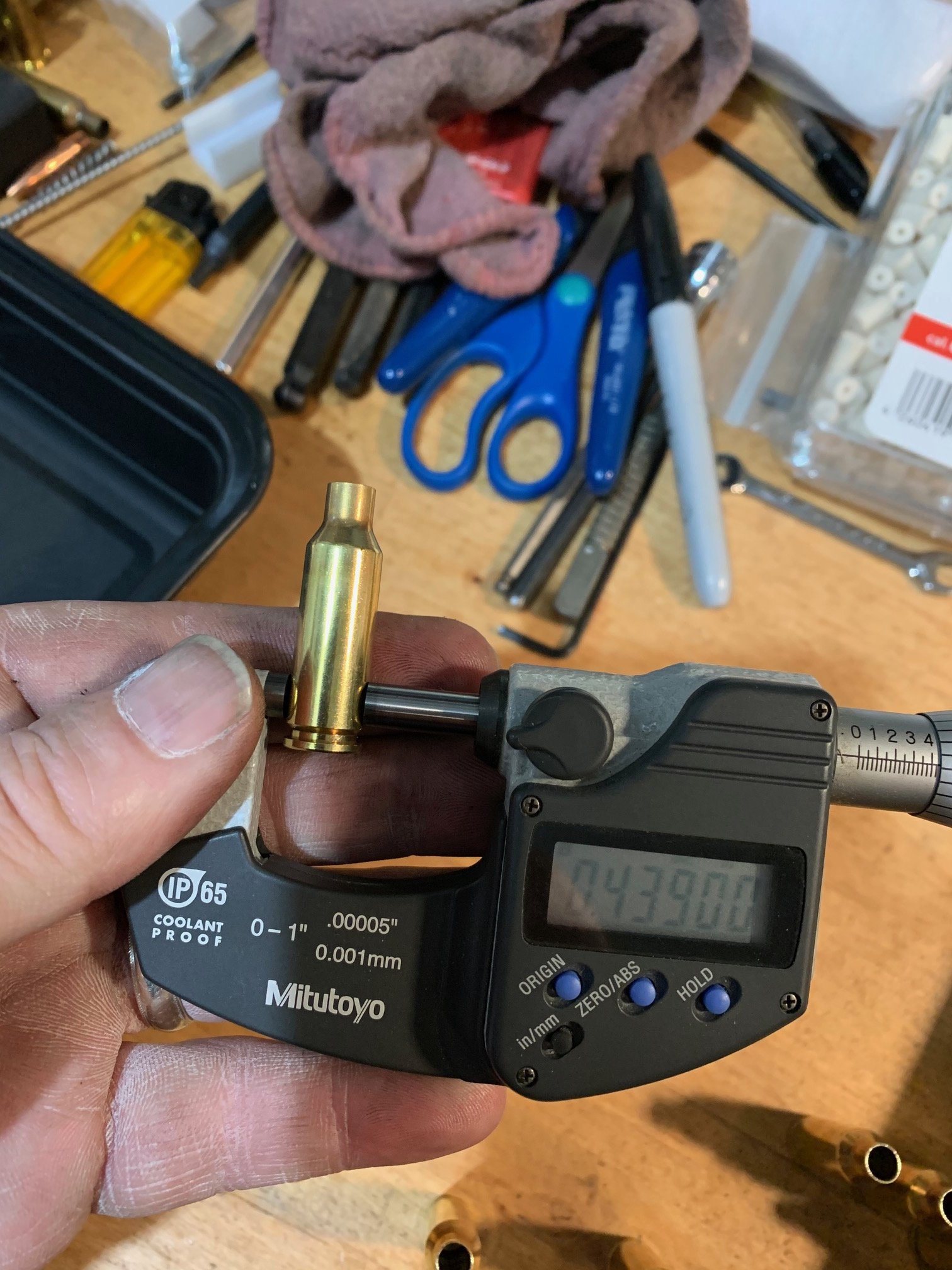

This didn't exactly inspire confidence either. Not blaming this on the barrel though. Head space was perfect on the Go guage with Maxim bolt.
Hornady factory loaded Ammo was .012 short of a fired case on head space & apparently some brass does all the stretching in the unsupported area & some does not.
Had 7 out of 50 look like the case on left. Anyone else have this happen with the factory ammo?

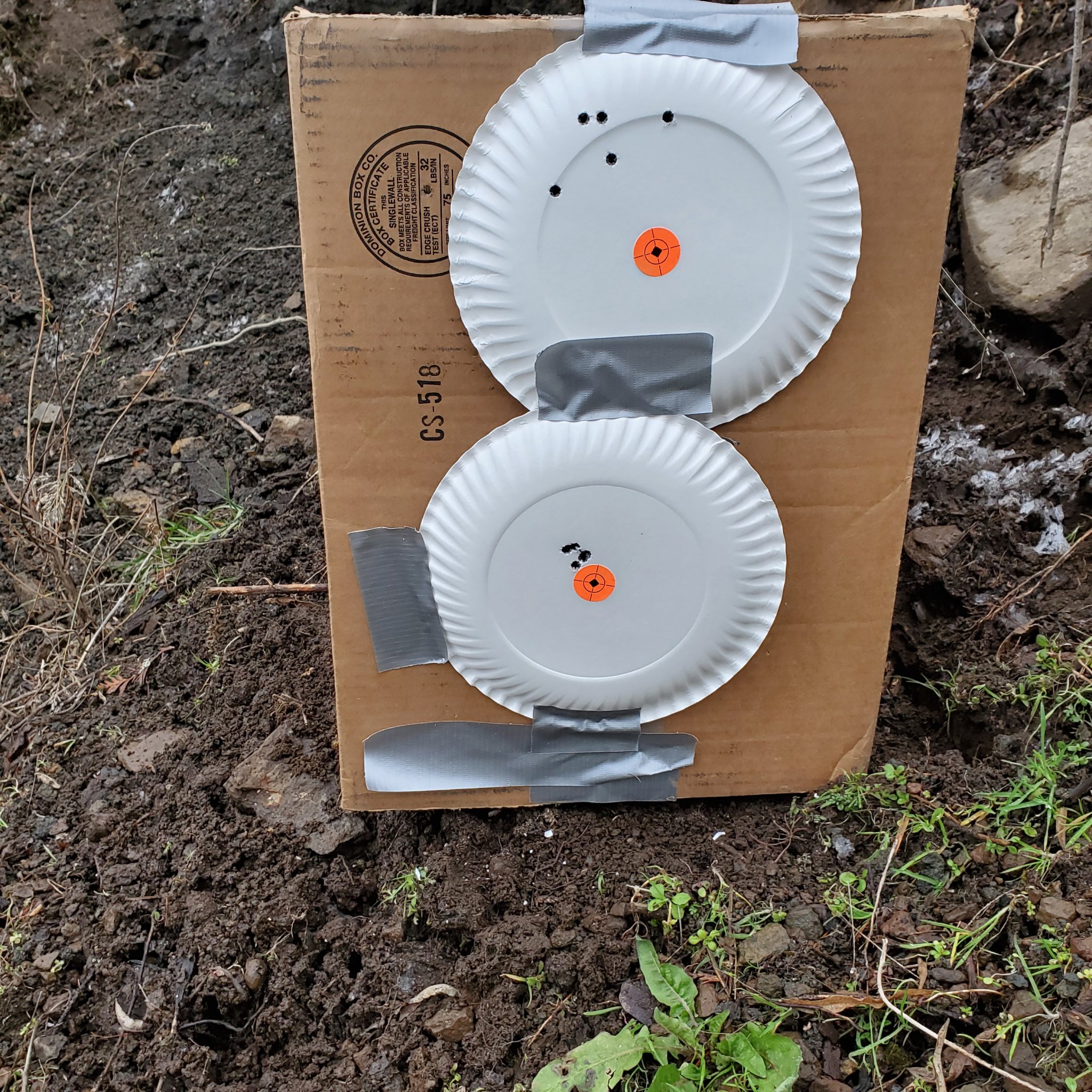

Top 6mm ARC group was a BA barrel, the borrom 6mm ARC group was the first 5 shots fired out of a Proof SS barrel 1/2" ...same 108 gr ELDM load, I only use hand loads in all my firearms. All My Proof SS barrels shoot like that...or better. So that is why I recommend them...hope the next one is good too, & wondering if their quality is slipping or other factors are contributing to these new found inaccuracies.
