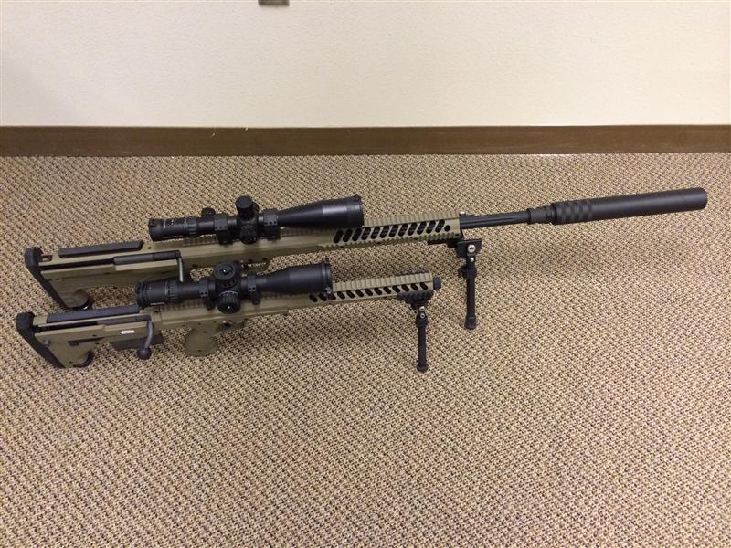

Here's a crappy pic. Running a NF 2.5-10x32 in a GDI mount for now, and a Sandstorm suppressor.
