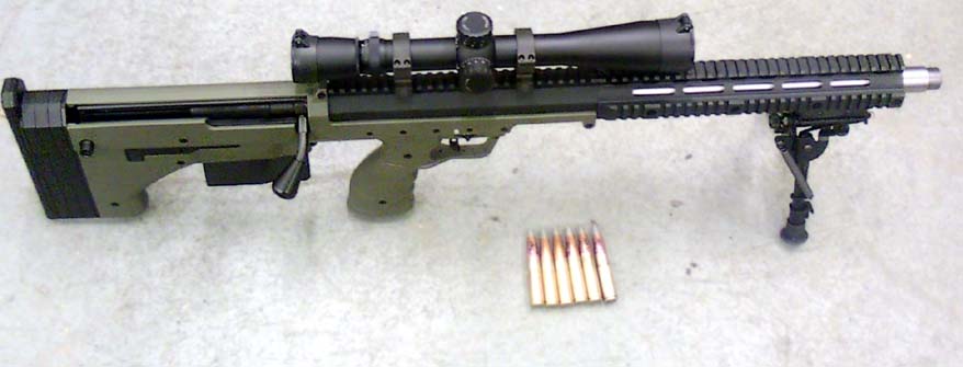

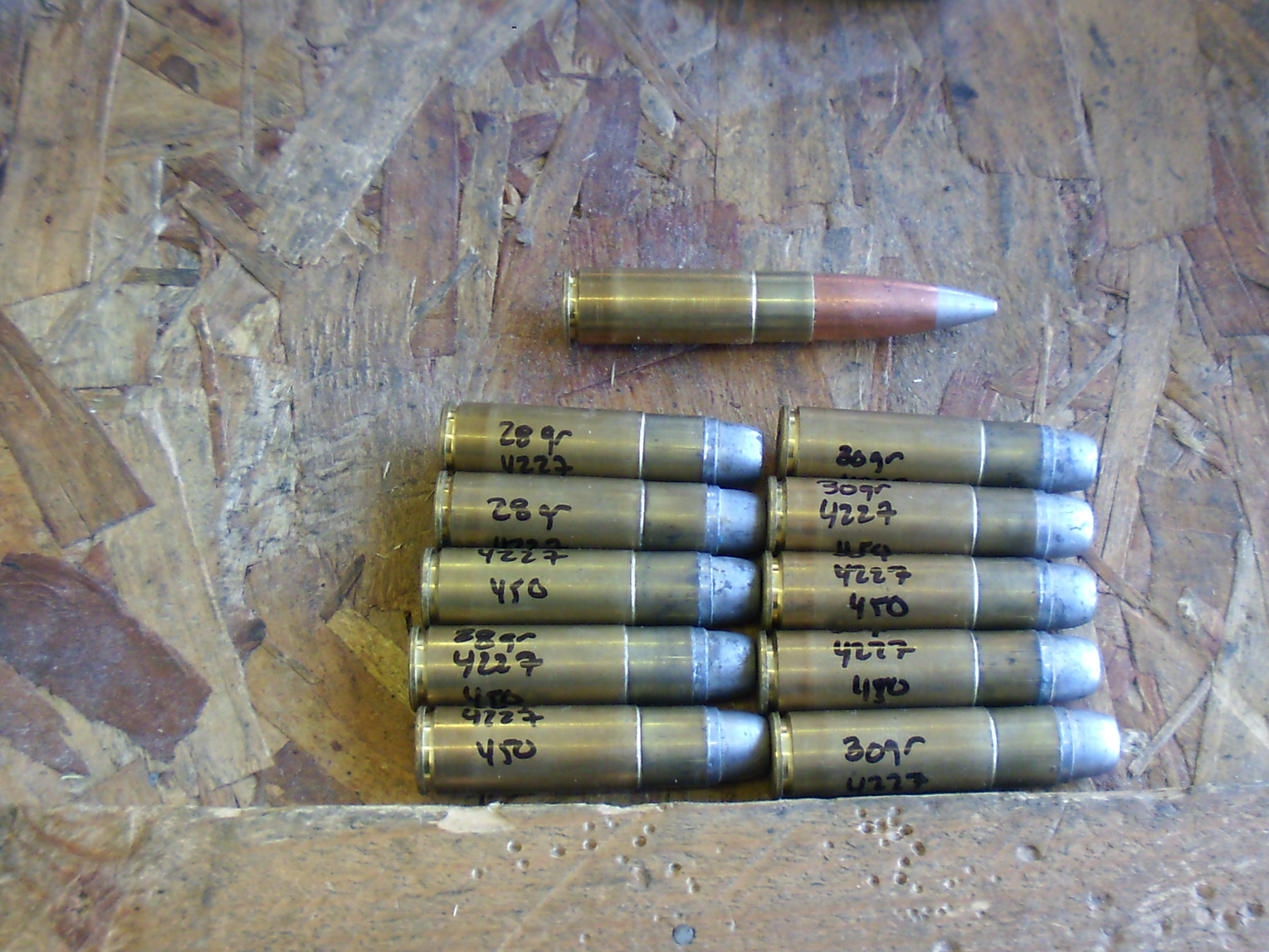

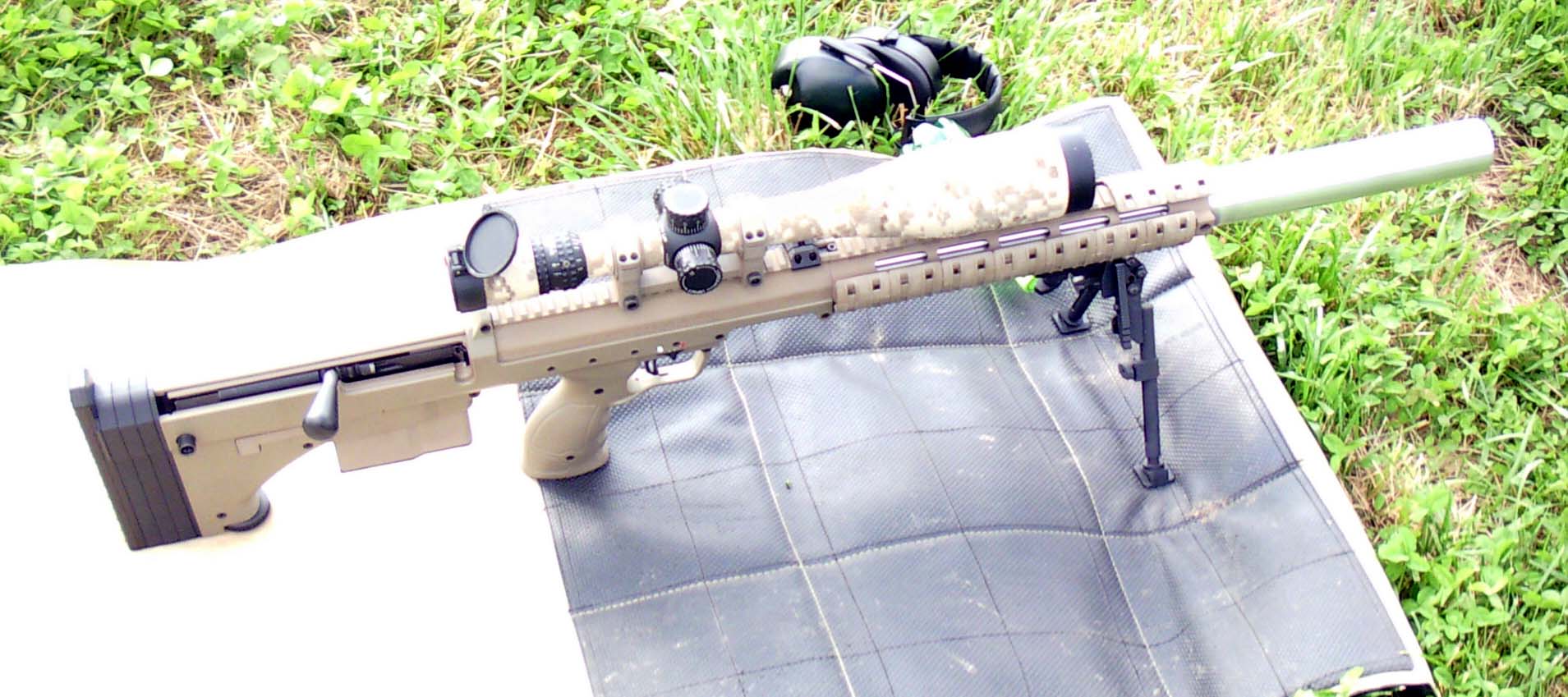

Here are some pics of the cartridge. Its based on the 338 Lapua mag case cut down then a neck turned on it. I don't use a lathe to turn the cases in the sense that they're cut on the lathe. I do use the lathe to turn the neck turner however so it does make life a lot easier. As Dogtown noted the cases are a little annoying to make but I've got cases with 25 firings and no loose primers or cracked necks. Shooting them subsonic really doesn't stress the brass much. Even the supersonic loads don't seem to wear it out much. Point is once you've got it made up its good for a long time.
I've made up quite a few barrels for the DT's and they work great. 16" barrels are great and perfect length for shooting the subs.....work well with supersonics too. Suppressors can be made from aluminum due to the low pressure and large bore dropping muzzle pressure. As noted the long boattail BMG bullets will fly well with no shockwave to disturb them. High BC keeps the velocity up at long range. Most of the calculators show with a starting velocity of 1050 fps you will still have about 850 fps at 1000yds. There is the huge drop issue but with consistent loading it will be a consistent drop. I've fired my 12.7X48 at 800yds and hit things I aimed at consistently. You also have the option of shooting active bullets like tracer, incindiery, etc. Neat flashes and traces etc....They're a lot of fun. Pictures show some cast bullets with gaschecks loaded from subsonic to about 1800fps. They're 450gr while the API pictured is 650gr and subsonic. The one on the far left is a development for Indiana deer hunting with the case shortened to 1.79". We can hunt with rifle cartridges with over .357 dia bullets and cases shorter than 1.8".
Hope the pics help.
Frank

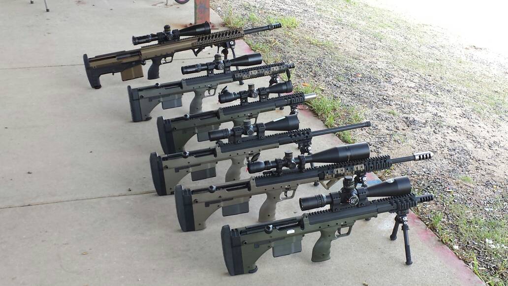

Representing DTA from the land down under
Holy shit man, is that Little River? Ive seen a few of those SRS's and that HTI there before, but i didnt know there were that many down here. I sold my SRS to fund an AI AT, but that photo is sick. Nightforce, S&B's..... And i didnt know anyone here had a BEAST yet.
