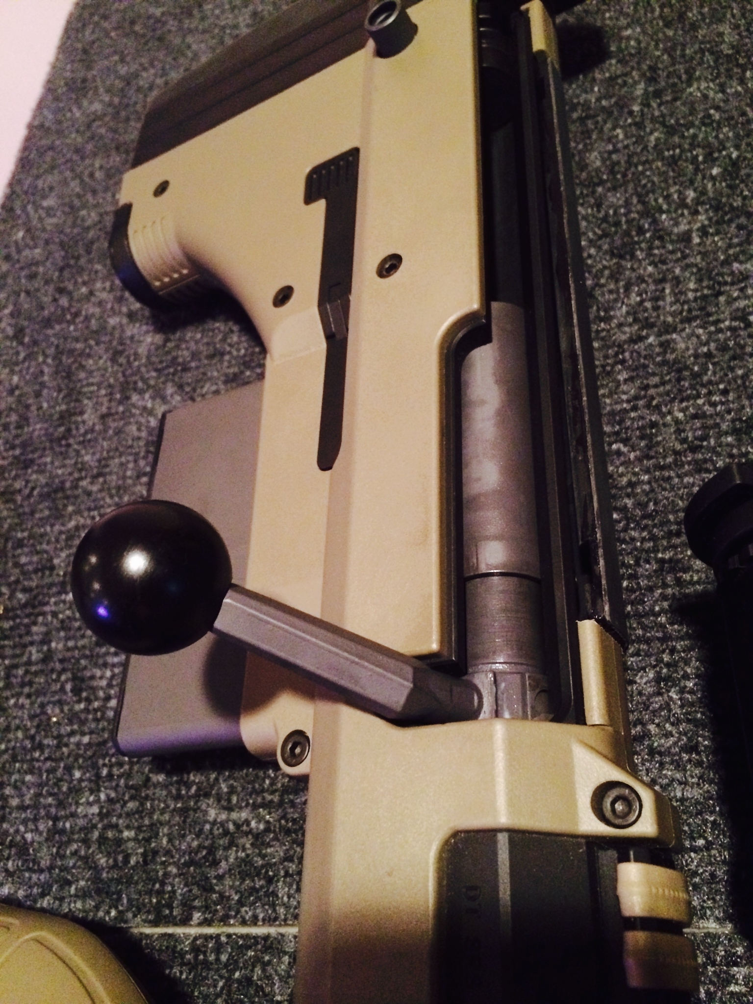

DTA New bolt style 338LM
Hello all,
Just wanted to share my experience with DTA CS and Ryan. What an amazing service he has provided to me. I am a new owner of SRS A1 and ordered a bolt for 338LM. This is the bolt that I received today. It looks different then my standard 308 bolt. Ryan said that they changed the design recently.
I really like the new design of the bolt. Does anyone else have this bolt design?
Ryan, if you are a member here and reading this, thank you for great service! I am a DTA customer for life now. Cant wait to put some rounds through the 338LM conversion.
Happy shooting!

Hello all,
Happy shooting!
