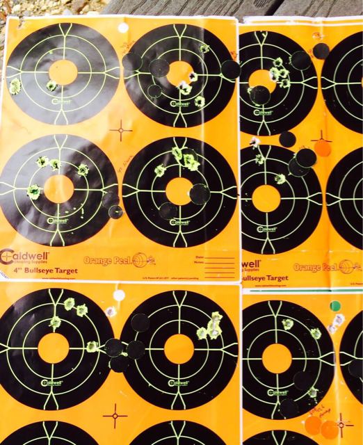

Range result 200yards 260 rem dta A1. .020 off the lands. 1st row lapua scenar 139, second row 140 amax and 3rd row 142 sierra. I used H4350 for all 3 bullets. Best group was with sierra 142 bullet 0.697in center to center. What should I do next?? Should I play with bullet seating? I was getting 2789 velocity with SD of 10. ImageUploadedByTapatalk1408236728.464731.jpg
