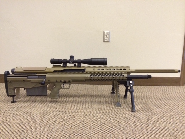

Some of you guys may know we are a nightforce dealer. Others may not. Either way, I always find it humorous to listen to guys talk up their 50BMG's in my presence. ... and then I show them mine.
Here's a customer's M107 that came in for a scope and mounting. I know which .50 I'd rather have! Though the 107 would be nice if guarding a checkpoint. ;)
