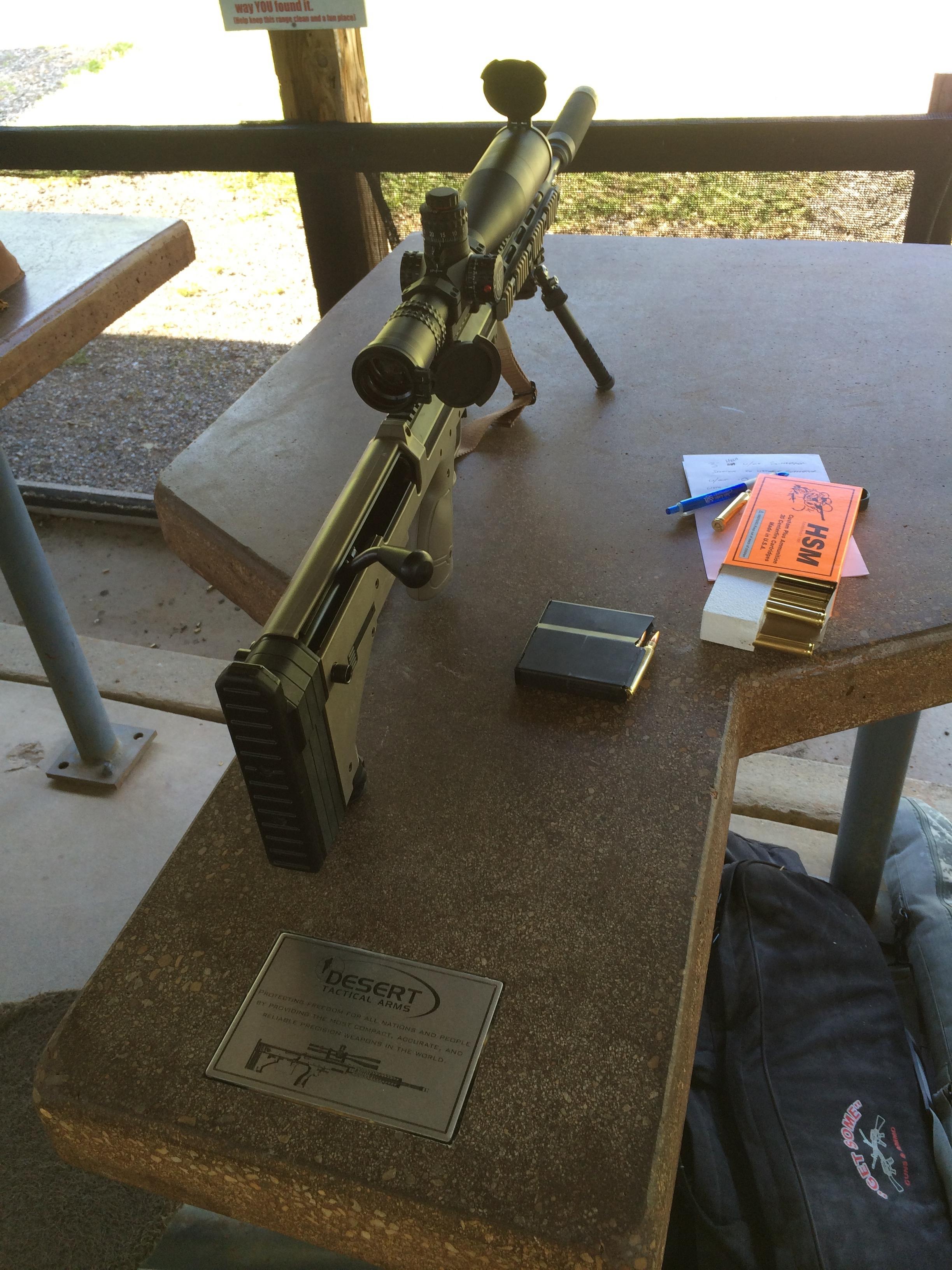

Don't post often, but I always read this thread and still love my DTA. Here is my 09-10 SRS. Not as pretty as the A1 but it is still going strong and thought I would post the pic of it on one of the few places it shoots off a bench. Suppressed 5 shot and unsuppressed 3.
