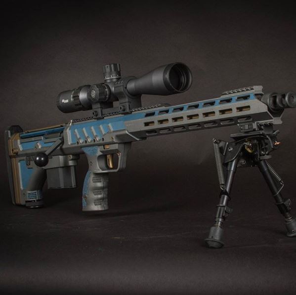

Does anyone know what fore end this is? I found it today posted on Desert Tech Shooters Facebook page, credit is listed at @romeo_whiskey338lm from an ES Tactical post.

I dont think its a new forend. If you notice the entire receiver has been milled as well. More than likely he had it done using the original receiver and forend. But why dont you ask the owner on the FB page?
I located another on john_the_baptist_1 instagram. Supposedly he works for DT as a weapons engineer and was able to shave off a pound with this chassis. Hopefully a new coming Gen 4?

It is my understanding that insiders did a couple of these as "one-offs" for employees, on the mill, prior to manufacturer info and SN being engraved on the receivers. If you look at your chassis, you will see that that information would be removed if you did this yourself on one that is already labelled with that information. There is no word on this being offered to the common man, and if you wanted my guess, I would say I doubt it and I'll offer you 3:1 odds on that bet.
Just seems like it would be the natural progression of design for their SRS. Why not offer an improved (well maybe) chassis or handguard with mlok. If these are already how, how difficulty would it be to mill more to put on the market or make a Gen 4 thats lighter? I can only hope. I'm sure I'll be getting my covert long before that comes to fruition.
Close, but not entirely accurate. These were done after the fact, to finished SRS receivers. And I'll agree with your odds.

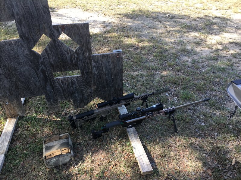

I was shooting the DT and Tubb rifles back to back on the barricade this weekend. Both rifles are great in their own ways but there is definitely something to be said about how the DT balances off a barricade.
