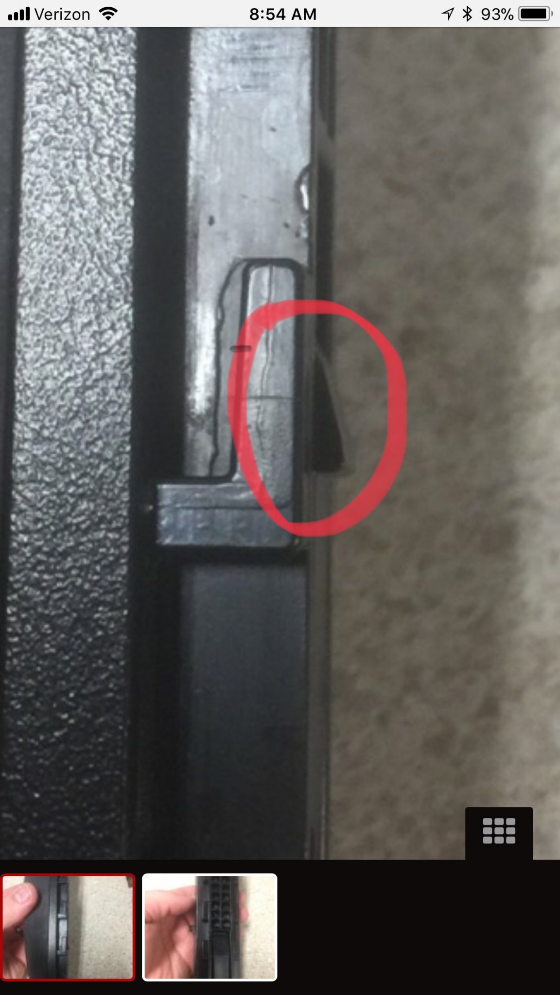

Can you take a few pictures of the catch? This is mine.

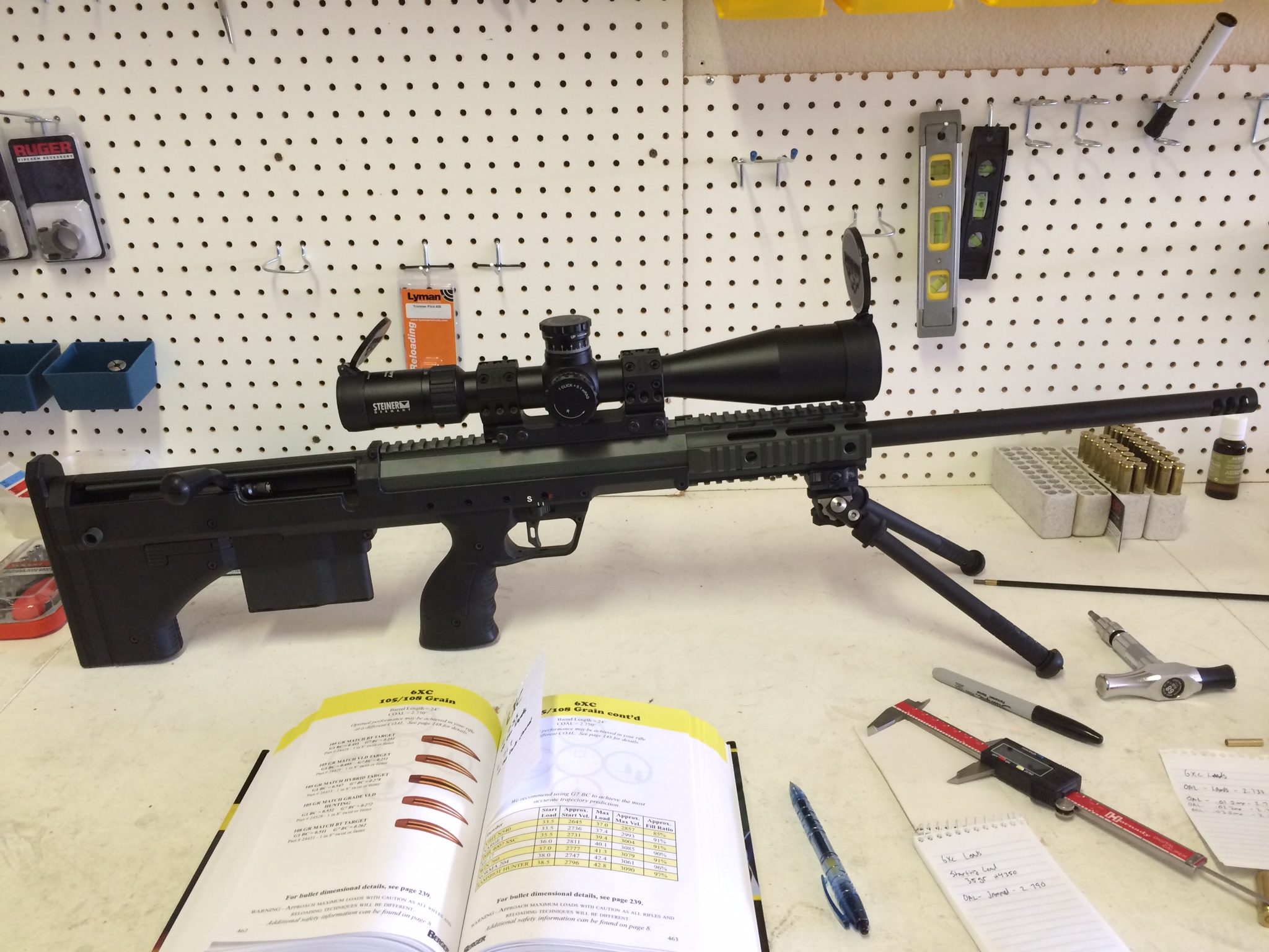

Hey guys, posted a thread about it, but figure I’d ask here too. Looking to do a hunting only caliber for my Covert. Would like to do 24” even 22” barrel would be sweet! Either something with good factory ammo available or something easy to reload for. I hunt out west so our shots can approach 600 yards+ on a regular basis. Was thinking maybe
7lrm
28 Nosler
7 rem mag
300 win mag
7 wsm
7 SAUM
Anything else I should consider? And why?
Thanks guys
ETA: I’m in California so I have to use lead free ammo for my hunting which puts a bit of a restriction on bullet selection.

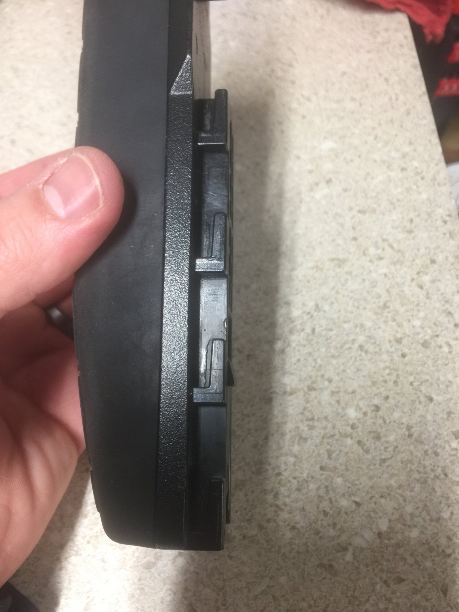

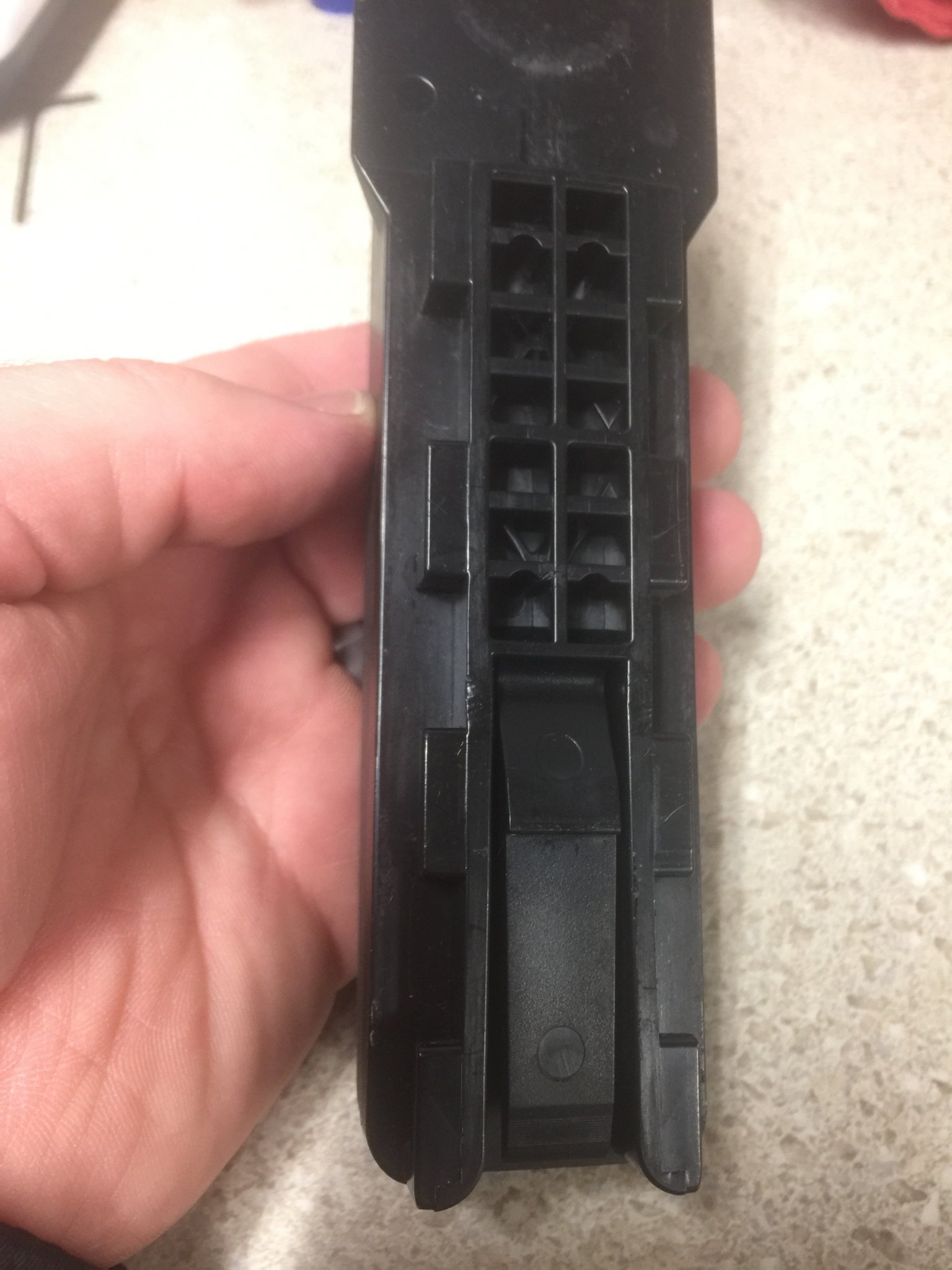

Does your buttplate latch protrude the same amount as shown here? Also take a look at the chassis/skins where the buttplate latches and see if it’s worn down or damaged.
My latches look good with no signs of wear , all attachment points look fine also . I can whack the pad firmly with the palm of my hand in any direction and it stays put . Only comes loose when fired and very random , not every round as a rule , but sometimes every round.

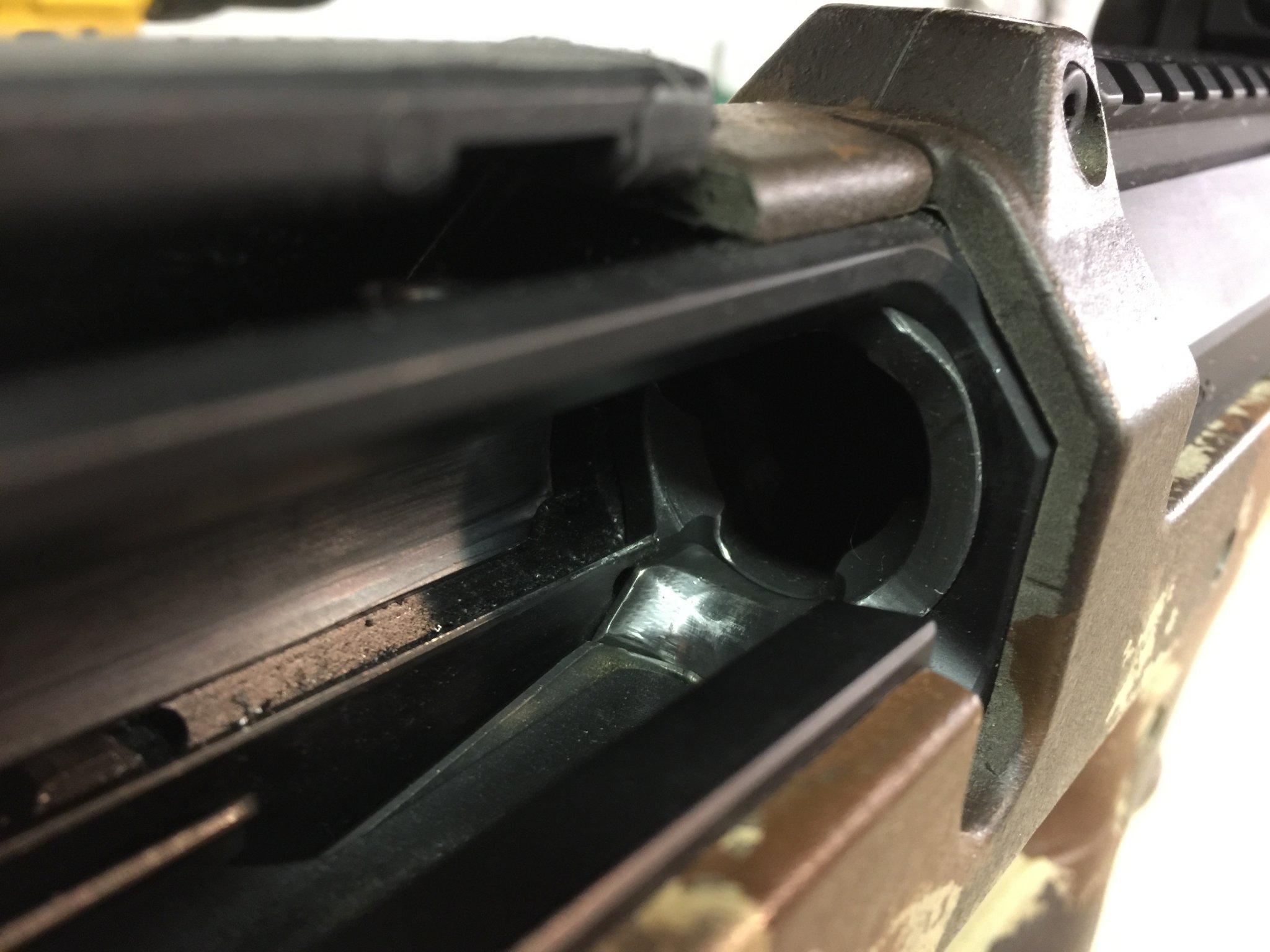

I asked this question before, but then it kind of got lost when two other members got into a p*ssing match with each other. So I'll try asking again. I have a LH DTA Covert that I bought slightly used in 300 WM. Just starting to get used to the rifle. The one problem I have is that the rifle is not ejecting a fired round when I open the bolt. To be clear, the bolt has no problem extracting the round from the chamber, but I have to rotate the rifle 90 degrees to get the spent round fall out. This happens regardless of whether I open the bolt slowly or quickly. Am I doing something wrong? Is there a quick fix?
I would take apart the bolt and make sure it’s all serviced. Orkan has a great write up and I think video on his website about hot to Service it and some great tips. It sounds like you may have a weak extractor.
