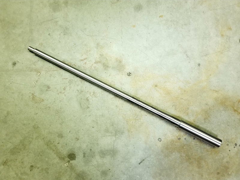

I’m also curious guys about fluting the tennis area. Any more thoughts on this? Thanks
I’m also curious guys about fluting the tenon area. Any more thoughts on this? Thanks
I don’t buy it. The shop referenced are real shooters and if this was an issue you would hear about it by now on this thread and it wouldn’t be common practice. By doing this you introduced peaks and valleys, but you still have plenty of peaks to clamp/torque down to.
But I’m not a machinist.
I wouldnt hesitate to buy a barrel with a fluted tenon; and those spiral fluted ones look sweet.
I'd avoid fluting the tenon. I believe it was done as a one off for someone then became a warranty issue for that owner. It screwed up something in the receiver that had to be fixed. That was from what I read when snipershide was jumping back from the previous versions. Just not something to play with.

I think the issue with fluting the barrel tenon is that the receiver is aluminum and with the heat, shock and vibration of shooting it will wear into the grooves on the barrel. This may create issues with removal and installation of the barrels, especially those without fluting in those locations. You are basically pinching the receiver down against the barrel in this area so think about what happens as the two parts work against each other.

Does the monopod really weigh 1 lb or close to? Anyone have a weight on this? That is a significant weight savings if one needed to drop some weight on the rifle. After that, your best bet is to go with a skinny profile, and keep in mind the DT barrel is as stiff as a barrel about 4-5" shorter due to all the tennon support. I agree that fluting the tennon is asking for trouble. All your clamping force is being concentrated on the peaks of those flutes, and aluminum is softer than steel....

Also, I agree with the thought that fluting a tenon is bad, but find it odd that SAC would do it if it was a problem.
Thanks for the info 4.6 oz is a weight savings but not near a lb!
I’ve seen the SAC flutes and they report no issues but it sounds like there have been some. I think if one beveled the flutes so they are not sharp at the edges then they might be problem free, but I’m just theorizing.

I don't see anybody reporting problems. It just seems like there's a lot of speculation.

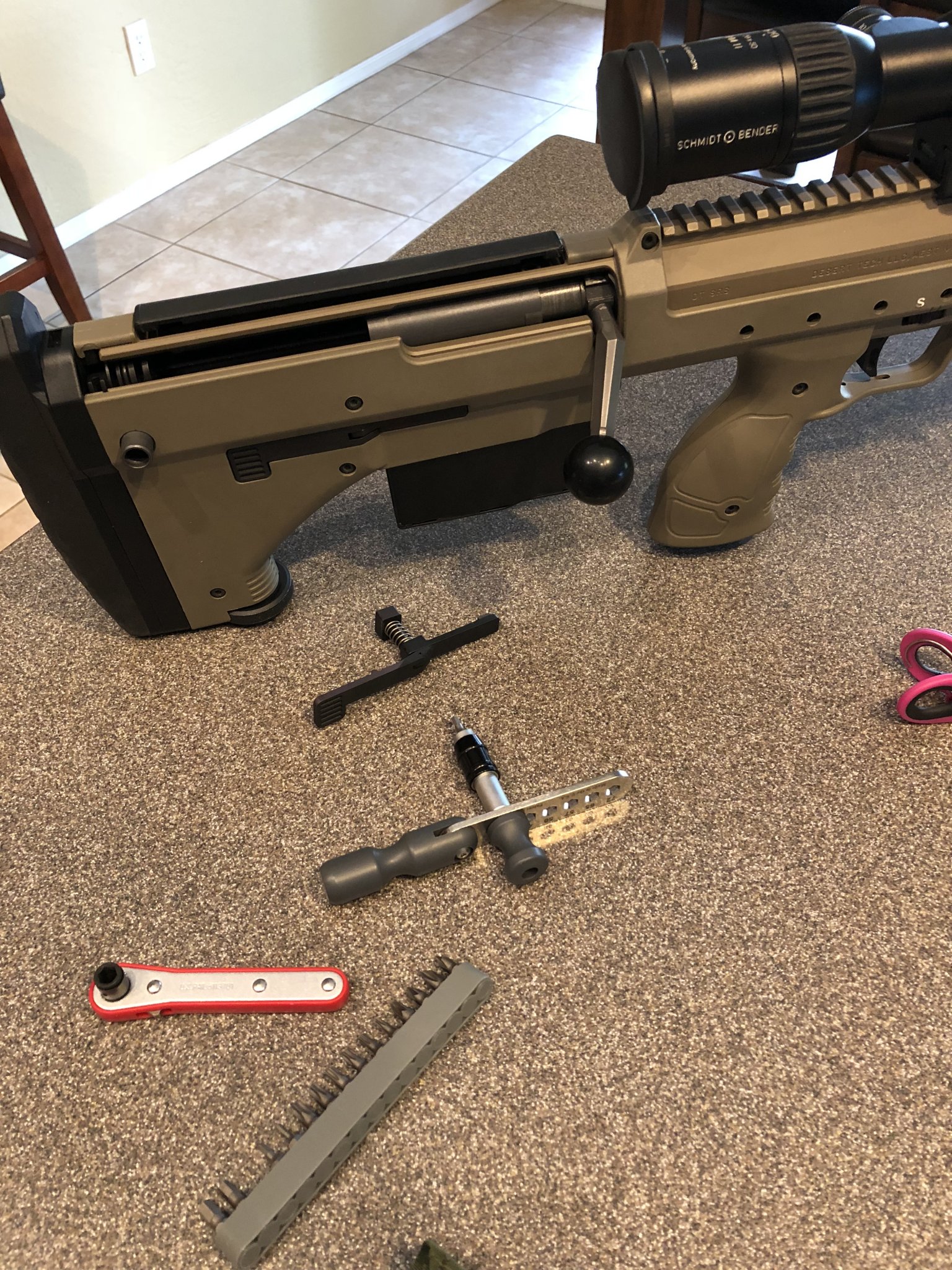

Finished the single shot adapter. Added an over insertion tab and a few other little things. If anyone would like the STL file to print their own, I'm offering it to you for free. I use a .2mm layer height and 15-20% infill. Haven't seen the need for anything more detailed or more dense. If someone doesn't have a 3D printer and would like one, I'll drop one in the mail for $10. Hit me up sometime next week when I finally catch up.
I saw that picture and thought that was an updated mag for a minute. The mags suck compared to AI
