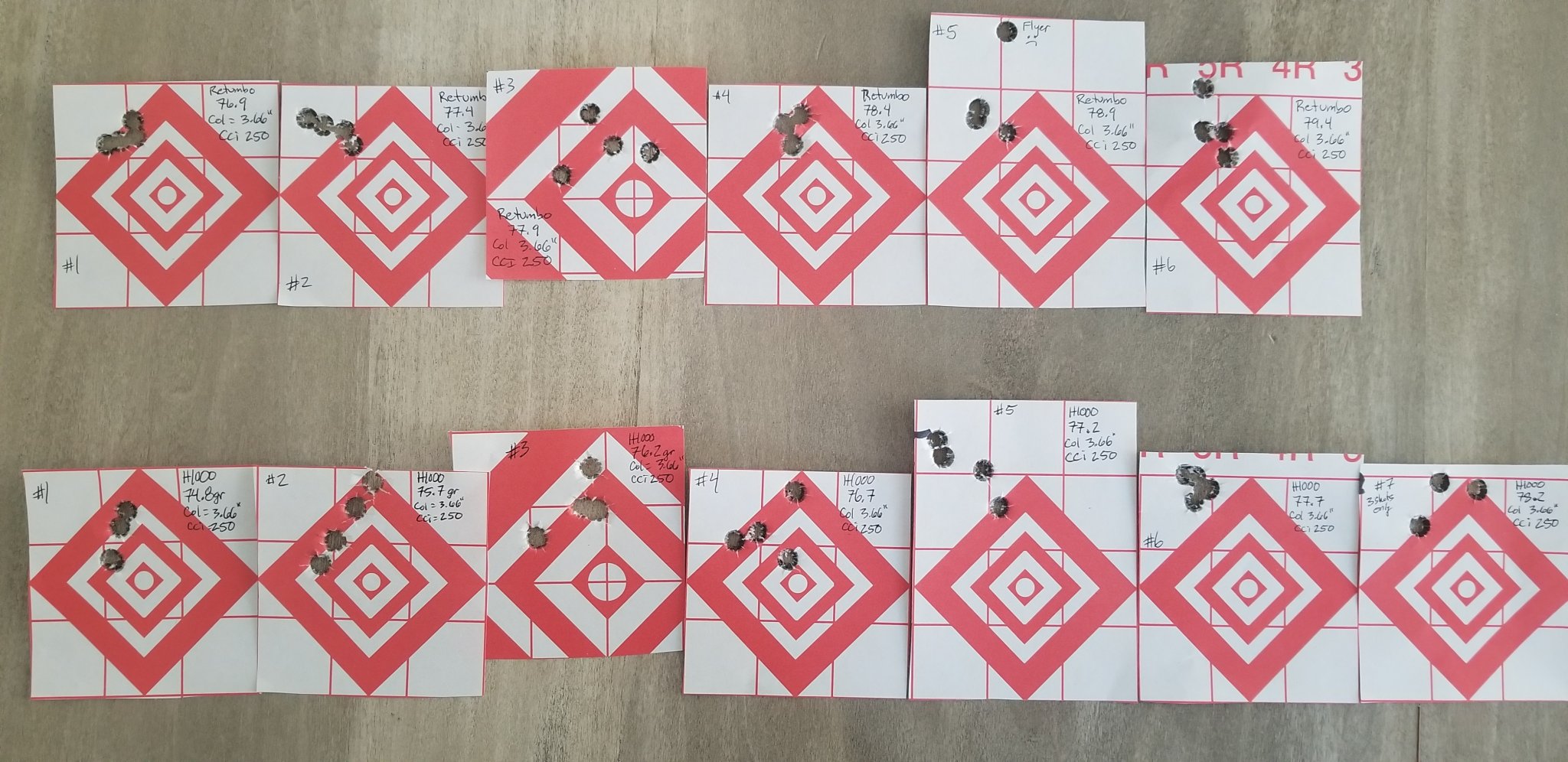

Dane @DMR rifles out of Vegas spun up the barrel. It shot great. The brass sucks but I love it. No Muzzle velocity data yet. But here is some ocw data. View attachment 7047244
Wow that shows some serious promise and thank you for sharing. Which bullet was that and far off the lands was that? Why does the brass suck? Is it Hornady and are they the only ones that offer it? I very much hope the barrel life is as good as advertised? Thanks again man!

I loaded to factory ammo depth there abouts... 3.66"
H1000 and retumbo powder.
Cci 250 primers
225 eld pills

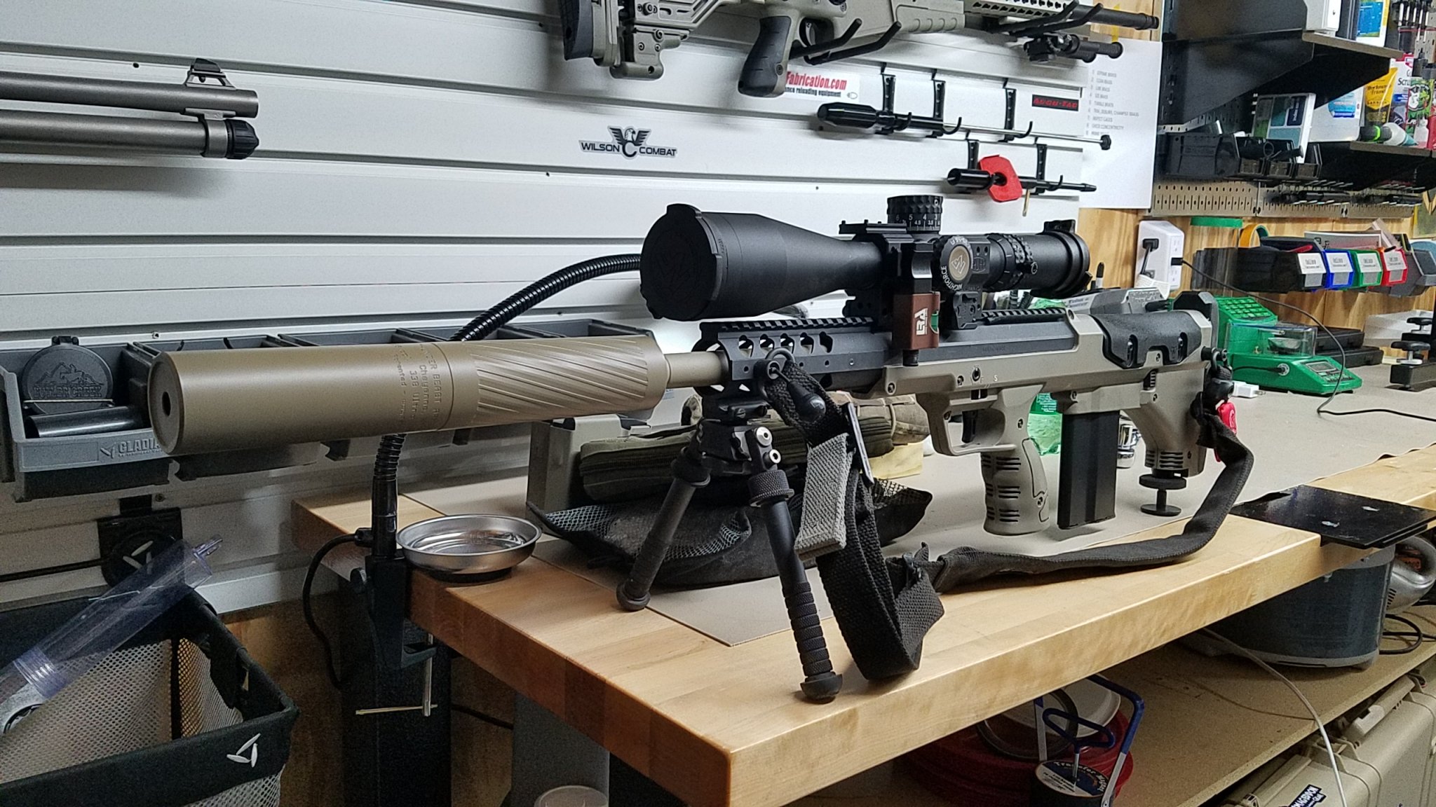

6.5cm 18" barrel with a 10.4" thunderbeast 338 can. Still pretty compact compared the the AIs.

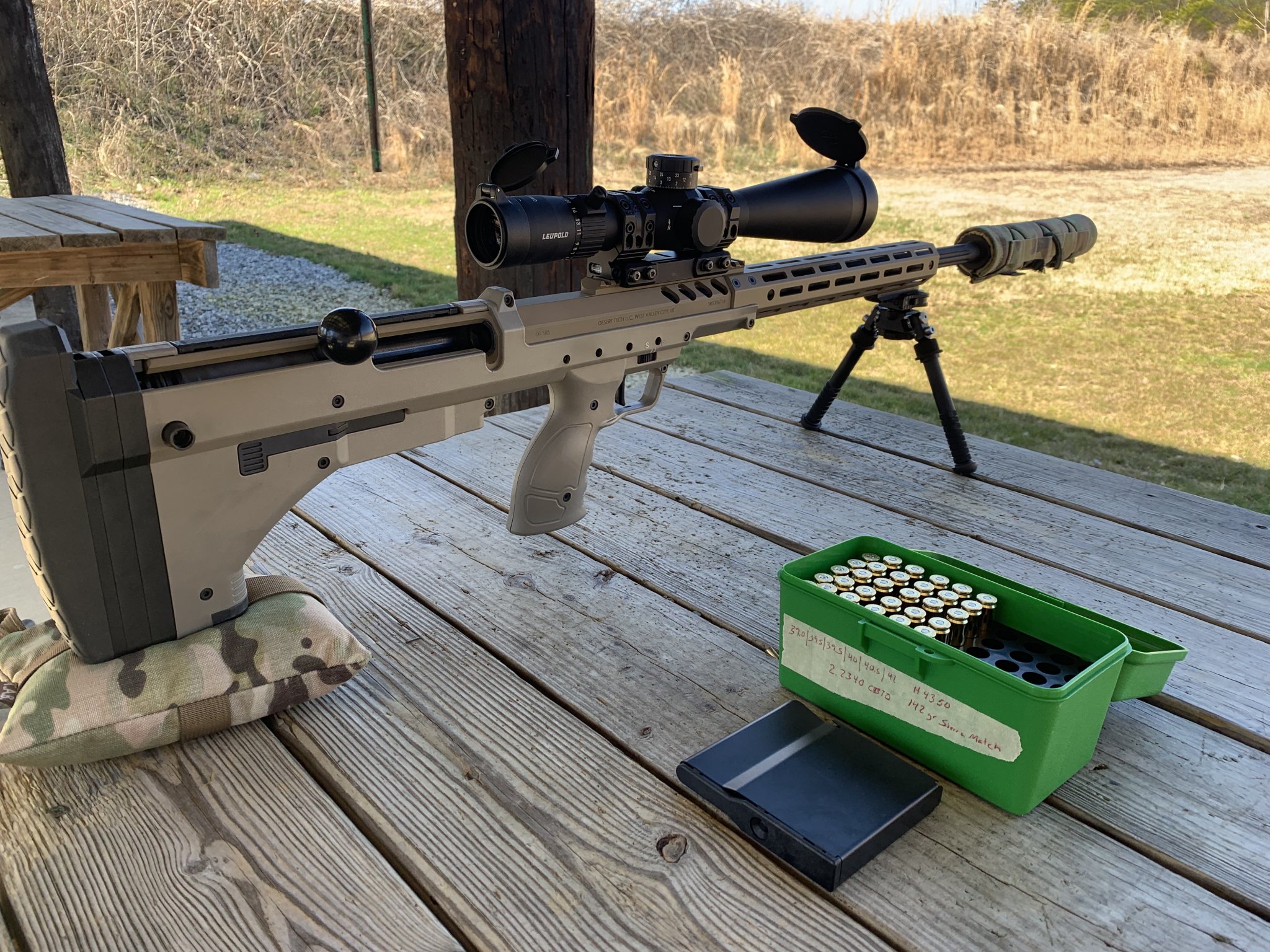

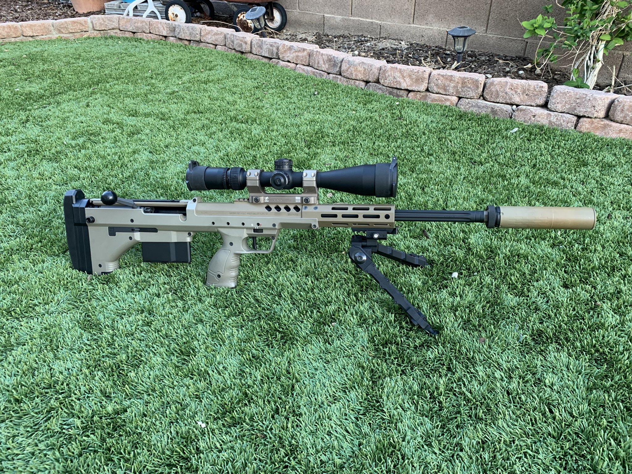

Received my A2 today! Very sweet little package. Shown with 22” 6.5 conversion. I have an 18” 300WM conversion coming too. Need to order an Arca rail for the handguard and going to make my own Arca Mount for the tripod screw on the chassis.
Trigger feels good, but not great. Breaks pretty clean and has no creep, but does have a decent amount of overtravel.
Hoping to get out to shoot tomorrow, but I have a crazy day at work, so the following day is more likely.

Got to the range this morning. I’m very happy with the A2! It was actually really fun to shoot. The trigger is still set too heavy, so I’ll need to mess with that tonight. Only other complaint is that the magazine fit in the mag well is very tight. Given the location of the mag release button, it is pretty awkward depressing the release and stripping the mag out at the same time. And I definitely have to strip the mag out as it’s way to tight to drop free, even with some wiggling. Inserting the mag is equally awkward.
Other than that, the rifle is great to shoot. I found bolt manipulation pretty easy to get comfortable with and the balance of the gun is fantastic. I’m looking forward to getting the 300wm conversion today.

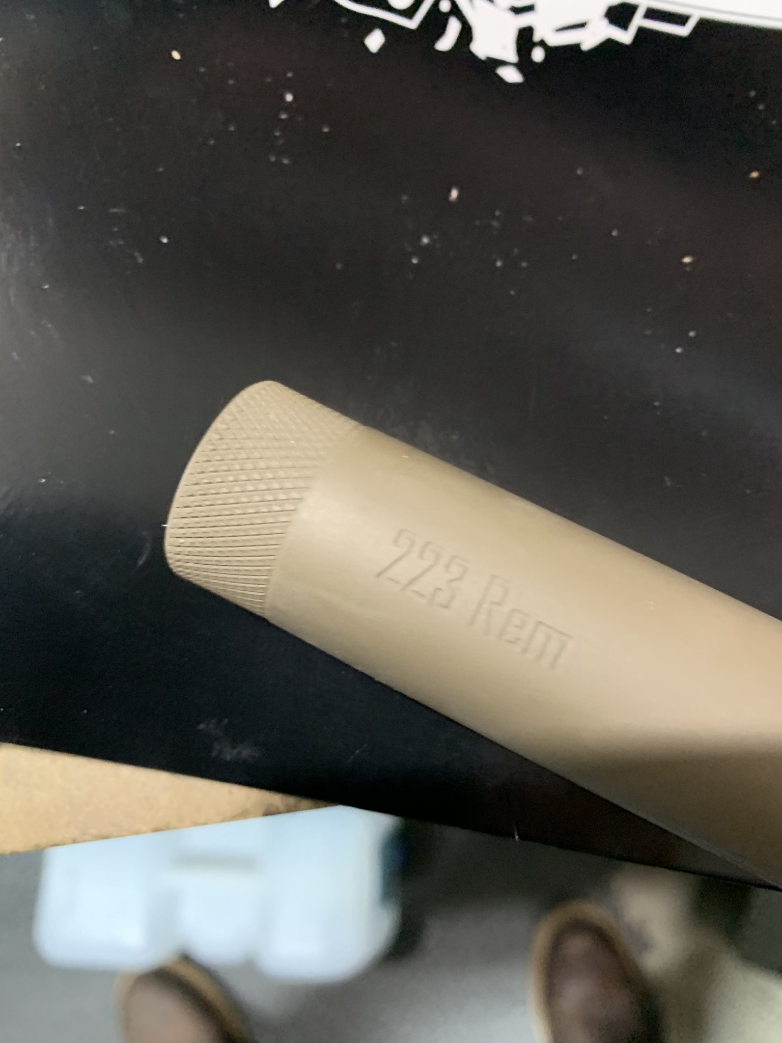

Just got my SAC 223 conversion, 26” barrel. Gonna start the load development process tomorrow. I’m testing hornady 73gr (at Short Action Customs suggestion) and some Nosler RDF 70gr pills.
I plan to run Varget powder. Anyone running this combo care to share their load recipes? I’ll report back with results
