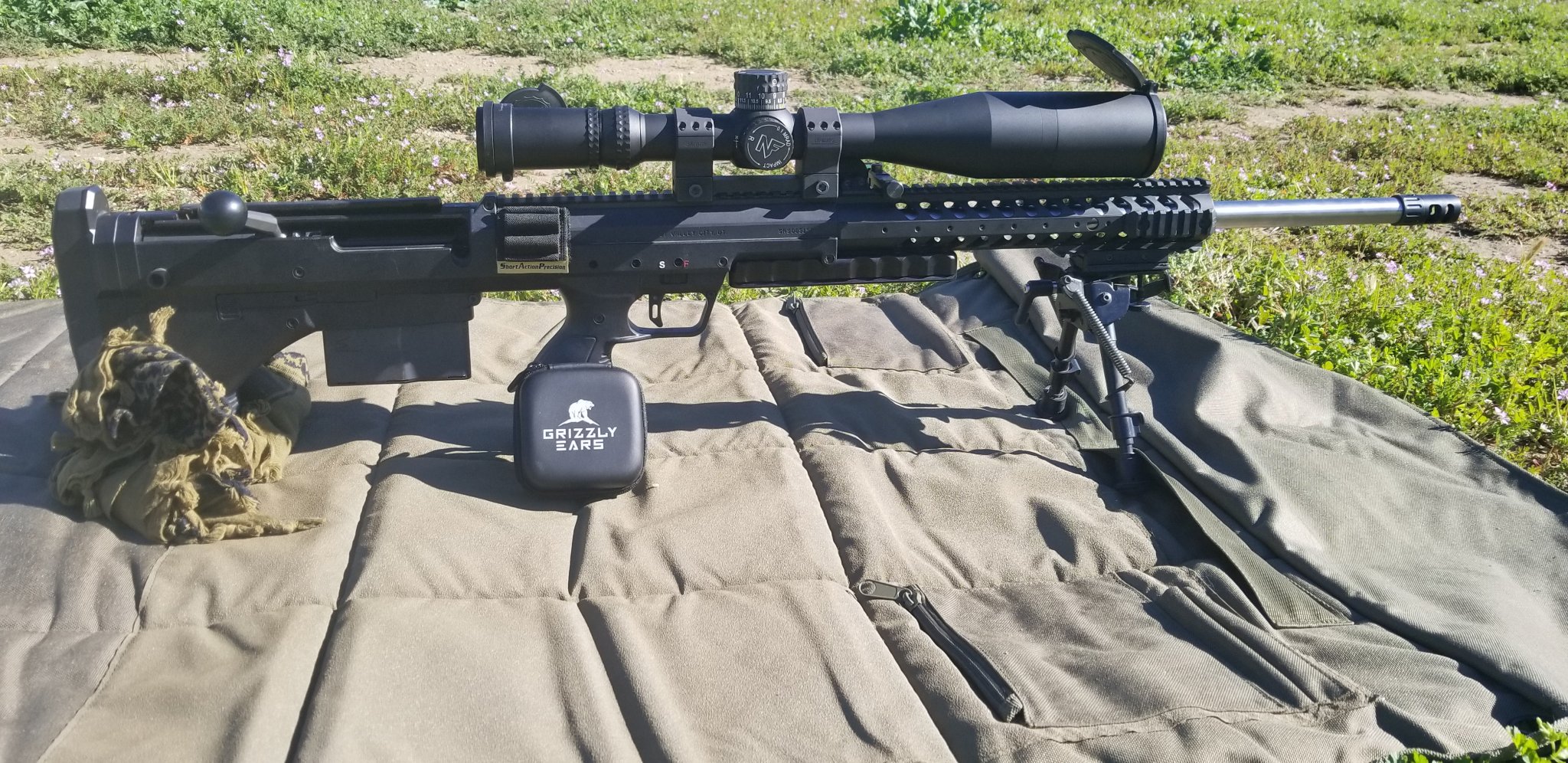

Finally got my 16" barrel! I have been wanting to have the option to convert my A1 to a lighter weight covert ever since I bought this rifle last year. I traded into a covert handrail and bought an unfired 26" Special Purpose Rifles 6.5x47 conversion here on the hide. I sent it over to Mark at SAC to cut it down to 16", thread it and time a TBAC break and give it deep flutes on the barrel and shank to cut as much weight out as possible. After receiving it I sent the Handguard, mag and Barrel to Daniel over at Primal Finish to match the Mirage Cerakote I already had on the rifle.
Mark at SAC did a fantastic job, after cutting the barrel down he weighed it before cutting the deep flutes after fluting he said it cut off .55lbs. I weighed the barrel before sending it off and after cutting it down and flutting it went from 5.28 lbs to 3.68 lbs so it saved 1.6 lbs all in! The rifle with mag, scope, TBAC Ultra 7 and RRS rail went from 15.3 lbs to 13.1 lbs.
I can't say enough about Daniel over at Primal Finish his work is impeccable, the attention to detail and quality of his work is just incredible.
Here are a few pics.

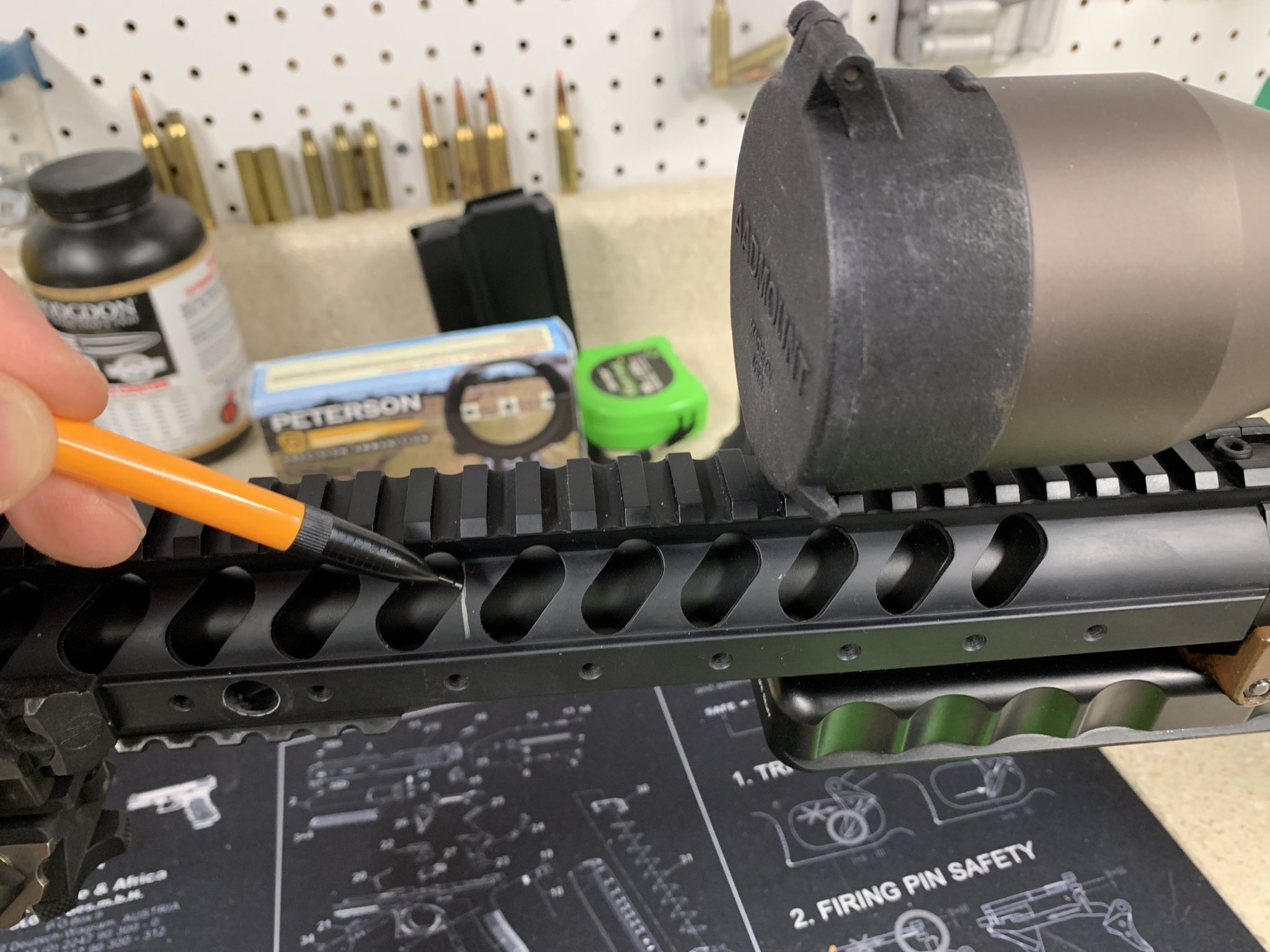

Does anyone have any references to cutting an srs a1 to covert length I saw a post on page 206 i am looking for more references before i start cutting
What do you mean by references? Lots of people have cut their handguard, others bought a replacement handguard and now have both the full length and Covert lengths to swap as they see fit. As I recall a new handguard is in the $500 (ballpark) so cutting may be a good option for you.
I am looking for more pictures or advice on where and how to cut I have seen 2 pictures one was a straight cut the other was cut on an angle matching the holes in the handguard
Ok. Where you cut is really up to you. When I cut mine down on my Gen1 I wanted the flush cup so it ended up being slightly (1/2” maybe) longer than the A1 Covert length. You can also see the Gen1 handguard wasn’t designed to be cut in half, which is why I ended up with open portions on the end.
If you have 16” barrels you are going to want to make it Covert length or slightly shorter. If you have 18”-20” barrels then you have some flexibility.
My full size handguard is 11-9/16”, maybe someone with a Covert can post their exact length. If I were to cut mine down I’d do it at 6-3/16” which would be right before the 7th vent hole starts so I would have 6 full vents, which would also maintain the circular portion of the handguard, unlike my Gen1.

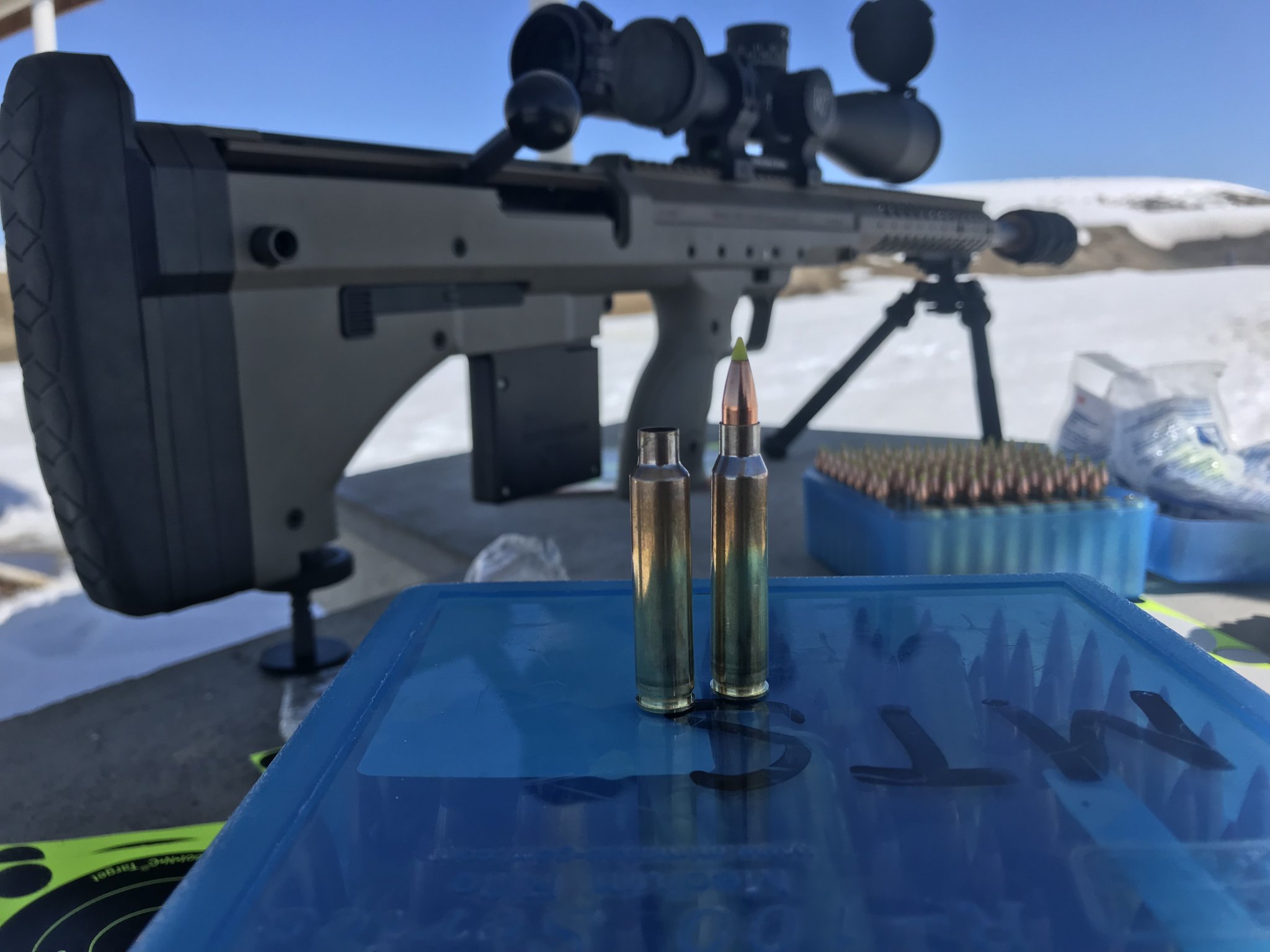

Threw together some quick loads for fire forming, very low effort and the new barrel shot great. I would definitely recommend the SAC .223 kit. I can’t wait to start load work with the fire formed brass. View attachment 7044410

Unfortunately I didn’t take pictures of the groups, I was trying to get 100rds fire formed.
I will next time for sure.

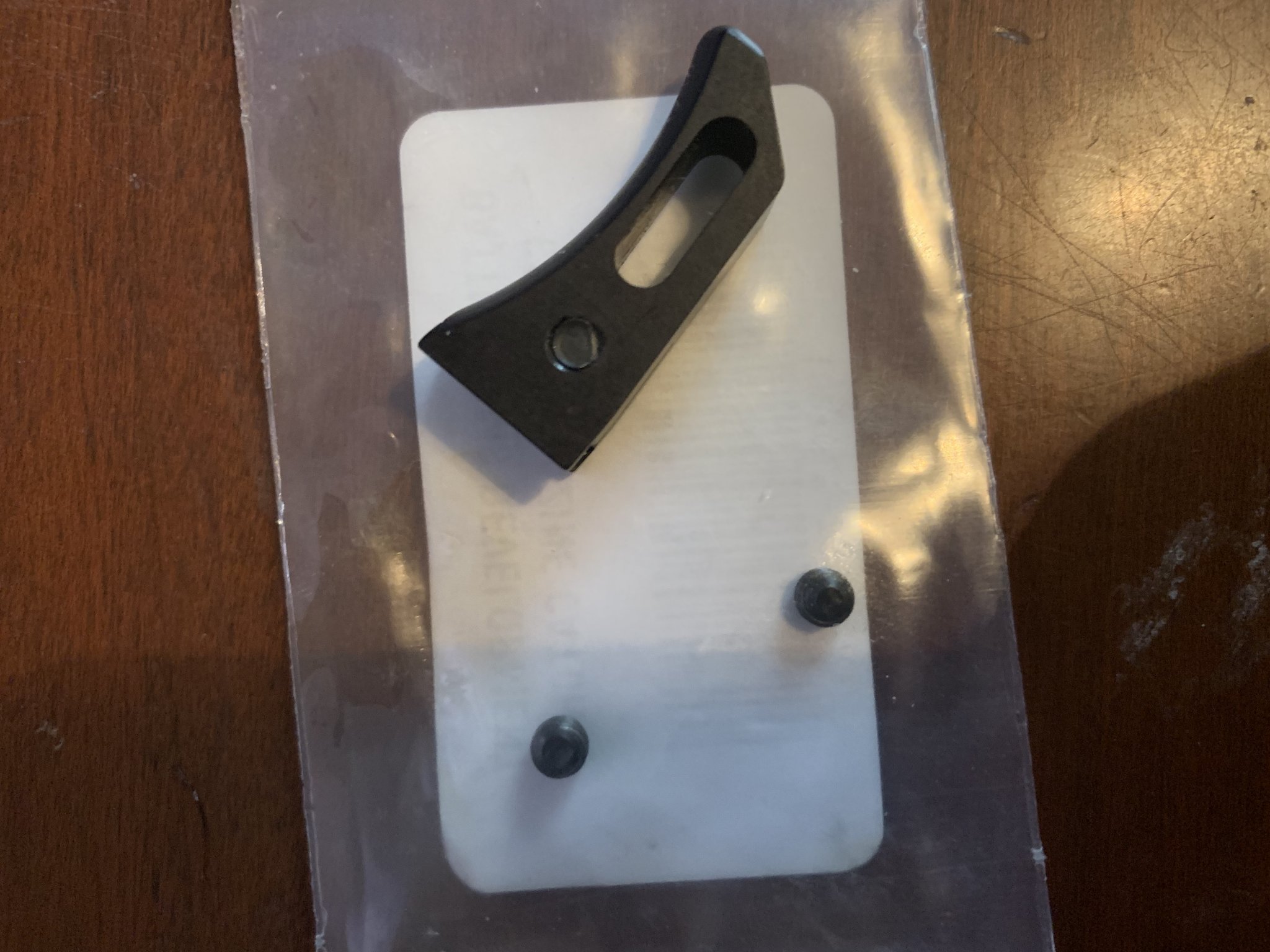

I need some help with my covert, I had it cerakoted months back and after that I have had all kind of issues with the trigger coming off the gun and I cannot find where these two small screws went.....
in order to put the trigger back on do I just tighten the Allen screw? Any idea where these two small screws go?

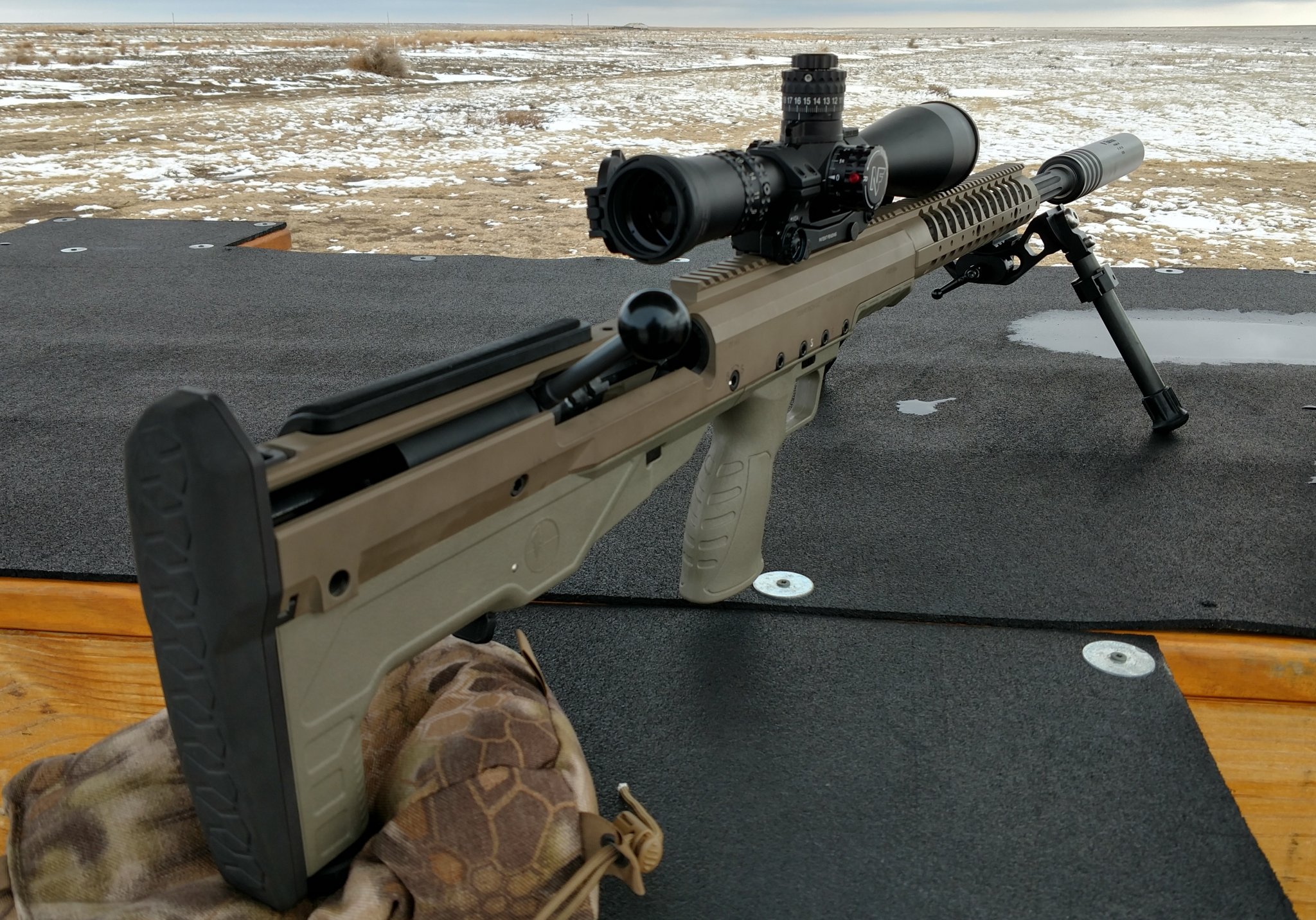

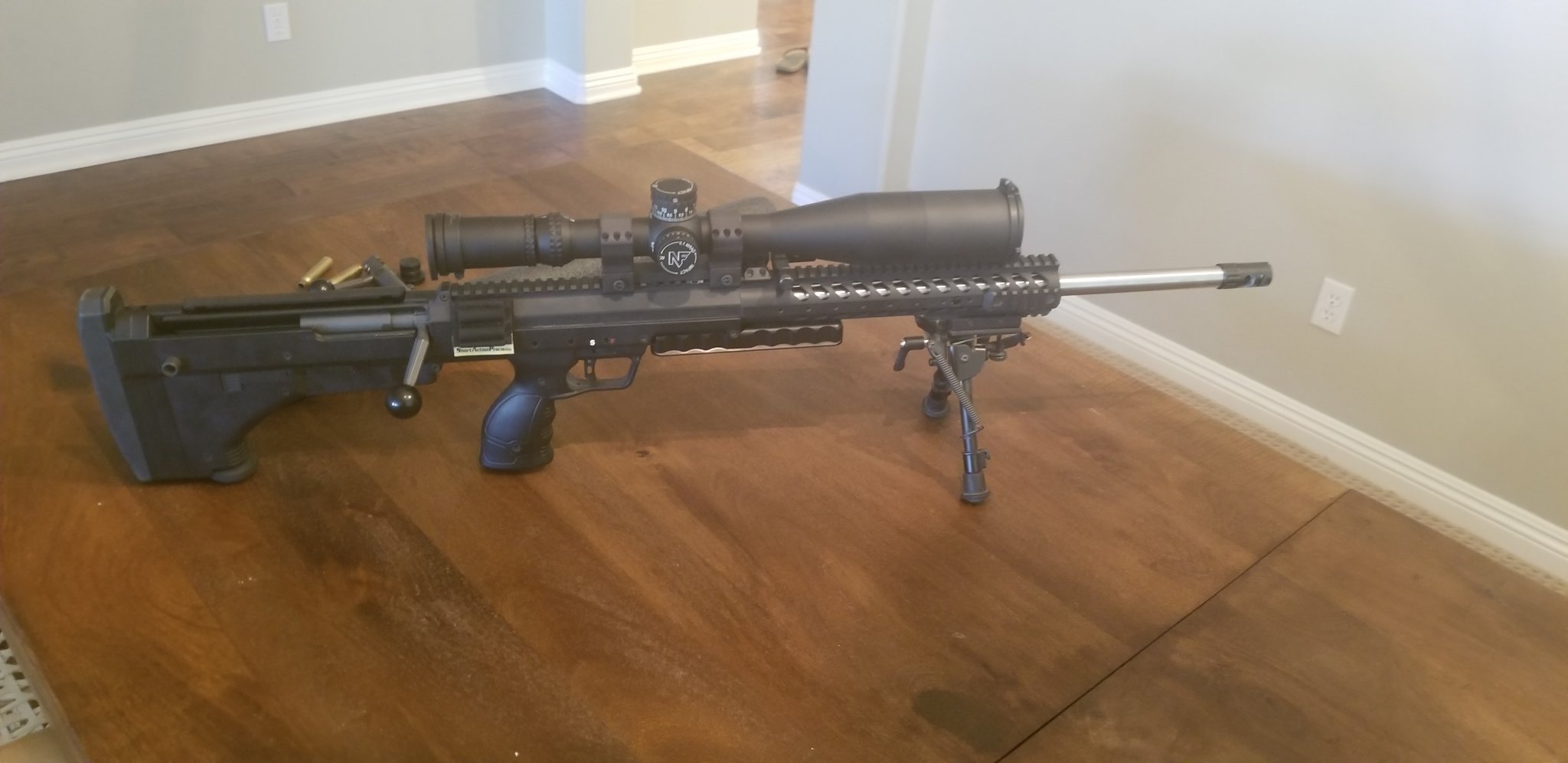

Got out for a little bit this afternoon. Finally had a chance to shoot the DT SRS A-1 in .308. Today was not a disappointment and shot it side by side with my AIAX. Getting used to the ergonomics of the rifle but a blast to shoot. Here are the results:
