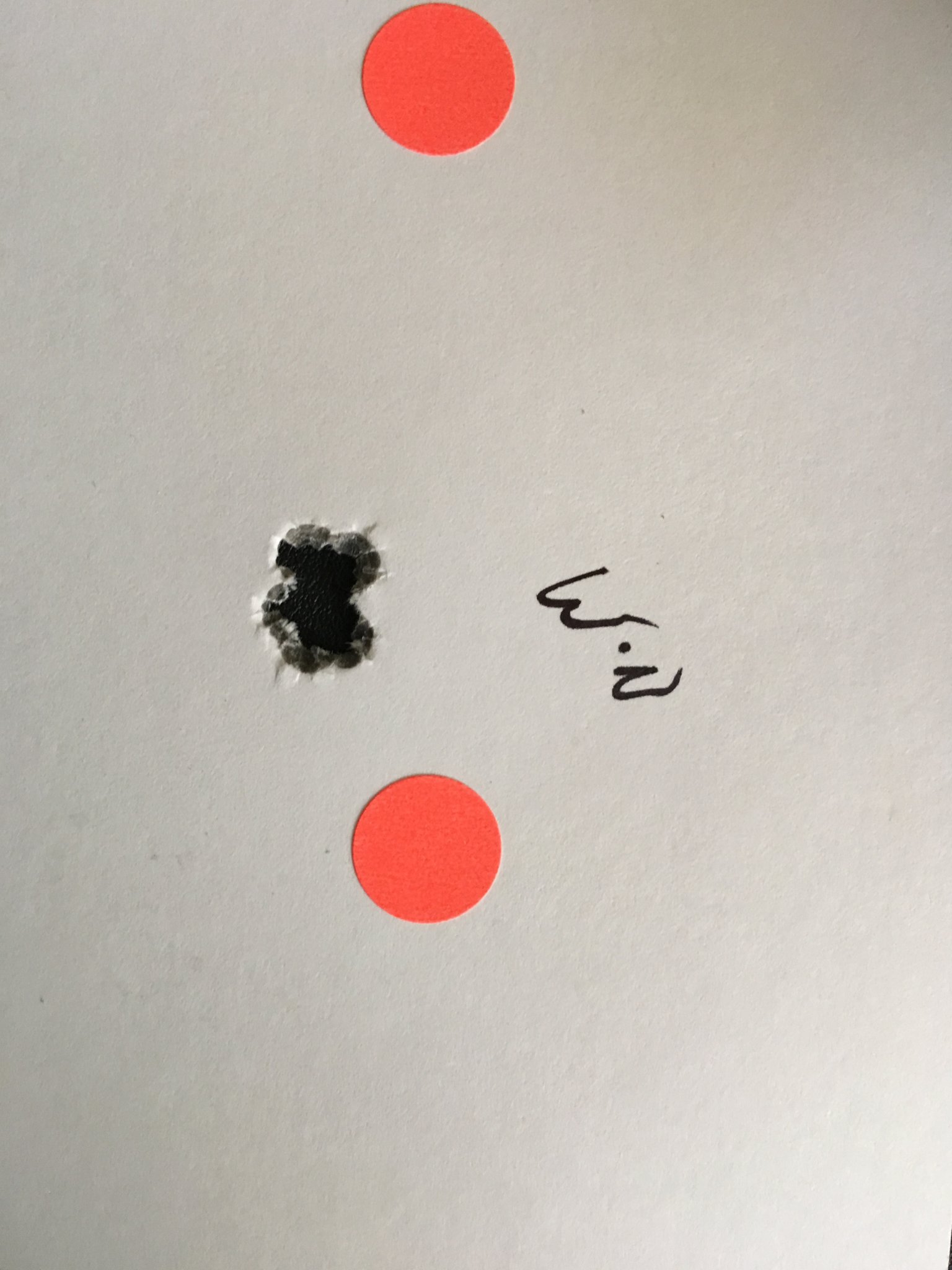

Took the new SAC 223 out and this was done with in the first 50 rounds. This is one of the best shooting set ups that I have ever had. Will post more pictures as the barrel breaks in. The Winchester was match 77gr.
Reactions: Juggerxxx
I did something and knew it like on that one I wasn’t completely set up behind the rifle. And I jerked the trigger. I knew the shot wasn’t going were I wanted to. Then corrected and the other 4 were good.

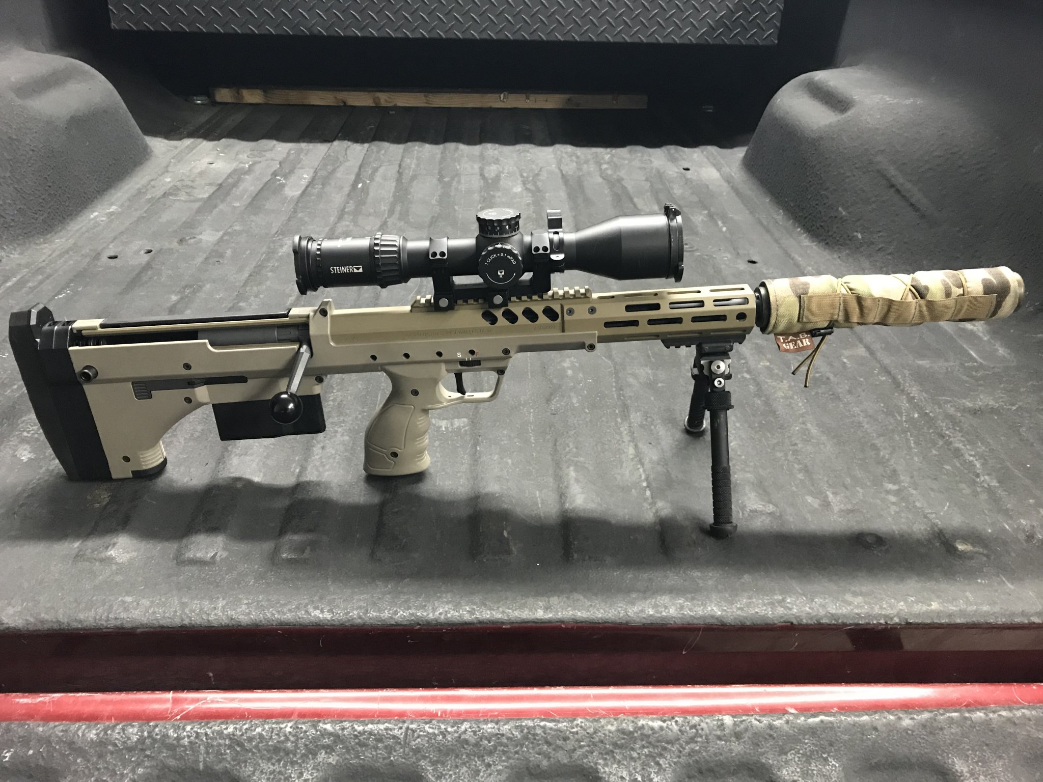

Just jumped on the DT bandwagon. ES-Tactical made this A1 for me. 6.5 cm, 26" 1/7.5, .900" taper, Ryan Pierce's muzzle brake.
Tonight will receive a ZCO 527 atop. Can't wait to shoot it!
So awesome. I run a Kahles 525 on my A2 and a NF ATACR 7-35 on my A1 right now. Super excited for you and looking forward to hear your experiences with the ZCO.

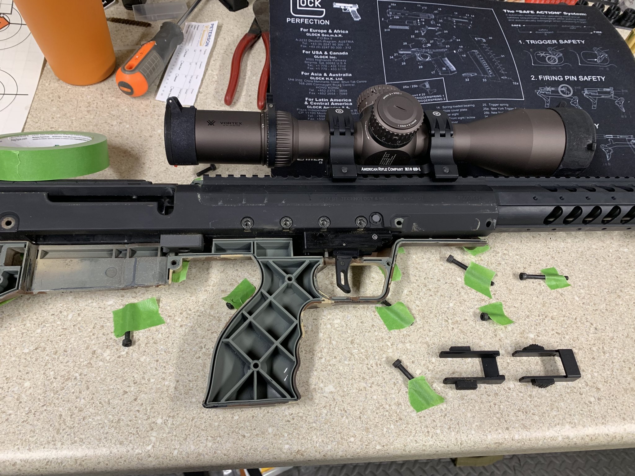

I haven't taken the skins off to see, but how much structural support is there on the pistol grip? I really dislike the shape of it and was wondering if it'd be possible to chop it off and replace with something else bubba'd on, then hide the seam with some camo wrap or similar. I tried to find some rubber/silicone grip wraps but nobody makes one that's big enough for the SRS grips unfortunately.
Searched around a bit but didn't find anyone else that's previously done grip mods to the SRS of any generation. The skins are relatively inexpensive in case I mess it up terribly and want to revert, but I wouldn't want to modify the metal underneath at all.

Don’t cut that grip off! The skins are one piece.
