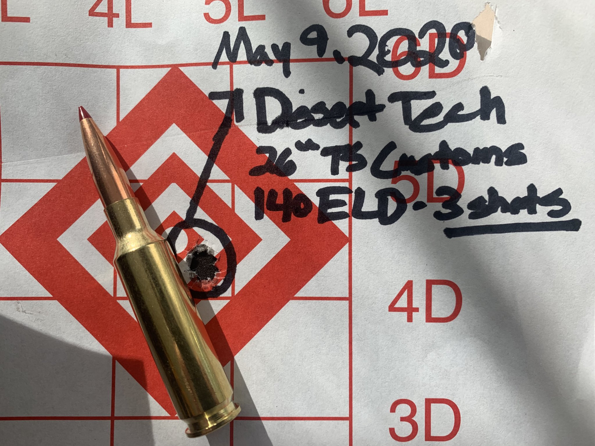

First groups today through the TS customs barrel. Uncommon for me to shoot 10 round groups but felt like it after moving the first over.

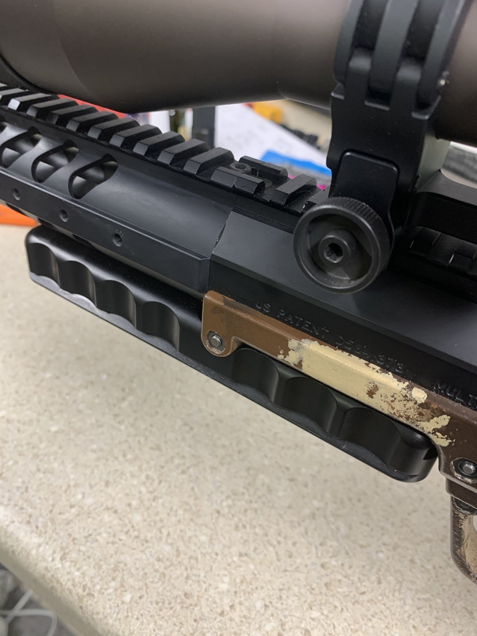

Almost positive that neither the two screw or three screw picatinny rails will fit in front of the RRS rail that goes right in front of the trigger guard.
I usually just hook my bipod on the front 2in of the RRS rail and the tripod hooks on way further back towards trigger.
I see your problem though, it would be nice to have a small picatinny rail in front for a atlas with adm or similar.

you can easily get a picatinny rail section that can attach to the mlok forend. Attached a picture from mine.

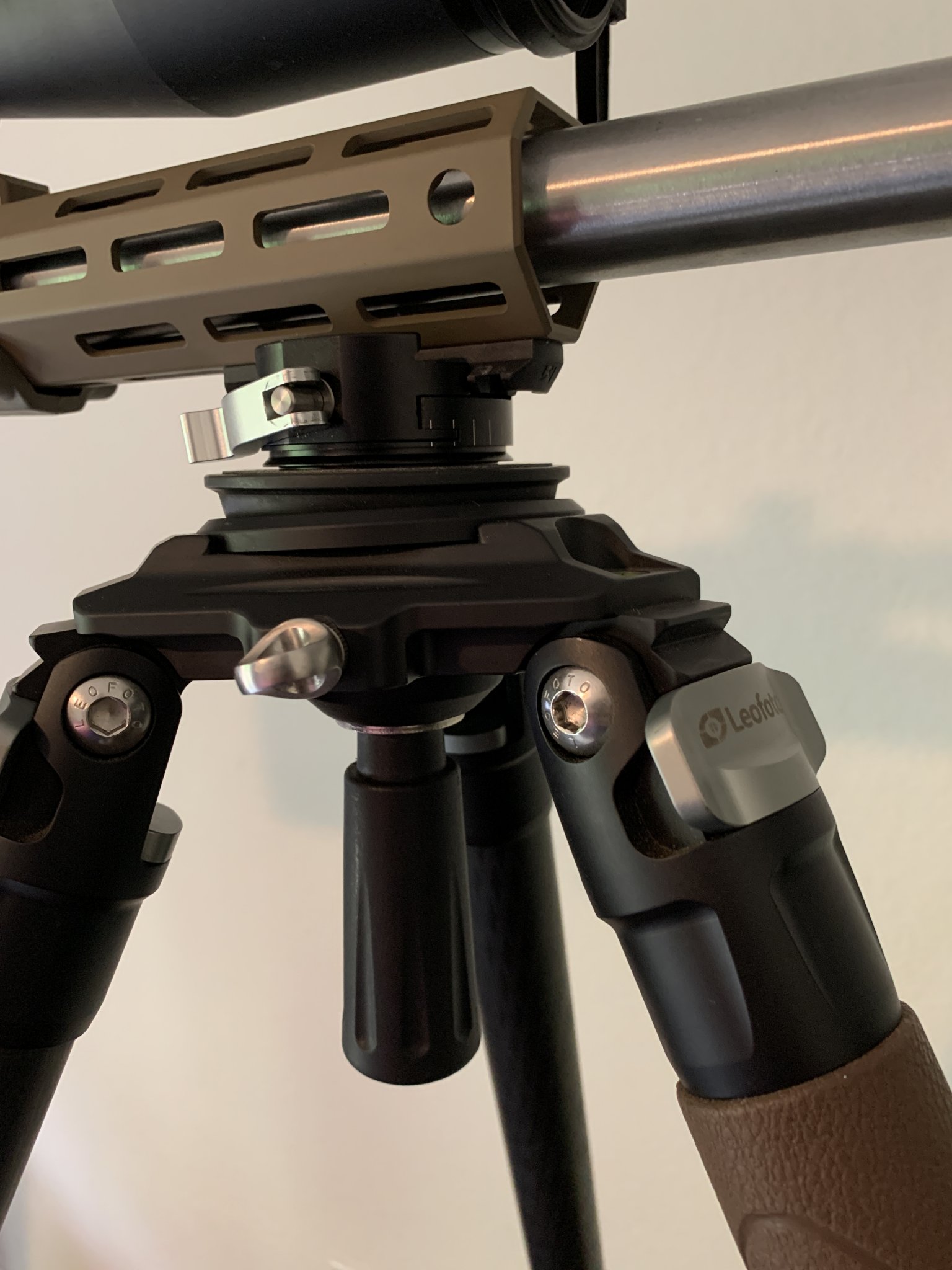

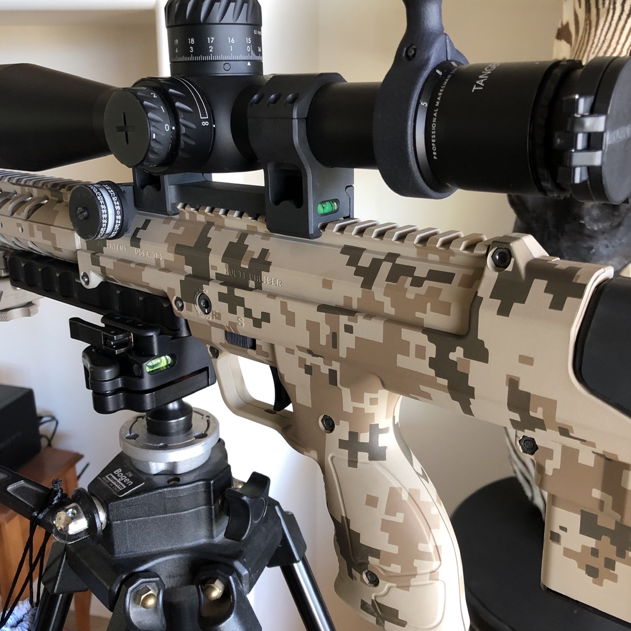

If the concern is about getting the rifle centered over the tripod, all you need is the RRS Desert Tech Plate. This is all I use and its perfect sitting on a tripod.
https://www.reallyrightstuff.com/BSRS-A1-Desert-Tech-Forearm-Mount

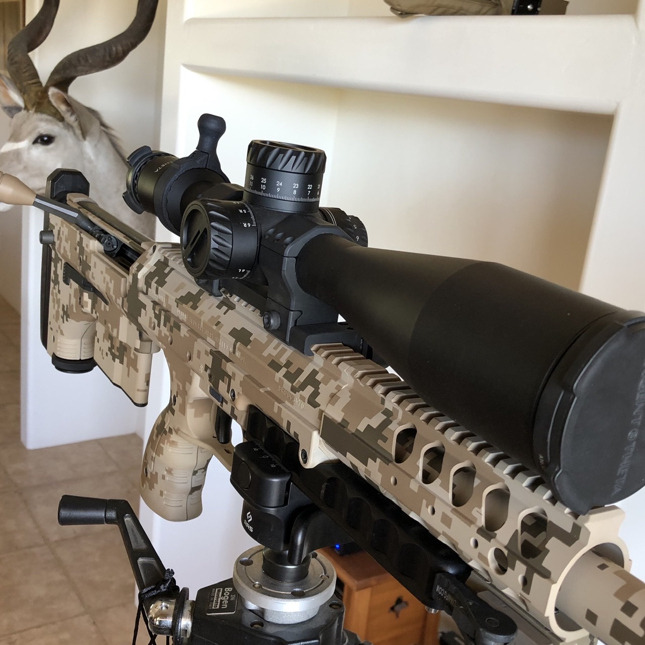

The center/balance point of the rifle is right about where your thumb is in the above picture, right in front of the trigger guard with a typical factory barrel.
Here’s mine:
Here’s mine:
YEah that’s exactly how I want to run mine but RRS doesn’t make a full length picatinny adapter which is why I want to upgrade to the slim line A1 so I can get the full plate that goes to all the way to the trigger guard. Plus it’ll make it easier to position the area 419 arcalock gamechanger.

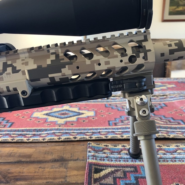

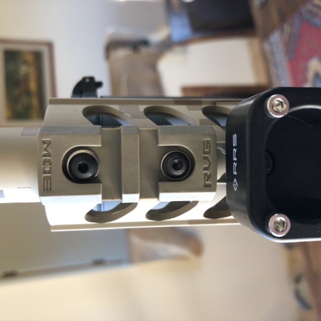

For those looking for a Picatinny rail section to go in front of the RRS chassis adapter on a Covert the rail section that comes with the MagPul RVG forward hand grip have the right hole spacing.
Last week I added the RRS adapter to my Covert and was thinking of getting the ARCA adapter for my Atlas. Rooting around the garage I found the rail from an RVG fore grip I bought last year and the hole spacing was right to place it in front of the RRS adapter. All you need is some M4-0.7mm button head screws.
ill try and take picks tomorrow of what it looks like. I like it because I didn’t have to buy the ARCA adapter and it puts the bipod as far forward as possible on the Covert.
Edit: This is for the A1 of course.
Thank you. Was going to cut drill and countersink the DT rail
they don’t list it but it doesn’t hurt to ask. Worst case is you get a picatinny fore grip to use elsewhere or sell.
Edit: The 3-slot MOE rail looks close, worth a call to MagPul to find out the hole spacing.

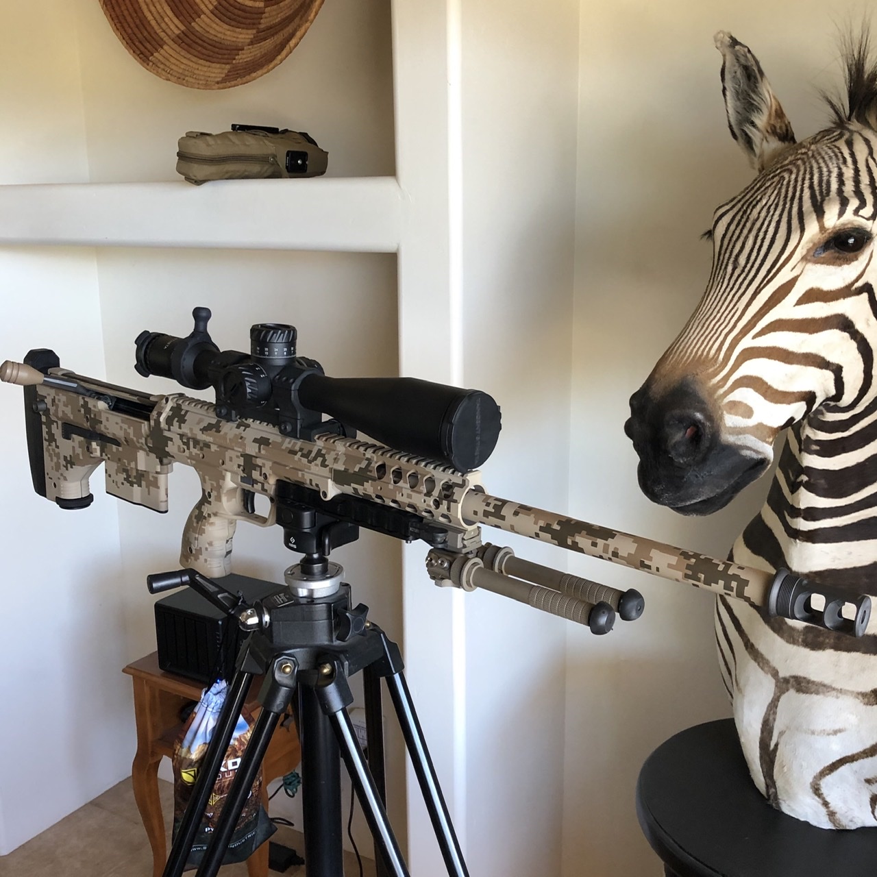

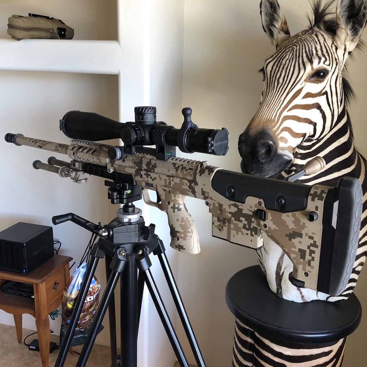

Here are some more pics.

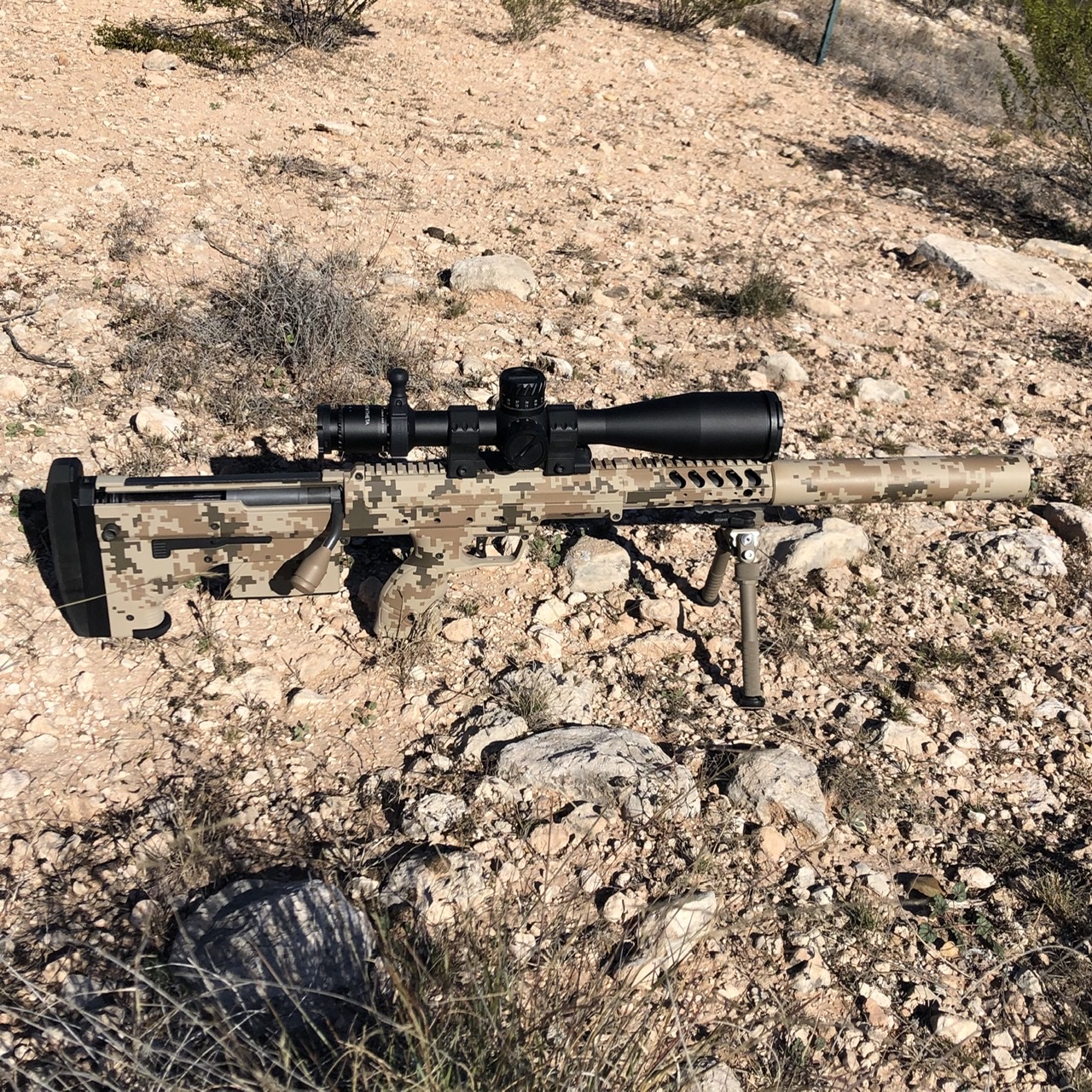

Yes, it’s a 338BA/Ultra, it’s the can I use on all of my barrels for the rifle.
Thanks for the compliments on the Cerakote work. This rifle was our test bed for getting the pattern density and colors right for desert digital.
