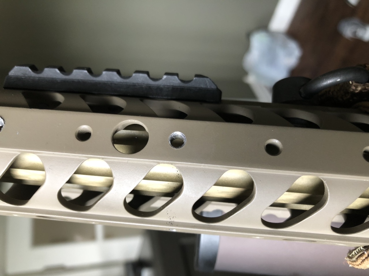

Anyone know the thread pitch for the A1 handguard rails? Mine broke and the replacement screws sent were too large.
Mine are now 8-32 for the steel rail underneath with the bipod mounted. I've repaired quite a number of the BS plastic rails which have broken off and taken the too small metric threads out of the handguard. The plastic rail on my brand new A1 chassis was factory broken so it didn't even make it from utah to pennsylvania in the box. I added a thin steel threaded plate inside since the handguards are so thin and soft. Haven't had a broken one yet......

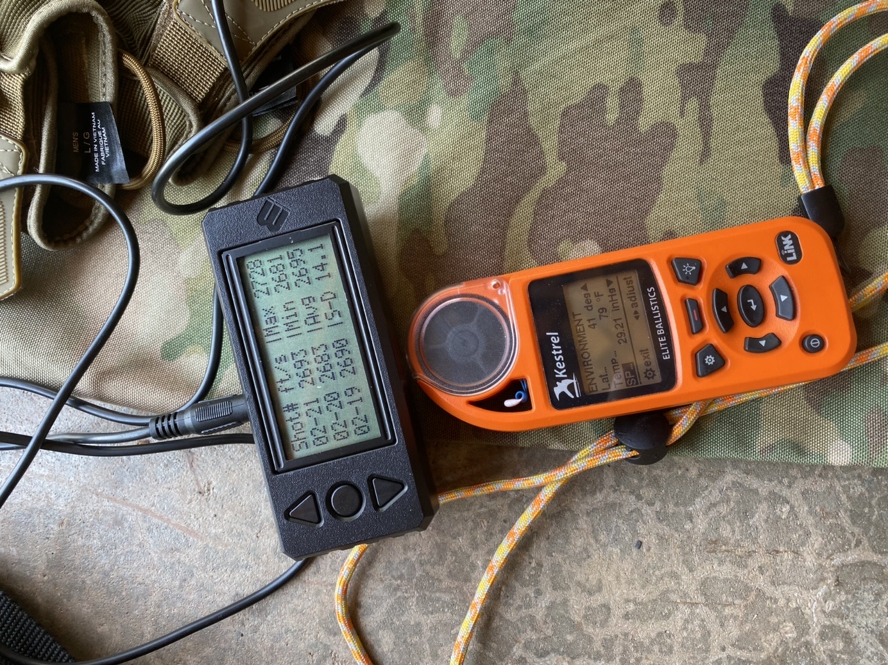

Here are some speeds using Hornady American Gunner 140 gr HPBT in case it’s helpful. This is out of a 22.5” proof barrel. The A2 is substantially lighter than the A1. In my experience, both are half minute guns all day.
