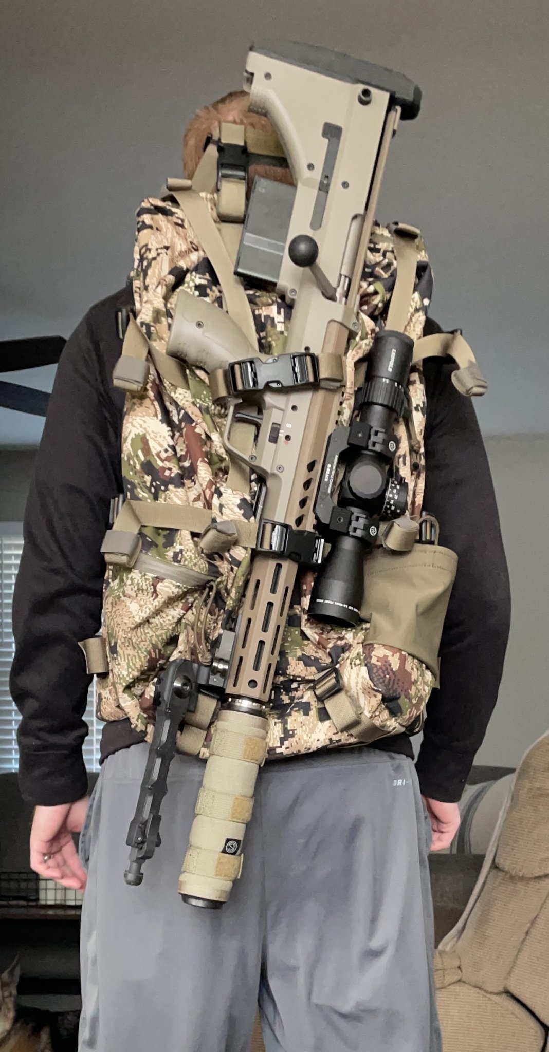

Kind of a hunting-ish related question. Does anyone have a pack they like that fits the SRS well? The larger butt pad doesn’t fit in my standard rifle holder on my Mystery Ranch pack. So I am forced to pretty much strap it in as pictured. Not ideal by any means.
Had same issue with another strap on mine and size Of butt on SRS.
I wouldn’t want a strap across my trigger. Especially with the safety off. 😉
@bmicek I'm not sure which MR pack you have but there is sort of a load area between the frame and bag (I think hunters use it for meat) that I found you can tuck the SRS down in nicely so its closer to your body. I'll post a picture when able
You know, I’ve had my MR Metcalf tightened down to the frame since I got it and hadn’t even thought about using the meat shelf. I’ll have to loosen straps and try that out today. Thanks for the reminder.
I have an Eberlestock pack with scabbard. It's been able to hold all of my bulky match rifles. I'll check it against my DT tonight.
I tried mounting it between the frame and bag of my Kuiu. Not a great solution. Ended up doing a patrol carry (barrel down and left) on my sling with my pack on over. Spot an elk, drop back and crawl.

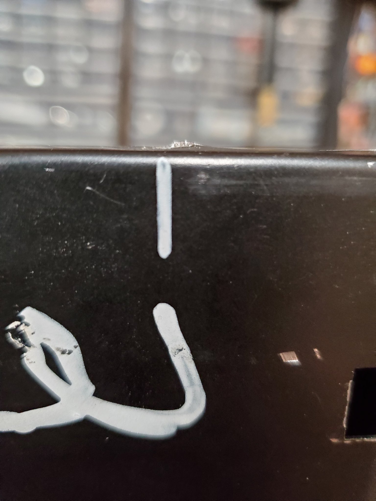

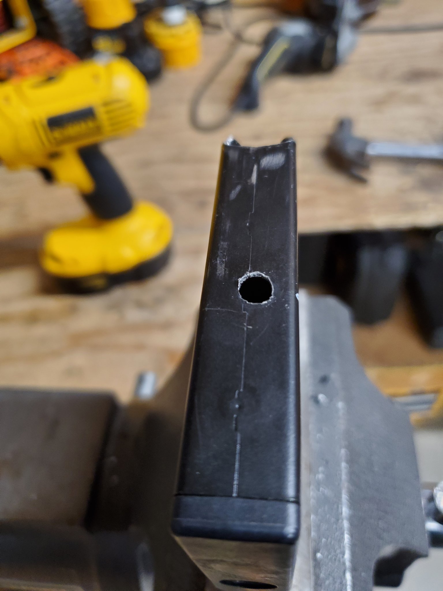

Here's my hillbilly $0 fix. Drill a hole in the back of the mag where the mag meets the rear of the magwell. Put a punch in the hole and pry to bend the metal out a little bit. This puts pressure on the lower back of the mag and tilts the front of the mag up slightly. All you need is a couple hundredths. If you go too far and the mag sticks tight just push the bump back down a little. Worked perfect in shop testing. Needs some hard field use to confirm.
Why not just superglue a thin piece of plastic instead?

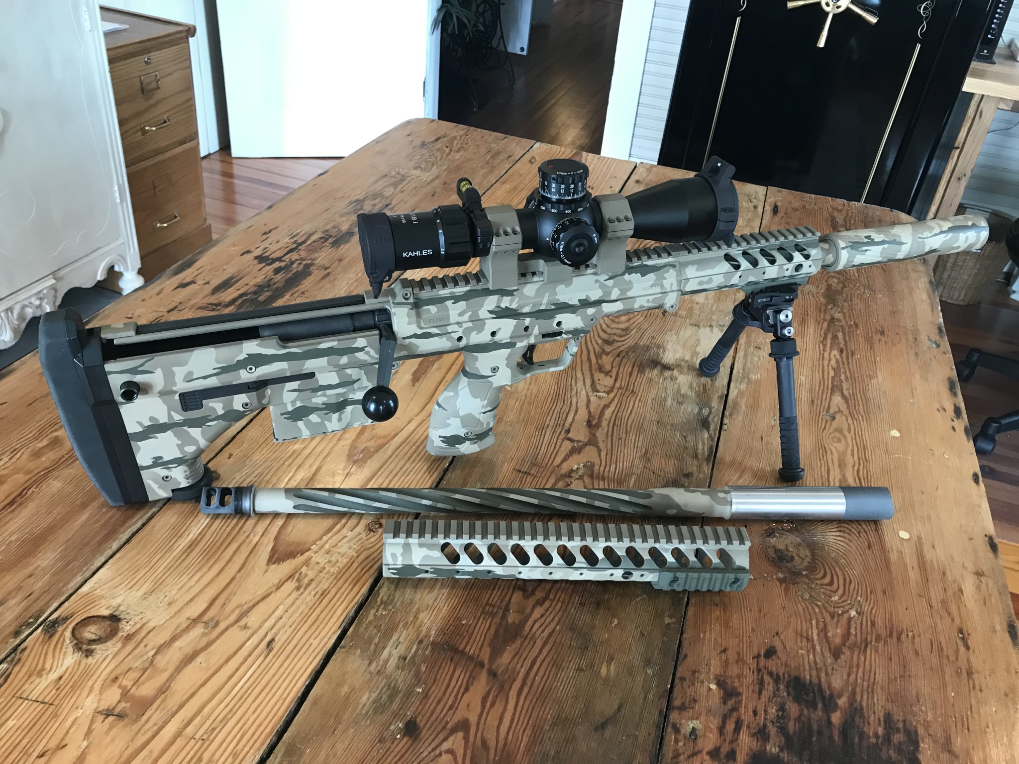

So, I got a little carried away today, called my smith on the way to an estate sale of some gun stuff ( barrels brass powder bullets and scopes) talked with him about doing a 6gt barrel for the DT. He says well i have a 6mm barrel in HV sitting here and it will work. ill double check it and spin it up for you, stop by on your way back. (COOL no shipping or tax for getting a barrel). estate sale has some heavy barrel profiles, 1.30 breach for like 8 inches and grabbed 2, one 6mm 7.3tw and a 30 in 10tw. On the way home ordered a 7mm barrel for a 7 saum ive been holding out on for the DT for a while now. all in all, 4 barrels, a bolt, extension and mag ordered/bought today. :LOL::LOL::LOL: cant wait to get some stuff for the 6gt and run it
Heads up the 6gt doesn't eject real well. Shoots great but a good ejector spring and quick bolt manipulation will be your best friend
Reactions: Dragoon300
