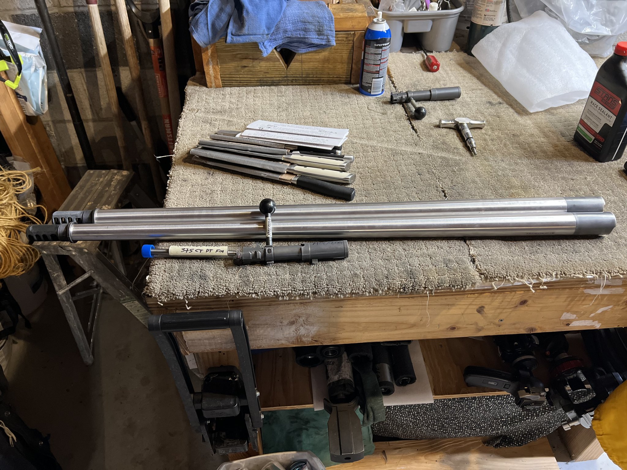

Just picked up my 3rd 375 barrel from Eric Smith Es tactical tonight. I think I finally found the perfect profile: 36” finish length. 1.620 for 8” them straight taper to 1.15” at 36. Honestly, my next one will go to 1.05 or 1.00” at 36”. I just like the aesthetics. Here it is beside a 35” barrel that tapers to about 1.25”. Notice how just 0.100” changes the profile significantly to the eye. 1.0” at the muzzle would be just about perfect for a 35-36” straight taper. I previously had one that tapered to 1.35” and it was way too fat. Wasted steel and weight I think.
Can’t wait to get out and test this Lilja with my 390 loads!.

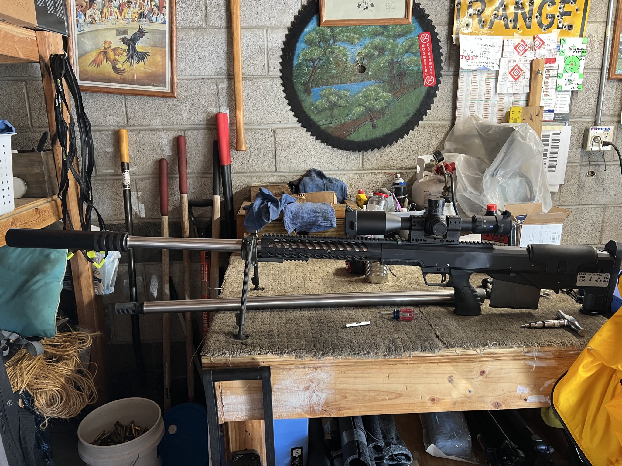

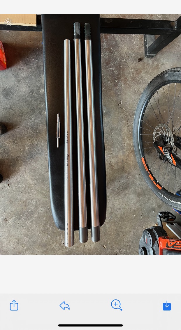

Here are my last 3 blanks that are all more or less 36”. Taper from left to right is 1.15, 1.25, 1.35” at the muzzle. Next time at 1.00-1.05” I’ll have it just perfect!
To be fair, I based the fatty on the right on my 41” 50 BMG barrel, which is perfect for that length with an AR50 brake. It’s just when you chop it 6” shorter and put on a 375 brake, 1.35” is just way too much. That extra weight is best used for length rather than girth. Lol
What’s the diameter at the muzzle and what caliber is that jammed into that covert? 338 I presume
Edit to add never mind. Since it’s a covert, it must be 1.250 at the muzzle. That thing is ridiculous. Either way.

Yup, .338LM Improved 40. This was originally a 1.25” straight 37” blank from Bartlein - basically a truck axle. At this point in the picture everything was done except contouring and finishing, and I wanted to see how it felt. I think it was something like 8lbs. So I had him do the step flutes towards the rear and straight flutes the rest of the way.

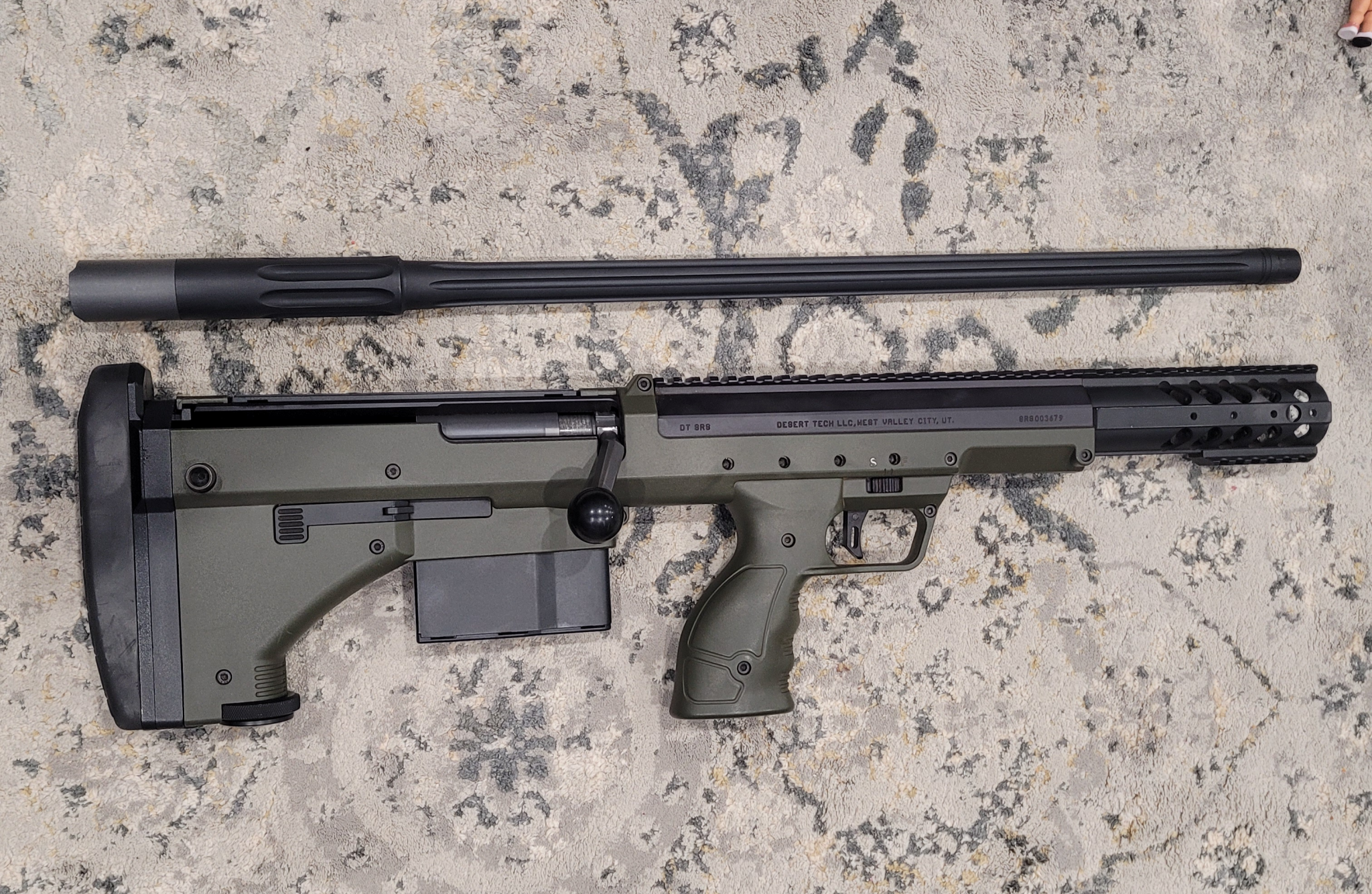

Picked up a A1 covert with a A2 308 26" kit. Looking at getting a short 18" 300wm spun up. Will try and keep this one for stalking deer.View attachment 8231691View attachment 8231690
We have the factory 18" .300 WM conversion kit in stock. I also have some 18" Proof CF barrels on the shelf in 300 PRC, we have Proof blanks to spin up an 18" 300 WM if you'd like.

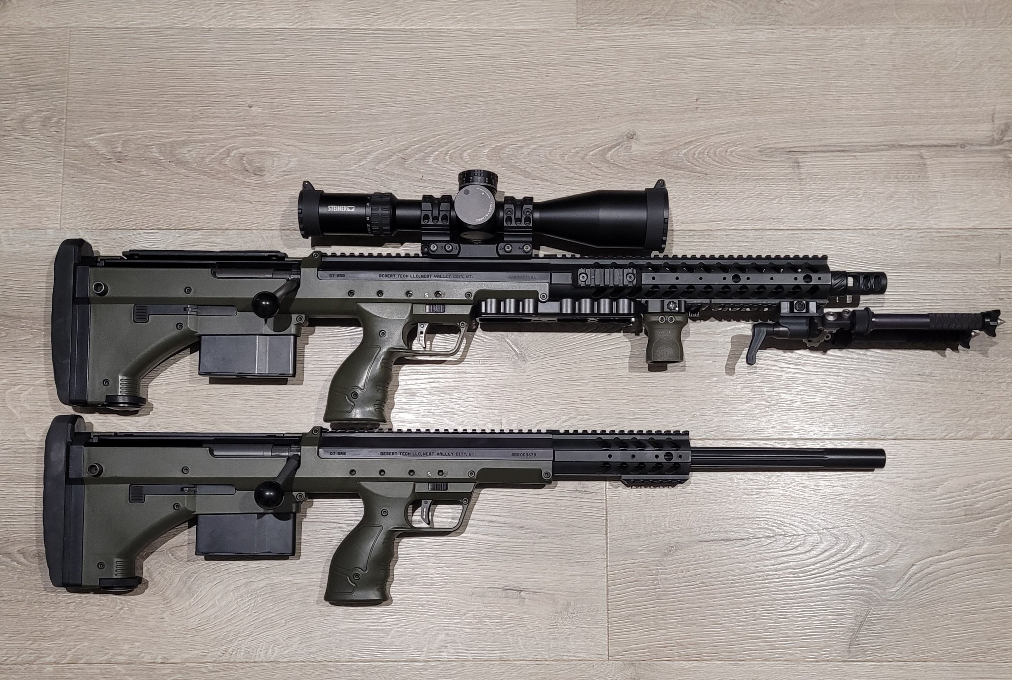

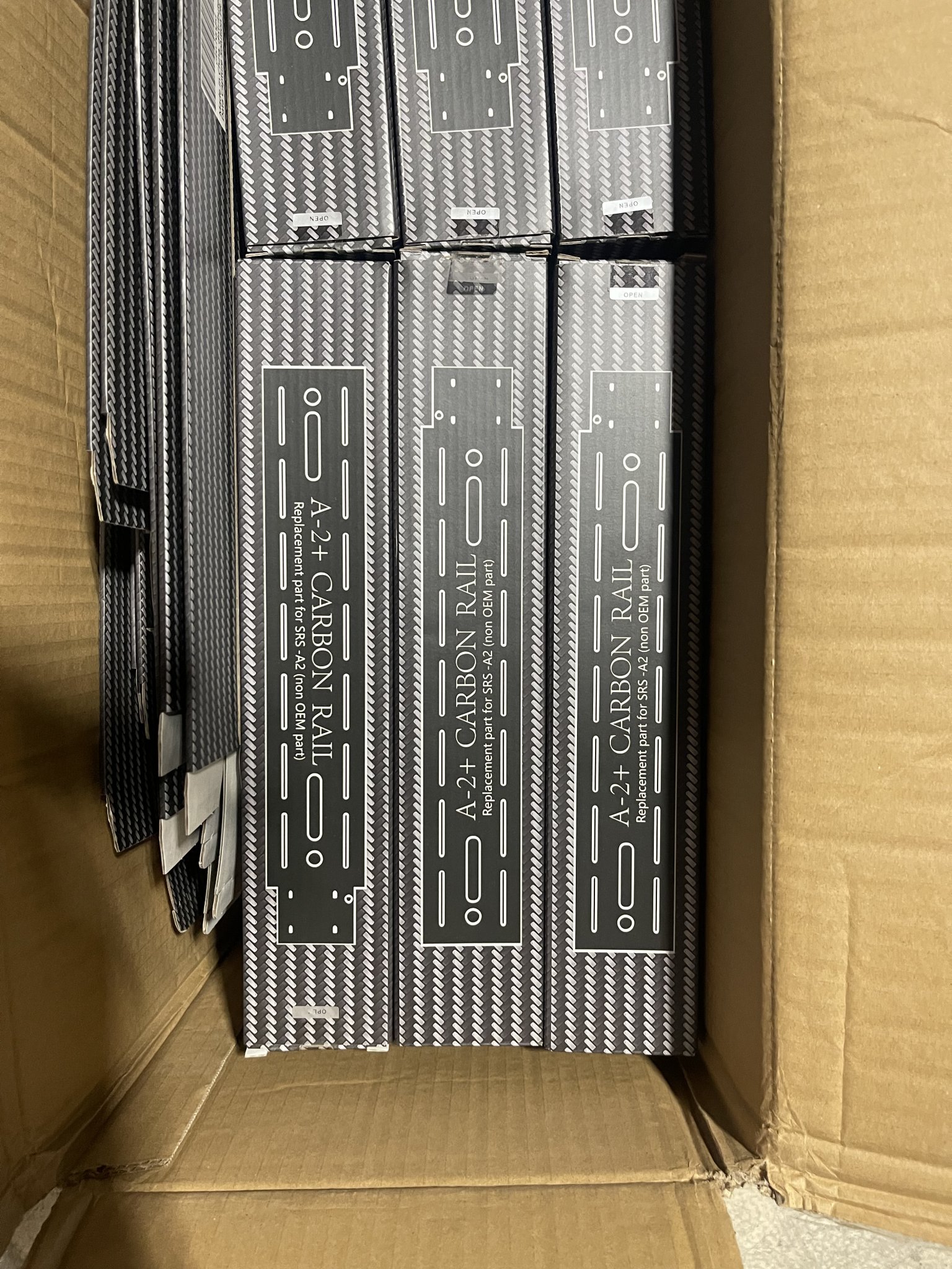

If anyone is interested I have 12" carbon fiber handguards for the SRS-A2
These will fit a 1.5" suppressor inside the rail (see photo below) with a sub 22" barrel.
The rail is also a lot more rigid/sturdy over the OEM rail and about 3oz lighter. I believe this improves accuracy shooting off the bipod.
DM me if interested.
NOTE: They WILL NOT FIT AN A1, and I do not have it have any in the works.

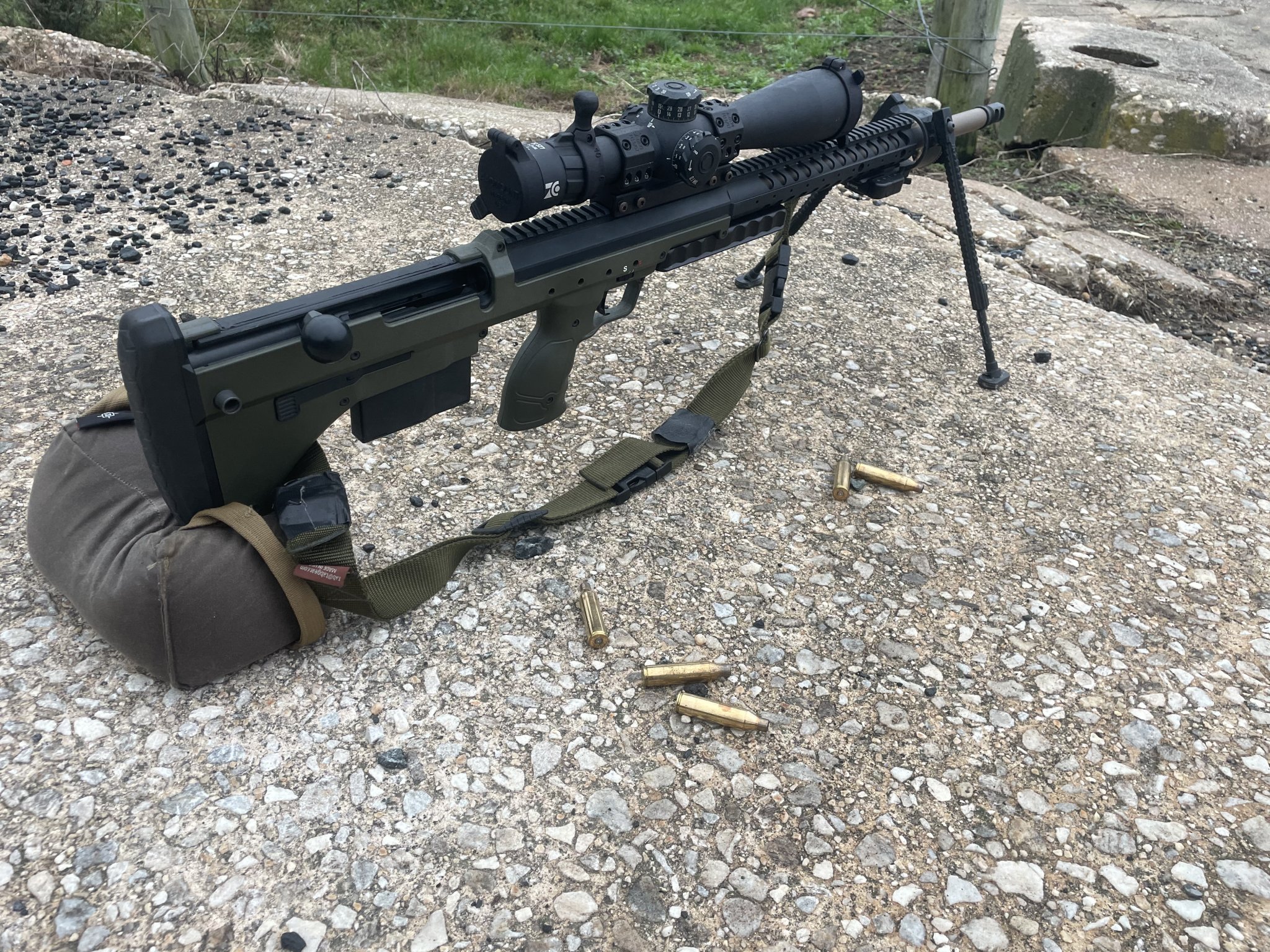

Put a 300nm kit in for my buddys antelope hunt.
Hope he doesn’t have to hike far lol. Thing is heavy. No cans allowed where he’s going.

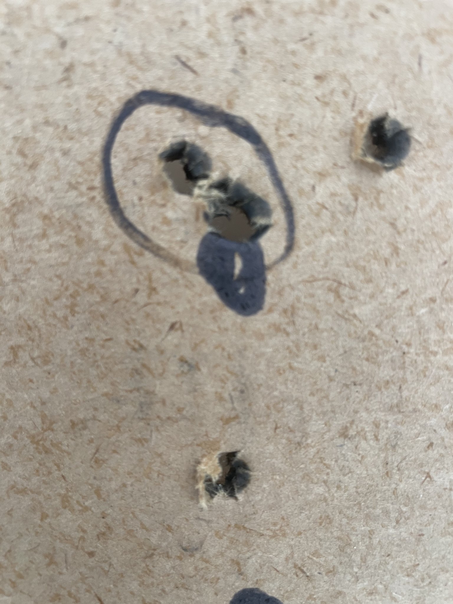

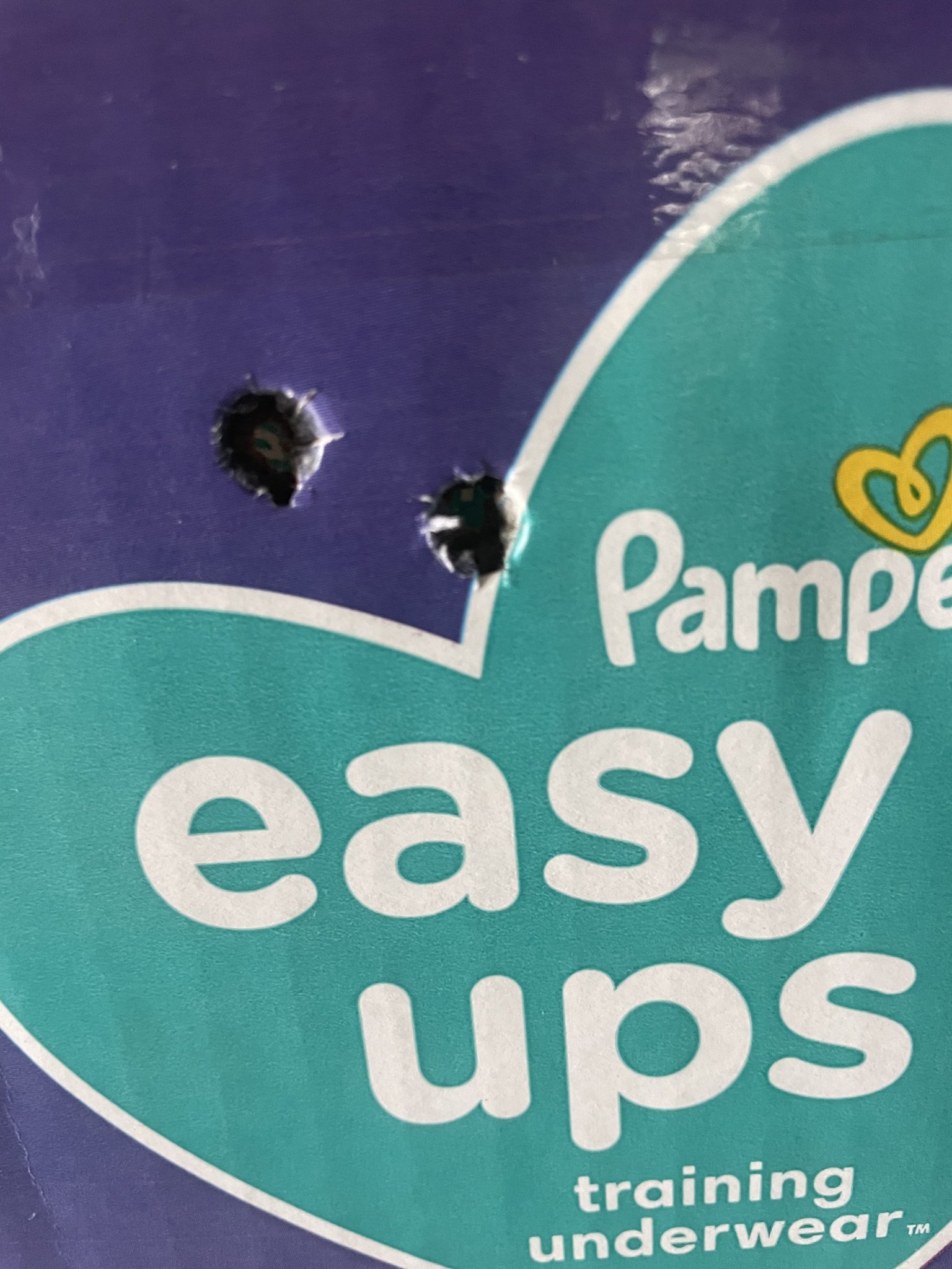

First 2 shots out of the barrel. From 2 different shooters. At least one was anticipating recoil.
A hair over 0.6”. Didn’t have time to shoot anymore.
Gun is a pussycat for recoil. I’ve had 223s that kicked more
