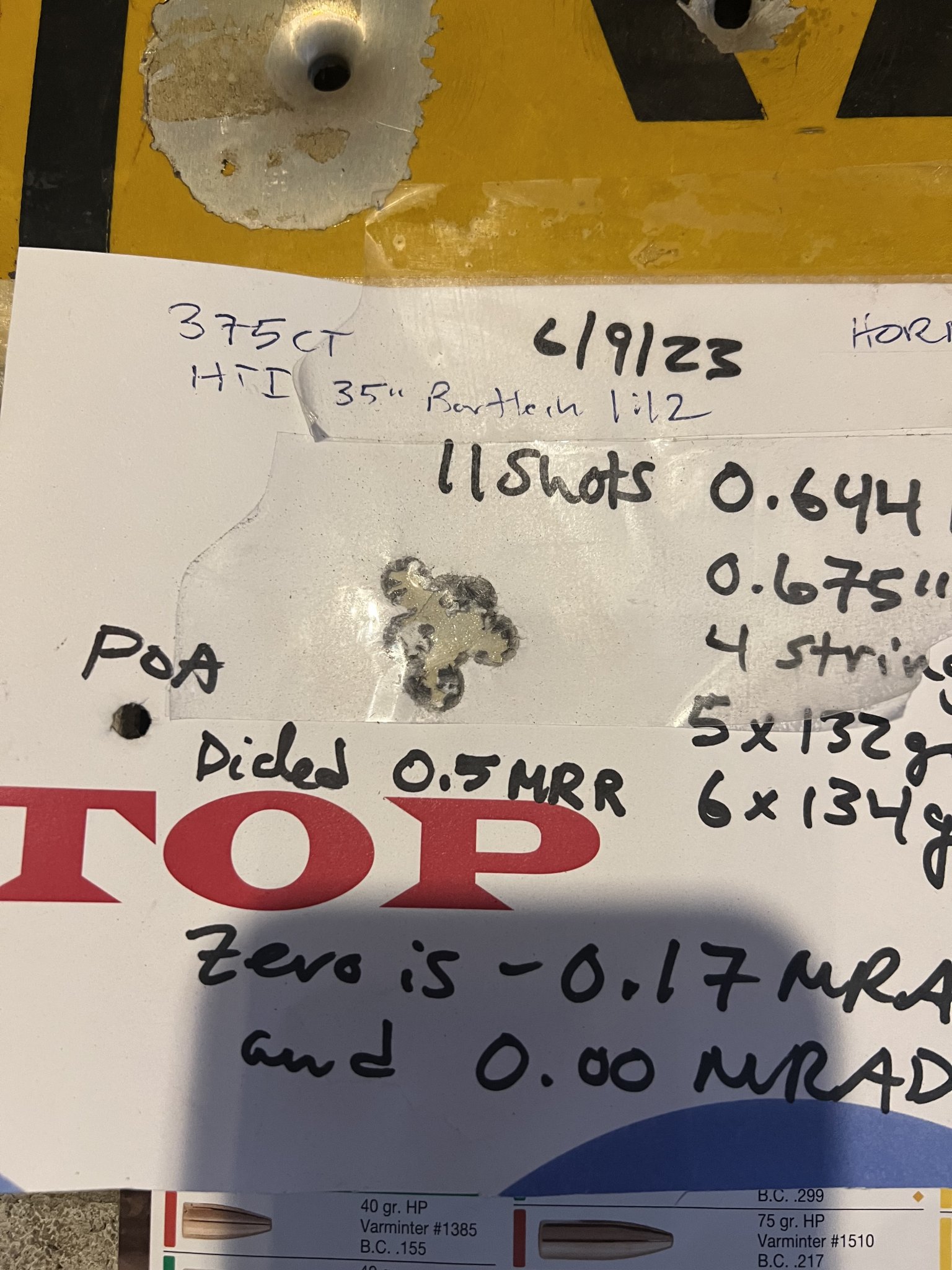

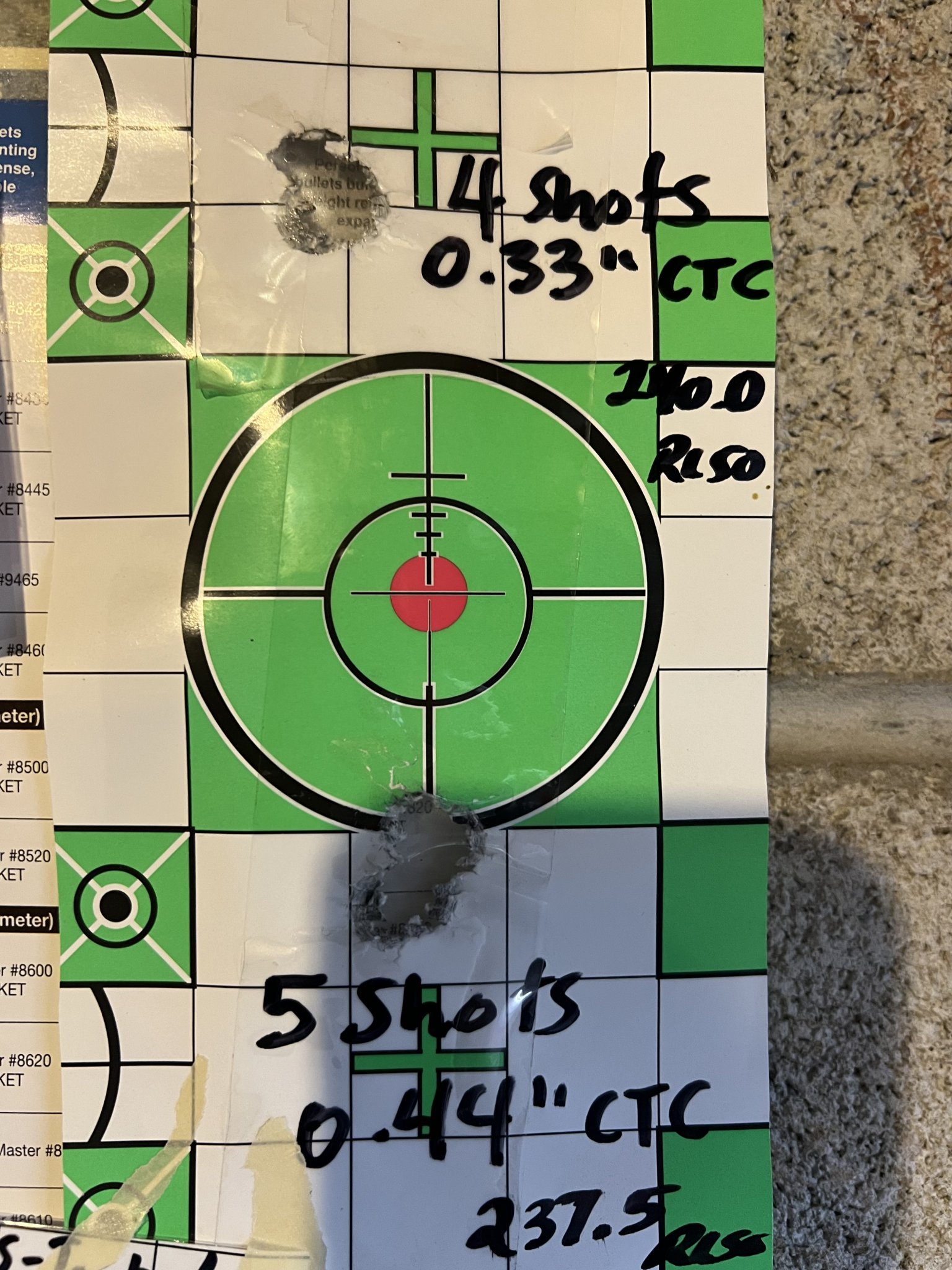

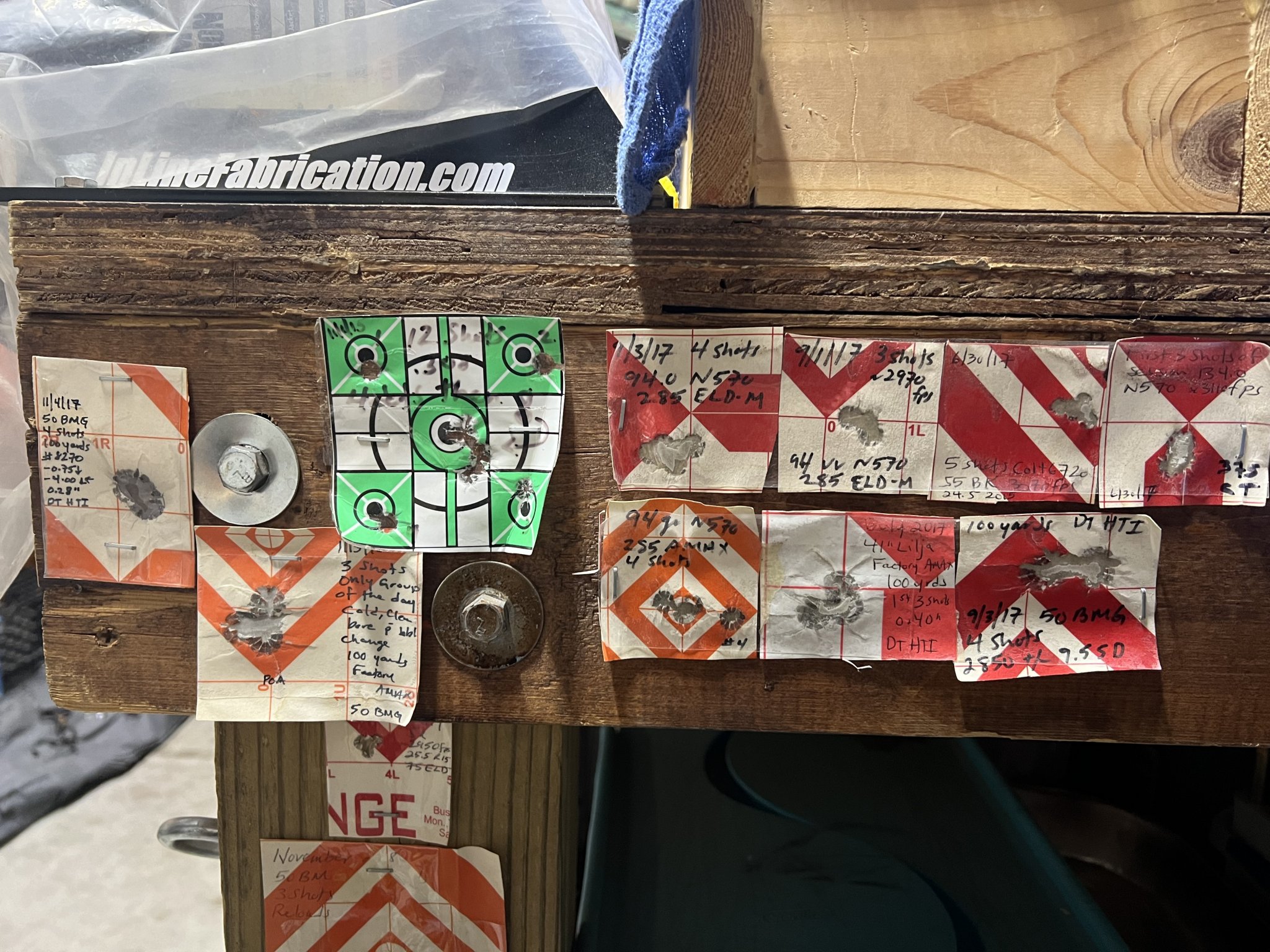

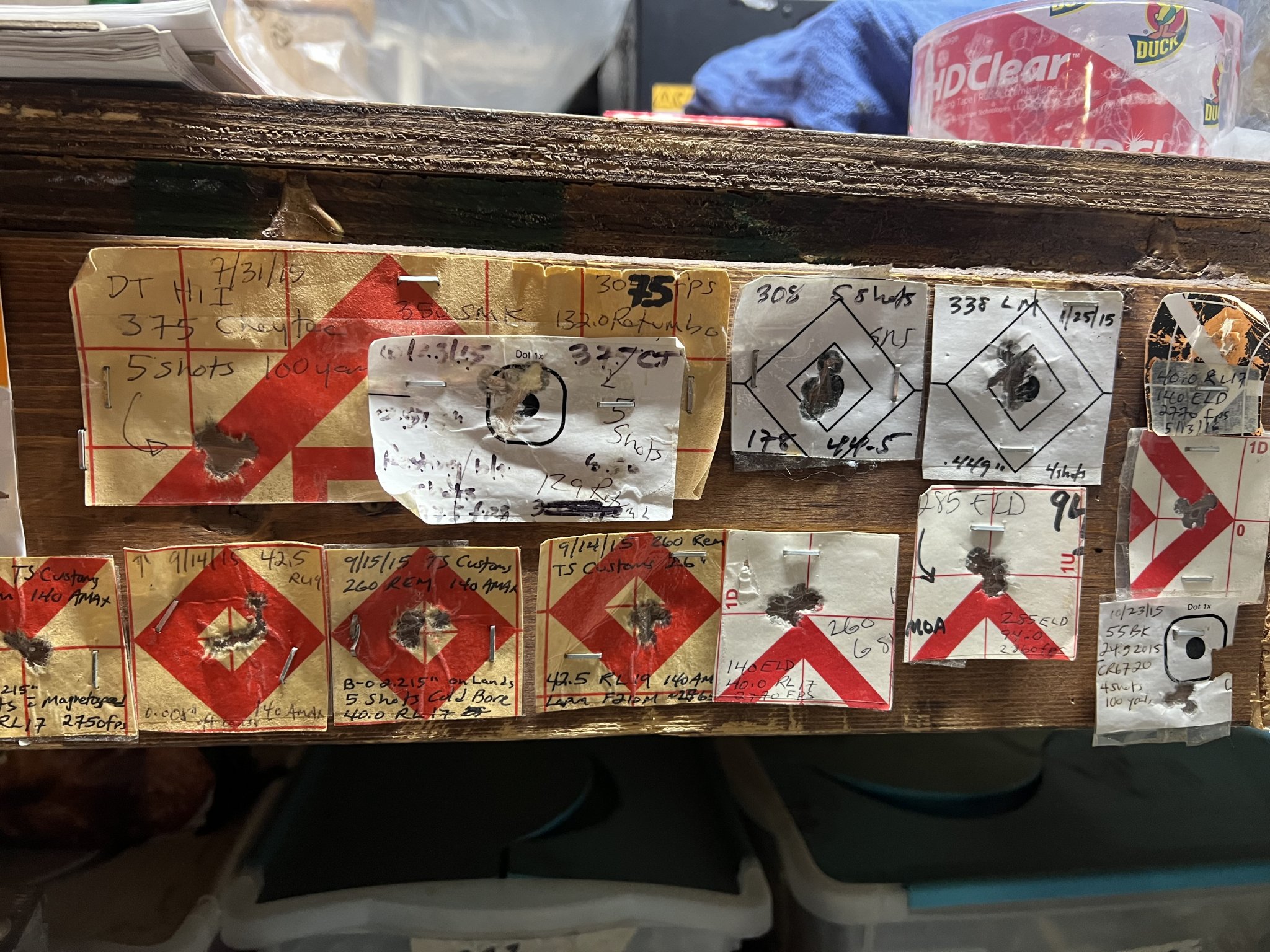

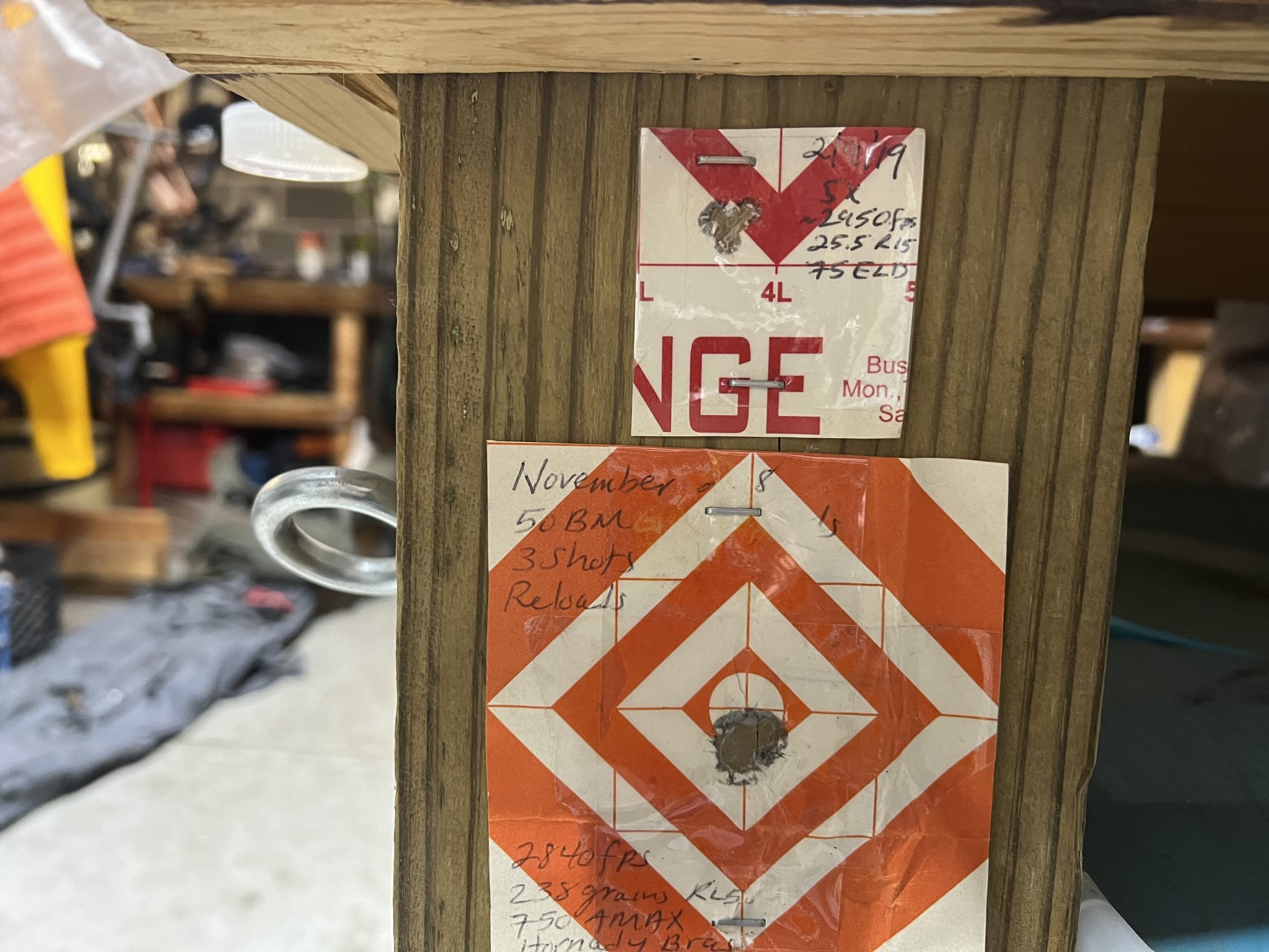

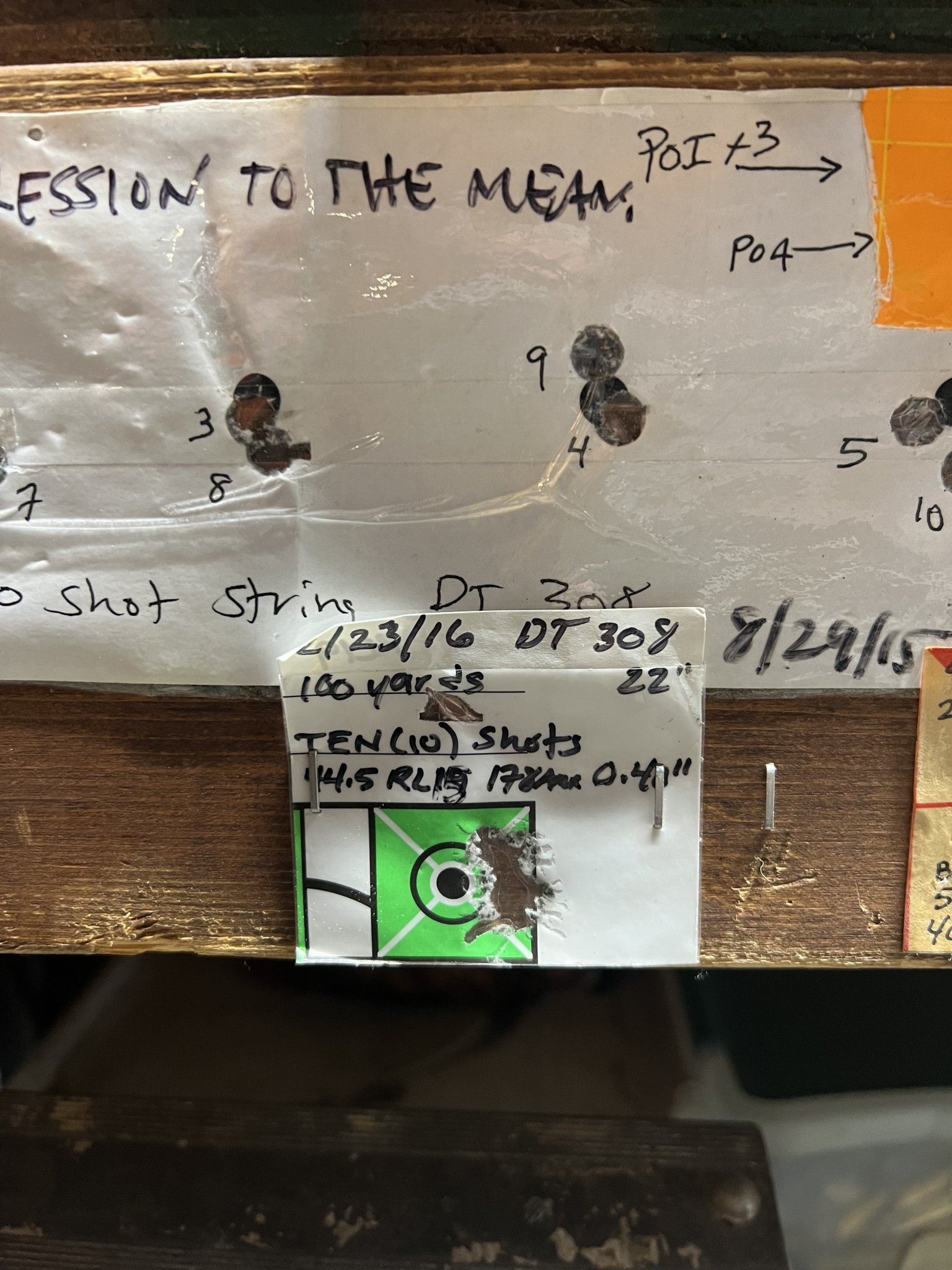

I love receiving emails/photos from our customers. Below is a photo I received from one of our customers after shooting 5 shots with the 28 Nosler Proof Carbon Fiber DT SRS barrel he purchased from us.
