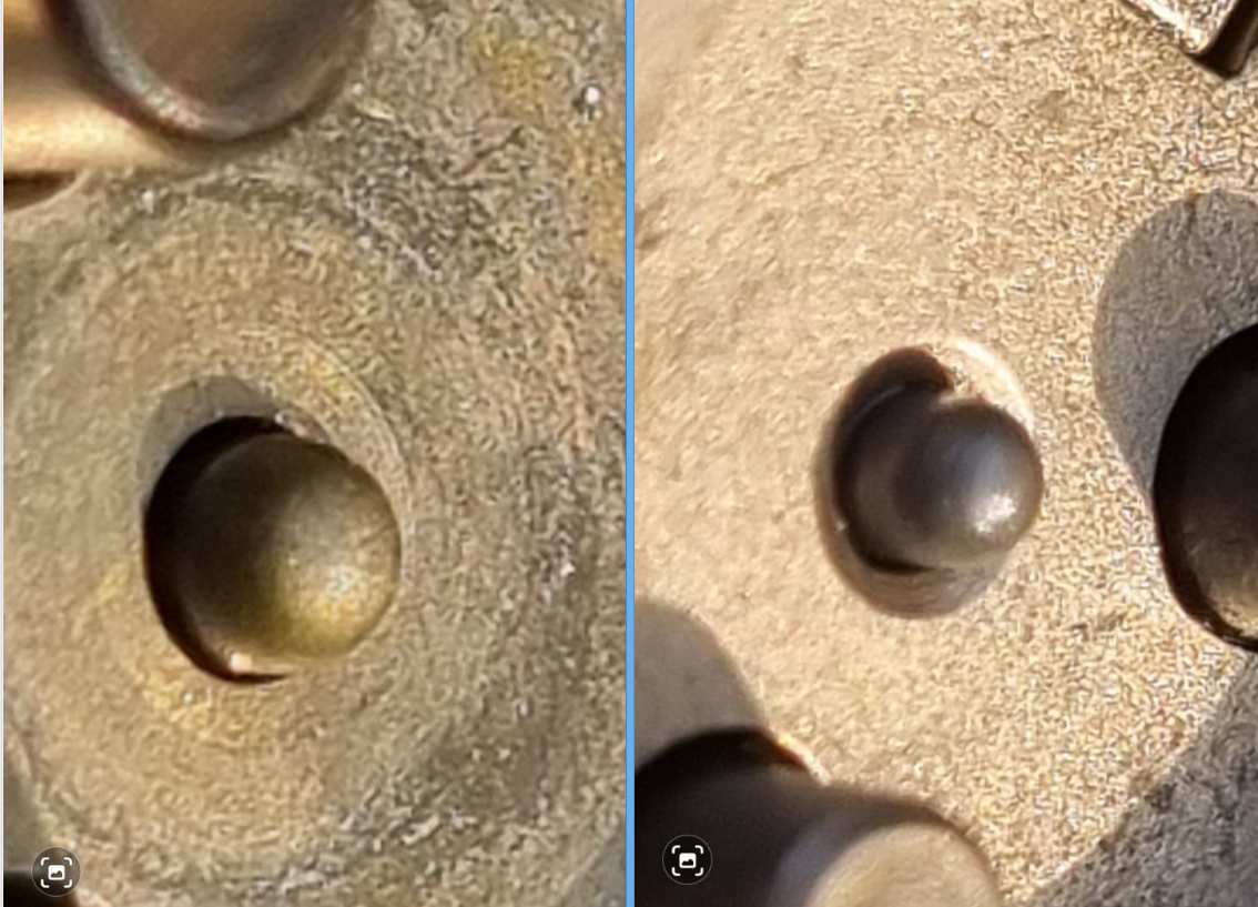

Several years back, a neighbor bought an SRS a1 on a desert tech close out deal when the a2 was coming out. He got a .473 bolt or .308 type bolt head as well as a lapua bolt. I did some barrels for it, but nothing for the .308 bolt. I bought that bolt when I bought my srs a1. I been using it, but it's a pita, the firing pin hole has a relief cut around it, and primers wash into that relief. It was a bad idea to relieve the edge of the hole. But whatever. It's a bad part made by dt on their behalf. So I sent an email, request to change the bolt for a good one. I don't care if they swap a bolt head or complete bolt. Got an RMA request, filled it out. I sent the bolt. Of course they want the complete conversion kit. But why? It's a part they made that isn't right. It's really simple. So I sent the bolt alone.....now were going round and round, I'll be lucky to get a junk by back without having to pay them. Anyone with some degree of intelligence, and some mechanical aptitude, an understanding of firearms and basic physics would simply swap the bolt. The bolt I have has a much higher potential of blowing a primer around the firing pin, which I'd prefer not to have my face on top of. But it's dt.

I have seen a few bolts come through the shop like that. They were all immediately swapped out by DT.
I had a 300WM bolt come with a chamfered firing pin hole .. Carson from DT organised a replacement ASAP..
yep. The ones we had come through our shop last year were the SRS-BL-BR or .300 WM Bolt assemblies that had the chamfer around the firing pin hole. It causes some major pressure signs on the primer.

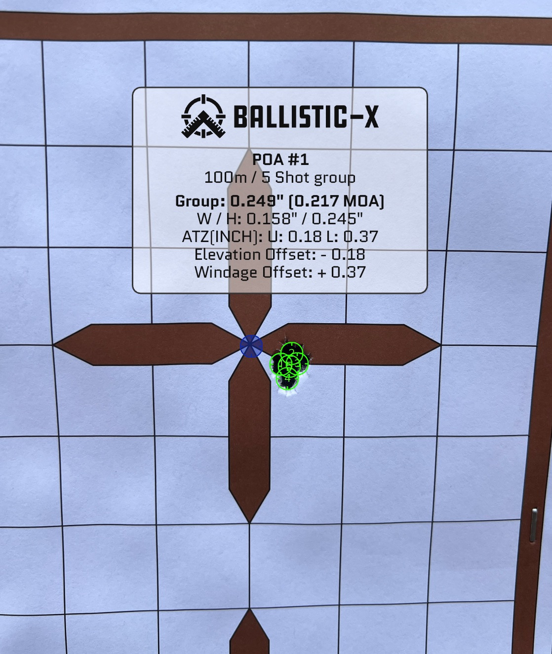

The SRS and I were on fire today.

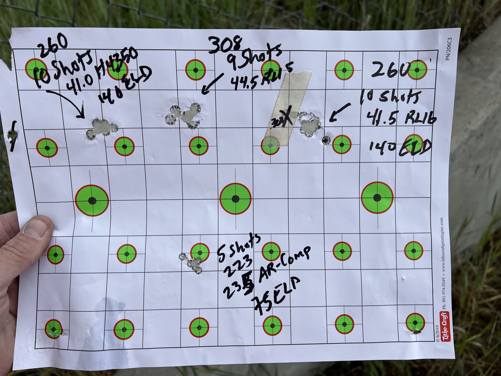

This is load development on my new ES tactical 260 barrel.
The 308 is my original barrel 10 years old and 5000+ rounds same seating depth as when I got it. It has lost its edge a little bit, but not much. Two of them just didn’t want to fall in line with the rest.

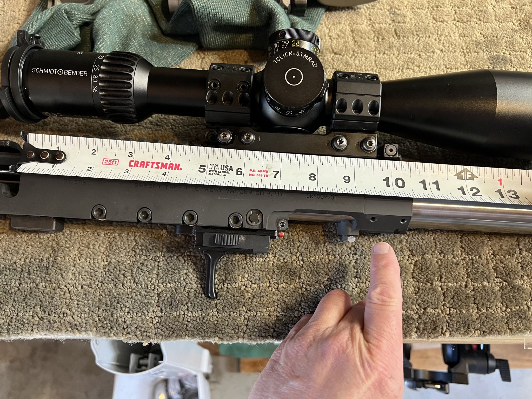

I have a full 1.250 in my A1
Works great
It should because that's what it is supposed to be. However, from what others have said, the A1's have been a bit loose with their tolerances and will allow barrels larger than 1.2500 to be installed. On the other hand, A2's have been held tighter to accept 1.2500 maximum diameter, not over.
Reactions: secondofangle2

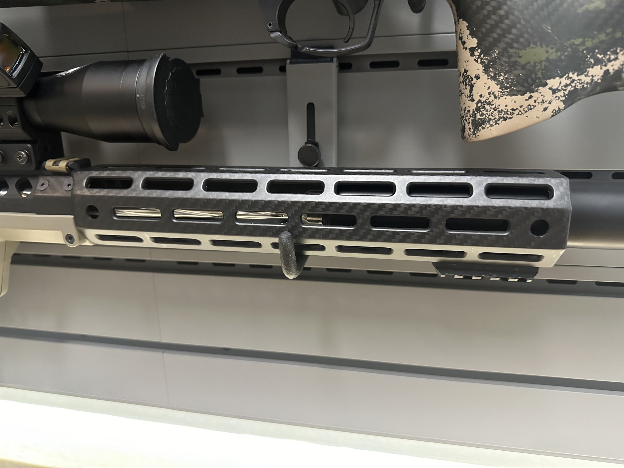

Yes, the diameter of the clamping mechanism has changed, but so has the design of the chassis to allow the A2 hand guard and the area where it clamps several inches forward of the barrel clamping mechanism also has a diameter of exactly 1.250 inches so the old trick that I used to do Buying a non-tapered 1.250 inch straight blank is no longer advisable
Reactions: 232593
Yes, the diameter of the clamping mechanism has changed, but so has the design of the chassis to allow the A2 hand guard and the area where it clamps several inches forward of the barrel clamping mechanism also has a diameter of exactly 1.250 inches so the old trick that I used to do Buying a non-tapered 1.250 inch straight blank is no longer advisableView attachment 8407261View attachment 8407263
Thanks for the information and pictures, I don't have a A2 or M2, but am interested in the differences from the A1. Do you have pictures of the handguard? Or any thoughts on different handguards?
It's just the MLOK style handguard that goes on the A2/M2 with 4 tiny screws. I think it's proprietary but I'm not sure. Complete redesign from the A1 with no cross-compatibility. At least you don't need the special tool to swap it. Would be very simple to make an aftermarket one that would bolt right on teh same way the stock one on the A2 does
Reactions: Dragoon300

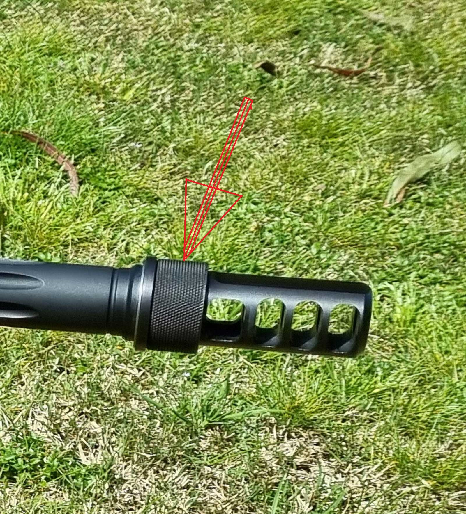

What is the thread pitch on the 375 cheytac muzzle brake for mounting a suppressor ?
.375 CT
.408 CT.416 Barret.50 BMG

I was asking about the brake, not the barrel threads.

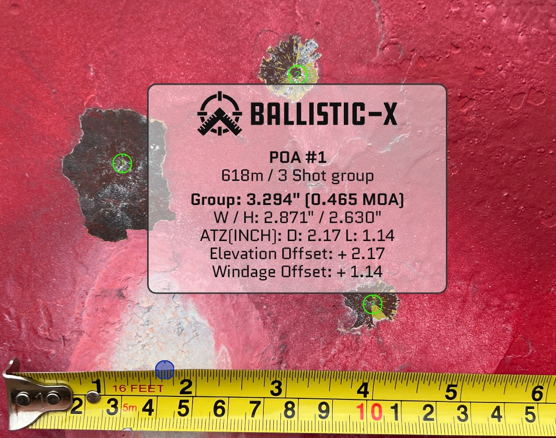

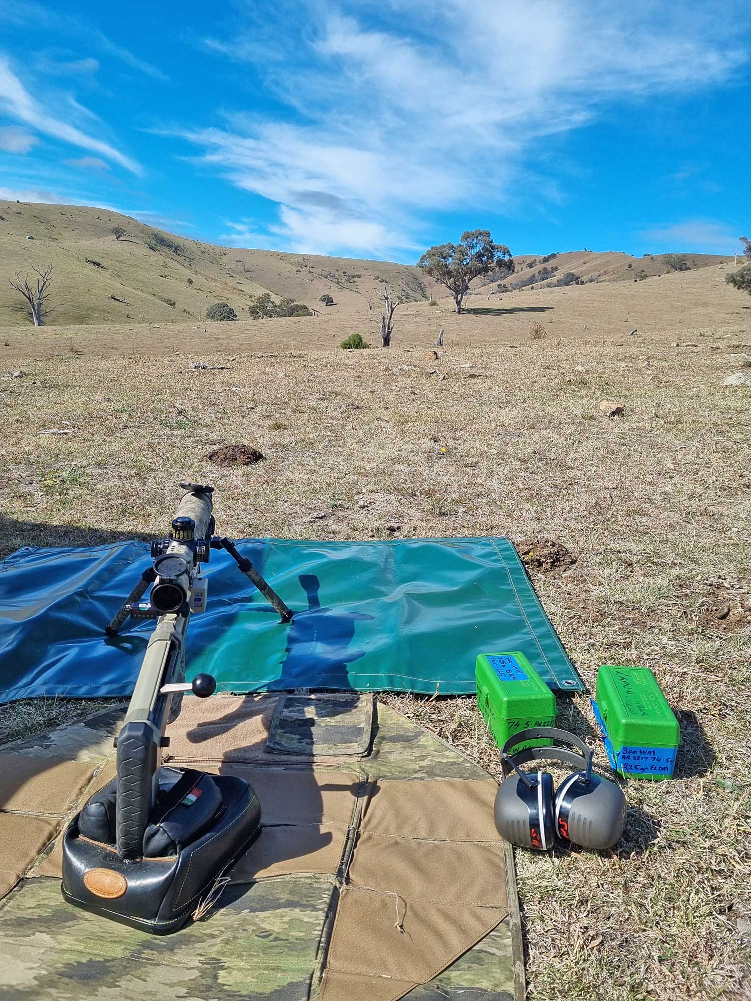

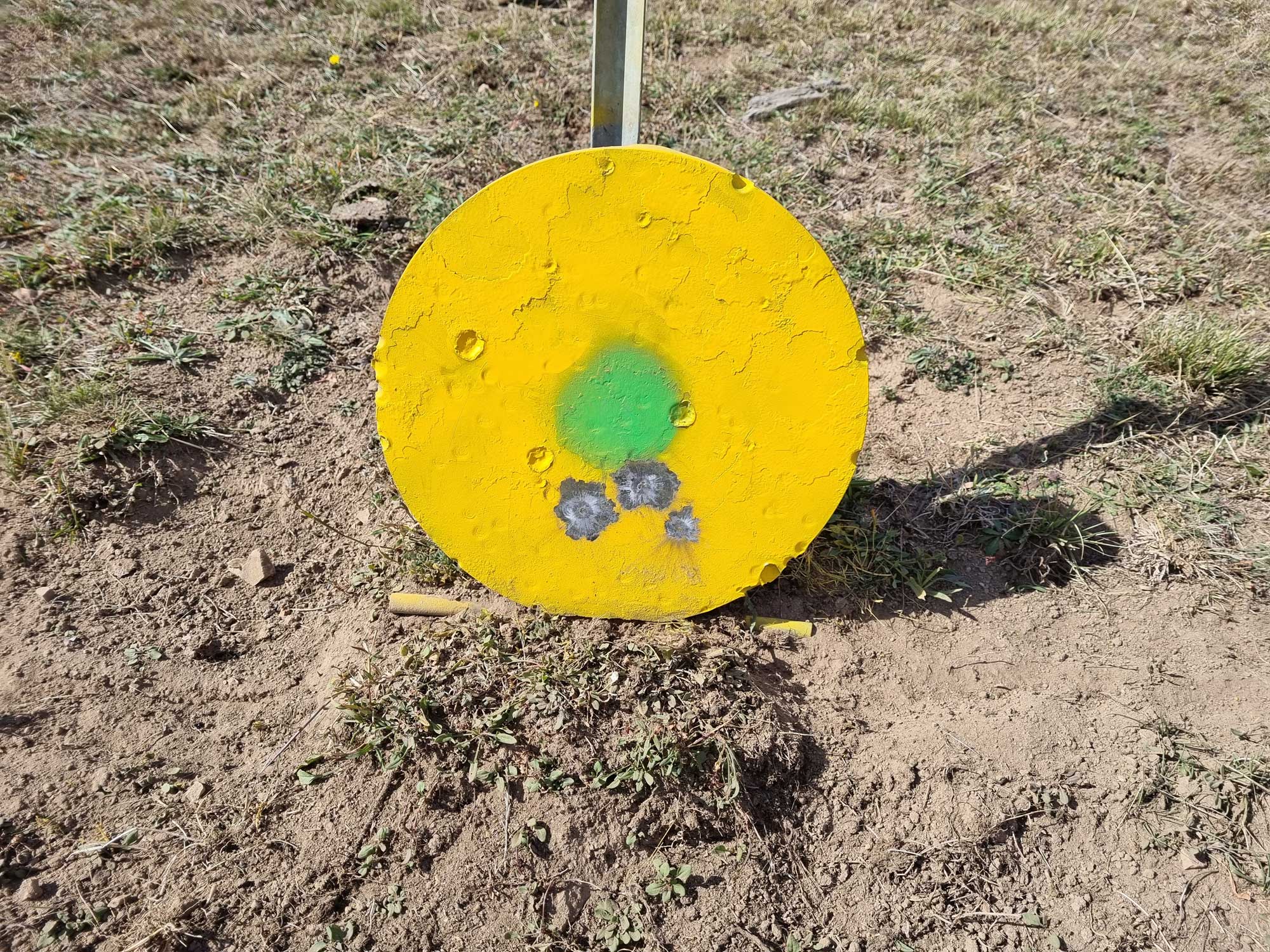

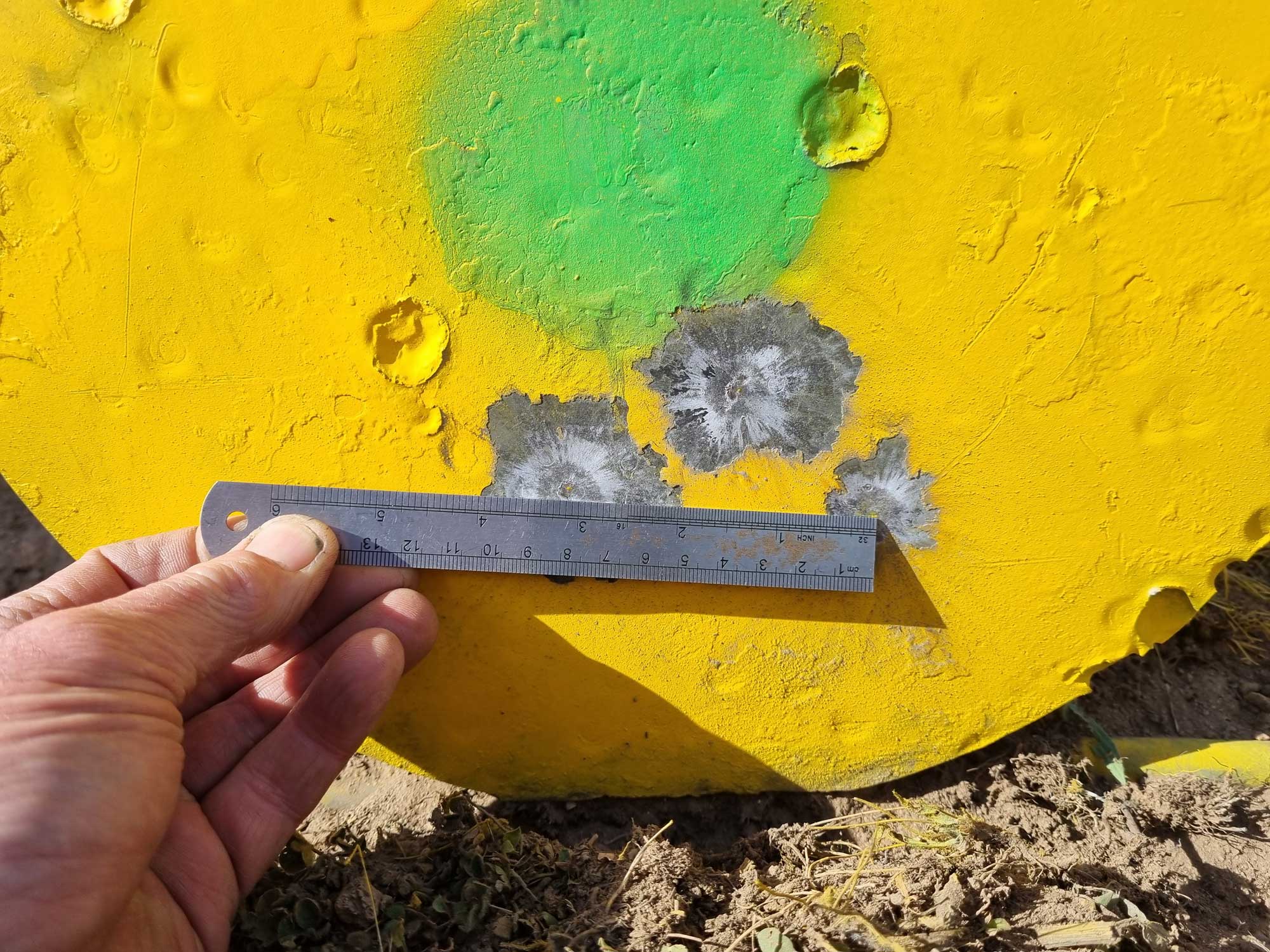

From reading here at times some may wonder just why we use the DT rifles as we seem to be forever bitching about various silly issues with sloppy QC..
Well........ today is why i will tolerate the silly QC issues and such from DT..
Perfect weather as we head towards Winter... cooling down and calm still days.. Myself and 2 freinds went out shot various ranges. I chose 1500yds with the 300Win Mag conversion........ Hornady 225 gr ELDM ..
These are the best consecutive 3 shot groups i have achieved at this distance !! This is with the factory Desert Tech 300 Win Mag Barrel... Absolutely superb accuracy !!! :)
All is forgiven Desert Tech..:ROFLMAO:

Ha ..... The "Toy" rifles are in fact the most accurate i have owned and used...and trust me i have had some very exotic rifles and custom builds..
