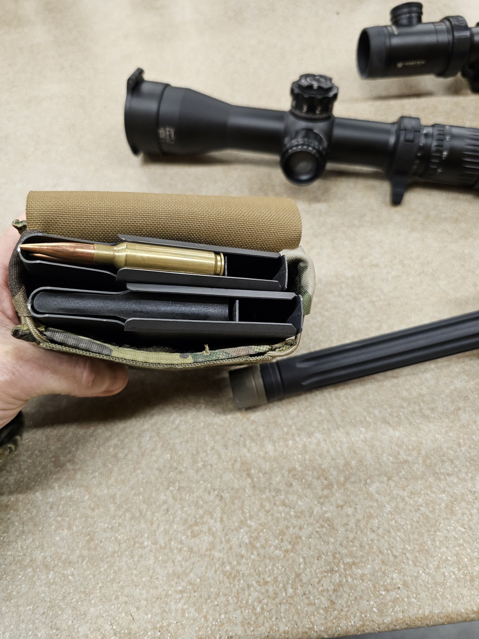

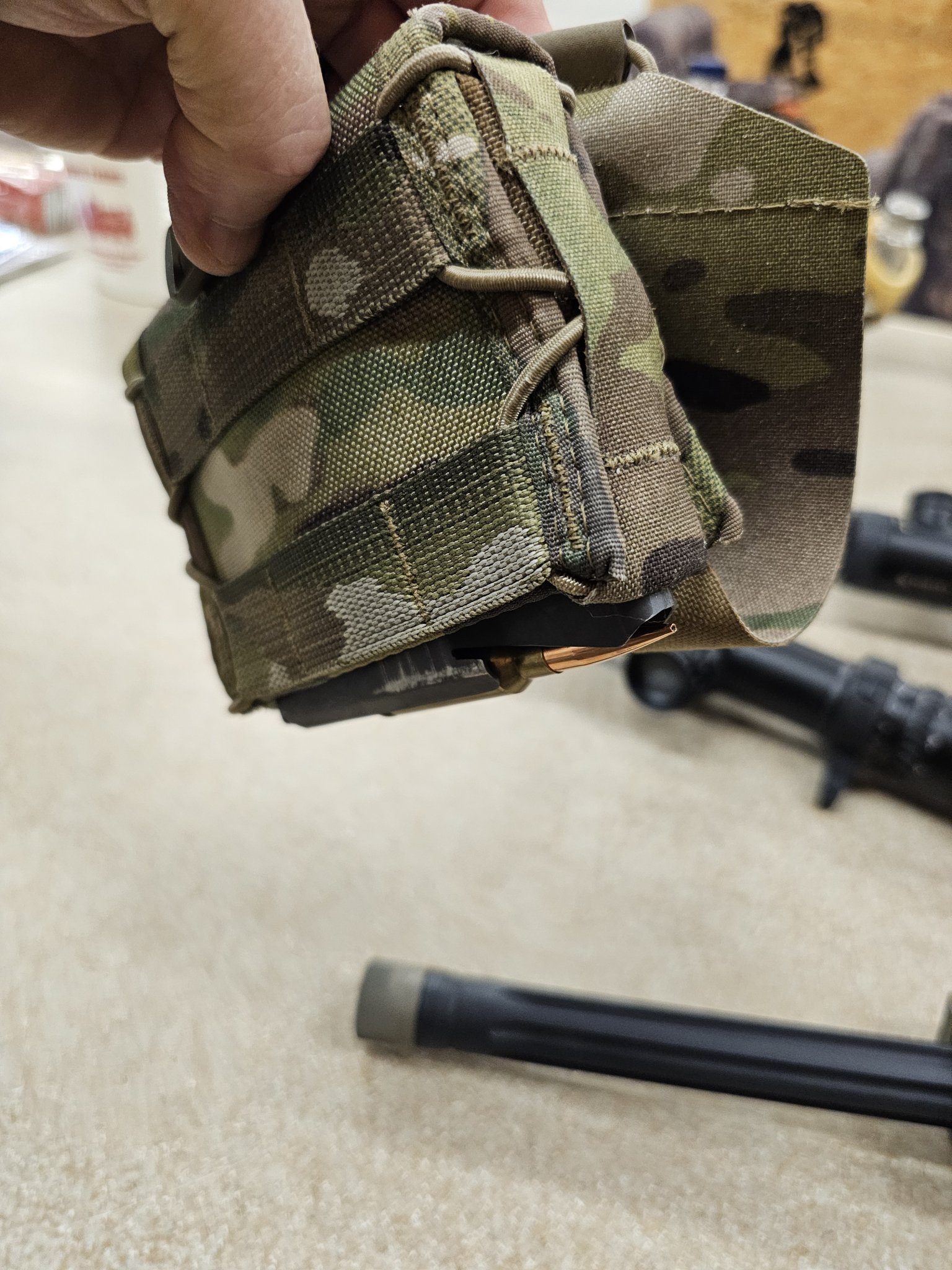

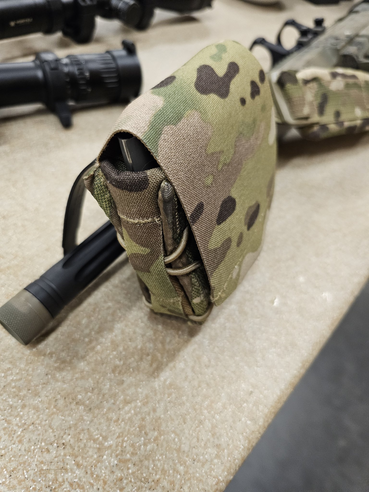

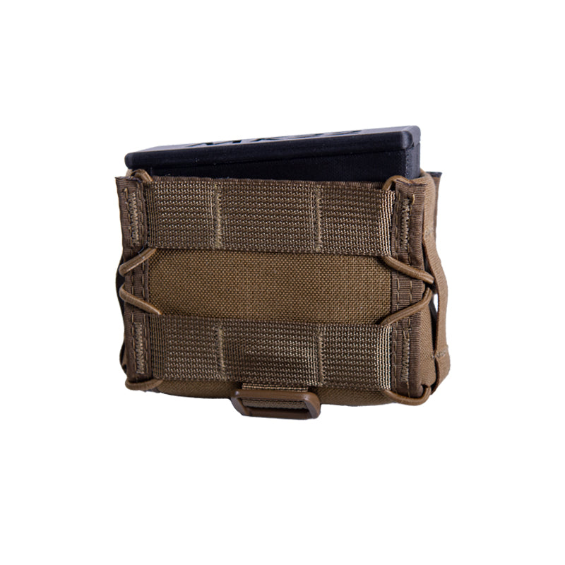

If you are looking for a good magazine pouch for Desert Tech I have found one that fits one or two magazines securely with or without the top flap. The top flap is removable if you want to run open top and width or tightness is adjustable so it can be friction fit for one or two magazines.
One mag
Two mags

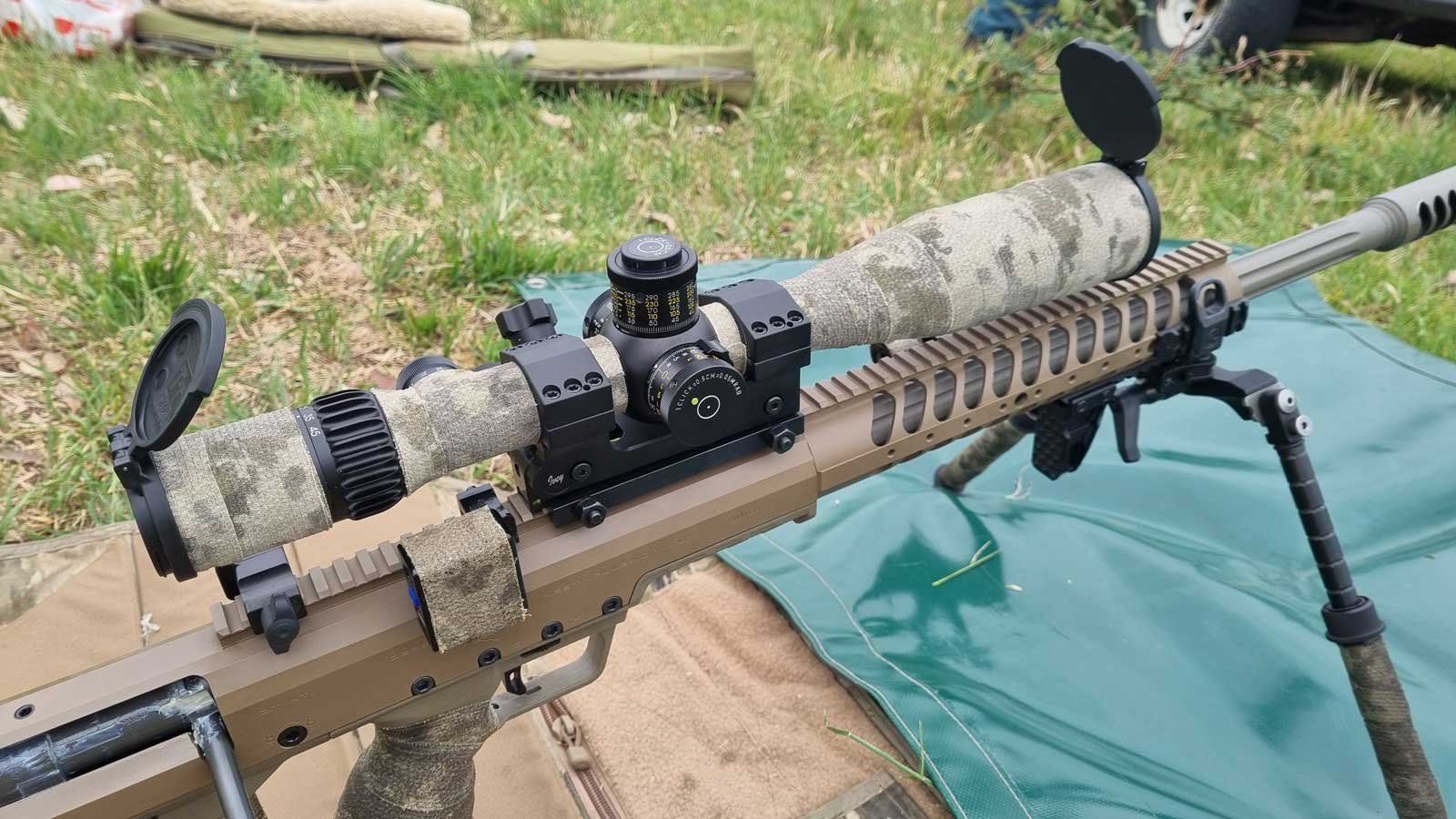

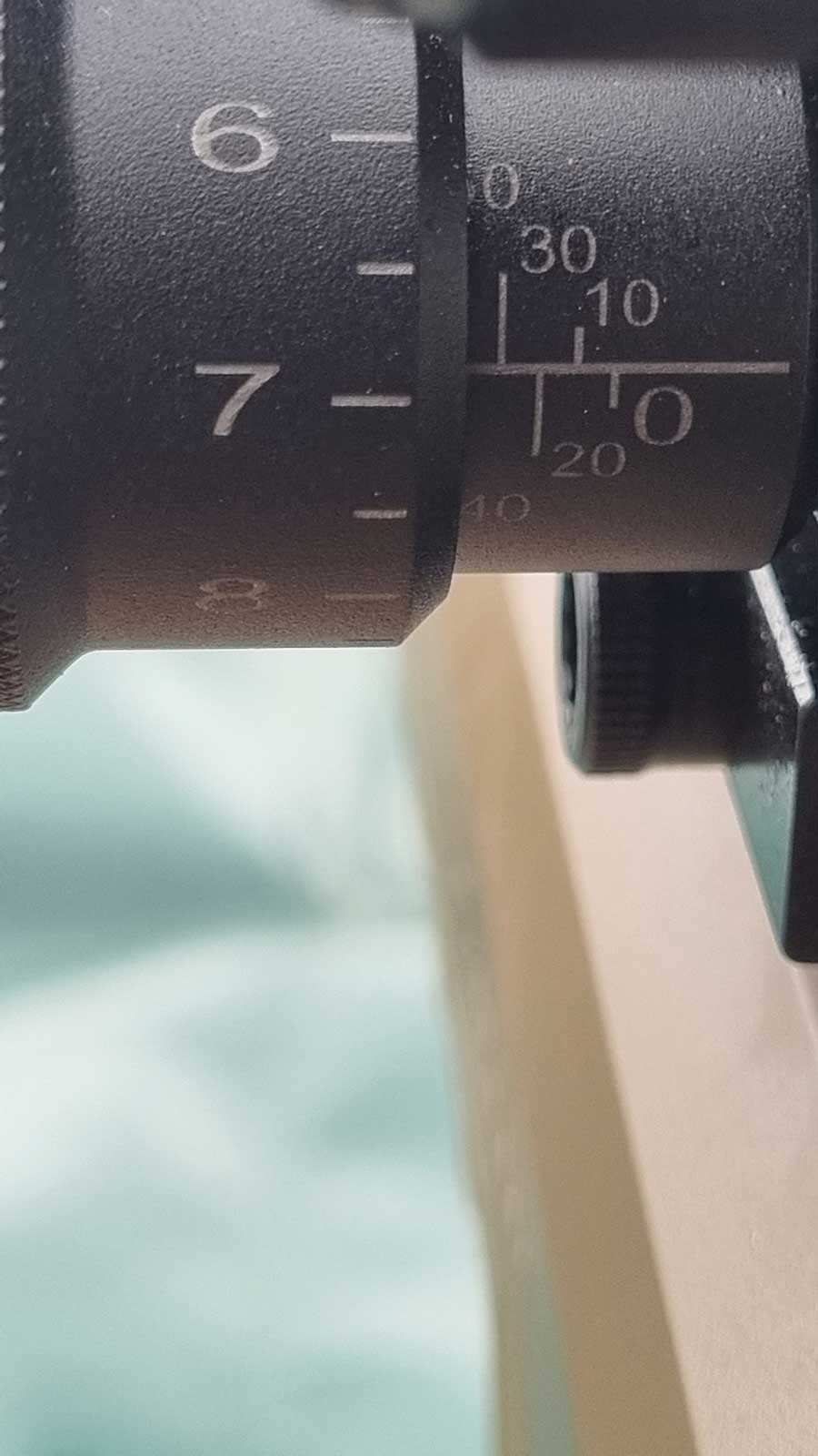

3060yds yesterday...
S&B 5-45 ( HTI 375CT 390gr A-tip) and DNT Optics ( SRS 338 lap 300gr A-tip) ...
338lap with 300gr A-tips did VERY well...
