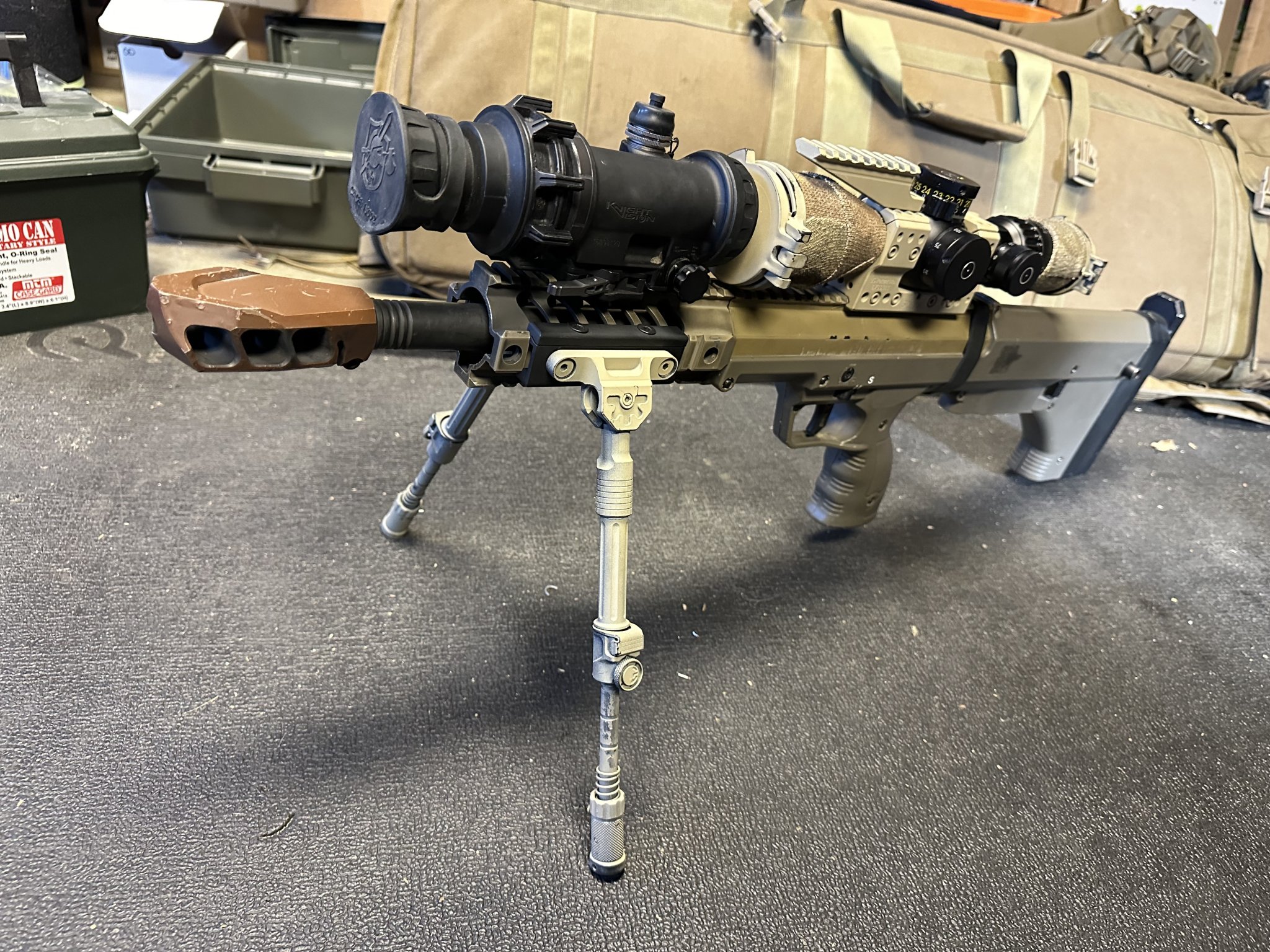

Started work on something new. The factory cheek rest doesn't go high enough for me so I made one from carbon fiber. This is a quick and dirty R&D unit. I'm trying to create a replacement for the stock itself now. I have some improvements to the factory model I'm trying to implement like AR-15 grip compatibility, among other major updates. The carbon fiber cheek rest is tons more comfortable. It's also more rigid and lighter. I used 5 layers of carbon fiber and went through numerous resins before I found just the right one.

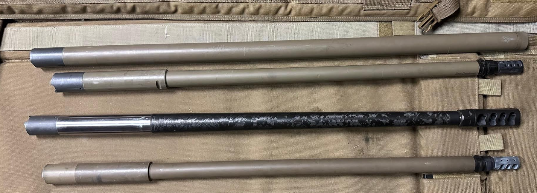

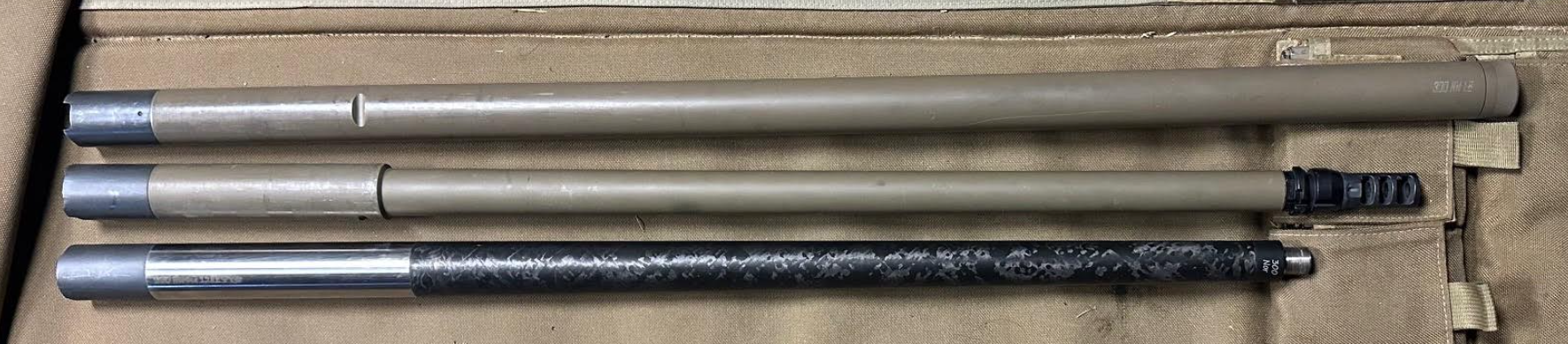

For anyone looking to shave weight off their SRS, the Proof Carbon barrels @PRDRIVER sells are about 30% lighter than similar barrels
these were weighed with my wife's shitty bathroom scale, so take the actual values with a grain of salt, but pay attention to the difference
Top - truck axle 1.25" straight 30" .300NM from SAC - 9.8lbs
Middle - standard SAC profile 26" 6mm Creedmoor - 6.3lbs
Bottom - Proof Carbon 26" .300NM - 4.2lbs
When I unpacked the new barrel I was surprised just how light it is compared to the other 26" barrel.

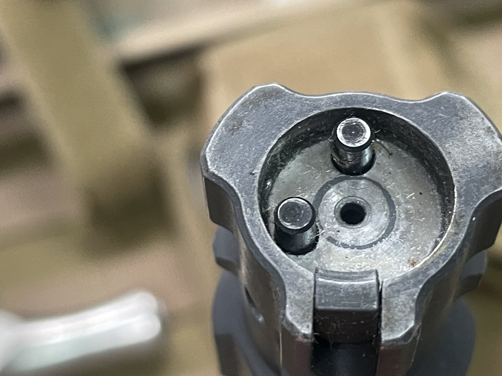

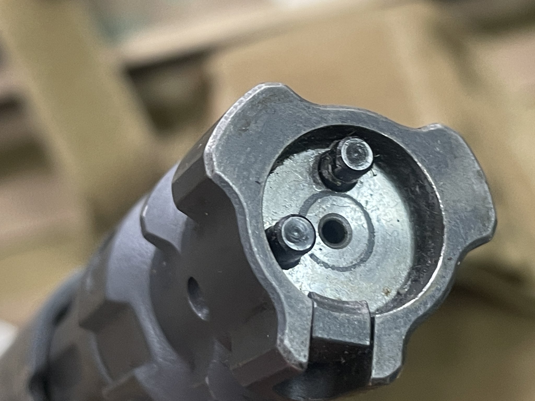

Hey guys, i picked up this .300wm bolt off the Hide a while ago and im getting ready to spin up a barrel for it. It looks like this bolt has been reworked after it was finished and im wondering if the massive chamfer on the firing pin hole is going to be an issue. Any thoughts?

Yeah, IIRC DT released some of those that were out of spec. They may warranty it, or maybe you could bush it. There is talk of it on this thread a couple of years and probably many pages back

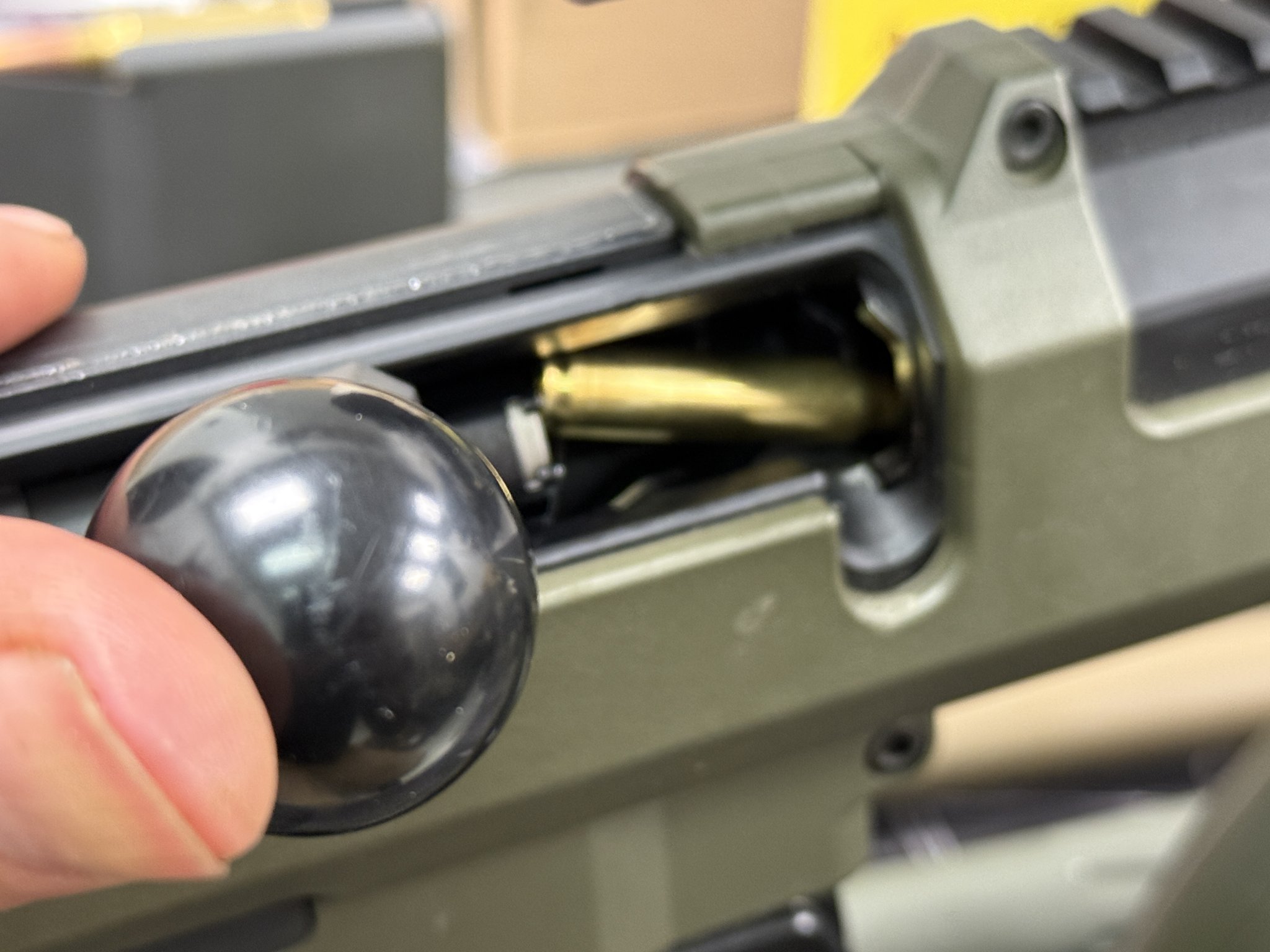

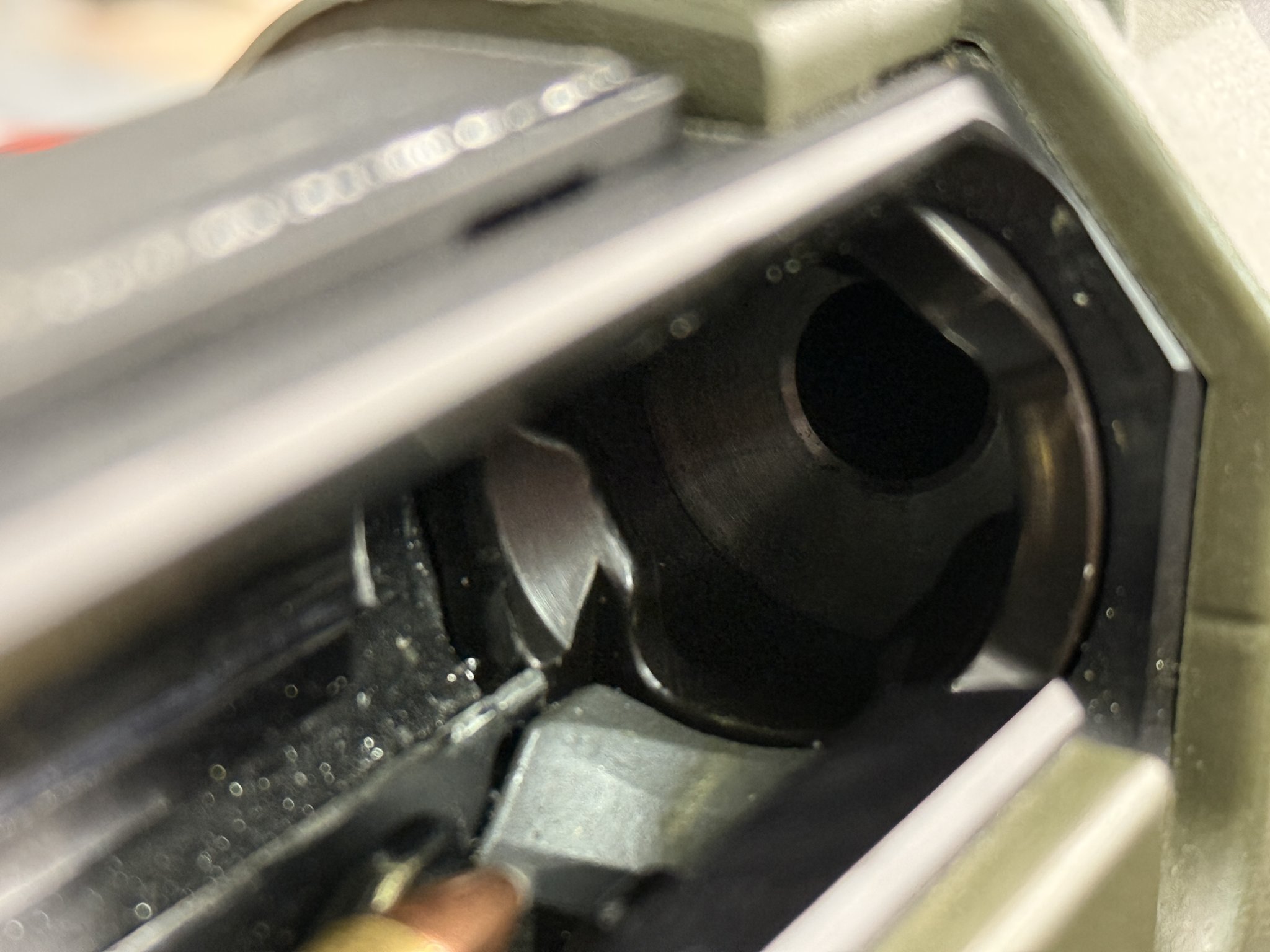

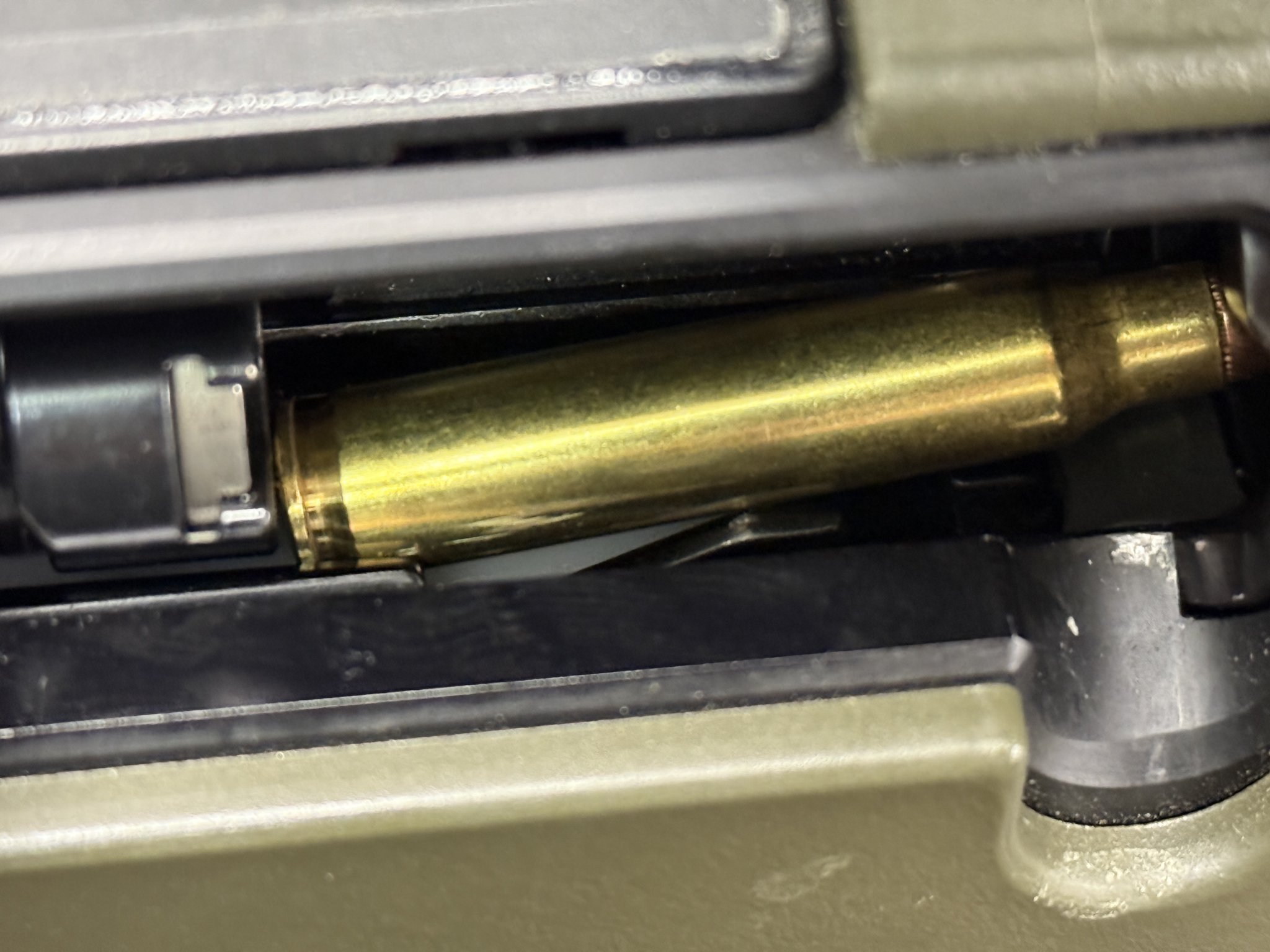

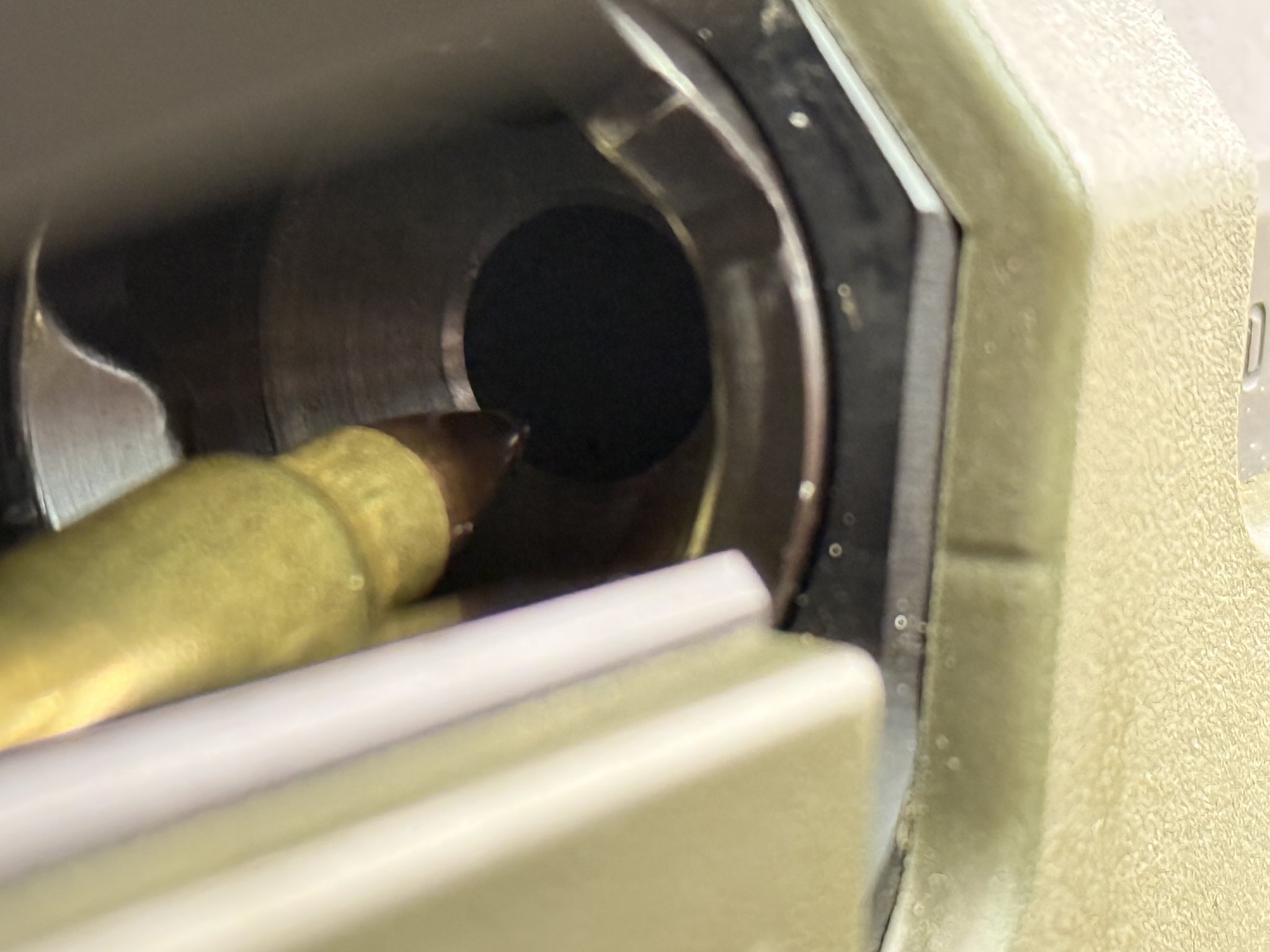

Ok guys, im struggling with feeding .223 55gn. Soft points in my SRS A-1
I bought the .223 kit from SAC but chambered the barrel on my lathe.
the rounds are popping out of the mag before the round enters the chamber.
Its better if i feed it fast and hard but even then its 50/50. Im wondering if increasing my chamfer on at the entry of the tenon would help?
