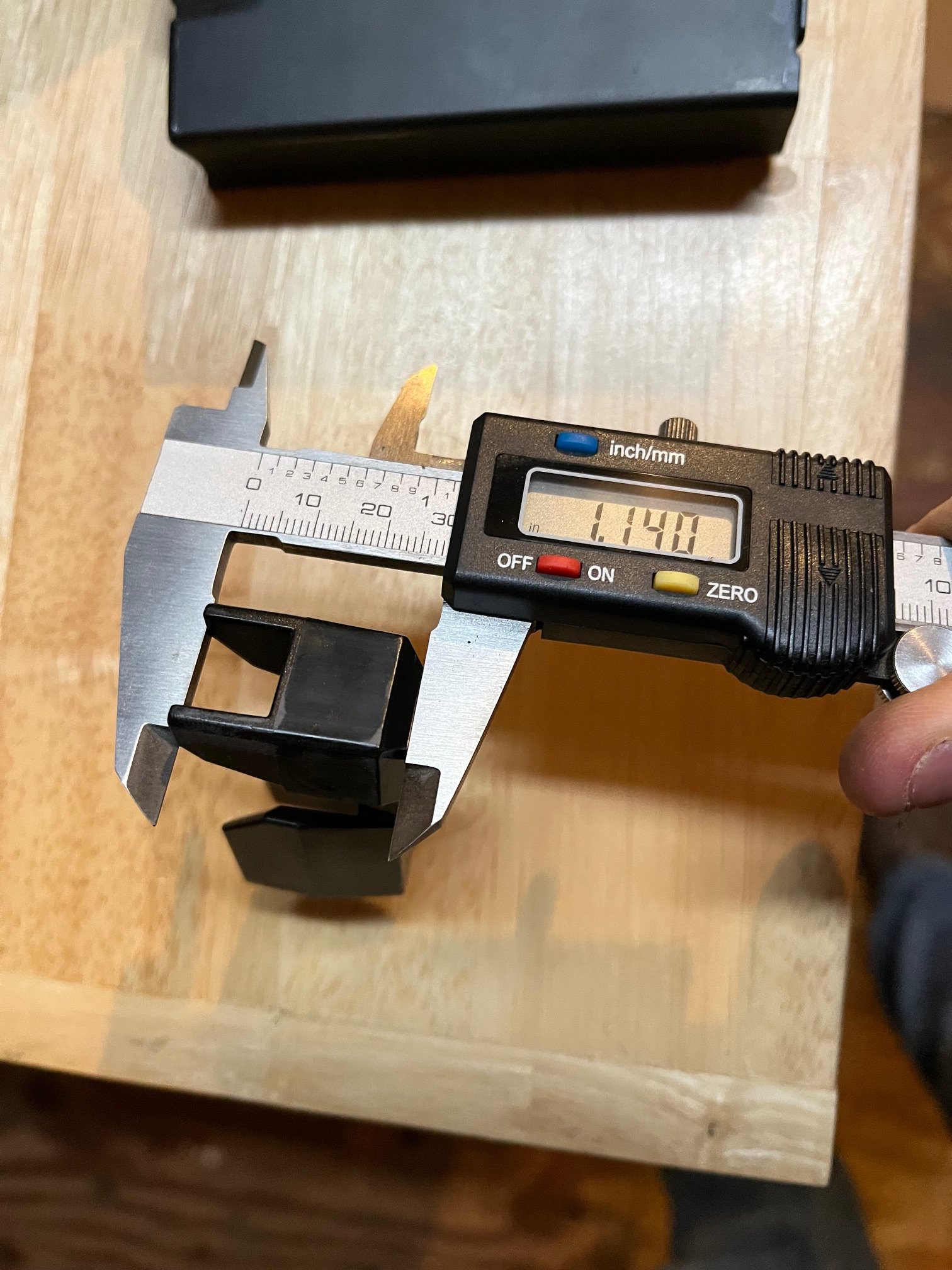

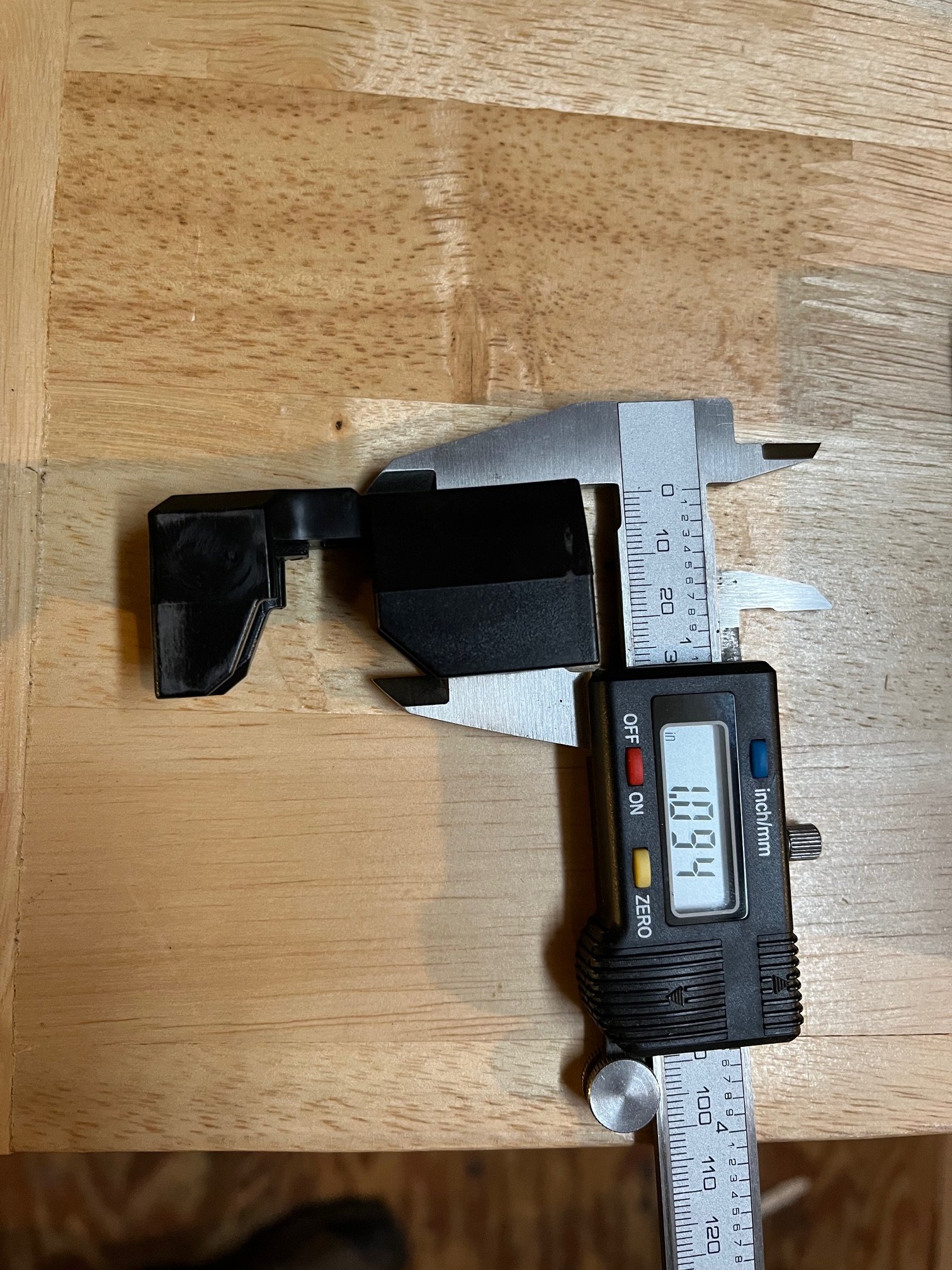

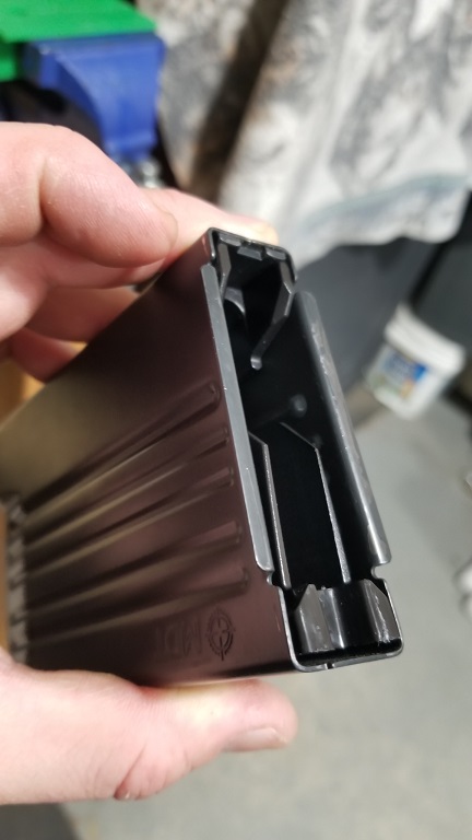

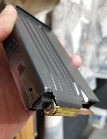

Funny you should ask, and I appreciate you taking the time to check back! I actually just did this, here was my experience:
- I've wanted a "full mag" indicator for awhile, because I'm a little neurotic about having a fully loaded mag going into a stage and I often lose count. So, then I have to unload the whole mag and reload it...anywho. I decided to go very low-tech, and just figured out where the follower spine is when the mag is fully loaded, with the intent of drilling through the mag wall and into the spine to leave a little neon dot.
- Much to my surprise, the feet of the follower protrude well past the bottom of the mag when it's fully loaded. The spring isn't the issue, it's that the magazine literally does not have enough room for 12 rounds plus the follower; the way you "fit" 12 rounds in there is by swelling the mag body as @terrell35744 notes. The follower sticks out about 3/8" of an inch from the bottom of the mag, I'd say.
- So, I cut off about 1/4" of the four follower feet and checked function, seemed to work fine so I did it to my other mag, then went back to my original plan. Drilled the holes, painted a little dot of neon on the follower, and now I can fit 12 rounds without a pry bar and can also tell when I'm all full.
- Haven't had a chance to run the mags in a match or practice yet as I just yanked the BR barrel, but I'll update when I do.
I appreciate MDT following up, but do you mind if I ask why you issued a design with dimensions that clearly can't truly fit the advertised round count? You've shipped updated mag followers (for free, I'll add, many thanks), did MDT just experience follower tipping when the feet were shortened?
ETA: If anyone's interested in my little DIY mod, I can post pics
Reactions: DIBBS and Dolomite
You're very welcome and always happy to help. I have passed this info onto our team and will look into it further.
Once you have run these magazines in a match, please let us know, we would love to hear how it went.

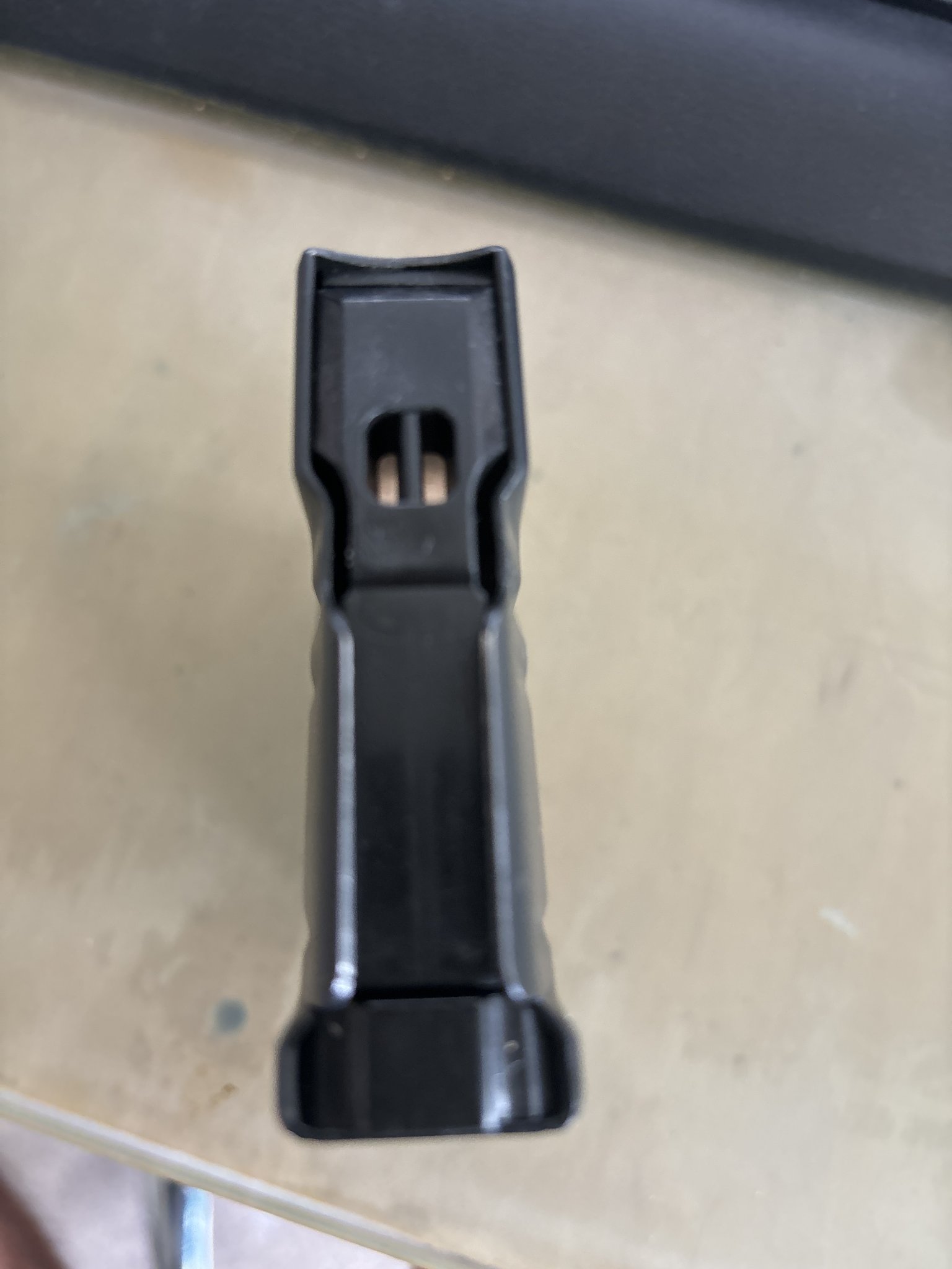

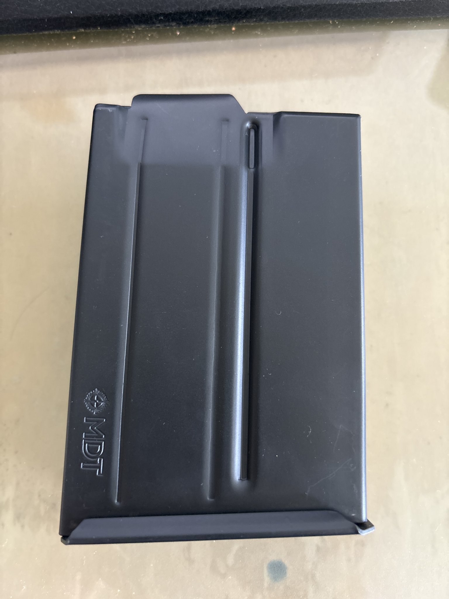

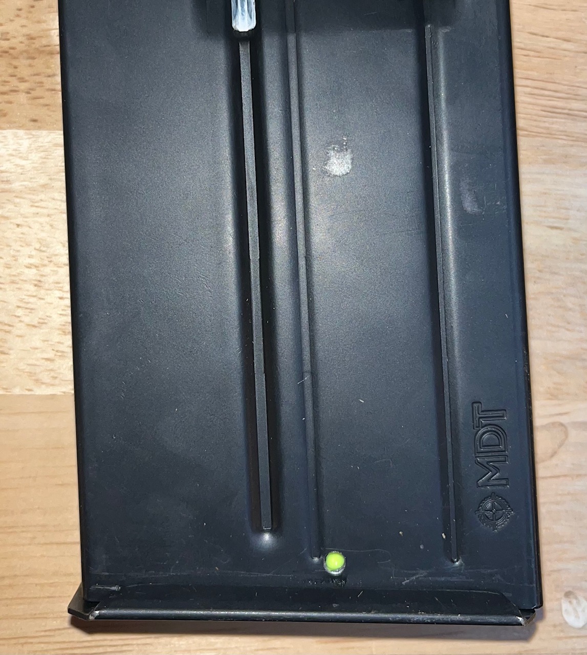

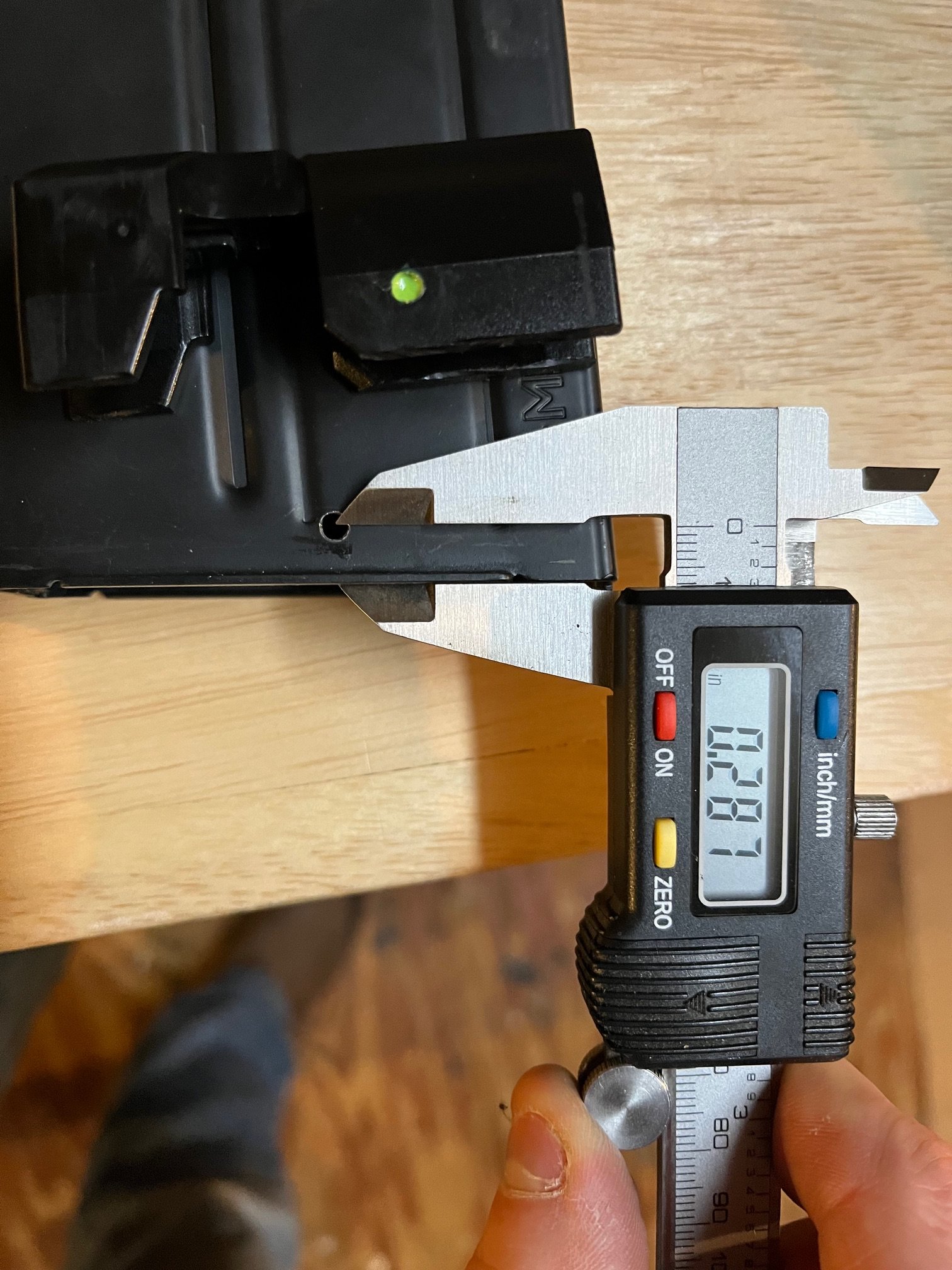

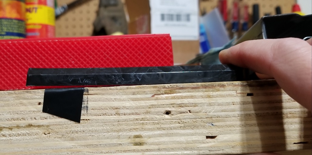

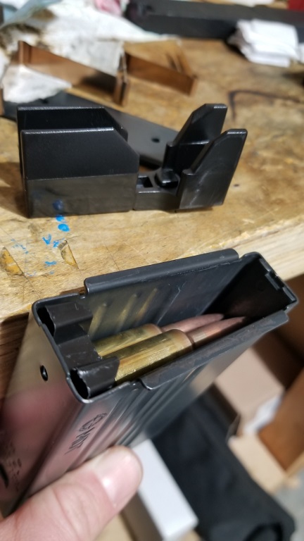

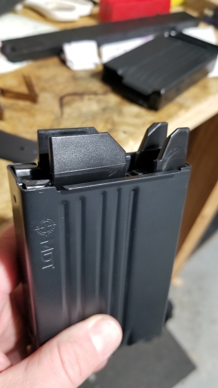

Turns out I only took off about 0.175", felt like more. I used neon yellow finger nail polish for the indicator. Pics of unaltered follower:
Modified follower and mag (recommend drilling the hole in the mag first, then load the mag and drill the small divot in the follower through the mag wall to ensure alignment):
View attachment 8338917View attachment 8338918
View attachment 8338919View attachment 8338920
View attachment 8338921View attachment 8338922
Nice work!!! I’m not going to ask about the yellow nail polish since I wear red 😂😂 but thanks for the info!!!!

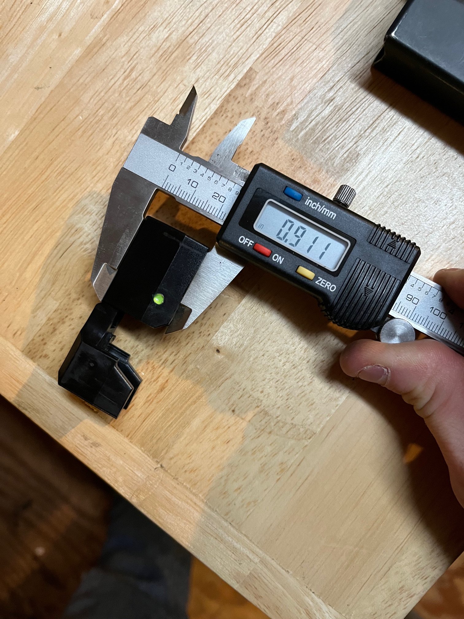

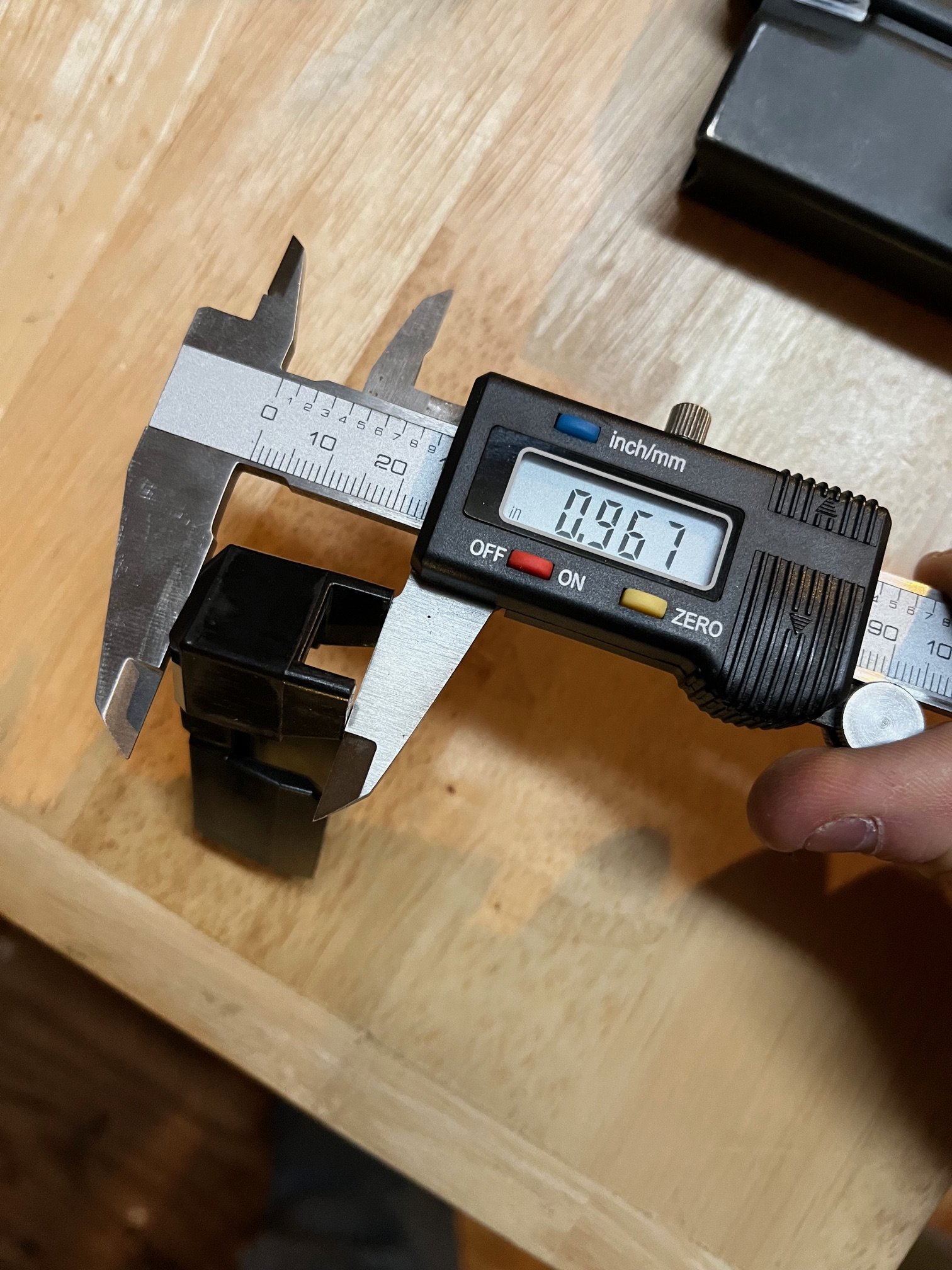

I have 2 of the newer body 12rd mags (black friday sale) and one older style body with new spring and follower mdt sent me. In my impact with otm bm and foundation they all have fed perfectly. They are a bit stiff to drop mag cuz they are just a bit thicker than my accurate mags but that's not that big of a deal to me. *knocks on wood*
How can you tell the difference between the new mag and the old mag? I got mine in 2022.

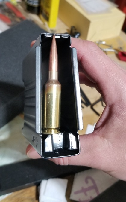

Just wanted to add some info here. If you are having issues with the ass end of the round sinking down in the mag and the bolt not picking it up, or skimming it and pushing it forward, but not into the chamber, try this…… remove your spring and pinch each the “V’s” together some. This is going to compress the spring some and give it slightly less upward force on the follower. This seems like the exact opposite thing to do, but after fucking with these things for hours, I finally realized it. I kept stretching the spring more and more thinking I needed more upward force on the follower to keep the ass end pushed up since it always showed to be sunk down after the 1st round was chambered. The way the spring sits, it was just putting more force on the front of the follower, thus making the problem worse. After pinching the Vs down some, it created a more balanced pressure across the whole follower. The spring still has more than enough tension. I tried it with 12, 10, 7, and 3 rounds. It fed good everytime.
I don’t know if this will help anyone else, but it’s worth a try. Especially if you are having issues with the ass end of the round sinking down.

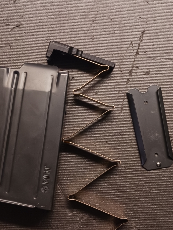

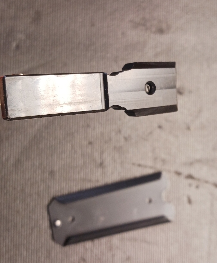

Follow up so I sanded the bottom of the follower using a sheet of course sandpaper on a piece of glass. Removed 2mm and now the 12th round fits with a little space to spare. It’s still a little difficulty getting that 12th round in but it goes in way easier. Not sure if I should sand more.

Knowing I'd eventually turn to a Dasher from a Creedmoor when I started loading my own ammo I got some mags awhile ago which I finally set up and shot last weekend. I had the hardest time trying to get 10rds into a 12rd mag. I took it apart and discovered what others here have already said; there is no way 12rds are going to fit into a 12rd magazine. If you take it apart and drop 10rds in and then the follower it sits flush with the very bottom of the body.
And if you drop in 12rds and then the follower it sticks way out.
Also the spacer in there does not lay flat and is bowed. That means when the first few rounds loaded get to the bottom of the magazine the nose is forced into the binder plate/front of it. So it'll at the very least deform the tip of the bullet ruining it's BC and make it more difficult to load that last few rounds as they scrape down and potentially push the bullet deeper into the case changing the OAL.
