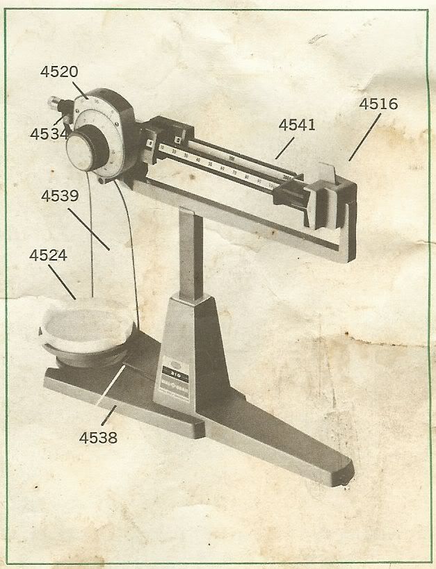

I have an Ohaus that is labeled "3100 Dial-O-Grain", but it came with literature that says 310 and talks about modifying to model 304 or 309 to measure grains instead of grams.
I got it for next to nothing at a gun show.
Re: Ohaus 1110 Dial A Grain scale
J.A. King mite be able to help you with the parts as they help me. http://www.jaking.com/Locations.htm. The 309 and 310 are textile, lab, school ect.. scales Grams vs. Grains and the dial on the 309 will measure over 100 grains and the dial on the 310 will just do over 10 grams. The 304 scale is a reloading scale the same as the RCBS just not in green, 1110 grains and a perch for a powder trickler. They also made a Cent-o-gram 314. The 314 was a reloading scale 3110 grains, 4 beams, no dial with perch for powder trickler.
