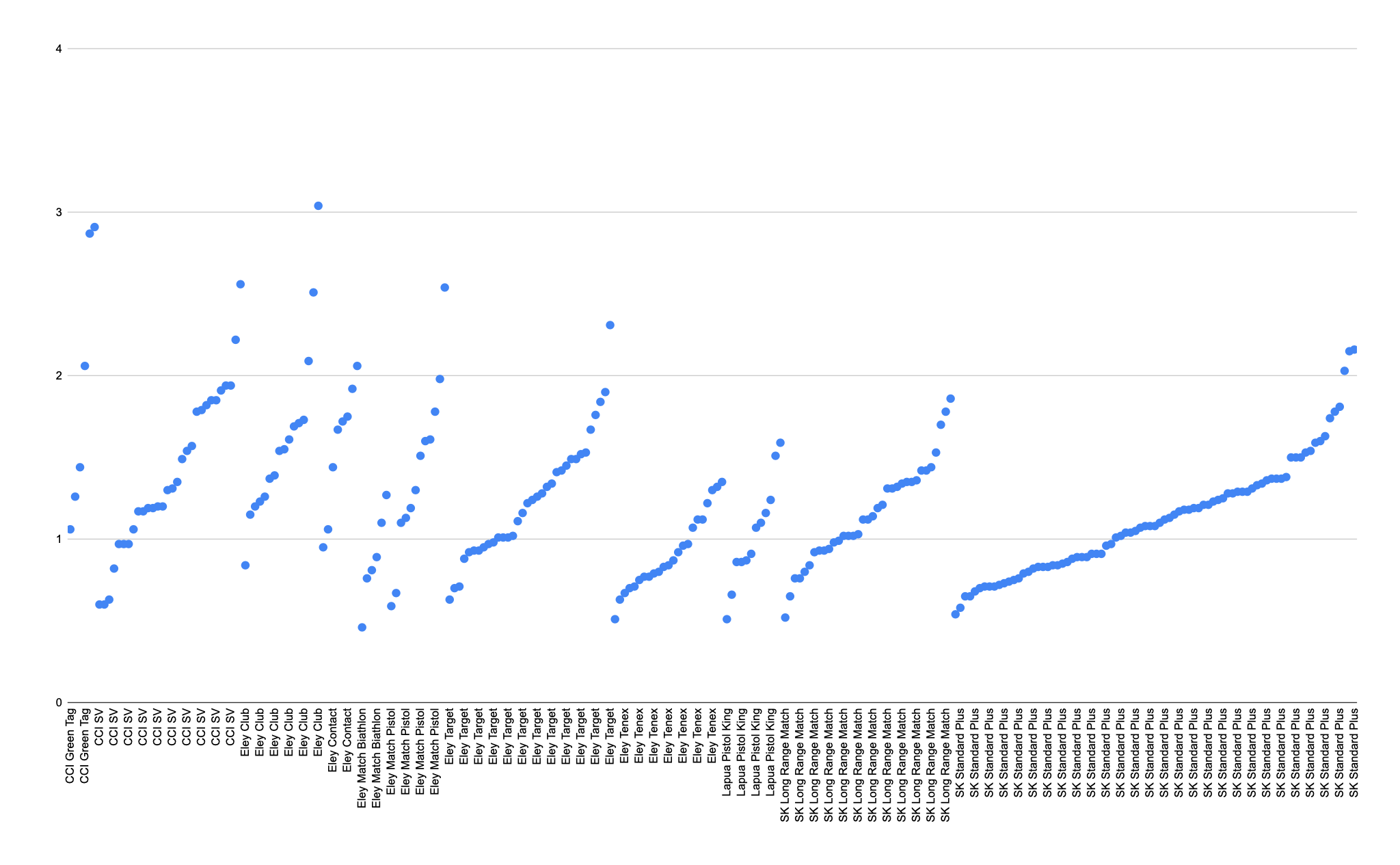

Here's my group sizes at 100 yards with my factory T1X. Lot testing does help too. I tested 4 lots of C-X, and 2 of them averaged .9" and 2 of them averaged .7". SK+, had 4 lots all averaging around 1.1", and 1 lot averaging .85". Ended up buying a case of each of those lots.

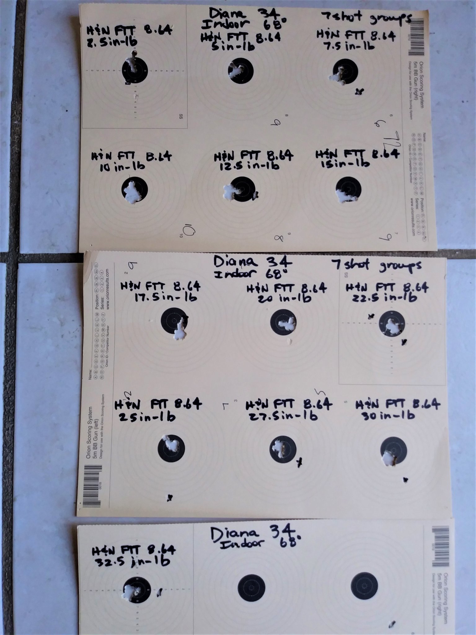

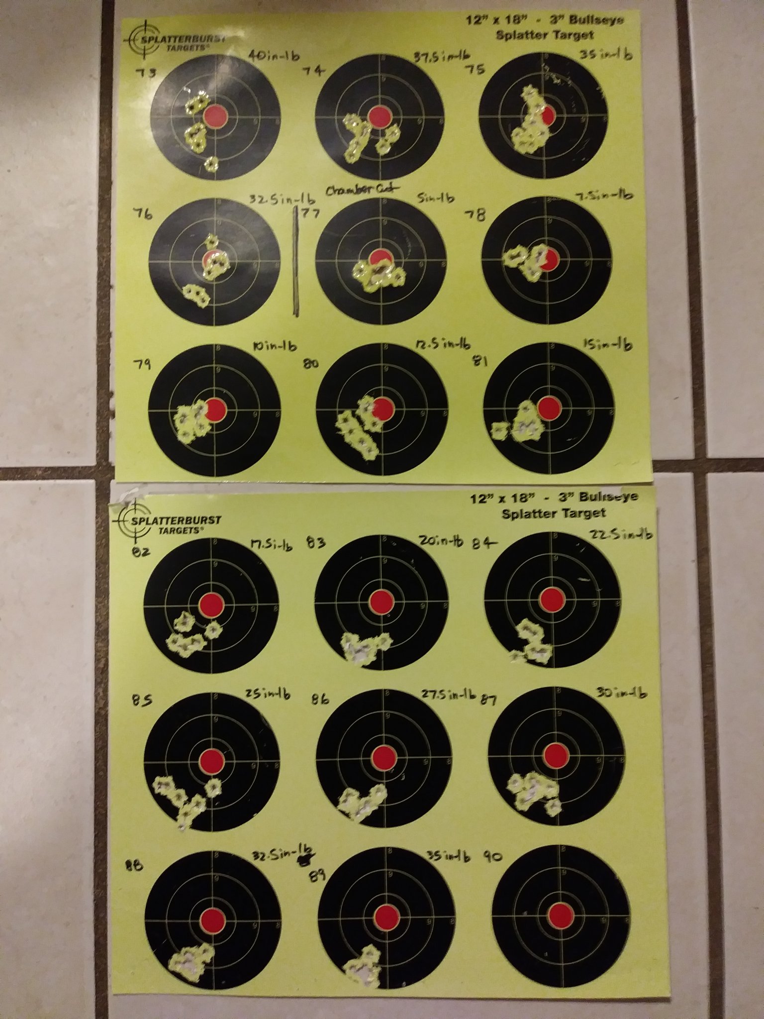

If I might add some thoughts from some exhaustive experimentation with a Savage Mark 2.
1) If your rifle is sensitive to the torque on the stock screws, which it probably is, then you should find this out before you blow through your ammo. I would suggest a Wheeler Fat Wrench for torquing your screws. I have ammo tested the Savage at least 3 major times, and multiple minor tests, and I found that I can make any ammo good or bad by changing torque of the stock screws. I wasted a lot of good ammo figuring this out. I figured out that Wolf, Eley, SK, RWS, CCI SV, Aguila SV, Fed Gold Medal, etc can all shoot really good or really bad. But with a pillar bedded action, free float barrel, shortened chamber, and 35 in-lb front and rear torque, I can average just over 1" at 100 yd with unsorted CCI SV with a flyer here and there. Sorted to .1 grains, the results are the same, but flyers are less common. Once there, I can shoot Eley Club, Eley Target, and Wolf at those same torques at get 1" or under with minimal flyers. The Eley Target and sorted CCI are almost identical. At 10-15 in-lb stock torque, the same ammo selection will give wildly different results. I know a guy shooting an Anschutz 54 that has seen the same thing with his torque settings. I have taken that knowledge over to shooting springer airguns, and my springers can compete with some PCPs shooting silohuette.
2) Batch testing. I can take one batch of CCI SV, optimize torque, then change to another batch, change torque slightly, and get virtually identical results.
3) Rest placement. This can seriously affect results on harmonically challenged rifles, like sporters. Rest it and hold it exactly the same.
4) Wind has major affect at 100. It can make a great ammo look like a dog.
5) I found Vibratite VC3 to be awesome stuff for keeping your screws from loosening.
6) I also found a correlation with COAL, just like in centerfire, but I have not had time to test much. For my Mark 2, the longer the COAL, the better. I shortened my chamber until CCI SV engages the lands.
Here are some targets I did with CCI SV at different torque settings. Just ignore the bulls before the line where it says "chamber cut". Each bull is a 10 shot group. Hope this saves you some time.

I guess I need a torque wrench. At its current level it shoots good with a number of ammos. It will be interesting to see if I can induce the same results.
Your rifle is shooter for sure. I don't think you have anything to fret over batch changes. Just tweak the torques from batch to batch and see if you can't get the new batch to cooperate. With the torques, mostly what you're doing is messing with the harmonics of the rifle to alter the barrel movement curve to find good spot. Going from Wolf to Aguila, that's a lot of variable changes. Going from Wolf lot A to lot B, is minimal variable changes. If someone gets noticeable group changes from lot to lot on the same quality ammo, that's a pretty good sign that rifle might need to be tuned up some. Basically, we're having to do with torque, what the hand-loaders are doing with load development.
This is from a break-barrel airgun I was torque testing at 20 yards. This rifle had been tuned pretty extensively - it was a dog when I got it. Notice how the POI AND the shape of group changes. That's pretty typical during torque testing. The groups move smoothly, but the direction of movement is largely unpredictable for any given variable. I've had 10gr pellets have a POI HIGHER than 7.4gr pellets. It's all about the harmonics. Have fun with it bro' and hope you get that Tikka shoot one hole.
EDIT: Those shots that are marked out with black X's weren't my flyers. They were from another shooter that chucked the targets and I reused them.

I had a few minutes and plugged everything into an excel file and did a bit of analysis. Again, listed are all the ammos in the order they were fired. The first number is the average group size, if there is a number in ( ) it excludes any obvious fliers, the next number is excluding the fouler group, which didn’t shrink the average much in most cases. ROUND 2 is the same deal for ammos that I had 100 rounds of, and total is an aggregation of both groups. At the end of this post there will be some of my take aways. If you have any please chime in.
American Eagle HV – .5953, .0649 ROUND 2 - .453, .491 TOTAL .514, .5544
Winchester Super Suppressed – .912, .914 ROUND 2 .865, .876 TOTAL .888, .894
Remington Subsonic - .656, .581 ROUND 2 .555, .541 TOTAL .605, .561
CCI Green Tag – .708, .728 ROUND 2 .624, .668 Total ? I realized I did the math wrong on a different computer.
CCI Subsonic – .604, .5513 ROUND 2 .354, .373 TOTAL .518, .48
CCI Clean Long Rifle – .81, .701, ROUND 2 .753, .711 TOTAL .7815, .706
CCI Pistol Match – .673, (.5155), .738 (.6XXX)
CCI Quiet 22 – COMICALLY BAD 2.081, 2.168
CCI Standard Velocity – .503, .518
Aguila Super Estra – 1.115, 1.268
Federal Gold Medal Target – .4605, .4646 ROUND 2 .3755, .3813, TOTAL .418, .437
Federal Hunter Match – .589, .492
Eley Club –.354, .374
SK Flatnose Match – .4455, .404
SK Standard Plus – .4224, .387
SK Rifle Match – .3955, .3646
SK Long Range Match – .562, .521
SK Biathlon – .508, (.388), .451 (.4005)
Lapua Pistol King – .372, .304
Lapua Pistol OSP – .8505, .9246
Lapua CenterX – .3605, .3013
Wolf – .269, .308
Here is what I see: my rifle likes a lot of the stuff that is “pistol”, it also likes most SK and Eley. My theory for NRL matches is 1 MOA is accurate enough. It doesn’t like Federal or CCI SV as much as I thought that it did relative to a few other offerings, however they will work in a pinch, lot testing with those will prove interesting.
Excluding the fliers only significantly positively impacts the SK biatholon, however since .22 fliers are more often the ammo than the shooter, I think that it a useless statistic. I know I didn’t throw those shots.
Excluding the fouler group only significantly helps the ammos that shot pretty well already, like SK and Lapua, it did help a few flavors of CCI but not enough to make me want to test them again. Because the barrel will be fouled whenever I am shooting a match this is also a probably useless statistic. I was surprised how often that exclusion opened up the group size, a lot of the CCI ammo had this occur, it must like a cleaner barrel.
Including more groups didn’t seem to significantly change things however the trend seemed to be shrinking the groups overtime, like the CCI Subs, I found this interesting. This finding may inspire me to test group size over 100 rounds not just 50 once I really settle in to a few ammo types
Stack Ranking Ammo Average Group Size (100 rounders using TOTAL number)
Wolf – .269,
Eley Club –.354,
Lapua Pistol King – .372, (SK BIATHOLON IF FLIERS EXCLUDED)
Federal Gold Medal Target – .4605, Round 2 .3755, TOTAL .418,
SK Biathlon – .508, (CCI PISTOL MATCH IF FLIERS EXCLUDED)
CCI Subsonic – .604, ROUND 2 .354, TOTAL .518,
American Eagle HV – .5953, ROUND 2 - .453, TOTAL .514,
Remington Subsonic - .656, ROUND 2 .555 TOTAL .605,
CCI Pistol Match – .673, .
CCI Green Tag – .708, ROUND 2 .624, Total ?
CCI Clean Long Rifle – .81, ROUND 2 .753, TOTAL .7815,
Winchester Super Suppressed – .912, ROUND 2 .865, TOTAL .888,
Stack Ranking average group size ex foulers (100 rounders using TOTAL number)
Lapua CenterX – .3013
Lapua Pistol King – .304
Wolf –.308
SK Rifle Match – .3646
SK Standard Plus – .387
Eley Club –.374 (SK BIATHOLON IF FLIERS EXCLUDED)
SK Flatnose Match – .404
Federal Gold Medal Target – .4646 ROUND 2 .3813, TOTAL .437
SK Biathlon – .451
CCI Subsonic – .5513 ROUND 2 .373 TOTAL .48
Federal Hunter Match – .492
CCI Standard Velocity – ..518
SK Long Range Match – .521 - (CCI PISTOL MATCH IF FLIERS EXCLUDED)
American Eagle HV – .0649 ROUND 2 - .491 TOTAL .5544
Remington Subsonic - .581 ROUND 2 .541 TOTAL .561
CCI Clean Long Rifle – .701, ROUND 2 .711 TOTAL .706
CCI Green Tag – .728 ROUND 2 .668 Total ?
CCI Pistol Match – .738 (.6XXX)
Winchester Super Suppressed – ..914 ROUND 2 .876 TOTAL .894
Lapua Pistol OSP – .9246
Aguila Super Estra –1.268
CCI Quiet 22 – COMICALLY BAD 2.168
When stack ranking two ways there is movement as to which ammo is “best”, however each ammo stays fairly range bound, ie, most don’t move very far, or fall out of their current performance band.
Here is how they move around from foulers included to no foulers included. –X means it moved down in the stack ranking by that many positions, +X means it moved up the stack ranking. 0 means it did not move in the stack ranking.
Wolf -2 (to third)
Eley Club -4
Lapua CenterX, +2 (to top position)
Lapua Pistol King +2 (to second)
SK Rifle Match, +1 (to fourth)
Federal Gold Medal Target -2
SK Standard Plus +2 (moved from the sub .5 tier to the sub)
SK Flatnose Match +1
CCI Standard Velocity -3
SK Biathlon +1 (to the sub .6 tier)
CCI Subsonic +1
American Eagle HV -2
SK Long Range Match 0
Federal Hunter Match +3
Remington Subsonic 0 to the sub .7 tier
CCI Pistol Match -2
CCI Green Tag 0
CCI Clean Long Rifle +2
Lapua Pistol OSP -1
Winchester Super Suppressed +1
Aguila Super Estra 0
CCI Quiet 22 – COMICALLY BAD 0
