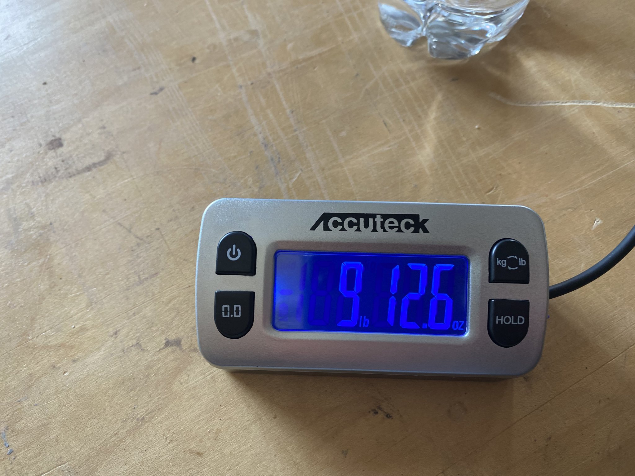

What was the actual finished weight of your rifle and how does it shoot?
9# 12 oz (including a 2# S&B scope and a 12 oz suppressor)

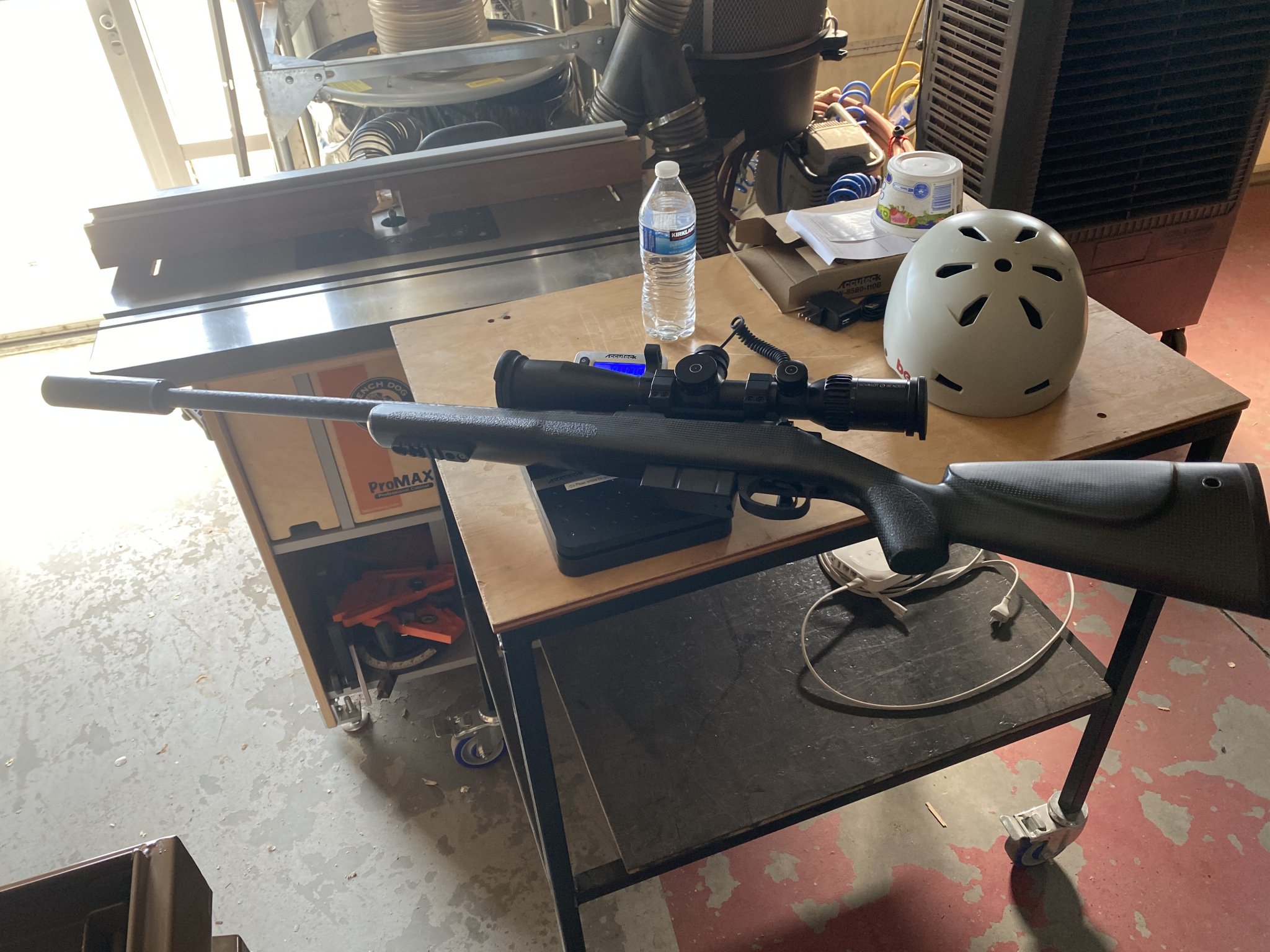

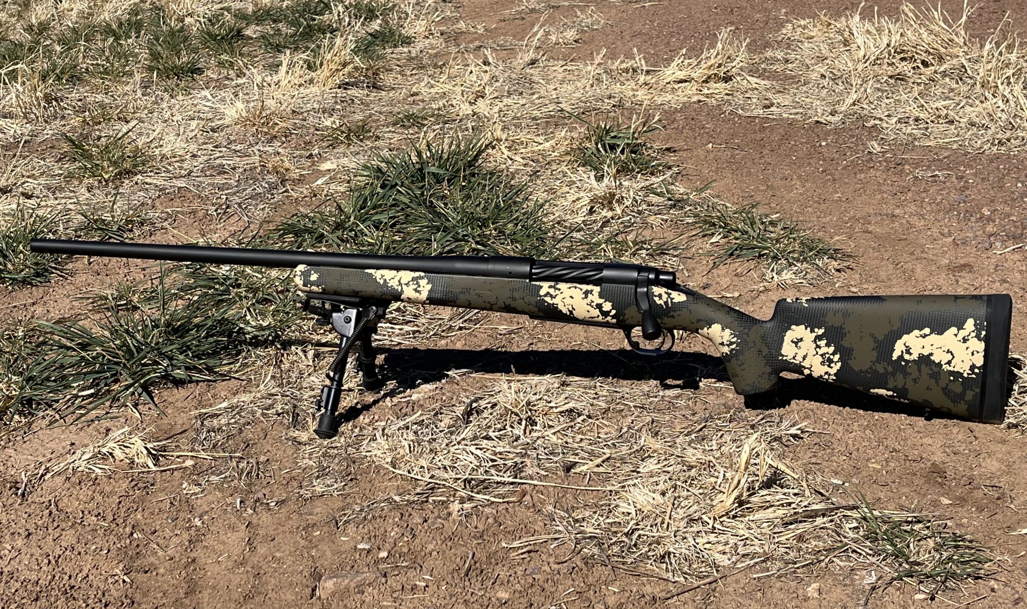

Tip to tail:
Suppressor - Silencerco Omega
Barrel - 22” Proof light sendero (7mm R SAUM)
Action - Defiance AnTi (XM length - allows 3.25”COAl instead of 2.85” of typical short action) with Defiance aluminum scope base.
Bottom metal - American Precision Arms XM RTG
Magazine - MDT XM mag (only option!) cut down by Kinport Peak Rifles to 4 rounds.
Trigger - Triggertech Special
Stock - All Terra Arms Carbon Stock
Glass - S&B 3-20x50 PMII
Rifle was chambered, bedded, and assembled by Greg at Council Mountain Gunworks. It shoots 145 gr Barnes LRX at 3100 fps (22” pipe) into 1/2 min (5 shot) groups. I’m sure it could do better but for my elk rifle that is plenty good (especially shooting copper).
The glass is definitely overkill and a bit heavy but when it’s time to shoot I’m glad I have it. We’ll see if I swap scopes in the future.
Magazines were the biggest challenge for this build. Three round versions are ‘in the works from various folks but they’ve been 6-12 months out for 2+ years. MDT made a 5 round for a while but I haven’t seen them around. The best option I found was to get a 10 round MDT XM mag and send it to Kinport Peak Rifles to be cut down to 4 rounds ($100 mag + $100 labor).
I like the XM over a long action and I don’t think I’d get the performance I wanted out of a short action (I gained over 1000 fps by seating bullets to 3.20” instead of 2.85”). It is definitely full custom though so be ready to spend some time finding parts etc…or just call Greg at Council Mountain and he’ll build you something awesome!

That is very nice. I just had a 30 Nosler based on a Remington 700 action put into an Allterra Arms stock. I really like the feel of that stock. With a shortened shank 24” Bartlein 3 barrel, it weighs 7 pounds, 7 ounces bare. For my kind of hunting, it would have been nice to have gotten it in 1/2 to 3/4 of a pound lighter.
Mine is really similar, I’d guess that the AnTi is the weight difference.
That’s a beautiful build.
