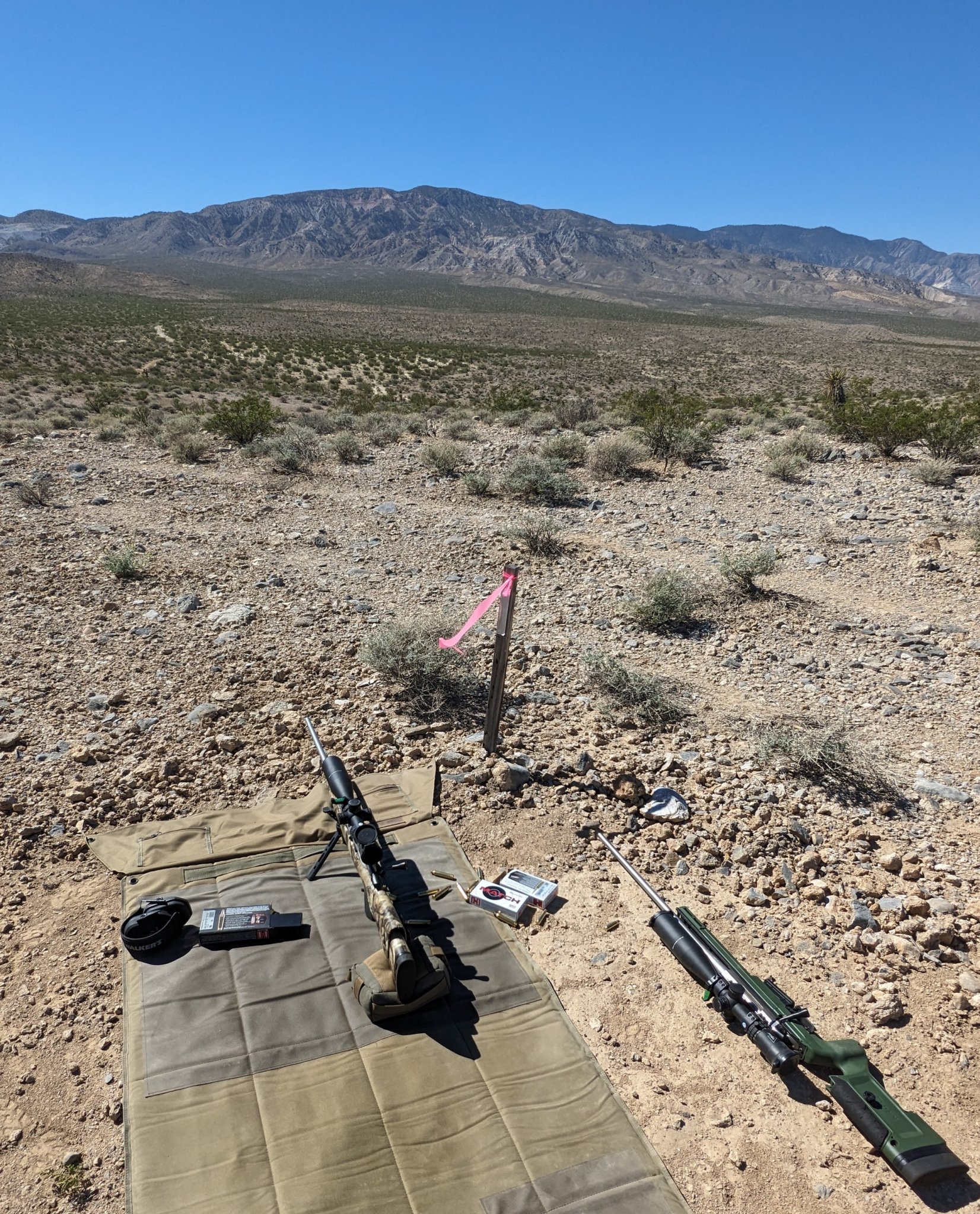

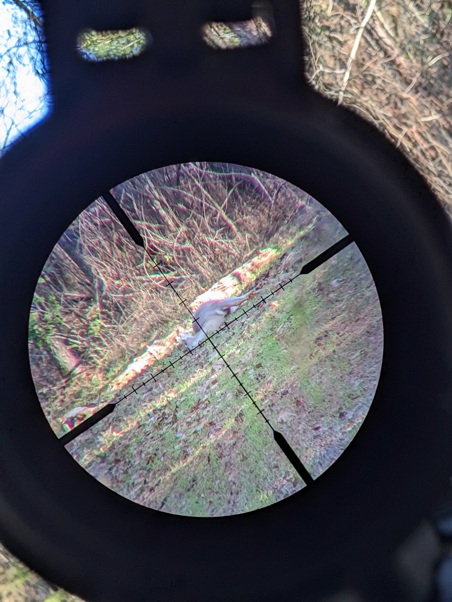

Between the two rifles shot 4 deer with them last year and trued out to 800 plinking steel when i visited my buddy in the desert last fall. 2 flights to california and alabama from hawaii no issues with retaining zero either. the dot illumination i do like vs the whole reticle for last light when in the woods on a cloudy evening. Haven't really seen any complaints from those that do have them, seems to be really great value with discounted prices they are often found at. 7mags gonna stay sfp but till deciding whether or not I want to go sfp or ffp with my 24 in 6.5cm. I see the benefits to both and liking the 3x9 ffp on my 20in 6.5cm.

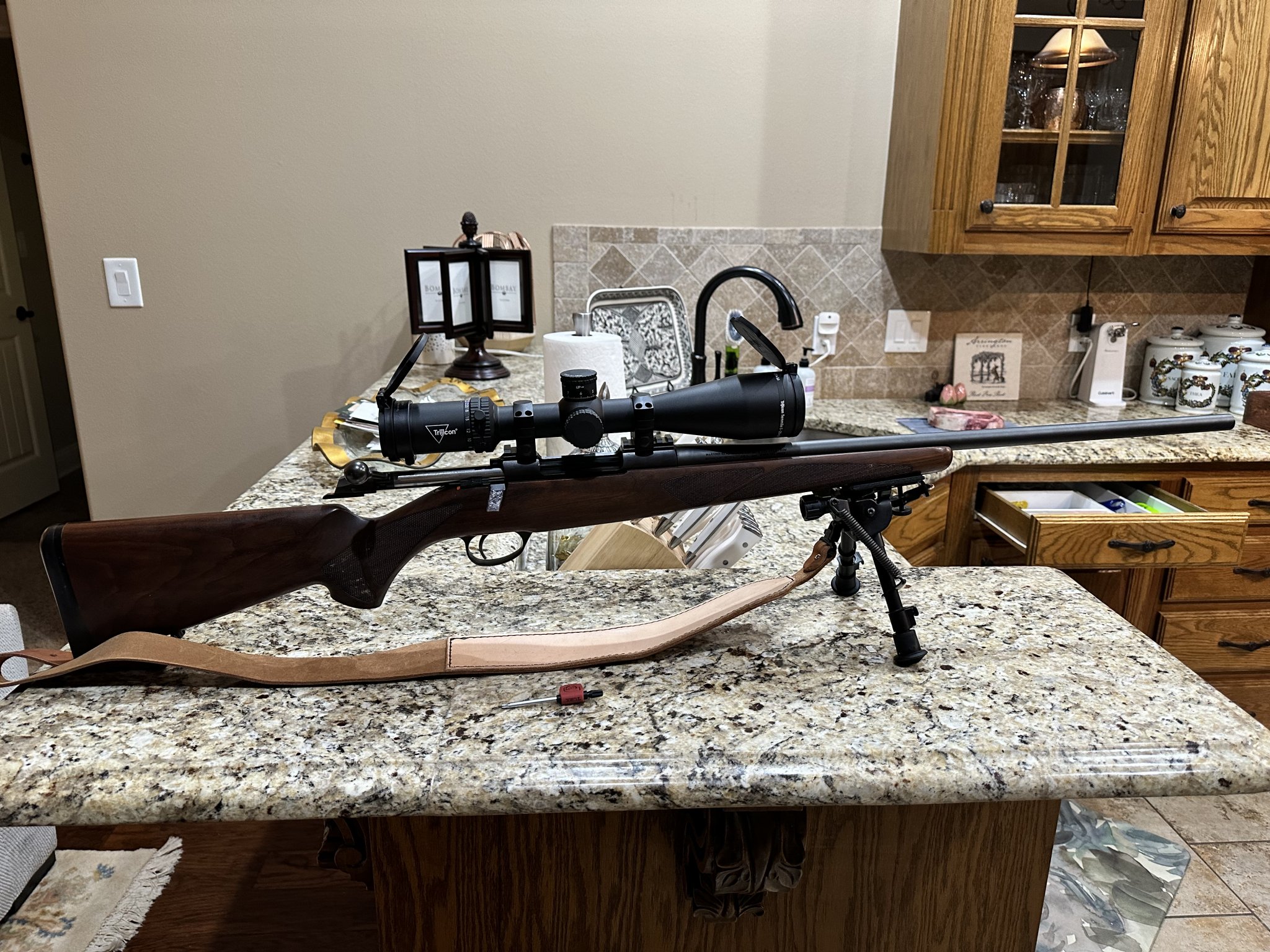

Just got the 5-25 mounted. First impressions are good. Wish the elevation turret was a little more tactile, like the windage. Eyebox seems a little tight at 25x. Going to hopefully go to the range tomorrow if i can withstand the cold and compare it to my Steiner T6Xi and Gen III razor. For the money though i really like it thus far. Mag ring is butter smooth, parallax is also smooth and goes down to 25yds, tenebraex caps, bikini cover, lens pen, the accessories are a huge plus.
That’s looks nice. Mine is going on a similar type rifle, was delivered today.
Reactions: 5RWill
I really am impressed thus far. Just need to get. New barrel for the sako and then I’ll be gtg with it.

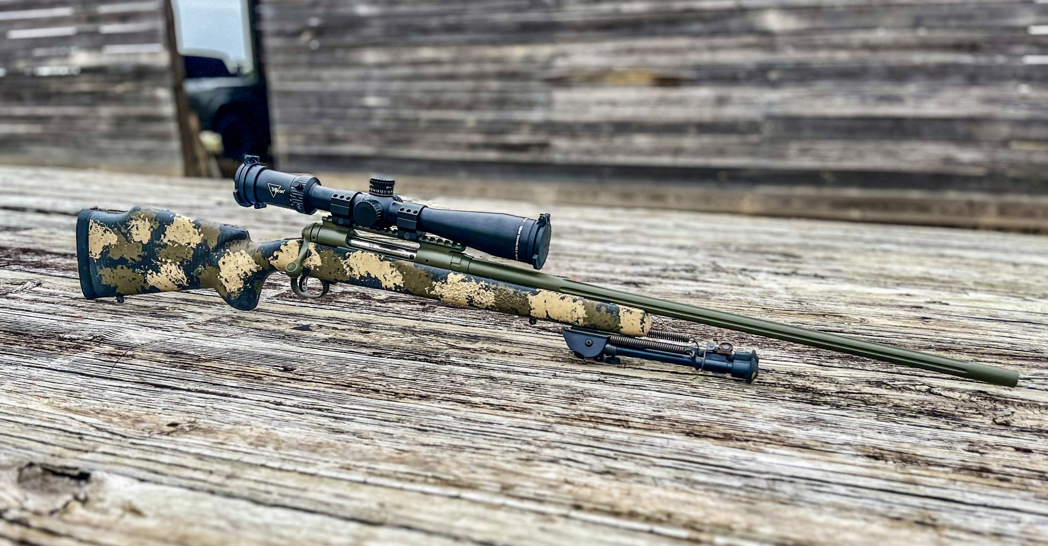

I’ll be trying mine soon. Saturday hopefully. It’s a combo build from Kevin Rayhill then had to have John Whidden correct. Shoots good now though.
Ran mine a few rounds to zero it’s a 3-18x44 model. Mounted on a 20 moa base I have 59 moa after zero more than enough for this rifle as it goes subsonic around 1350 yards with this load with another 15 moa left. Scope has 72 moa total travel, I think they advertise 60.? Glass is great, eye box isn’t bad but could be a little more forgiving if I pick at anything, optic does look a little thick around the outer edge (like the tube is bold looking through the glass) turrets are what I expected from my credo the elevation is soft but not easy, Windage more tactile (capped), zero stop is so easy to set and I really like the tooless turret caps on the tenmile and credo. Also reticle was done very nicely. Weight is 24 oz which I really wanted for this particular rifle, and came with scope cover and tenebraex caps. I didn’t do much to test tracking other than zero, hit 200,300,400 then carried straight to 800 with three shots with all center hits from my old door card with this load. If it’s as solid as they say from some test I e seen on them I’ll be more than happy with it, especially for what they are going for.
