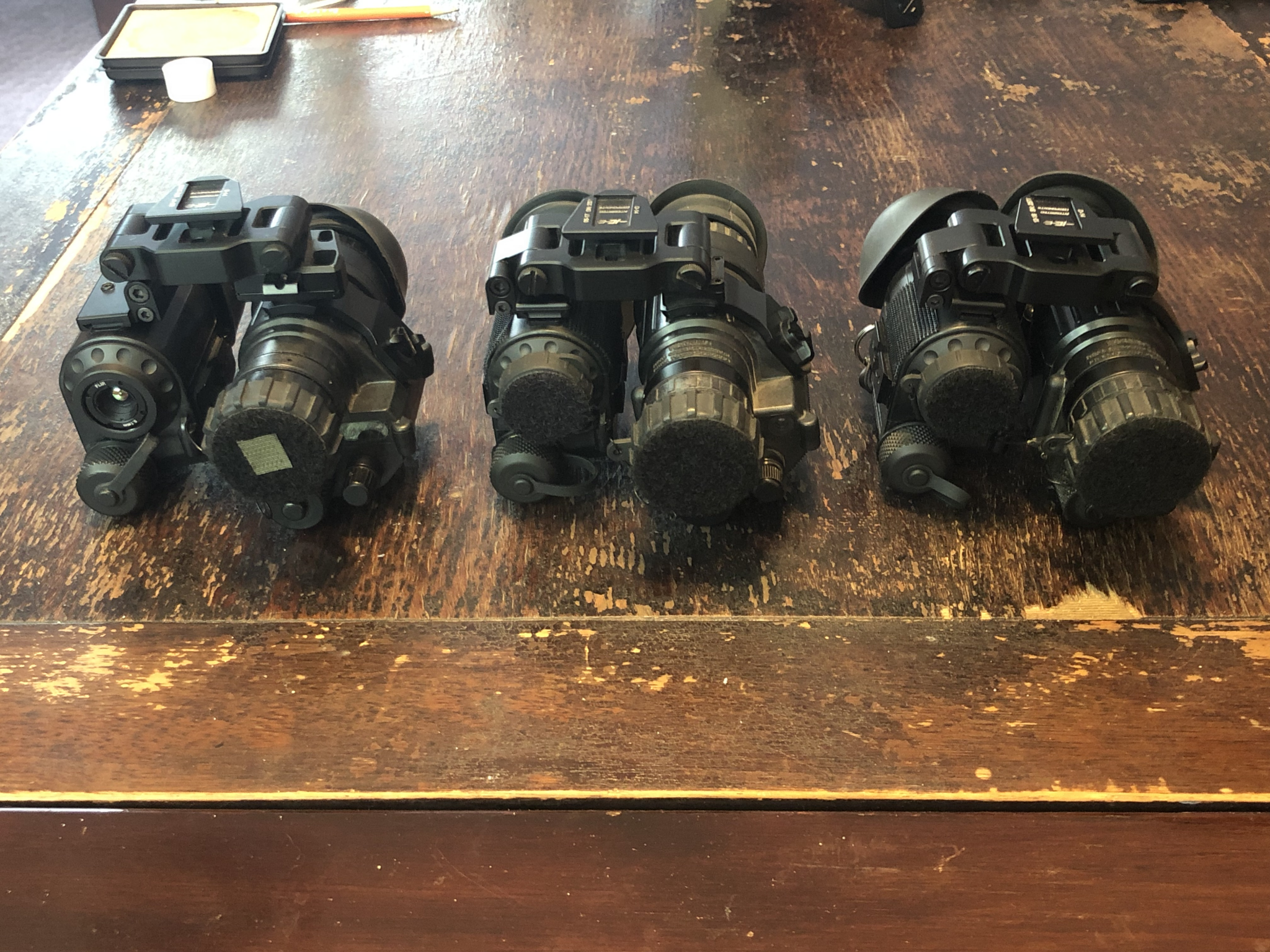

Night Vision Opinions on the Wilcox SkeetIR Bridge Setup for PVS14/Thermal or Dual PVS14s?
I do run the wilcox wired setup. Don't really use the buttons though. Live in somewhat rural area so no need to kill them quick. Sometimes when I'm walking out of the woods into a lit area I turn the switches on the units off and then hit the buttons just to be sure, mainly because they are there.
Different brand arms also impact how close or far the ocular sits from the face. I have never owned anything else and have no complaints about mine, but for weight/counterbalance I have wondered how much it would impact the feel of the helmet on the head if I had different ones. Ex: J arm that has ocular a bit farther away allows the G22 (in my case) to be run a bit closer in to the helmet reducing leverage. Just been too lazy/poor to try it out.
The Mod Armory arms have the dovetails more centered on the device. I don't know if they will snap into the wilcox sockets though. If the spring loaded tab that locks them in is in the front they should work. If its in the rear like a knights Jamr and I'm assuming the bridge it might not work.
basically. Even worse than a box and a circle, you have a canted box and a circle.
Ah. Yeah. I could see how that would be annoying :S. Thinking about it, there is no way around it given how the D14 requires moving the arms apart to get ipd right so each person will have it be a different amount of canted. Genuinely not sure how annoying it would be but I'm sure it depends on the person too
So having had my nox 18 out I can offer a better opinion. I don't think the bridge is really the deciding factor. If ghetto fusion works for you the box being a little canted doesn't matter. If you struggle with it I think that and a lot of other things will annoy the shit out of you. I guess I got lucky. For me it acts like a coti but with a high definition square in the middle instead of the circle. I need to play with the brightness on the nox. Under canopy my 14 gets dimmer and the box dominates your view. With ir light on its almost seamless.

Well, you might want to think about a Breach. It is a much better thermal than the COTI and has warranty and support. I have 3 Breach setups. The Breach's match up very well with PVS 14's with the Mod Armory Bridges. While they are not as good as the NOX, the Breach is probably the best cost/benefit/performer out there in the Helmet Mountable Thermals IMHO.
Figures haha. Is the successor a worthy alternative to a Breach in a bridge config?
