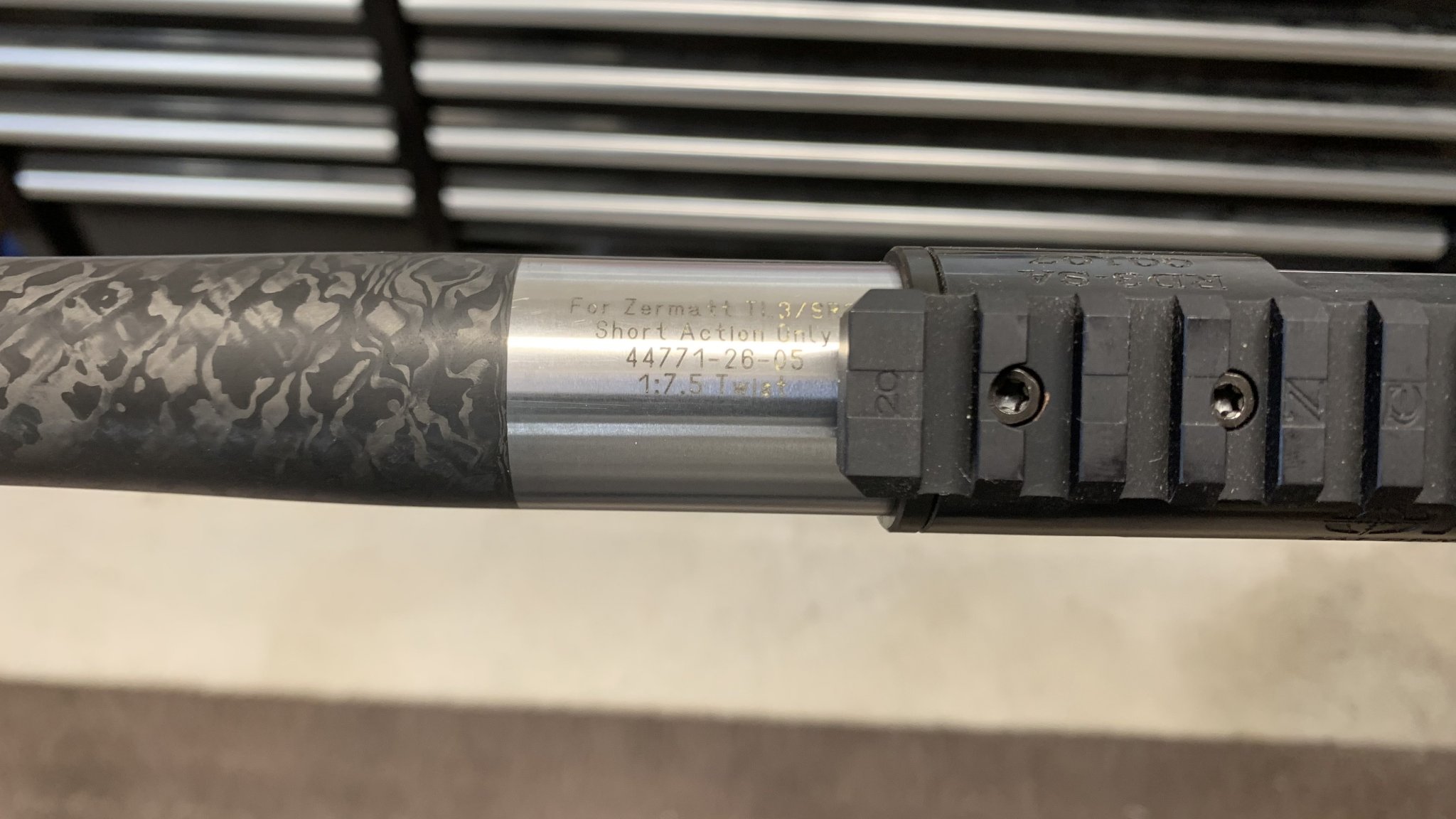

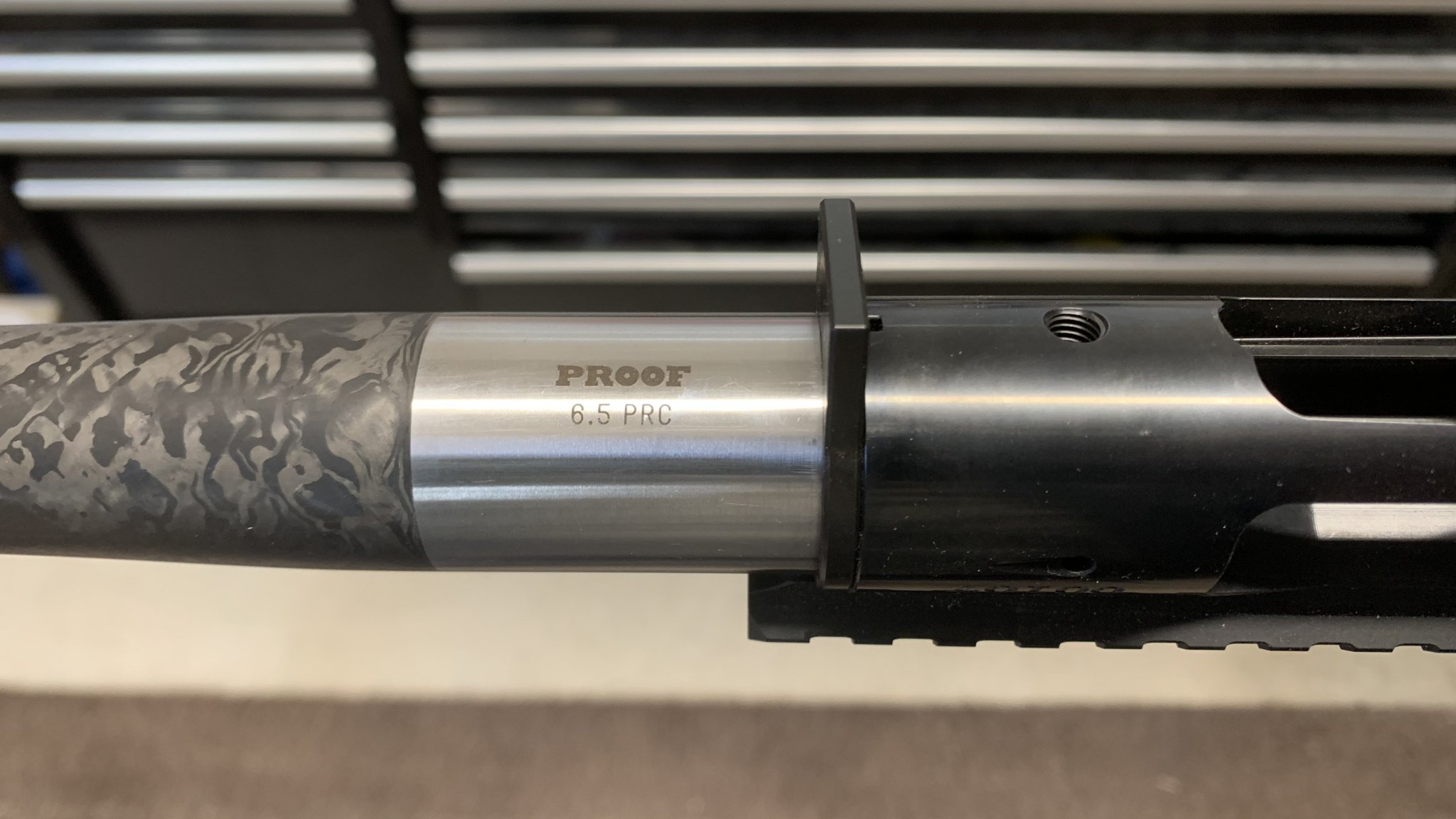

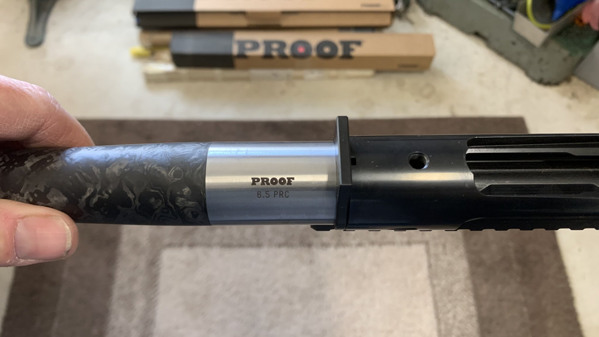

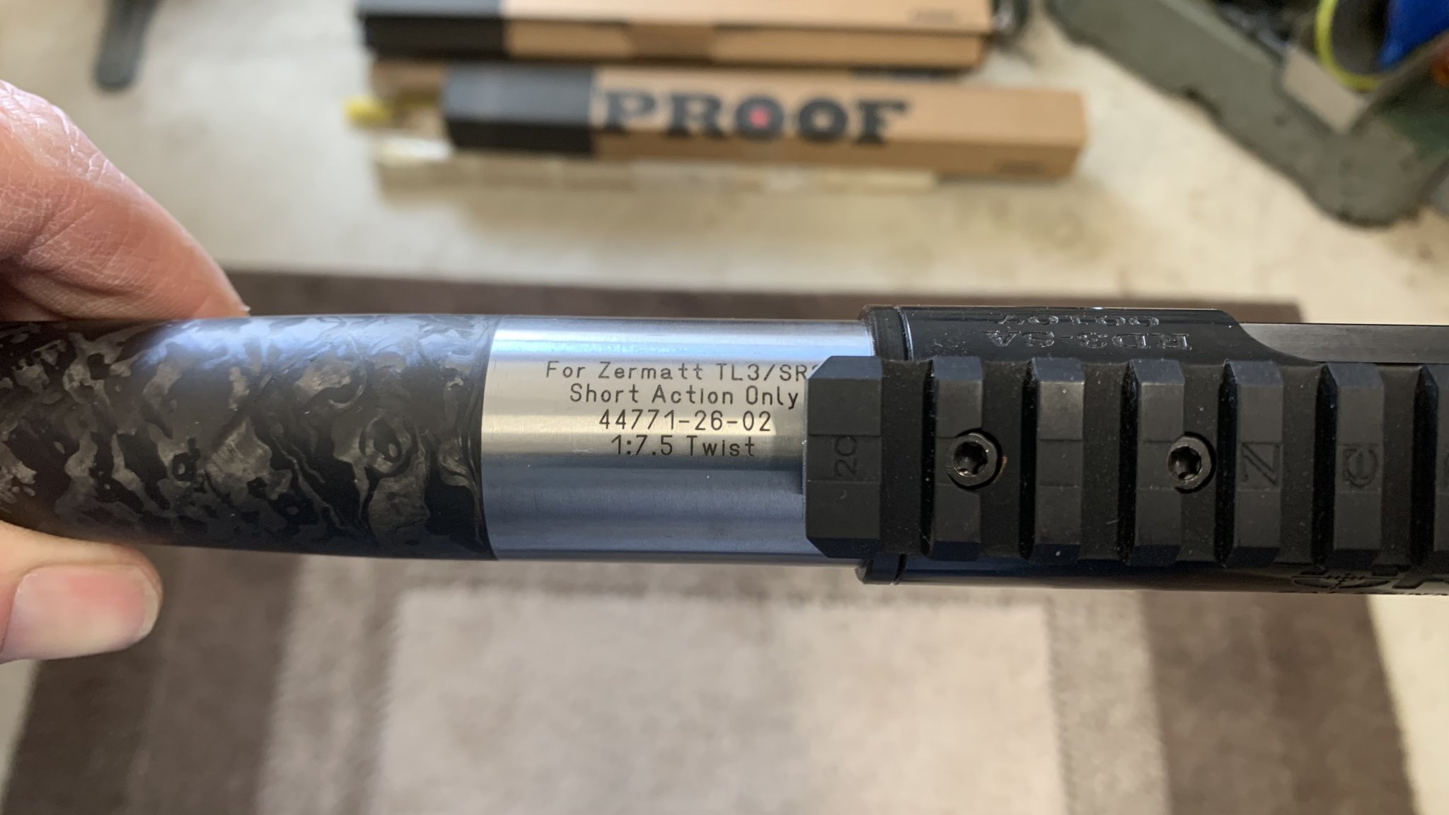

    My personal origin was all lonely, so here it is with two customer prefits. Unmodified proof TL3 prefit on an Origin with a HLR lug. Fully seated but not torqued. Note the different serial numbers on the barrels.
