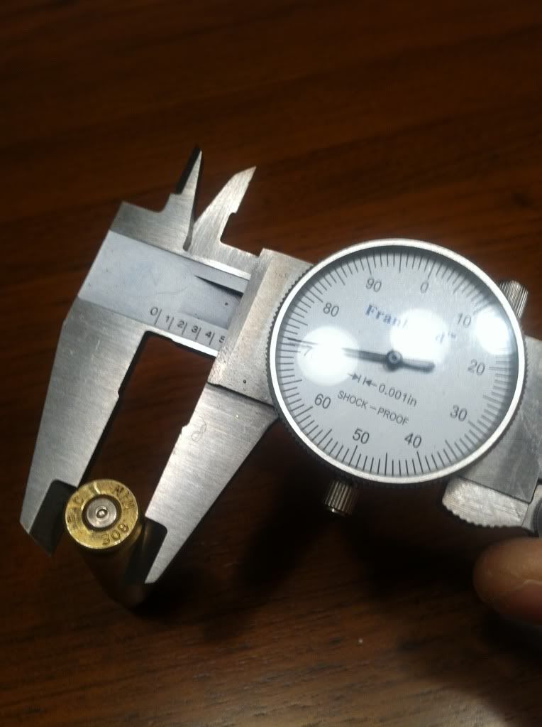

Once fired Federal GMM from a Savage .308 bolt gun:
.468" at the head:
.466" at the body:

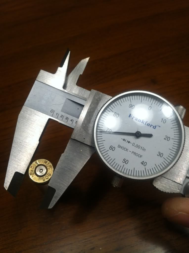

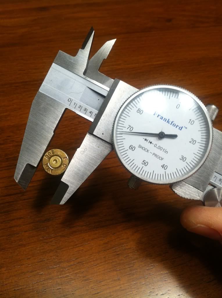

3X fired Federal brass, 178g Hornady Match, 45.0g BLC-2, 18" OBR
.469" at the head (.001" larger than once fired)
.472" at the body (the body has expanded beyond the head)

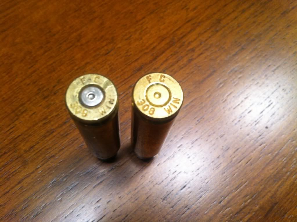

A comparison of the two heads side by side:
The lettering on the once fired Federal brass out of the bolt gun has deeper lettering while the 3X fired handloaded brass appears to be flattening.
.468" at the head:
.466" at the body:
